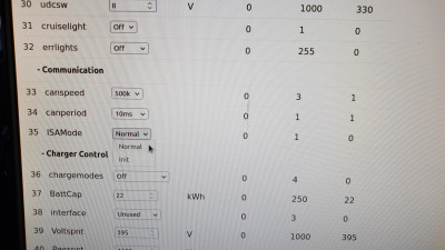

Re: ZombieVerter VCU Support
Hello
I need your help again
I have ordered the shunt and connected it
unfortunately I don't get any correct data displayed in the web interface
for example
udc 16777.18
udc2 -33554.4

If I connect an Arduino CAN shield with this code
https://openinverter.org/wiki/Getting_s ... bus_shield
then I get the correct data displayed
What I have seen is that in the Arduino code
CAN_1000KBPS
and VCU CAN is set to 500KBPS.
Peter

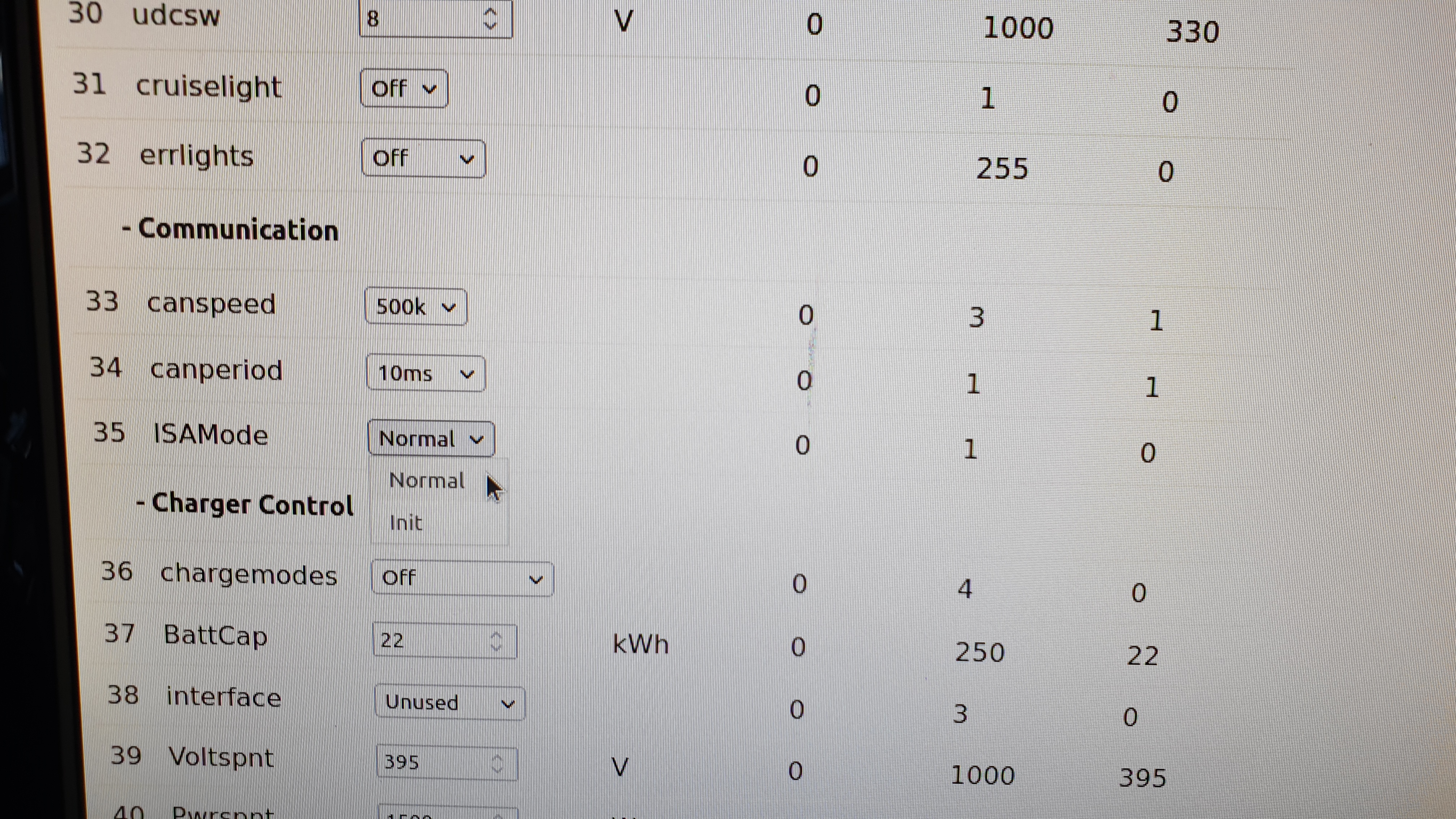

- Posts: 4000
- Been thanked: 1115 times
So this will be covered in the next video but here's the basics :
under Comms there is now an ISAMode option. By default its in "Normal". If you want to initialise a new shunt, connect it up, power on shunt and vcu, select "Init", hit save parameters to flash. Power cycle vcu and shunt at same time (should be on same 12v feed anyway). Shunt will initialise. Select ISAMode "normal", save to flash again and reboot again. Shunt should now be up and running. I've attached binaries with this implemented but will be available on Github shortly.

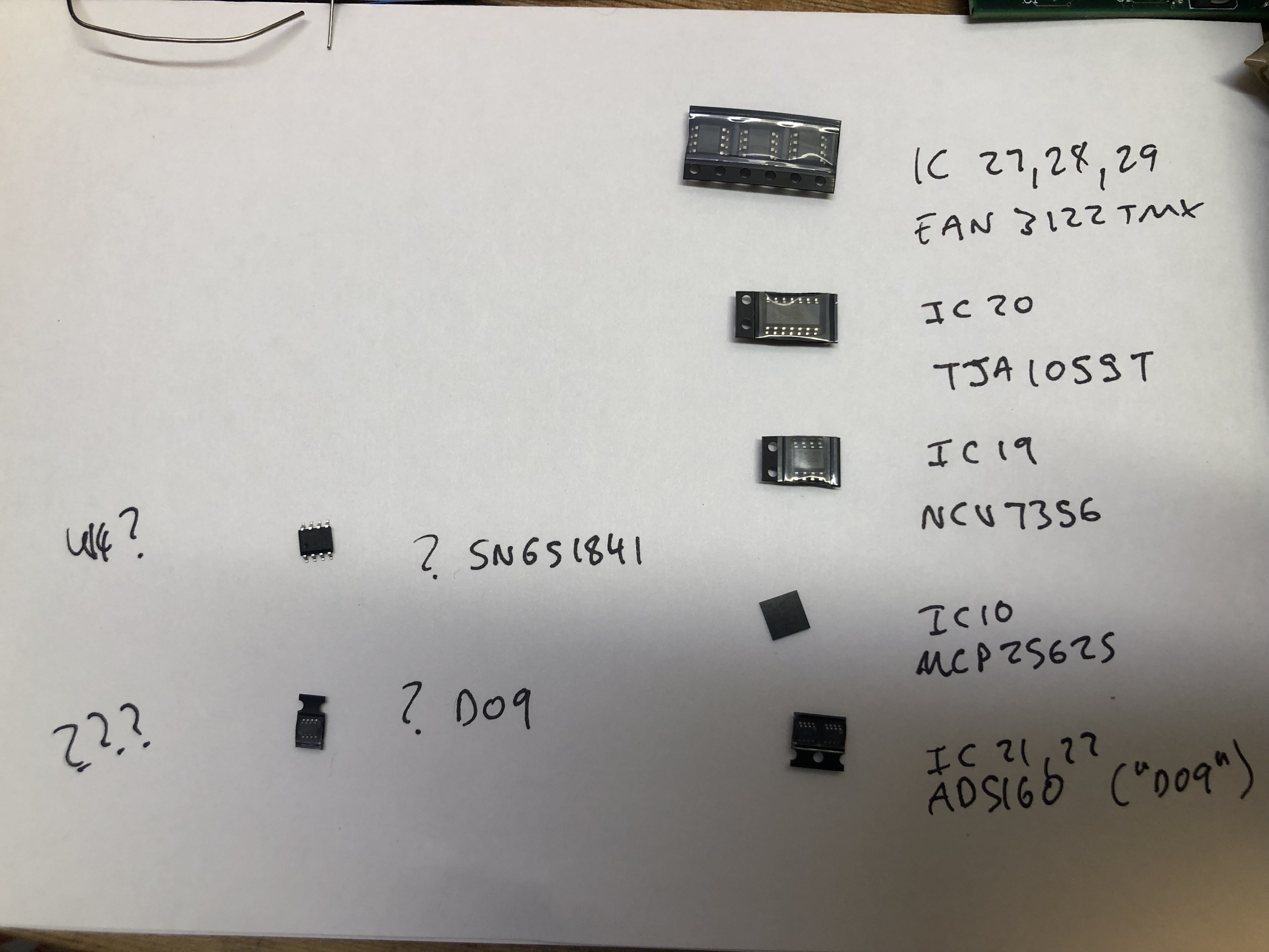

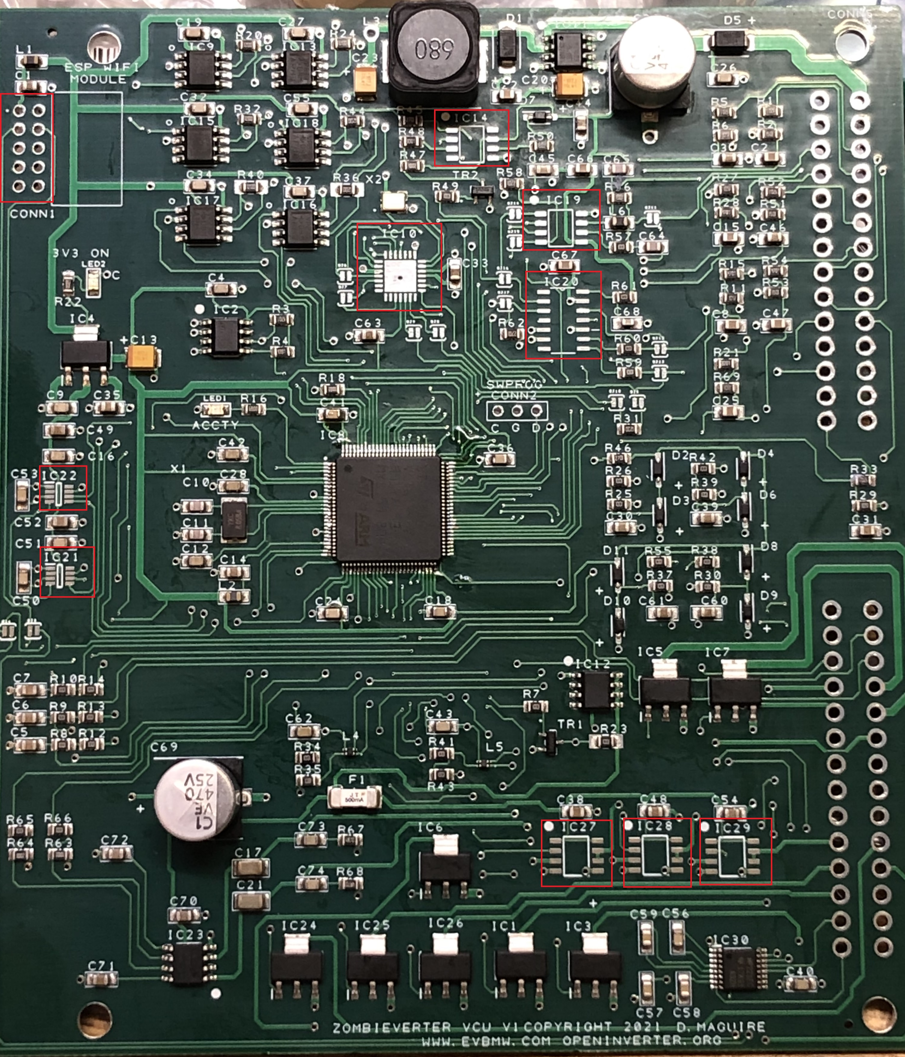

- PaulHeystee
- Posts: 141
- Joined: Mon Apr 12, 2021 10:26 am
- Location: Nederland
- Has thanked: 3 times
- Been thanked: 35 times
Does anybody know where the ICs go that where supplied separately with the zombieverter board?
I just got it in and checked out the schematic from github, however, the resolution is too low to actually be able to read the IC numbers.
mvg
Paul
mvg
Paul
Hi Dämon
I have the same problem and can't get CAN signals to CAN2.
Hi Paul
I can take photos tomorrow of how I soldered the loose components onto the board.
then we can try to compare
Hi Paul
et0
- Posts: 132
- Joined: Sun Oct 13, 2019 8:06 pm
- Location: Scotland
- Has thanked: 15 times
- Been thanked: 6 times
Hey Paul, I think you might be looking at the preview image of the schematic? If you go "download" and then open the PDF, you can zoom right in on each section and see everything clearly.PaulHeystee wrote: ↑Tue Nov 02, 2021 7:08 pm Hi,
Hope that helps.
https://github.com/damienmaguire/Stm32- ... ematic.pdf

The unpopulated spaces on the PCB vs the parts listed on the schematic are:
IC10 = MCP25625T
IC14 = TJA1020
IC19 = NCV7356
IC20 = TJA1055T
IC21, 22 = AD5160
IC27, 28, 29 = FAN3122
The parts supplied are as below, they match apart from:
There is an extra 8 pin SOP which looks like the digi pot, but no place for it.
The remaining IC which should be IC14 is marked SN65185 as far as I can tell.
On the old board, the IC14 is marked "1020", so that seems correct.
The one supplied seems to be an RS-485 transceiver, so that is presumably a replacement for the LIN transceiver? Just checking..

- Posts: 4000
The TJA1020 is a lin transciever that of course can't be obtained due to the chip shortage. There should be an MCP2004 supplied as a replacement. Now however it looks as if I can't even trust RS to put the right parts in my orders. Great. Looks like I gave you an extra digi pot by mistake.
- Posts: 4000
Yeah LIN is not used at the minute in software anyway. I'll send over an mcp2004 to you in a few days.
