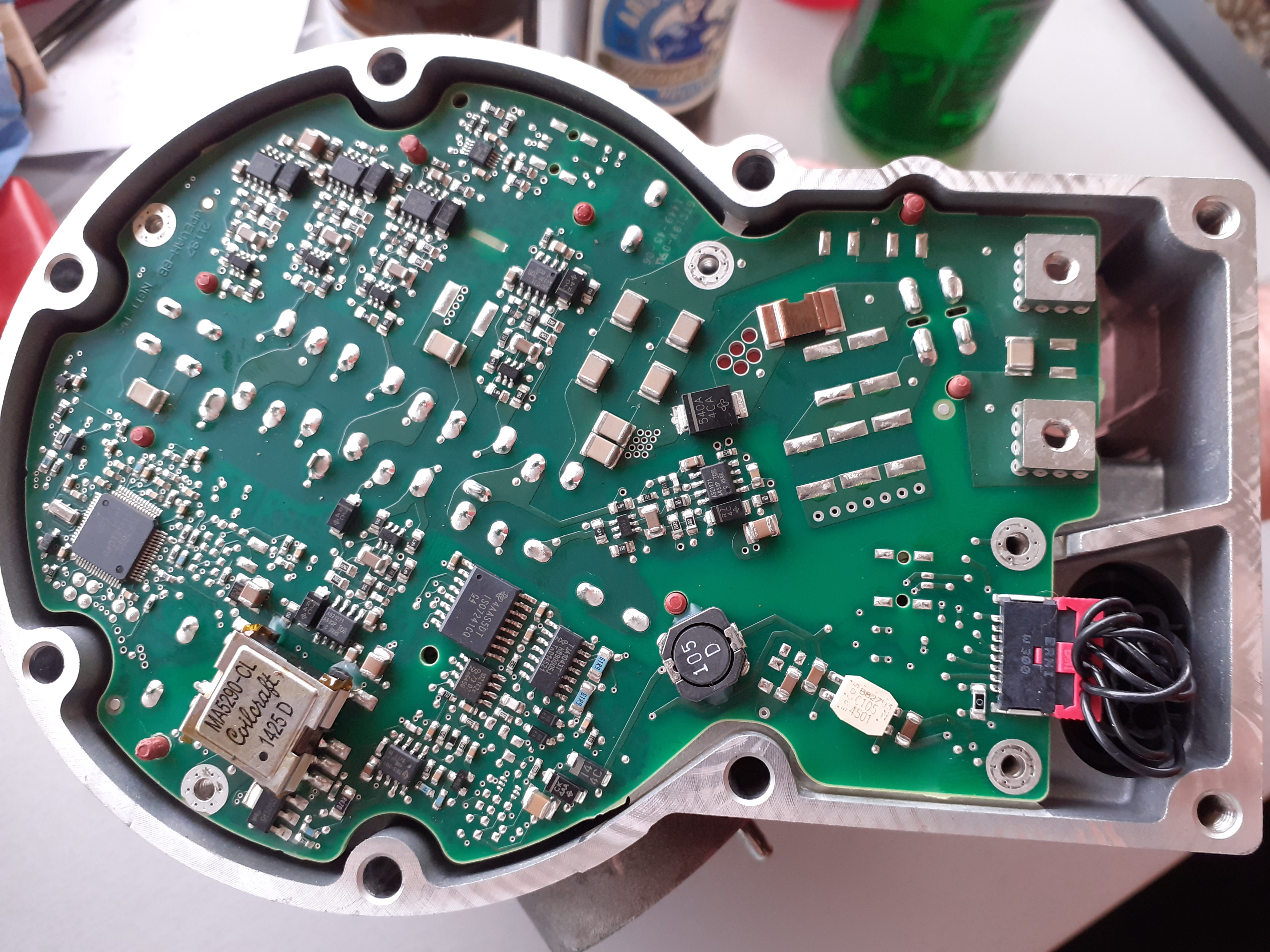

So after a week of troubleshooting, I found the issue. Not the same I inverter/pcb with overcurrent and blown fuses that I described here a month ago. Anyway, this pcb was purchased fully assembled and tested.
I had it on the bench fully working in February this year. But when test running it now it threw OVERCURRENT and HIRESOFS. First I thought it was software related. Then I measured around on current sensing related TP and components and when holding the probe against a leg of IC11, That bastard moved! Turns out IC11 had only been soldered on one of leg. Looked hand soldered. So I soldered it and now it works.

Please contact me for some compensation (I assume you bought from me?). Not sure how this would have slipped through as I measure the analog voltage signal on the test points while feeding the clock signal to the input.

Ok, Clanarn contacted me and the board was not sourced from the openinverter shop - always buy originalClanarn wrote: ↑Fri Sep 24, 2021 4:08 pm So after a week of troubleshooting, I found the issue. Not the same I inverter/pcb with overcurrent and blown fuses that I described here a month ago. Anyway, this pcb was purchased fully assembled and tested.
