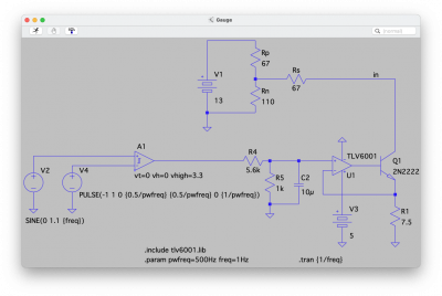

I've come up with a simple low cost solution that should work and still uses PWM.
I made a simplified model of one of my gauges, represented by Rp, Rs and Rn. The maximum current for this is about 70mA.
V2, V4 and A1 are modelling the PWM logic output with a 3.3V supply. This is low pass filtered by R4, R5 and C2 to give about 3mA peak-to-peak ripple in R1.
I'll breadboard this when I get a chance, just need to buy some bits.

I breadboarded the circuit described earlier. It works great, but the gauge behaves strangely in that when you reduce the current, the pointer doesn't come down to the same place as when it's going up. I can drop it below where I want it to be then bring it back up again, but this isn't ideal.
It's also nonlinear, but I can work with that.
