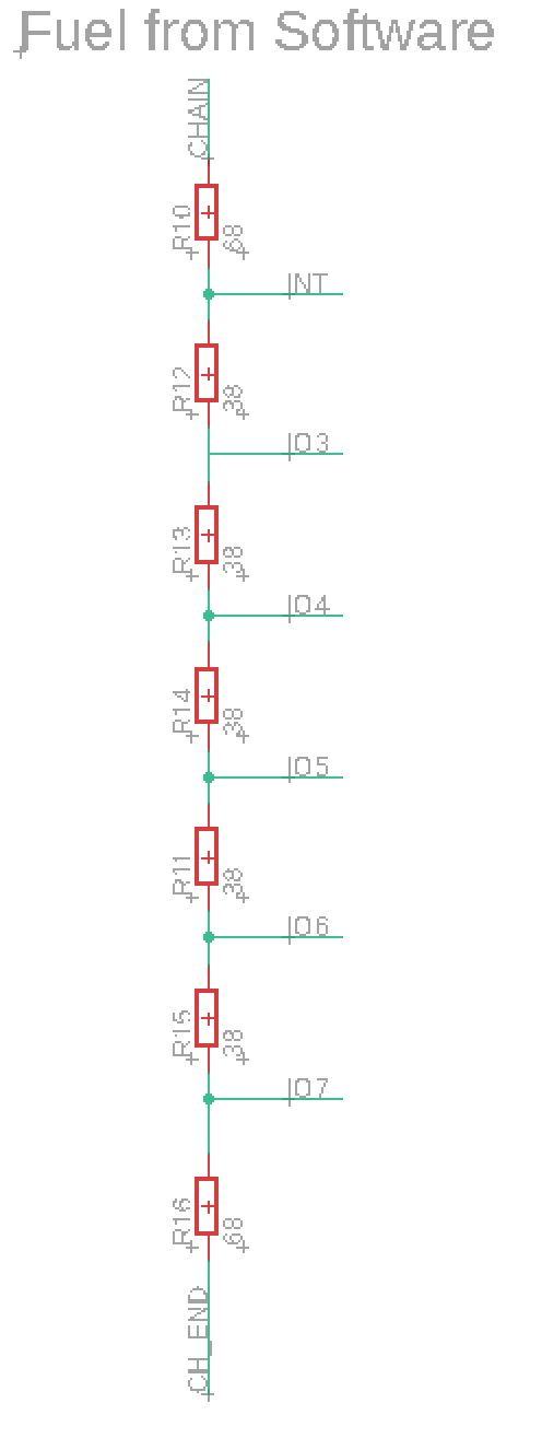

Check out the schematic on this guy :
https://hackaday.io/project/6288-can-bu ... -simulator
Super simple way to drive the vag fuel gauge.
- Posts: 1771
- Has thanked: 82 times
- Been thanked: 422 times
Re: Controlling an analog dash
Great find, that's a genius solution.
void Fuel(int amount)
pinMode(2, INPUT);
pinMode(3, INPUT);
pinMode(4, INPUT);
pinMode(5, INPUT);
pinMode(6, INPUT);
pinMode(7, INPUT);
if (amount >= 90)
pinMode(2, OUTPUT);
digitalWrite(2, LOW);
return;
if (amount >= 75)
pinMode(3, OUTPUT);
digitalWrite(3, LOW);
return;
if (amount >= 50)
pinMode(4, OUTPUT);
digitalWrite(4, LOW);
return;
if (amount >= 25)
pinMode(5, OUTPUT);
digitalWrite(5, LOW);
return;
if (amount >= 10)
pinMode(6, OUTPUT);
digitalWrite(6, LOW);
return;
if (amount >= 0)
pinMode(7, OUTPUT);
digitalWrite(7, LOW);
return;

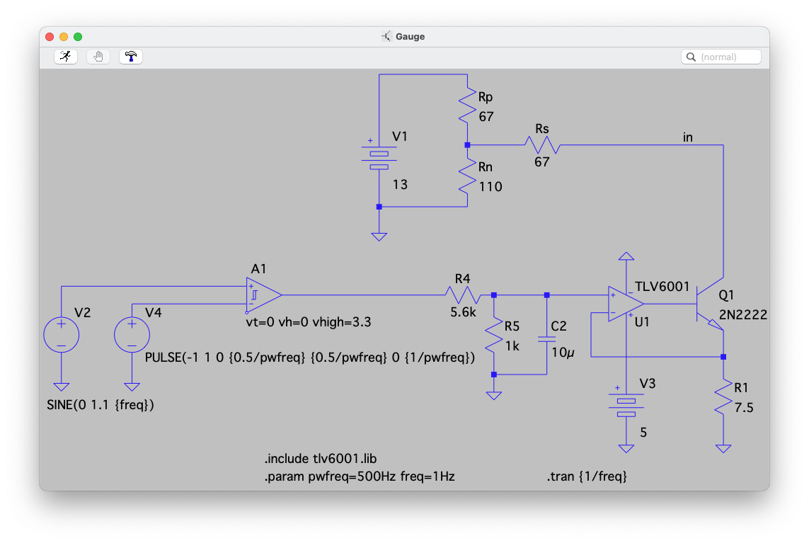

I've come up with a simple low cost solution that should work and still uses PWM.
I made a simplified model of one of my gauges, represented by Rp, Rs and Rn. The maximum current for this is about 70mA.
V2, V4 and A1 are modelling the PWM logic output with a 3.3V supply. This is low pass filtered by R4, R5 and C2 to give about 3mA peak-to-peak ripple in R1.
I'll breadboard this when I get a chance, just need to buy some bits.

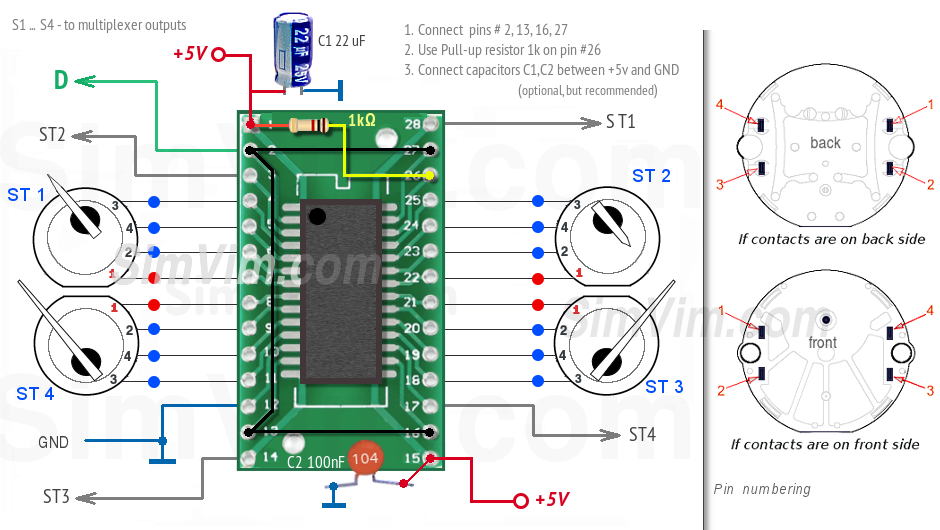

I removed all of the original mechanics from my analog dash and replaced them with stepper motors. Needs a little more mechanical skill, but now I have full control and low power consumption. I found the necessary information on this page: https://realsimcontrol.com/io_step.html
There is also a special watch stepper that I used to replace my watch.

I breadboarded the circuit described earlier. It works great, but the gauge behaves strangely in that when you reduce the current, the pointer doesn't come down to the same place as when it's going up. I can drop it below where I want it to be then bring it back up again, but this isn't ideal.
It's also nonlinear, but I can work with that.
