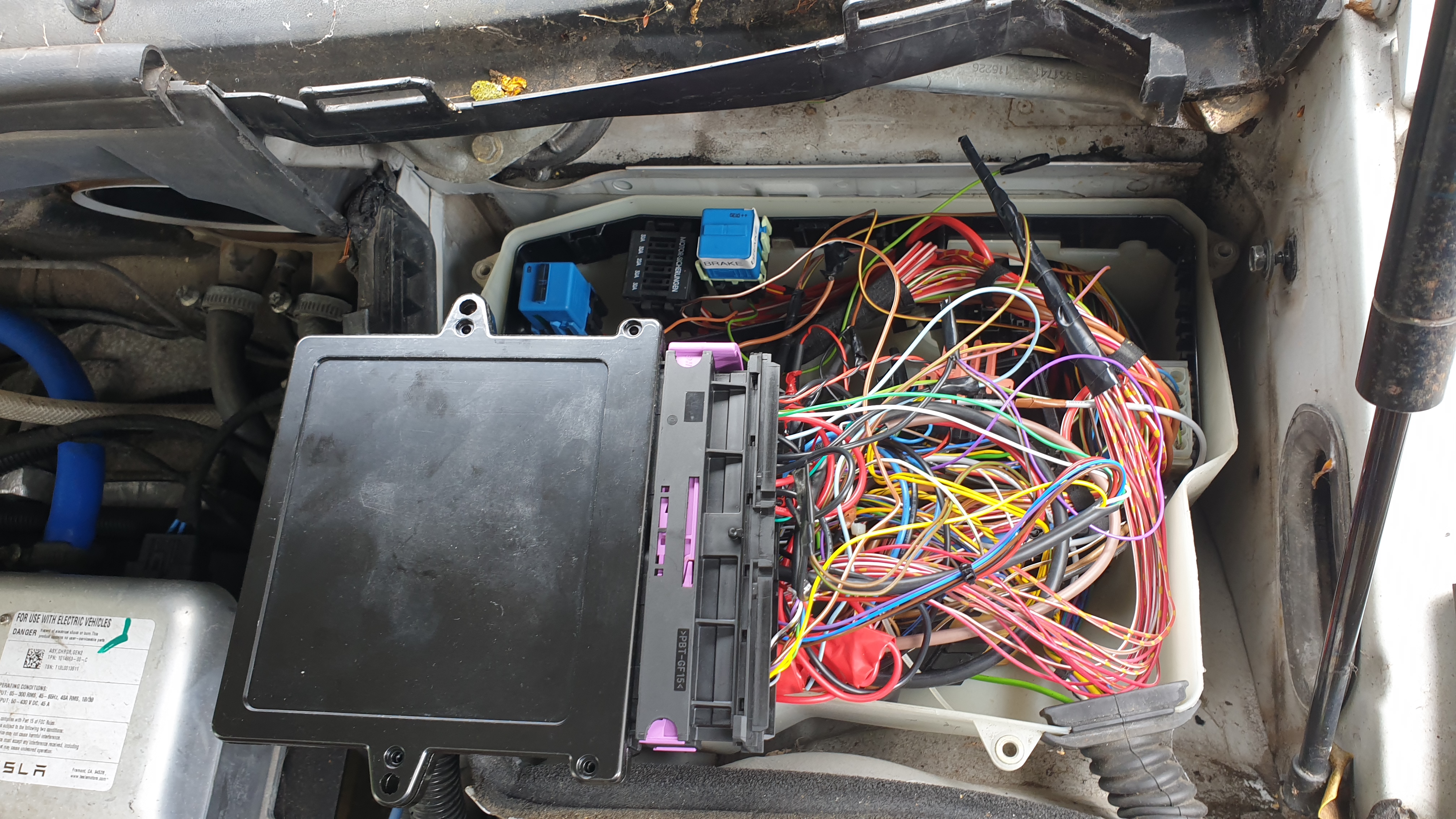

E39 install in progress. I have to say the connector is really nice to work with.

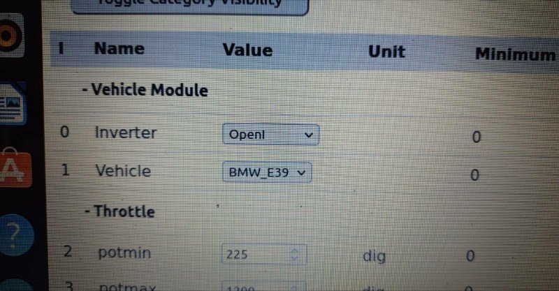

Basic OpenInverter class now working in the VCU for control via CAN. Also E39 vehicle integration going well. I'm saddened that more folks don't see the benefits of this project and contribute but I'll just fumble along.
I'm looking forward to try ZombieVerter with Outlander front transaxle to, but I'm a copy-past coder, so still waiting. )

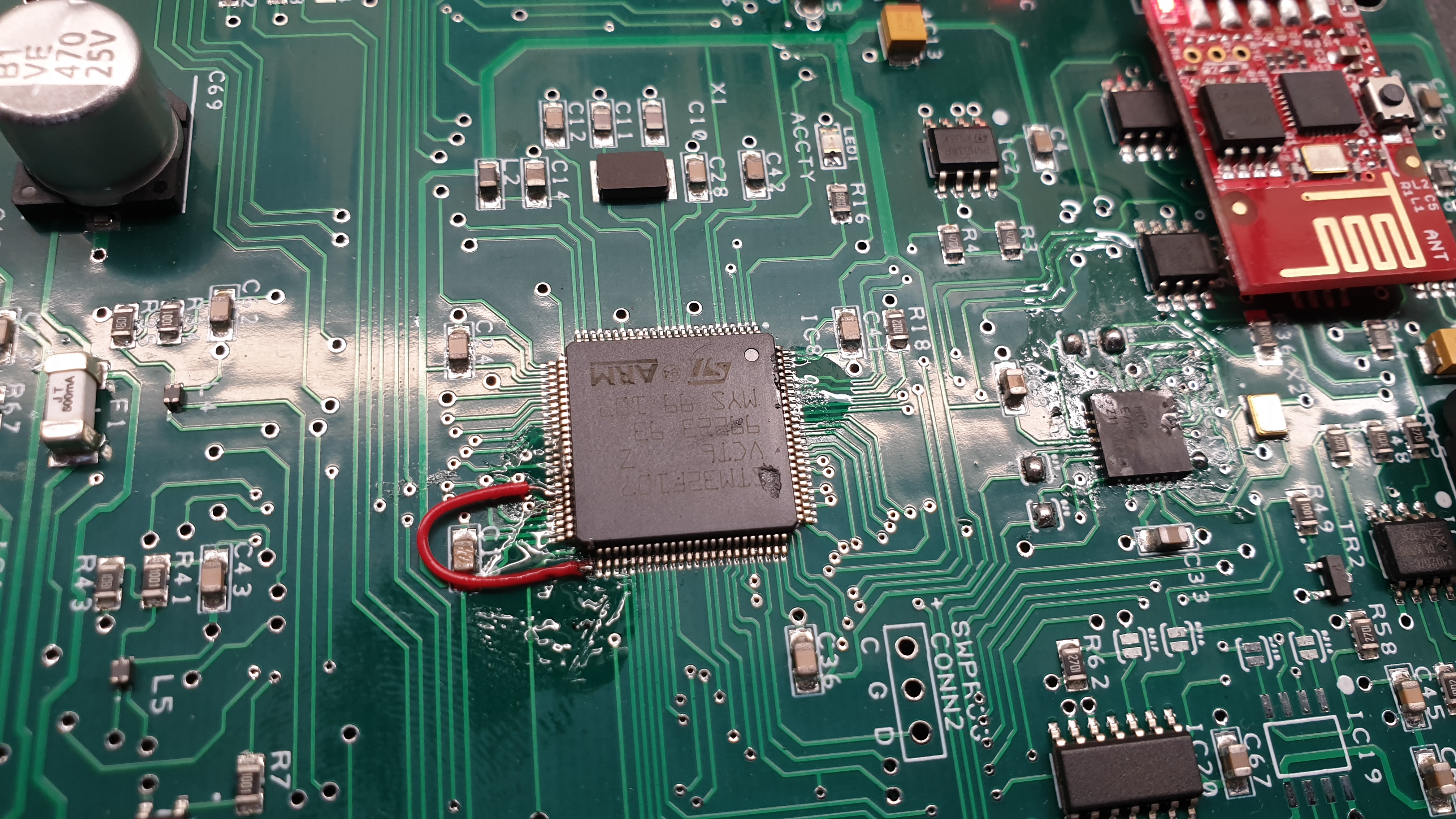

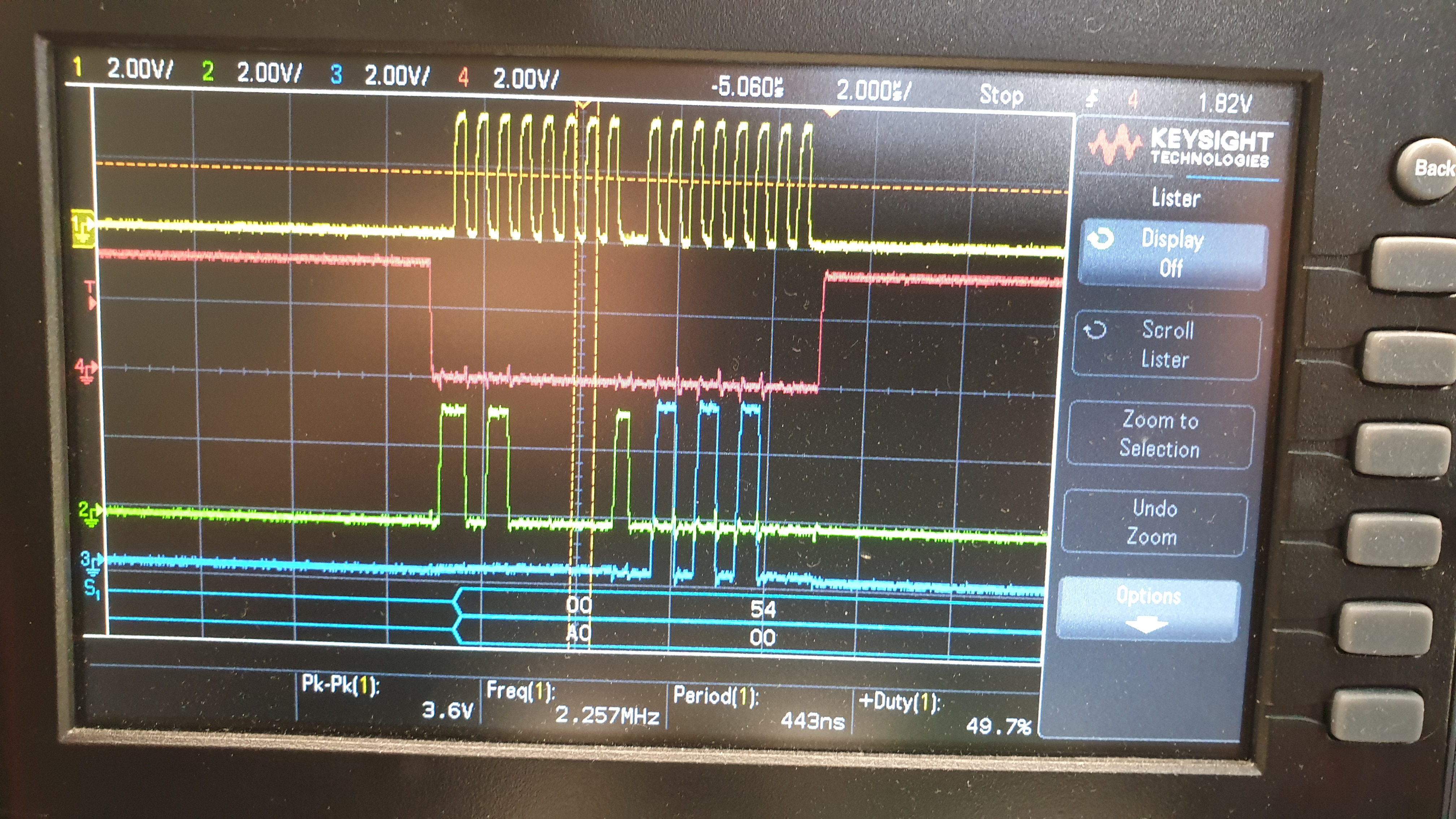

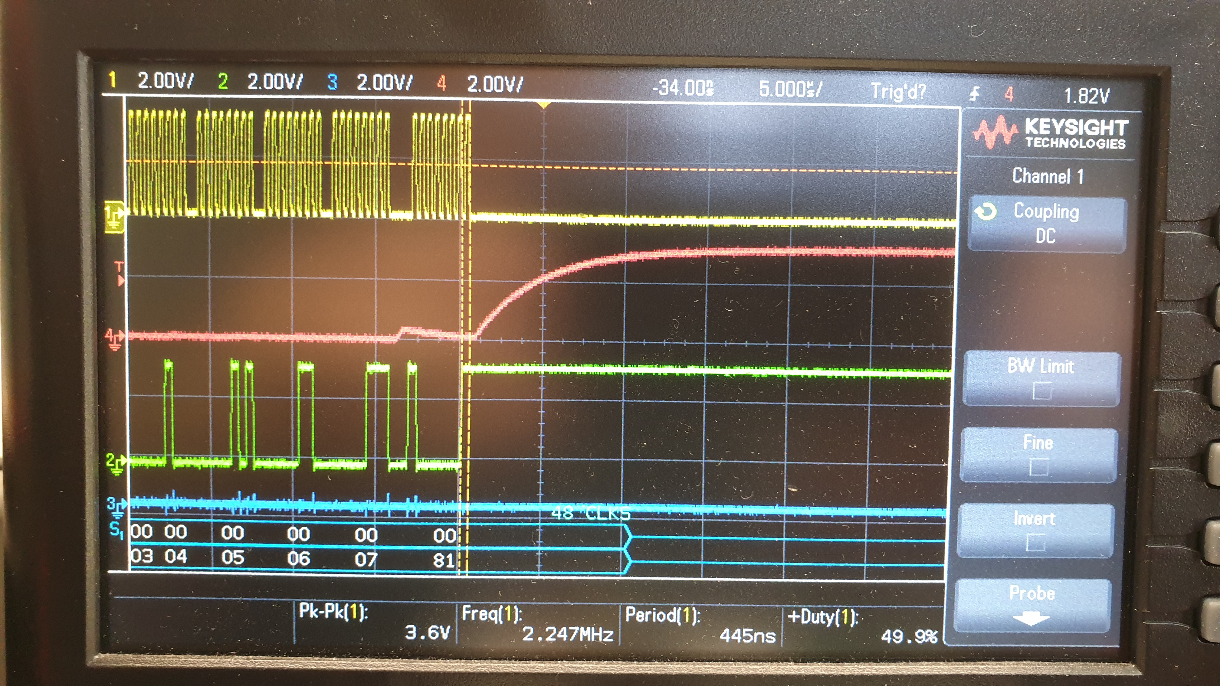

Well good news is CAN 3 is up and running via the MCP25625. I modified the microchip libraries to work with libopencm3 and learned about lots of fun things like anonymous structs being a bad idea. Of course it didnt work. 3 days of investigation led to a number of software bugs in my library (who knew!) and a very weird little problem with the STM32. When I designed the board I used the hardware chip select pin(PB12) for SPI2 as the CS input to the MCP25625. I mean that makes sense right? Well PB12 doesn't like to work. At all. Kinda like a lazy teenager on a sunday morning. Ask it to get up to 3.3v and it takes all day (20us). Likewise on the return to 0v. Doesnt matter how its configured. Doesnt matter whether we use hardware CS or toggle it in software. Even a 10k resistor to 3.3v or gnd is enough to keep it from changing state. So I ran a bodge wire from PE13 to the CS and Voila! instant CAN3 action.
It's all good though. I get it now. Why do this kind of thing when its more fun to just watch me stumble around in the dark like the moron I am.
That's really strange, is there limited drive capabilities on that pin or something? sounds like a very weak drive capability. I've been caught out similar with the STM32, where the RTC structure wasn't being zero'd correctly, prior to initialising the clock, hence it could re-configure an i/o pin as the clock out pin, but it was the chip select for an SD card. So the report from the field was that the SD storage was not working on some units.

Fixed it. libopeninverter was making the pin an input as pb12 is used as CAN2Rx in non remapped mode. Even though I was using CAN2 in remapped mode on PB5 and PB6 the library was still making PB12 an input! So no need for any hardware mods.
