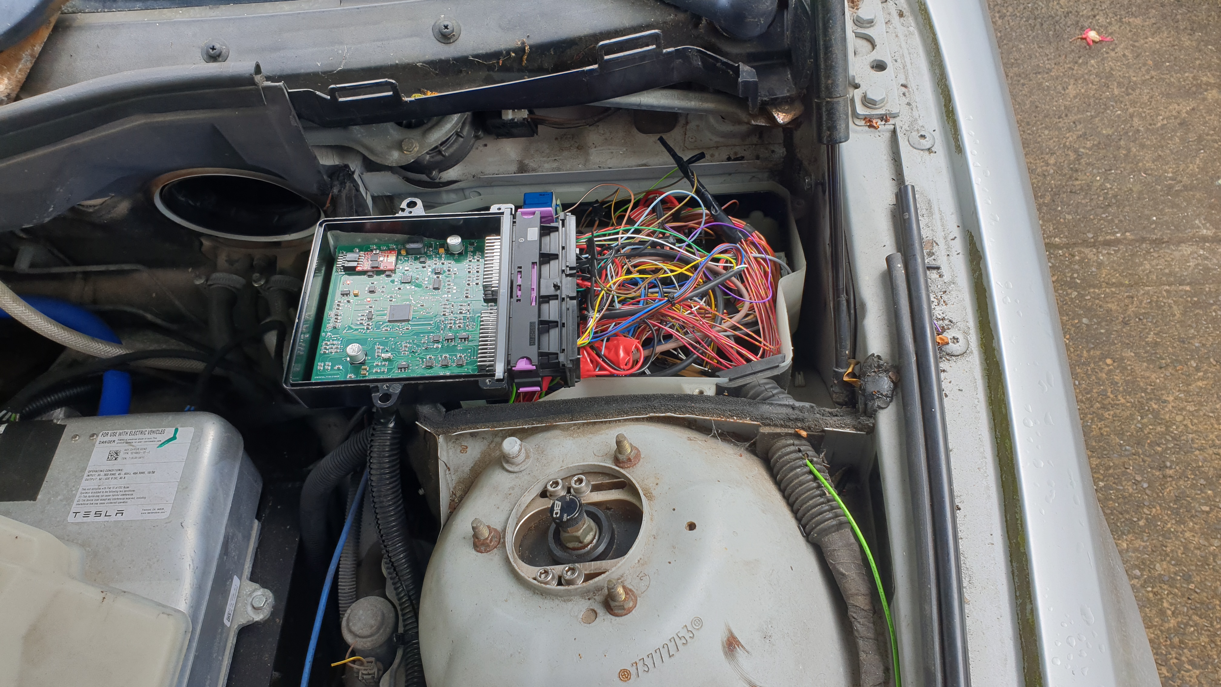

E39 install in progress. I have to say the connector is really nice to work with.
