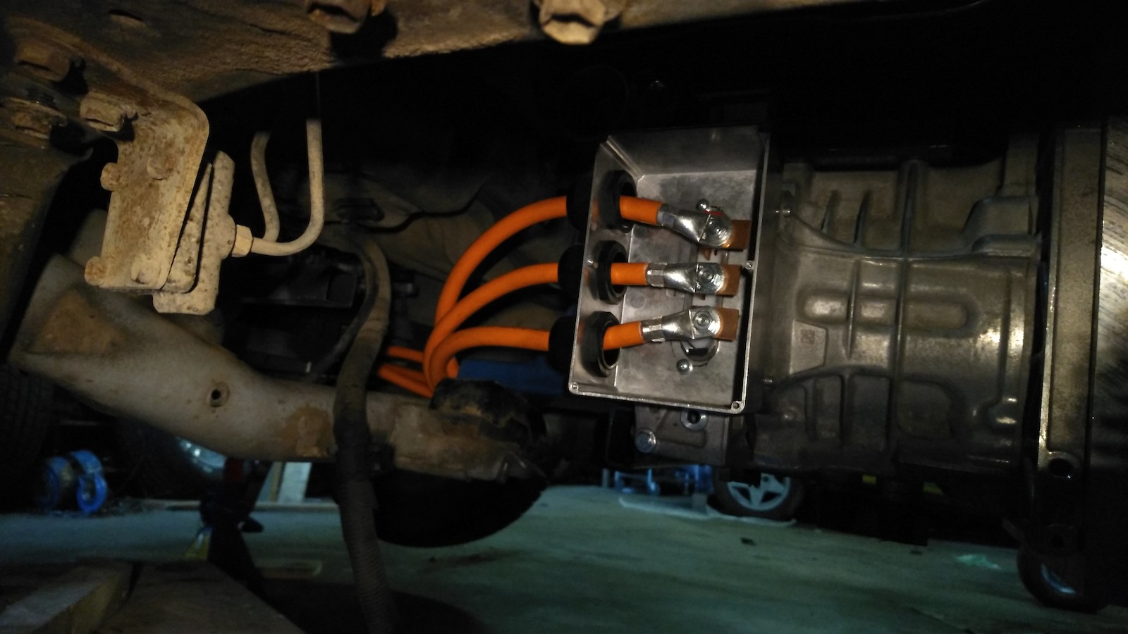

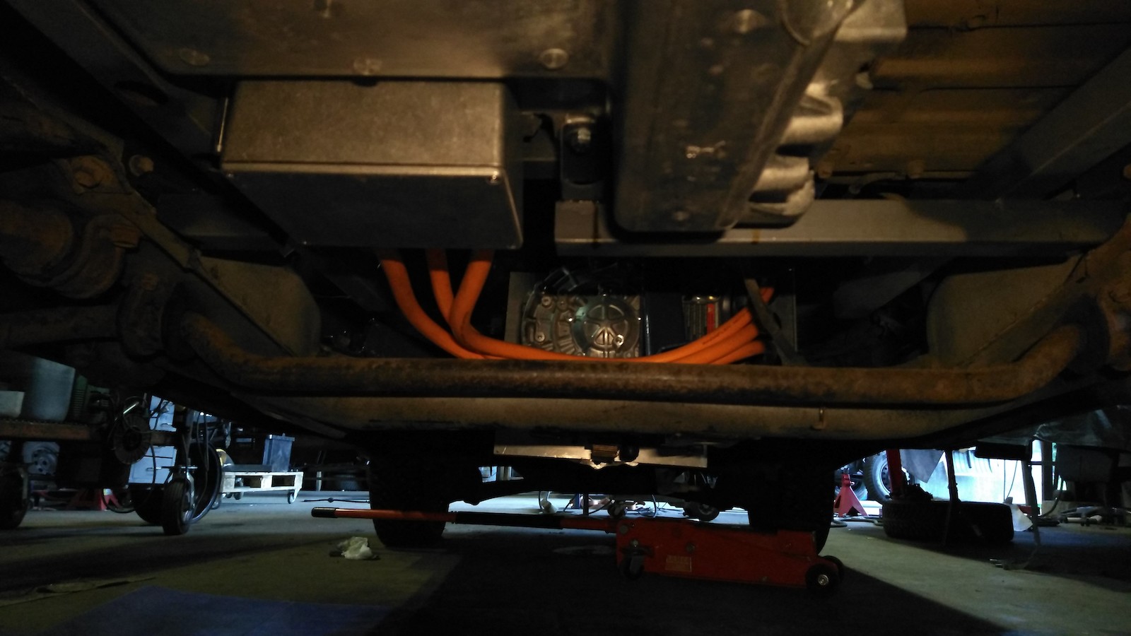

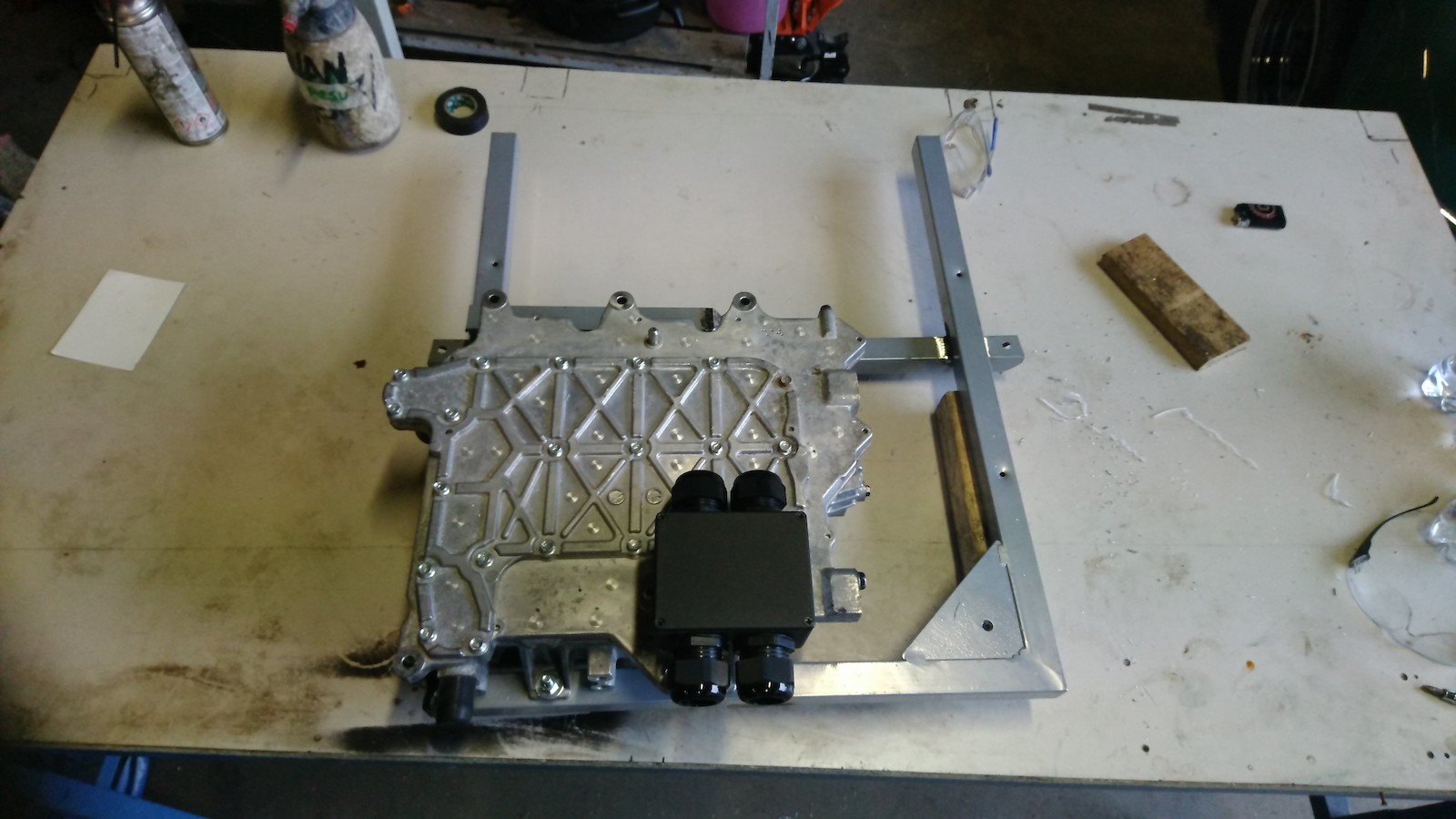

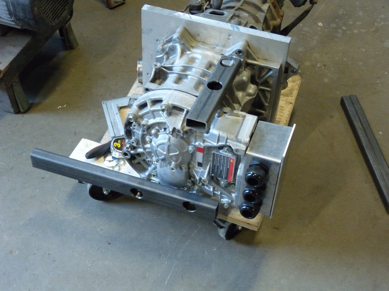

I did that in mine. Note that I did add some cable protector and proper cable mounts and I would recommend a ground sleeve/mesh for the motor phase cables for EMI reasons, it's on my late to-do list. As for the PDM, it has cables already, just cover the extra holes you aren't using.

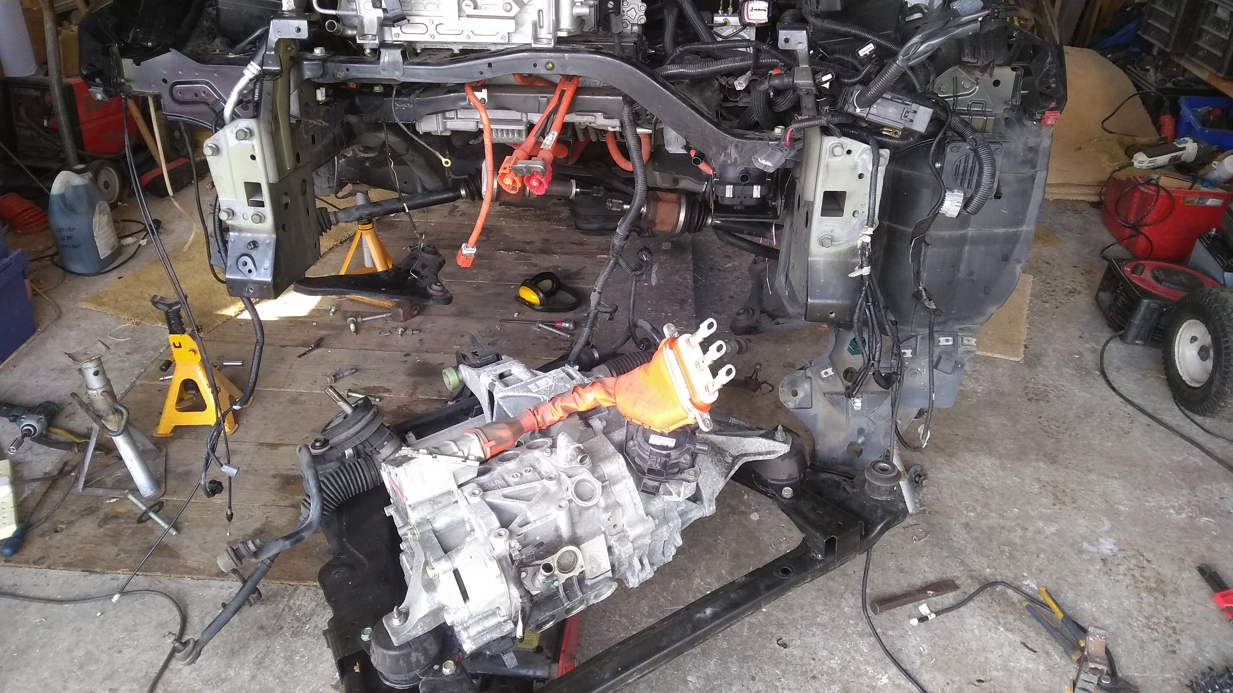

If you get the Mk1 Leaf motor and inverter they are already separated. The leads are around 30cm long.

This my the motor removed from the donor Leaf and you can see the Inverter lead on the top.
