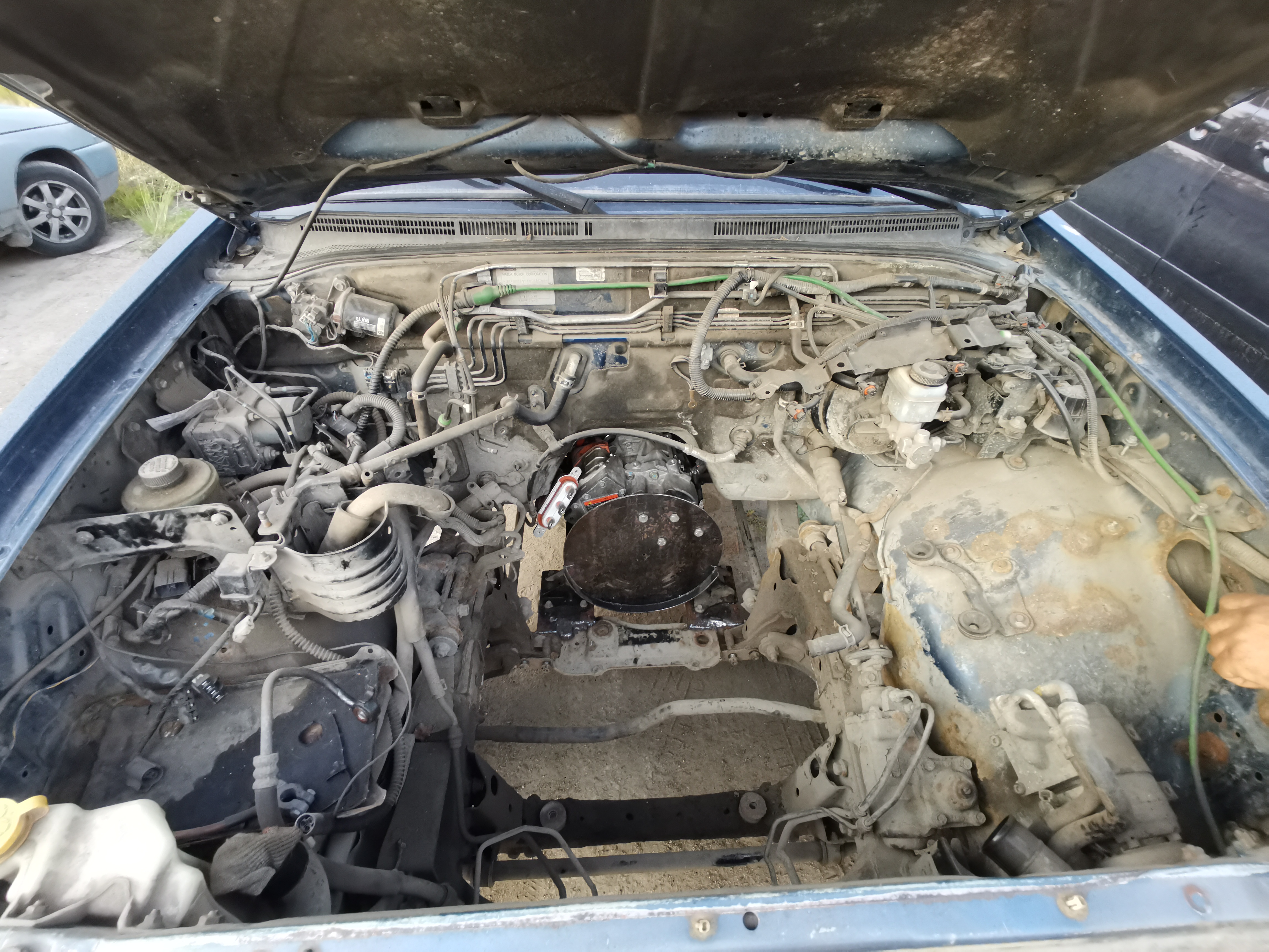

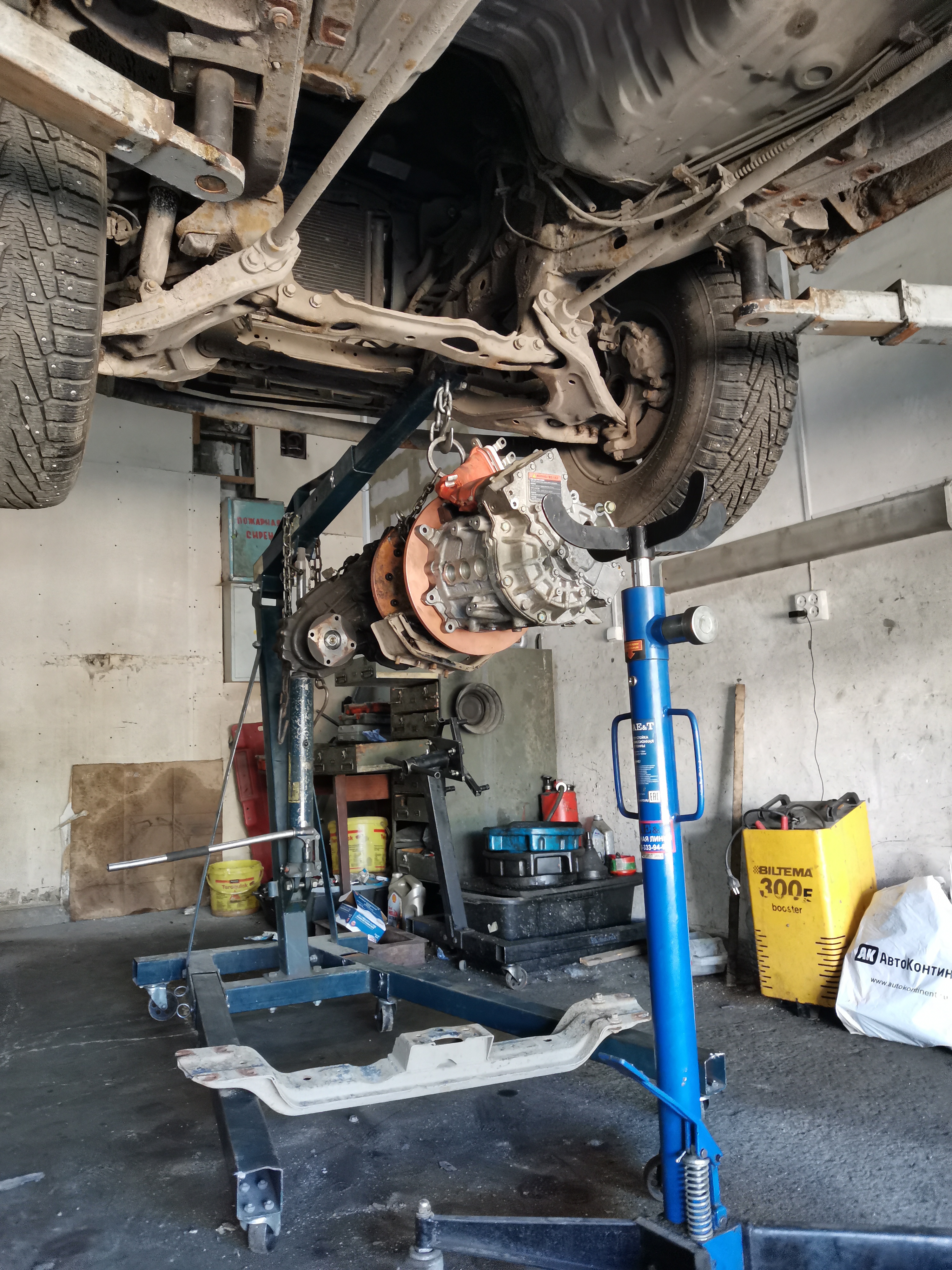

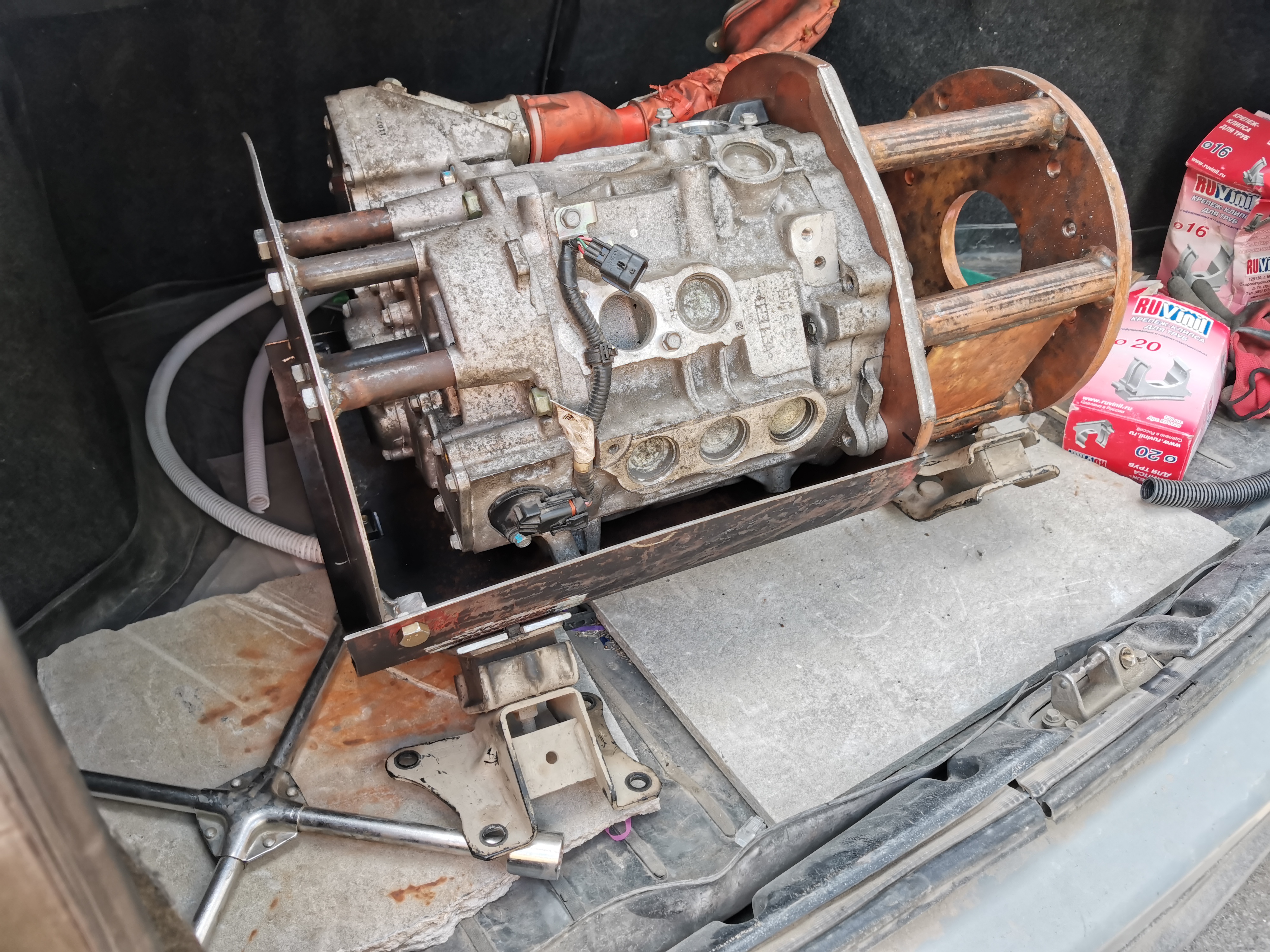

I have a MAZDA BT-50, in which I installed the EM-61 engine.
It was difficult in our small town, but I managed it.

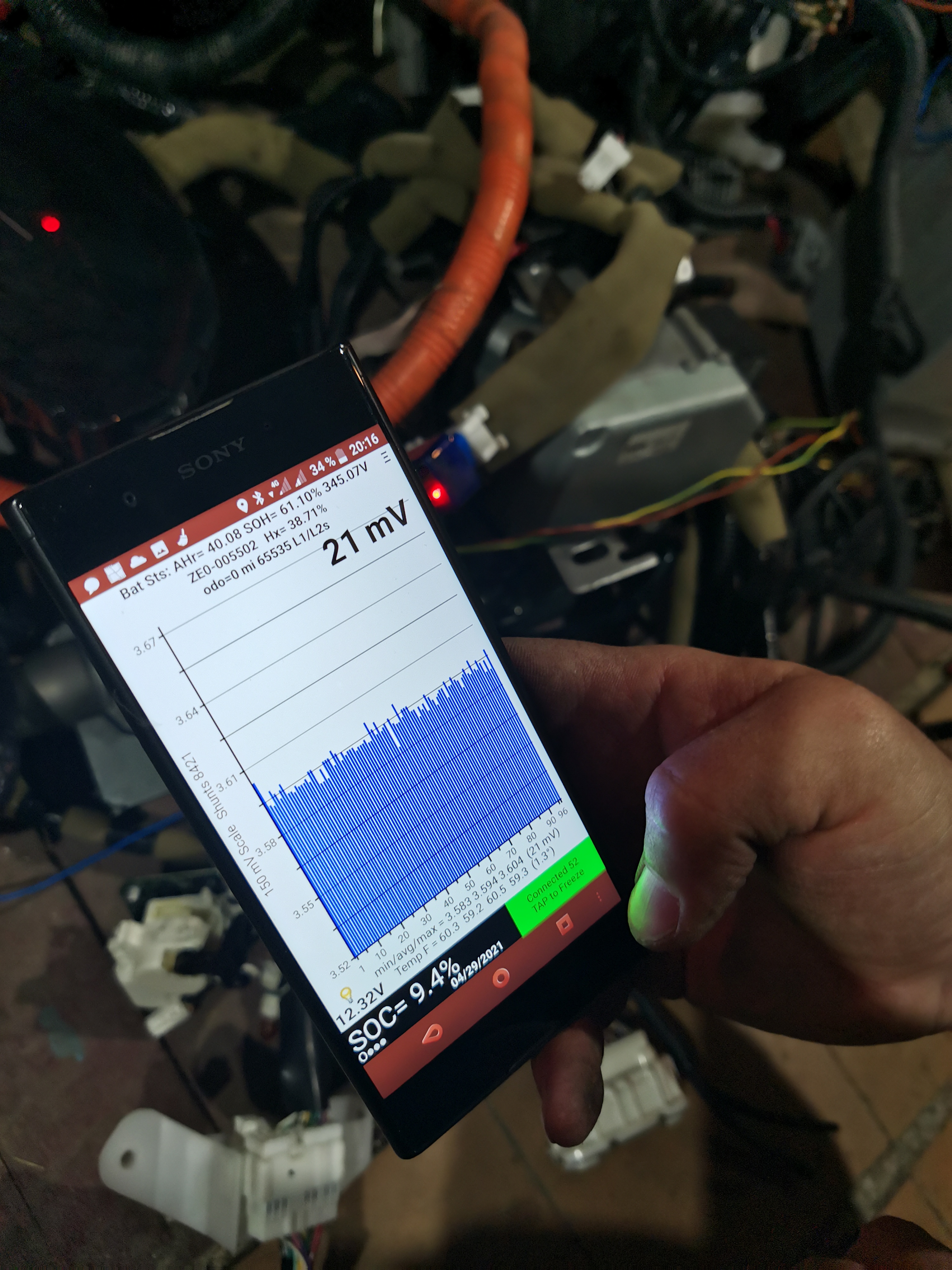

I have all the components from the 1st generation NISSAN LEAF:
BMS
Invertor
Electric motor
Charging unit
There is a desire to purchase ZombieVerter VCU
Please tell me if I can use the ZombieVerter VCU to control all components from the 1st generation NISSAN LEAF?
Or can it only control the motor and inverter?

The Zombieverter vcu can control leaf gen1 inverter and motor but no charger. It can control the GEN2 full stack and am wotking on GEN3. Hope that helps.
