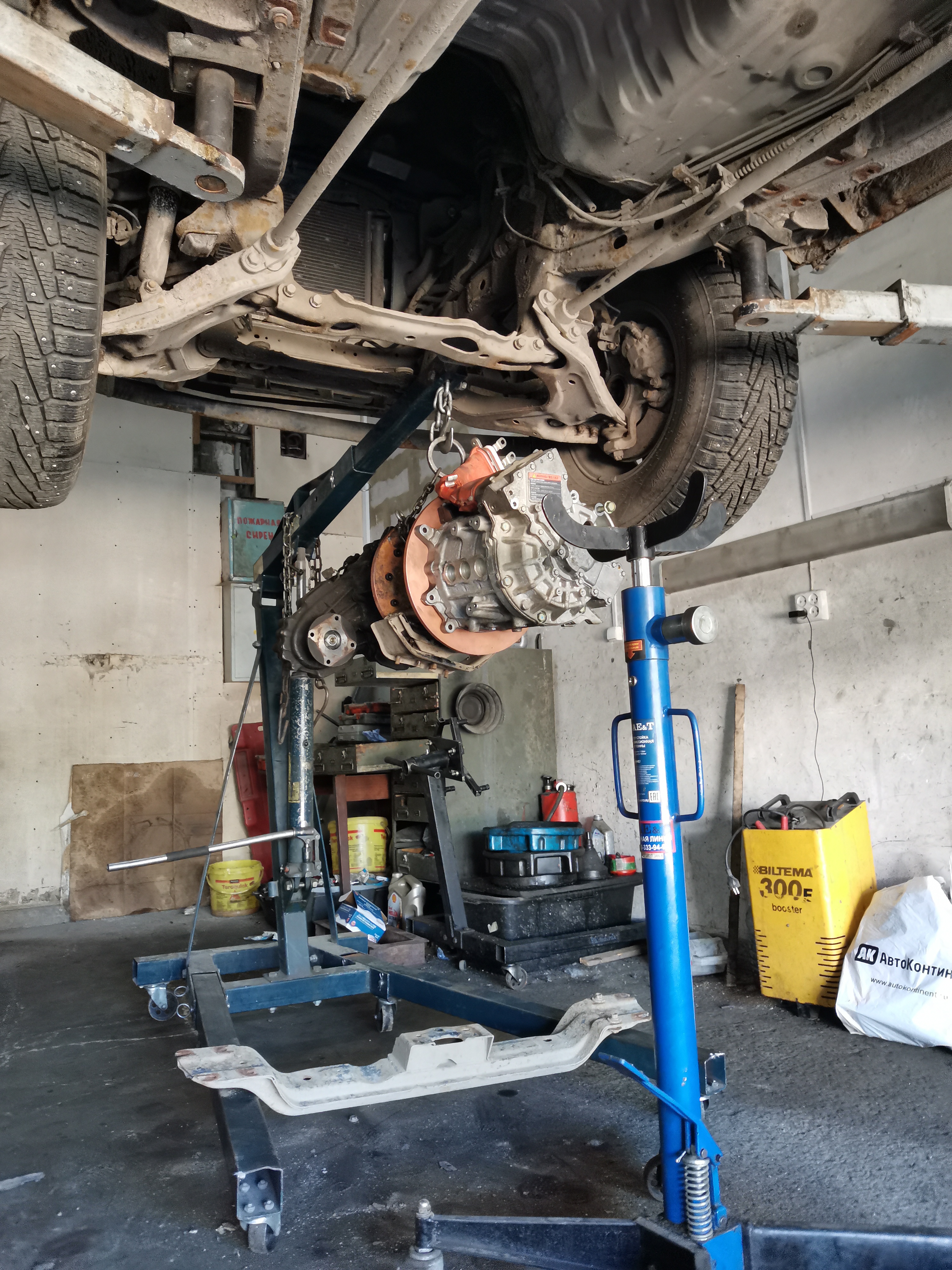

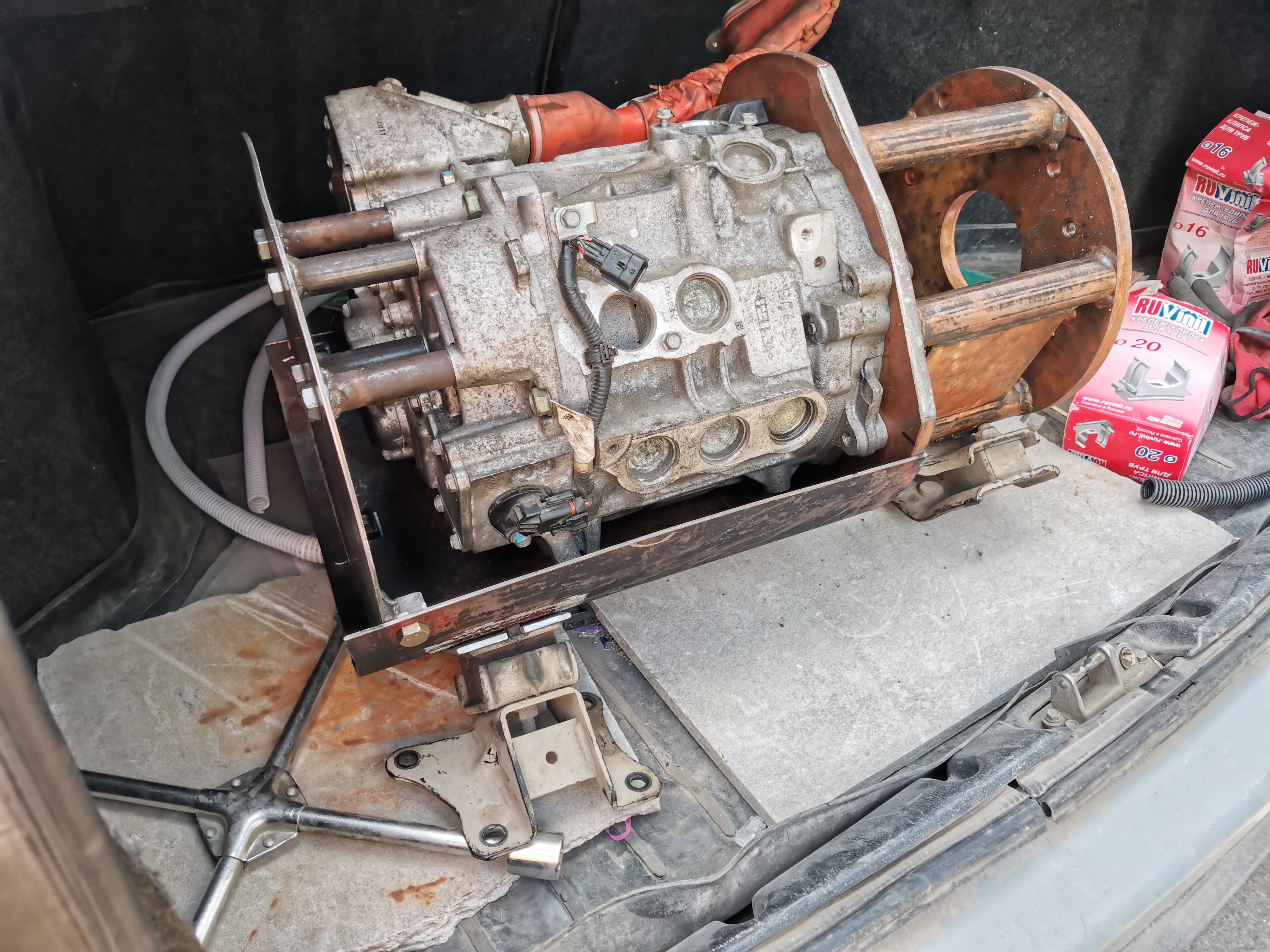

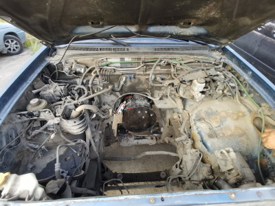

I have a MAZDA BT-50, in which I installed the EM-61 engine.
It was difficult in our small town, but I managed it.

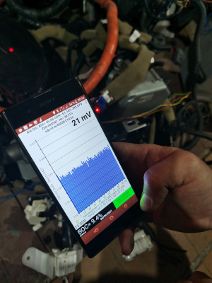

I have all the components from the 1st generation NISSAN LEAF:
BMS
Invertor
Electric motor
Charging unit
There is a desire to purchase ZombieVerter VCU
Please tell me if I can use the ZombieVerter VCU to control all components from the 1st generation NISSAN LEAF?
Or can it only control the motor and inverter?
