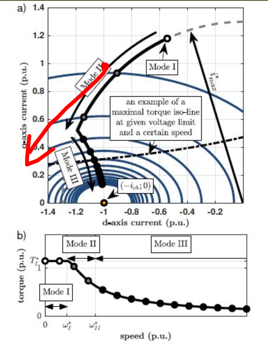

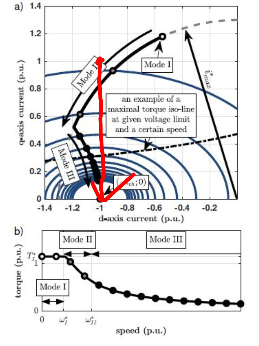

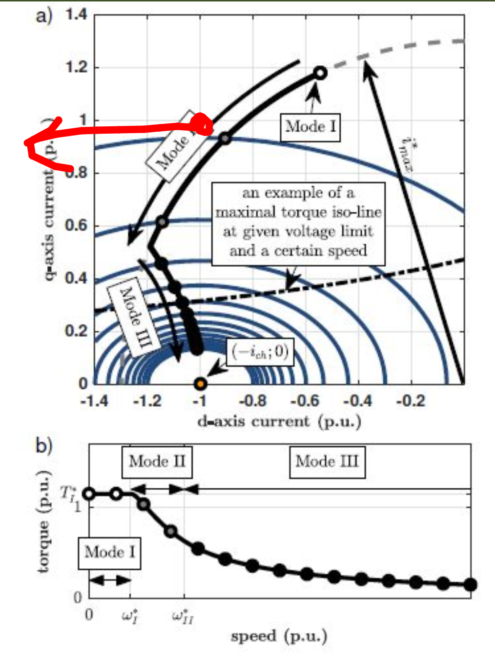

Under the assumption T_ref is the pedal input, I don't understand the Im = max(). To me it makes more sens min(), otherwise max current all the time??
I'm back to thinking Imax is a constant. The pedal input adjusts MTPA and when it no longer can deliver the torque requested depending on current and speed the VCLMT takes over and supplies as much torque that is possible for given speed. If the driver decreses the pedal input, i.e. request less torque, the MTPA might be back in action, limiting the torque output. Under the assumption T_ref is the pedal input, I don't understand the Im = max(). To me it makes more sens min(), otherwise max current all the time??

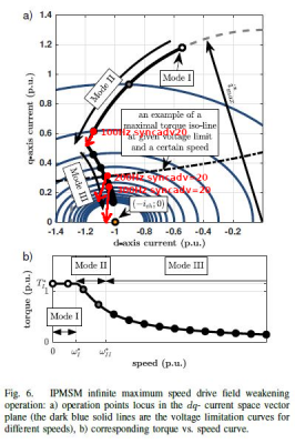

While doing the research on it, I stumbled on this 2017 paper, and while I do not understand more than the general idea, it appears to be relevant.
https://mplab.ee.columbia.edu/sites/def ... ao2017.pdf

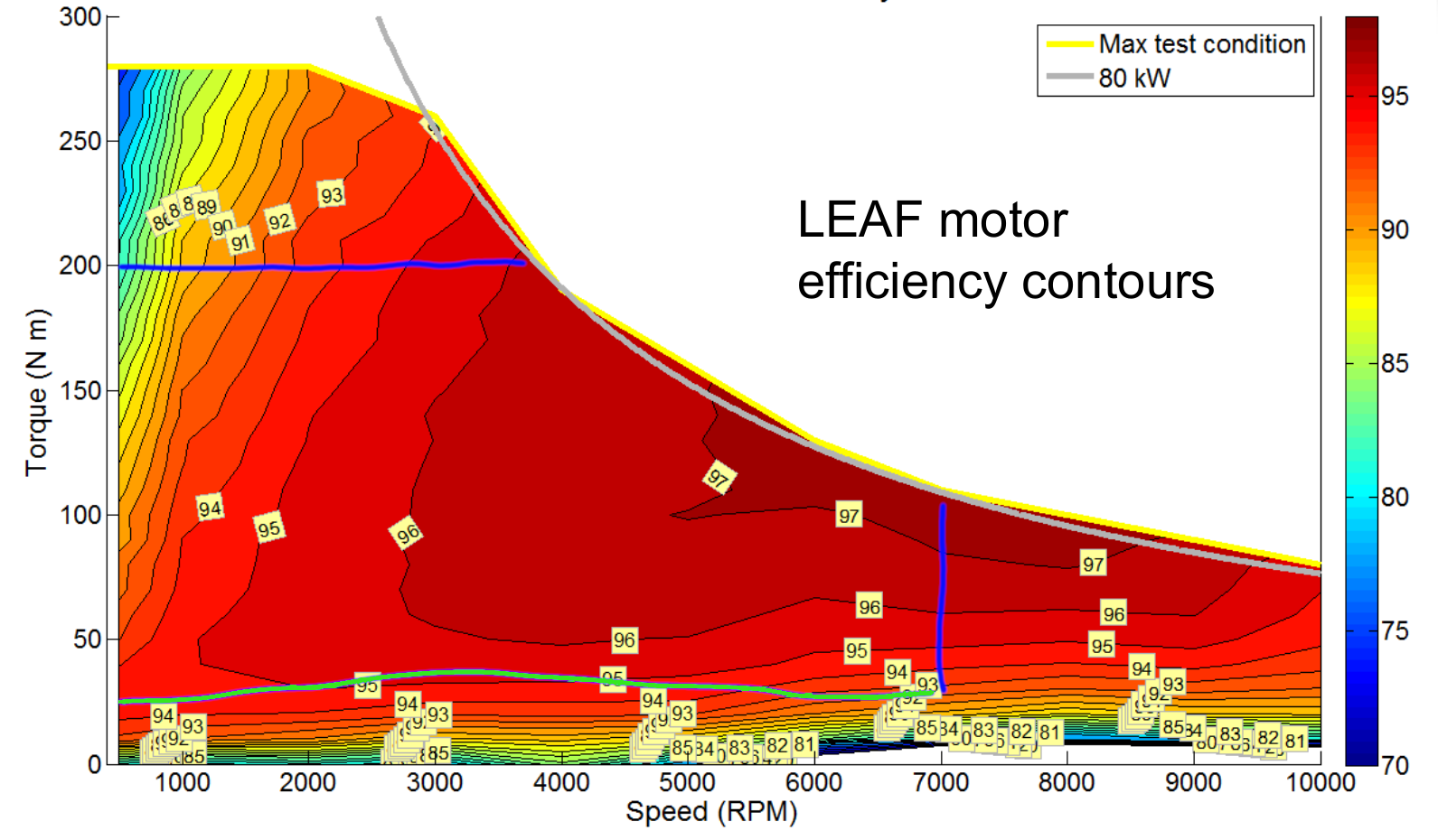

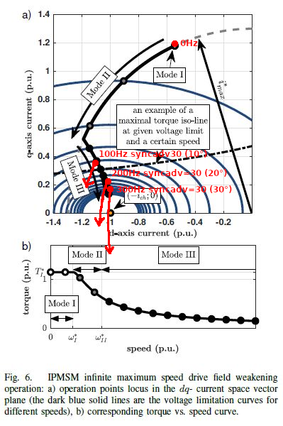

Some reasoning to justify my theory.
Motor torque vs speed (Nissan Leaf motor) In above picture the grey 80kW line would also be the base speed of the motor.
If requesting 200Nm by applying a certain amount of pedal the MTPA will provide current distribution along the blue line up to about 3500rpm which is the base speed for this current. Above 3500rpm the request is till 200Nm but VCLMT will provide as much torque as possible using another current distribution. Then, when reaching desired speed of 7000rpm the pedal is changed to a request of 25Nm and the current distribution is back to MTPA as soon as the requested torque is below the base speed limit, roughly 110Nm @ 7000rpm.
The VCLMT will provide as much torque as it can independent on the throttle position but it will only command current above base speed so as soon as the requested torque is below base speed the MTPA is back in control providing pedal controlled torque.
At this point it makes sens to me.

That looks very promising. So with that reference current regime the field weakening controller would be no longer needed as MTPV provides sufficient field weakening current anyway. On the downside we would need parameters for flux linkage, Ld and Lq. Maybe with some sane defaults tuning can be kept to a minimum.

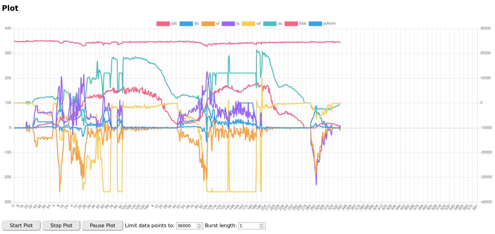

I did my first test drive moving the Previa around with the MGR. Here's the graph. I haven't found anything unexpected there yet.
The tire circumference is about 2075mm and the graph shows fstat peaked at about 175Hz. This means my speed peaked at 47km/h. (4 polepairs, 6.9:1 gearing)
It does look like ud is maxing out so it's running out of voltage, which is as expected.
At the middle of the graph I was driving up a hill (the one I coasted down a bit earlier in the graph) and you can see even while the motor drive was maxing out the speed dropped about 5km/h. This is not surprising as the motor was accepting only about 8kW. I have measured I need about 9kW to move the other Previa at a steady 50km/h on a level gravel road, so this all checks out.
EDIT: My plan is to try the throtid/throtiq firmware next. Once I have reasonable acceleration I'll try going on the highway, but I'll have to figure out battery management and charging before that.

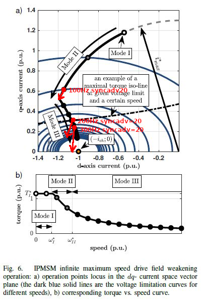

The plan: I think the syncadv trick is doing something like this: And the FW controller is trying to do something like this: The cross reference: viewtopic.php?p=32535#p32535

I'm trying to beat myself in my syncadv game using a custom frequency-dependent MTPA function like this. Not much luck so far. Still needs syncadv to perform well, which is a mystery to me. I'm also disabling the FW controller because it's so uncontrollable and that's unacceptable for tests. Attached also some drawings that probably mostly show I'm descending into complete madness.
What I think I'm doing is trying to hunt the sweet FW spot where the motor is getting exactly the right amount of id, not too much and not too little, to most effectively weaken the field, and I think I'm not hitting it. I'm trying to figure out where I might actually be in relation to that spot, but no luck so far. It's a 3-dimensional space with id, iq and frq and I really only can figure out the average torque at a single squiggly line per each breakneck run through the woods.
And I don't even know if the inverter is actually doing what it says - the way syncadv is affecting everything in ways I can't otherwise recreate isn't reassuring at all. It's like there's a physical delay somewhere that we don't know about.
I wish I had a dyno. Maybe I need to make one. EDIT: ...well, if someone sponsors me 2 more MGRs, I'll weld them locked and connect the flanges. Then I can drive one and use the other as a load.

I have the vehicle on jackstands with the wheels off now. If needed, I can try any code as long as you promise fmax works.
My plan is to first try to smooth it out - the code and settings it's currently running are absolutely terrible above about 50Hz. In fact that's why I removed the wheels: It felt like I wasn't going to have any splines left in my wheel hubs after testing. Looks like the only reason it felt stable at 80km/h was because it couldn't maintain speed without full throttle.

In today's testing it looks like a high fwkp is absolutely necessary for reasonably smooth operation. The critical speed above which the field weakening controller is needed is 150Hz. My code edits don't affect the smoothness really at all - it's all terrible without using the field weakening controller at high gain.
- Posts: 6709
- Has thanked: 368 times
- Been thanked: 1536 times
Re: Halved current during field weakening
How high is your gain?
Forgot to comment and that code above, it seems to try and restrict modulation to 95% by increasing id. It's a thought I had way back but thought it was stupid. Will try and implement that and have some of you masochistic guinea pigs try it

Who exactly do you mean???johu wrote: ↑Sat Oct 16, 2021 6:31 pm How high is your gain?
Forgot to comment and that code above, it seems to try and restrict modulation to 95% by increasing id. It's a thought I had way back but thought it was stupid. Will try and implement that and have some of you masochistic guinea pigs try it![]()

I tried fwkp=300 and it seemed ok but not perfect. Of course no load behavior can also be completely different to full load behavior.
However my CV axle flew off and I had to pause testing. Will get back to it of course once I get my axle sorted.
