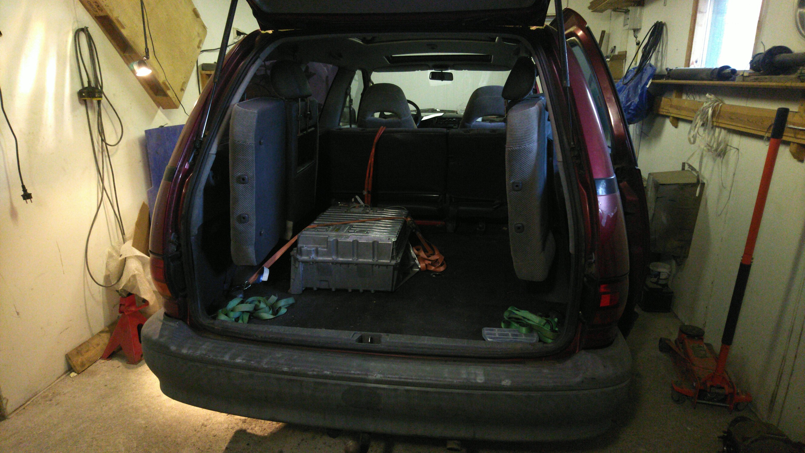

1993 Toyota Previa, 8-seater
Q211 MGR

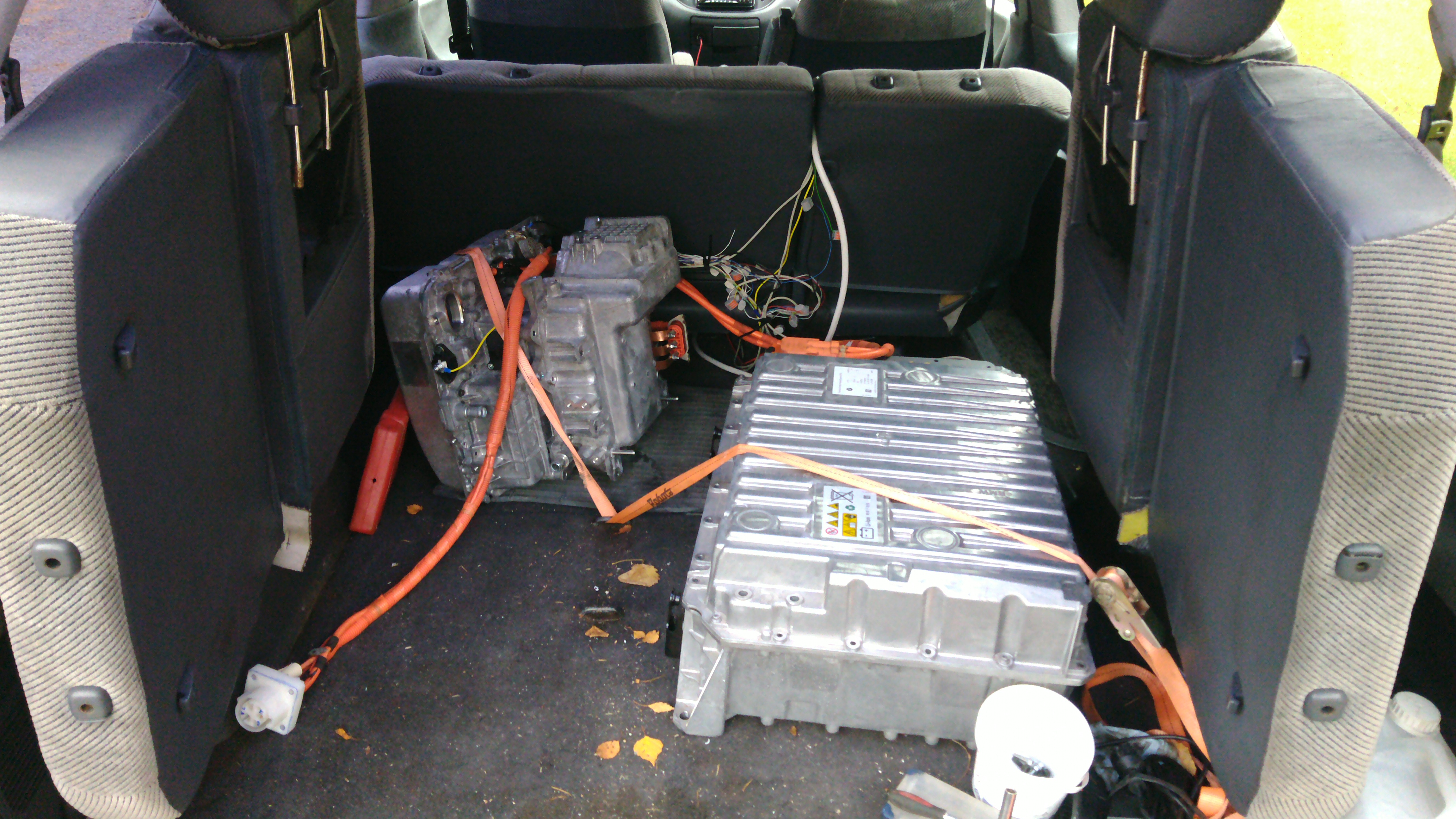

Leaf gen2 inverter with a custom openinverter board with lots of bodges
BMW X5 plug-in hybrid batteries
Yes, of course it has the full ICE system in and operational still. Just no propshaft...
Yes, the plastic spline adapters broke. But only after going back and forth at full throttle for more than 10 times.
Will order metal 3d printed ones.
There is no throttle pedal, charger, dc-dc, electric brake or steering assist yet. Only the MGR has bolts holding it down. Or more like up.
Q211 MGR

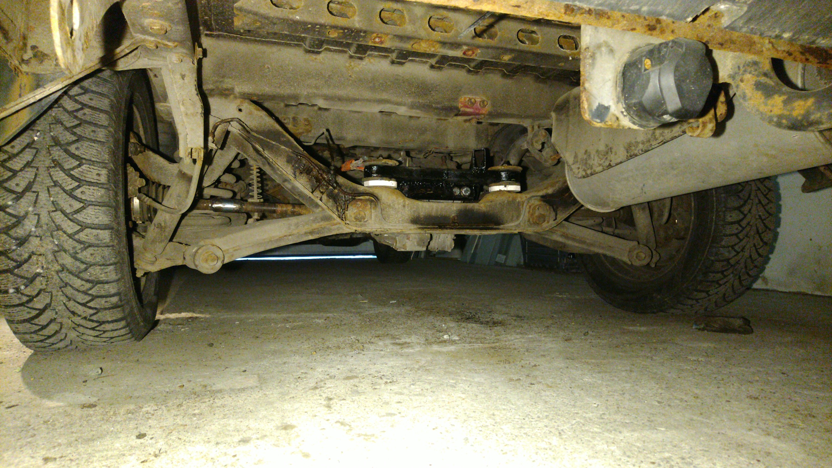

I had the battery, inverter and motor already wired up and configured since I did the torque tests in January. What I did in 5 days was remove the diff, mount the MGR and modify one driveshaft that was from a non-hybrid Lexus RX. And then jacked the battery inside and pulled the wires through the motor cover under the driver's seat.
I have to say, "removing the diff" sounds easy, until you realize the diff and the surrounding components, mounts and also the driveshafts last literally forever, i.e. they have been never touched since it left the factory almost 30 years ago. Took some elbow grease.

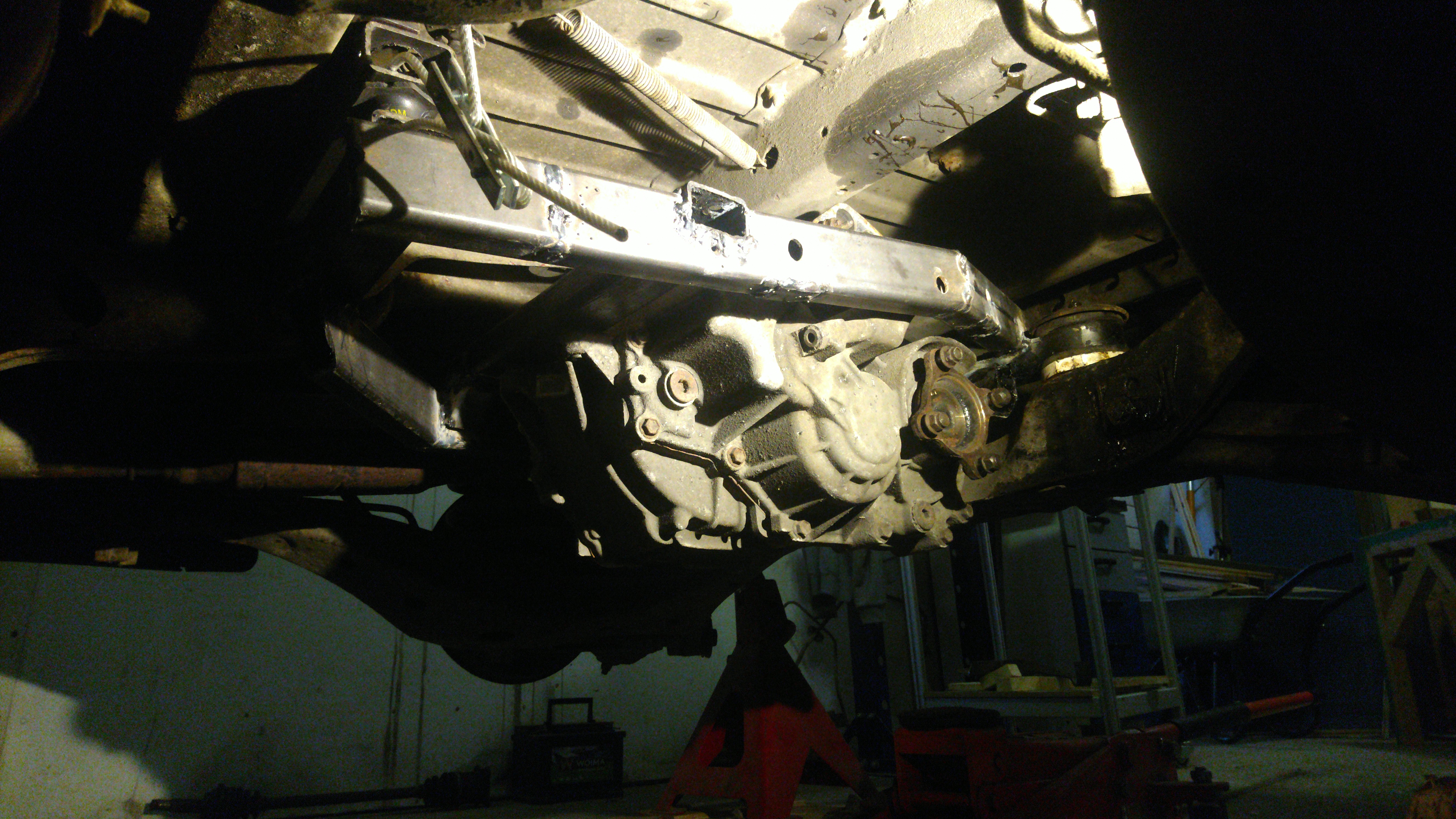

A multitude of problems, including my temporary MGR mount breaking almost immediately, causing it to move downwards and to the right, and the position of the MGR being too low (due to space constraints below the floor), causing suspension geometry to pull the shaft out too much. A slightly longer shaft could have helped but not fixed this.
I need to figure out how much I need to cut into the structural "beam" under the floor in order to get the MGR to a higher position, or whether I can move it forwards and then upwards to gain better suspension/shaft geometry.

Welded a better mount for this. Now I need to source some aluminium and try to mill bit of a spacer on the side that popped off last time.

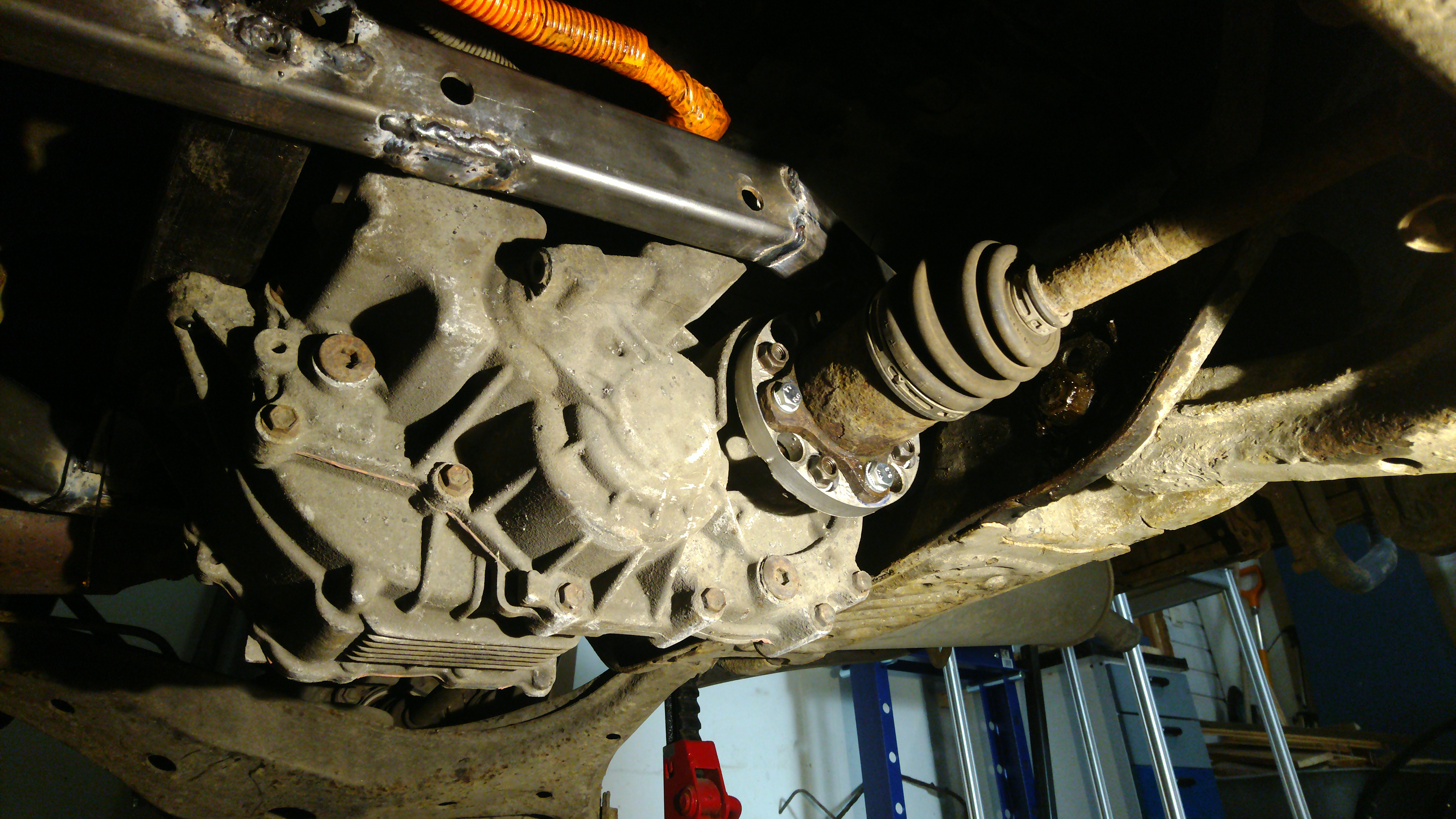

Well, it's a spacer. With a bit of luck this should last for a long time. I'm currently 3D printing a centering back piece that uses the existing hole in this piece of aluminium. I need all the height I can get from this piece, and milling aluminium is very annoying with my mini CNC.

Got the axles installed once again, will start testing soon.
I ended up pressing in steel nuts into the aluminium spacer, as I measured and calculated the aluminium threads wouldn't be able to provide enough clamping force to hold the axle in place when the motor produces its maximum torque. The aluminium threads I originally made stripped at 15Nm, which wasn't enough.
I torqued these M8 bolts to about 28Nm, which should provide about 75kN total clamping force for the 4 bolts combined, which at 50mm radius and let's say 0.4 coefficient of friction will hold 1500Nm of torque from the axle. That's enough for the MGR's 650Nm per axle. I also used Nord Lock washers so that if there is movement, coming apart will take a long time.
I also took one axle off and calculated the allowable length movement and compared to what the range caused by suspension travel was. It barely does it now, having about 10mm of range left in each direction before destruction. Adding 5mm more spacers to both sides would be a good idea, but I'll skip that for now.
Then I painted the mount yellow. In the most obnoxious way.

First test drive done, mostly just to see if it can handle some driving without exploding. It didn't explode, which is good. Now to check the log whether everything looks ok there also.
I don't think I'll find anything enlightening here, but if I do I'll probably post in the MGR FW mystery thread instead: viewtopic.php?f=7&t=1683
The tire circumference is about 2075mm and the graph shows fstat peaked at about 175Hz. This means my speed peaked at 47km/h. (4 polepairs, 6.9:1 gearing)
Well, it does look like ud is maxing out so it's running out of voltage, which is to be expected.
EDIT: I'll have to figure out battery management and charging somehow. I guess I'll port the SimpBMS BMW code to some board I have lying around and then try to cobble up a working PDM out of the PDM parts I have, and try to control that via CAN.

Holy shit, it was ready to kill me right away:
Now we know it's capable of 558 volts, eh?
This is as barebones as it gets: 9 wires coming out of the case: L, N, PE, CP, PP, CAN H, CAN L, permanent 12V, switched 12V, and the 10th wire is the grounding of the case:
Then just send the boatloads of CANbus messages Damien has jotted down in his latest ZombieVerter commits: https://github.com/damienmaguire/Stm32- ... eafinv.cpp
It doesn't even need a HV battery, it'll go ahead and charge anyway. There's a dual safety interlock in the case, but that doesn't matter either, I guess it just sends its status over CAN to the VCU which decides what to do with it. There's no voltage limit, I guess the BMS or VCU is supposed to deal with that.

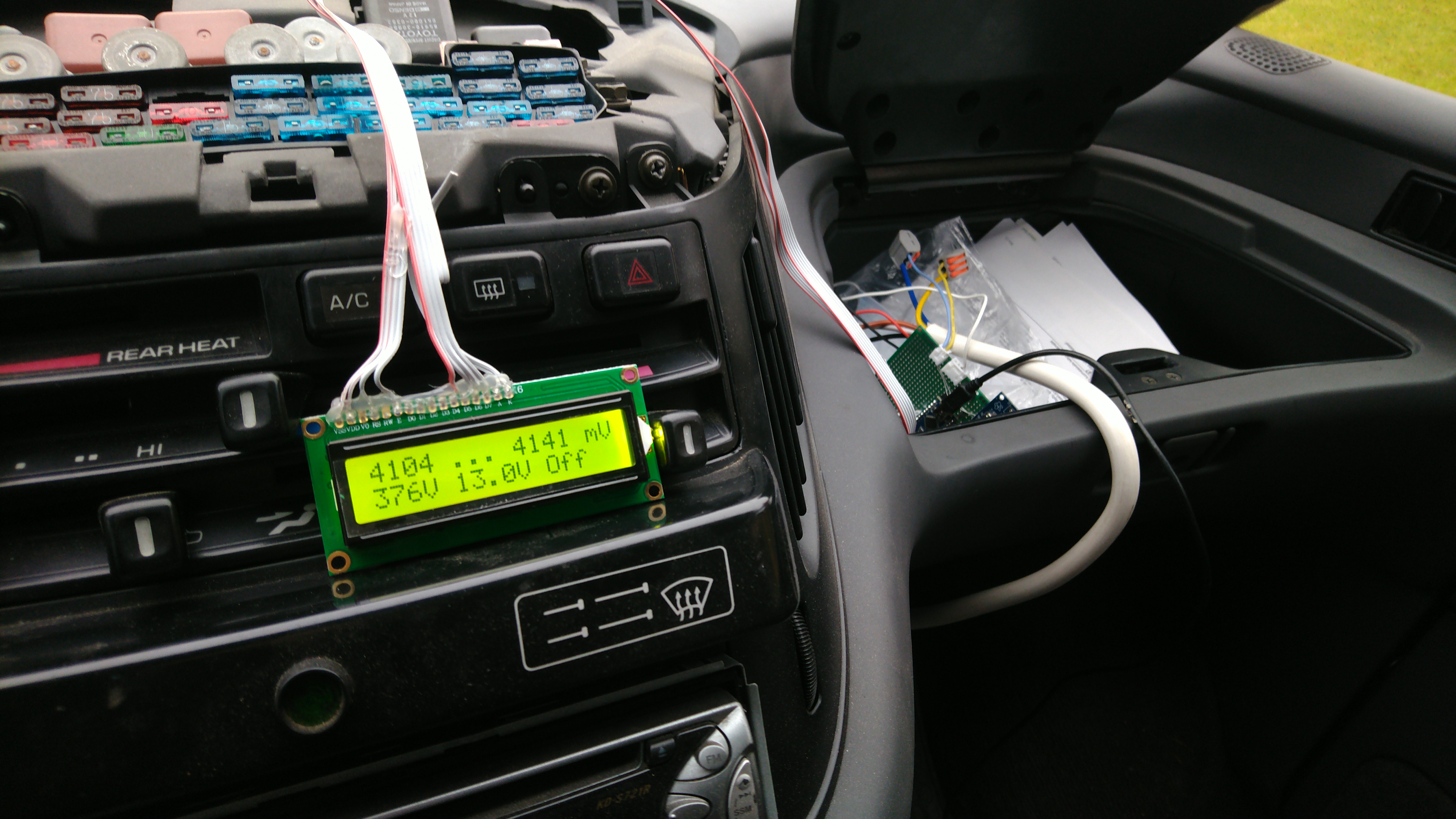

Just managed to connect the wires and program the arduino to read the module voltages and very crudely command the PDM. I'm still controlling the contactors by starting the inverter. In a couple of hours I should have a fully charged battery ready for testing. If I forget to unplug it, there's only a 10% chance it explodes.

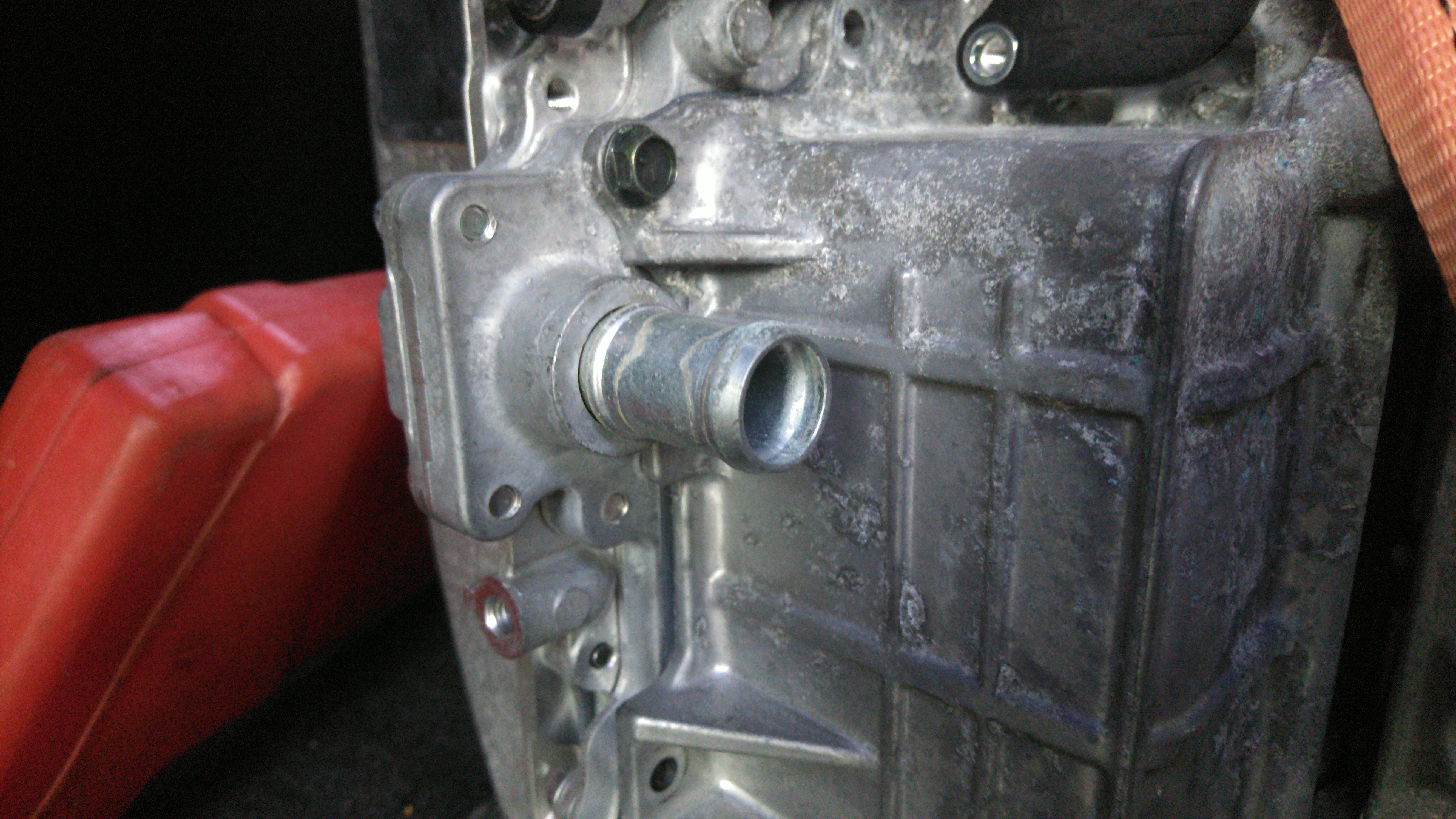

When charging the battery from halfway to full at 2kW, the charger gets so hot the crud on the aluminium starts smelling funny.
