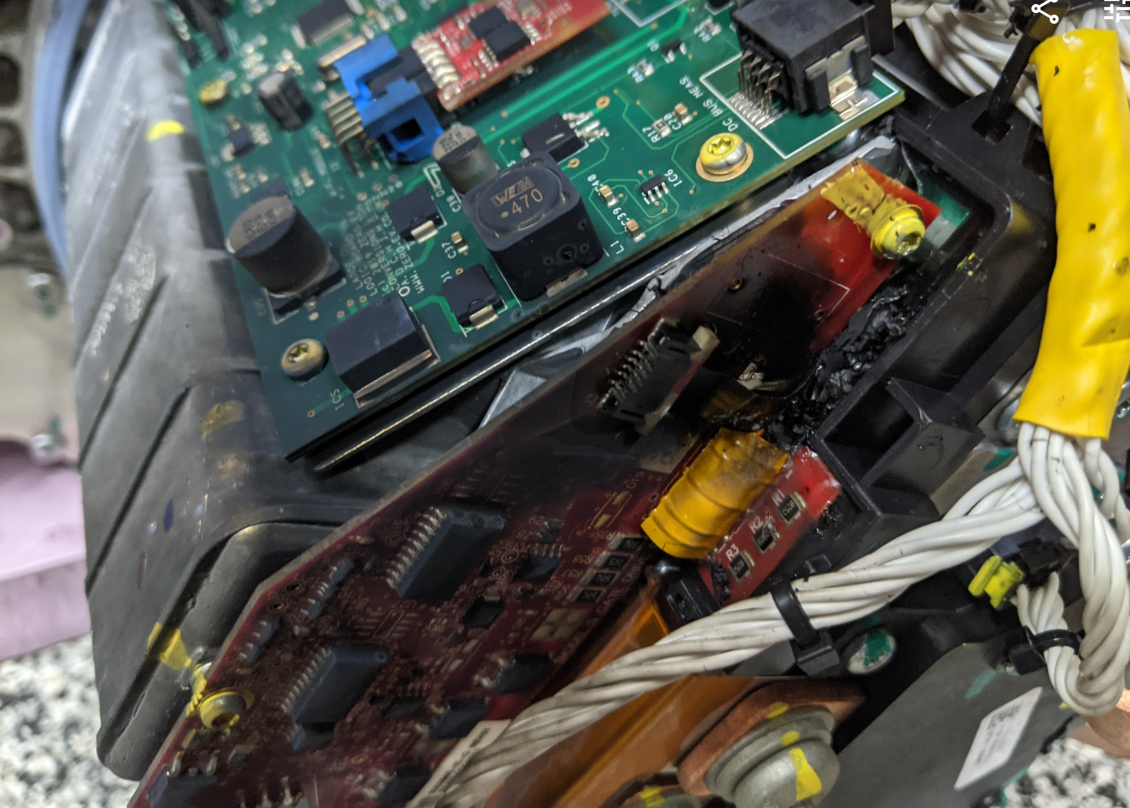

Found the smoke.
I have probably 1000 miles on the car with lots of hard acceleration. Not sure what would cause the Tesla pyro fuse to blow, it was power off regen at the time, battery cells were about 4.05 max.
Here is a picture of the inverter, the bottom phase took hit. Do you guys think this is due to the fuse blowing?
https://photos.google.com/u/0/photo/AF1 ... LexJhtllH4

MrMoparMan wrote: Sat Jul 24, 2021 4:35 am Here is a picture of the inverter, the bottom phase took hit. Do you guys think this is due to the fuse blowing?
If a LDU is spinning when the fuse blows or contactor drops out there is a large chance of irreversible damage.

Jack Bauer wrote: Sat Jul 24, 2021 6:47 am How are your contactors controlled?
Ignition on powers the pre-charge contactor, and then the DU closes the main contactor with start switch input. The BMS can shut down the ignition/DU power and contactor but it would be a total car shut down which did not happen in this case.

jon volk wrote: Sat Jul 24, 2021 3:32 pm Photos not working for anyone else?
It's probably me...Let me see if I can figure out a better way to attach them.
jon volk
Posts: 574
Location: Connecticut
Re: Dyno Tuning LDU
Post by jon volk »
Holy shit. That certainly looks like enough to blow a pyro fuse.

tom91 wrote: Sat Jul 24, 2021 11:54 am
That looks to be the case...
I think using a used Tesla pyro fuse was a bad idea. It blew at a strange time for not having any indication of a short.
