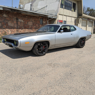

Hello, I am looking for some advice from the experts, beyond the already terrific information on this forum.
I have a newly running build and I am feeling my way through the settings. My dyno guy from my Turbo builds has offered me a free dyno day so we can learn the Inverter tuning.
I would like to approach the session with a solid plan on what to tune first, second, and so on. Any advise would be very much appreciated, thanks in advance.
The car is a 4000lb + 1972 Plymouth Satellite
LDU Sport motor with Zero EV control board
100 kWh Tesla Battery pack
Orion 2 BMS
So far the car makes decent power but I would like to safely maximize the potential with some fine tuning.
I look forward to sharing all the results and hopefully have a good base tune for similar builds.

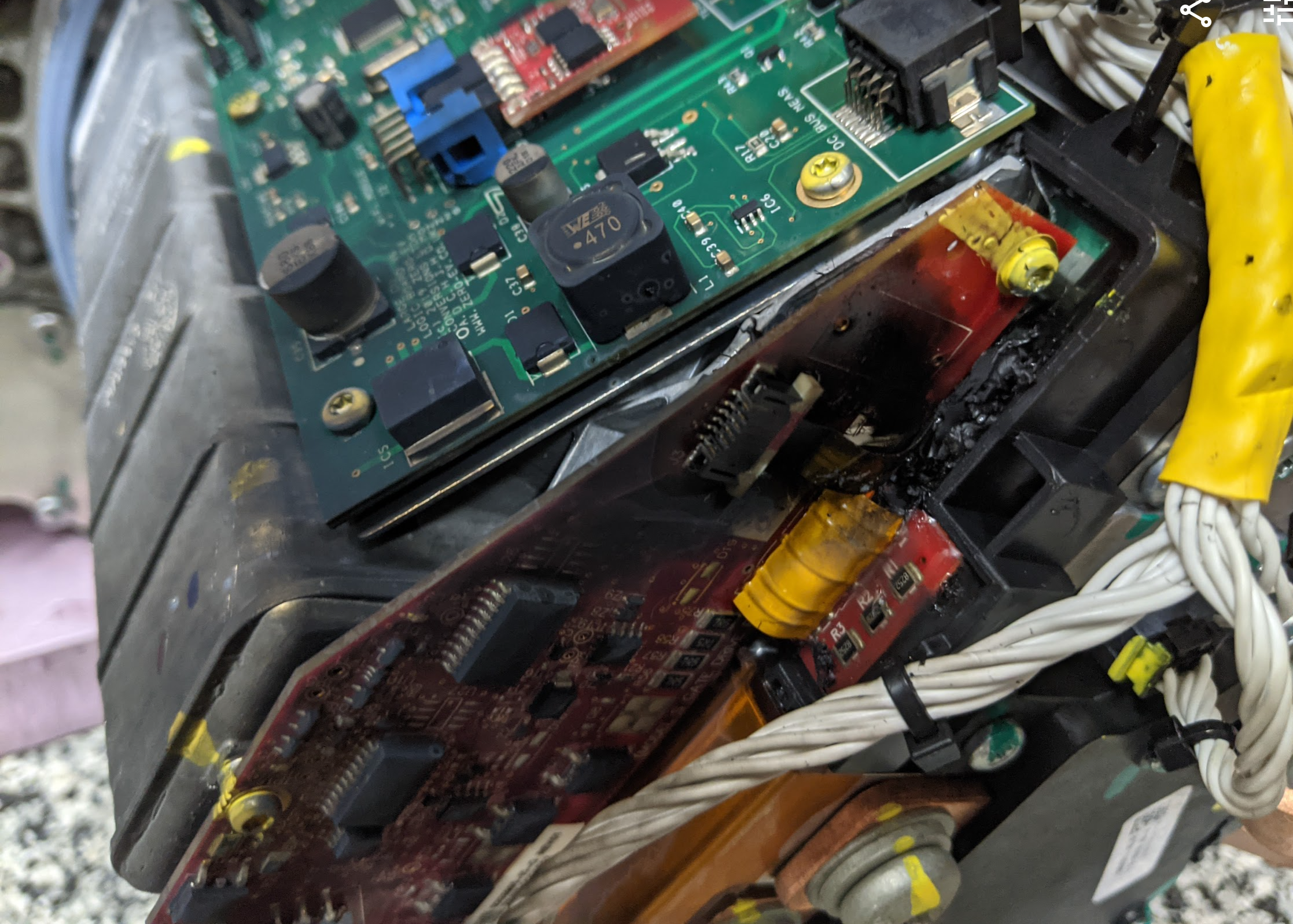

Funny you mention that, I just went out today to watch the temps after Chris from Zero mentioned motor temp.
DU temps started at 28C, didn't get further than that...
I did one Brake on full throttle launch with the attached settings, The car had good traction, and pulled hard all the way to 50 or 60 MPH when I let off. After coasting for a few seconds, I heard the Pyro Fuse blow.
I got the car home, checked for any shorts, there are none. I put a jumper wire across the fuse and powered the car. Everything powers fine, but I get an Overcurrent fault as soon as I switch to forward or reverse.
I assume something went wrong in the inverter.

Yup, that would be a blown inverter phase. Blowing while coasting -- that's really weird.

Found the smoke.
I have probably 1000 miles on the car with lots of hard acceleration. Not sure what would cause the Tesla pyro fuse to blow, it was power off regen at the time, battery cells were about 4.05 max.
Here is a picture of the inverter, the bottom phase took hit. Do you guys think this is due to the fuse blowing?
https://photos.google.com/u/0/photo/AF1 ... LexJhtllH4

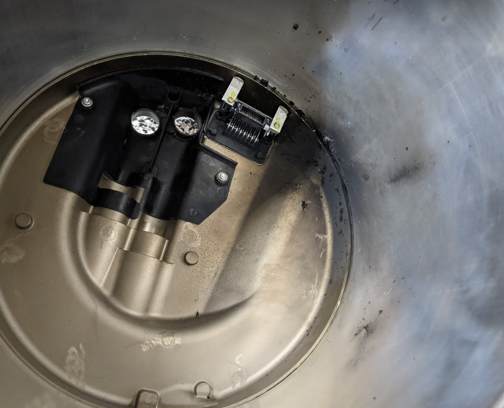

If a LDU is spinning when the fuse blows or contactor drops out there is a large chance of irreversible damage.MrMoparMan wrote: ↑Sat Jul 24, 2021 4:35 am Here is a picture of the inverter, the bottom phase took hit. Do you guys think this is due to the fuse blowing?

Re: Dyno Tuning LDU
Holy shit. That certainly looks like enough to blow a pyro fuse.
MrMoparMan
- Posts: 21
- Joined: Fri Feb 28, 2020 12:49 am
- Location: Denver, Colorado
Re: Dyno Tuning LDU
That looks to be the case...

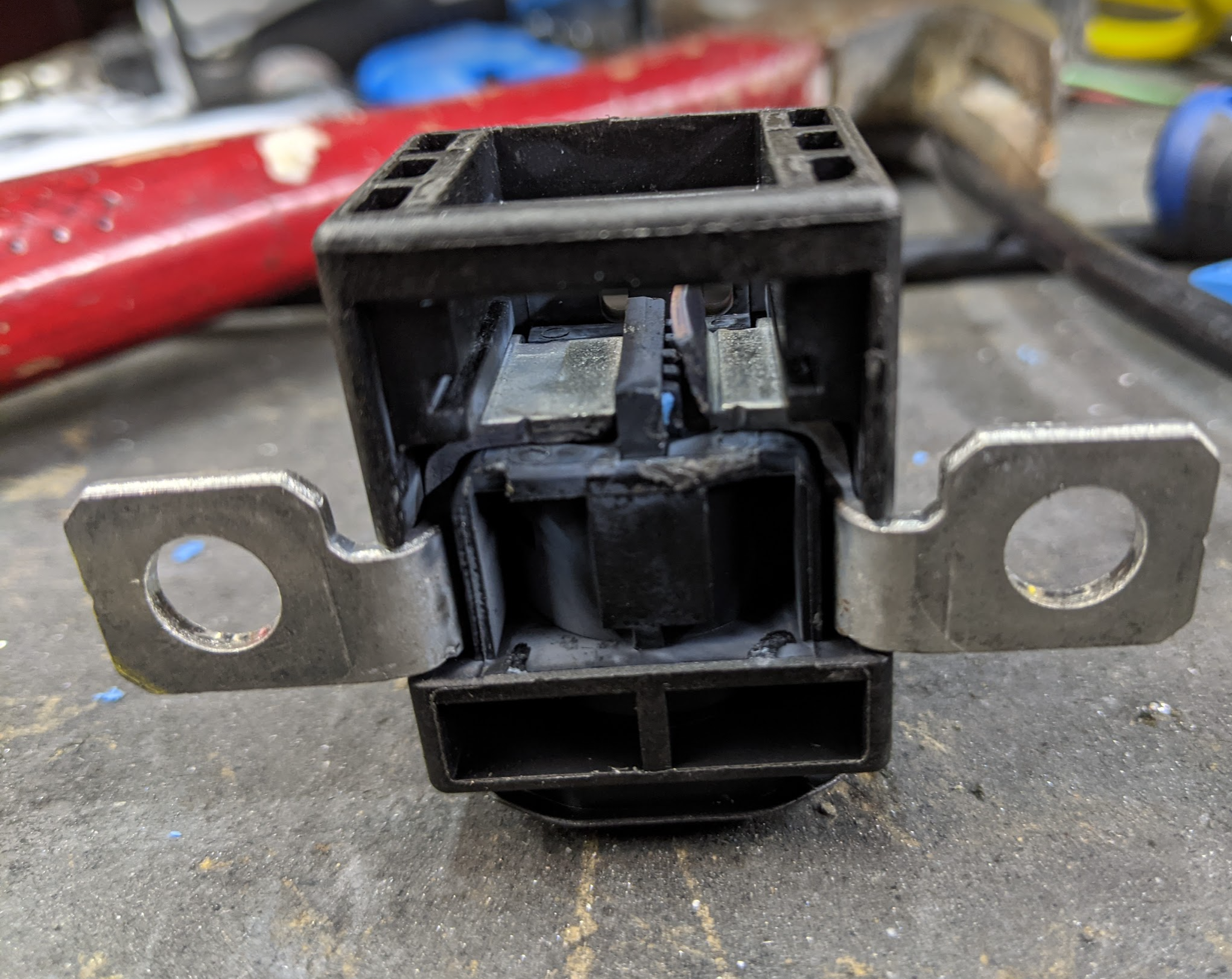

I think using a used Tesla pyro fuse was a bad idea. It blew at a strange time for not having any indication of a short.

I'm not very familiar with the fuse system from the tesla S. The model 3 has only one fuse, the model S apparently has a pyrofuse and a normal fuse. I think the pyrofuse is normally only triggered in the event of a crash. There are fuses on the internet for the Model S with 450A, 550A and 630A. What kind of fuse system do you have and do you actually control the pyrofuse?
MrMoparMan
- Posts: 21
Re: Dyno Tuning LDU
As far as I know, Tesla developed the pyro fuse when they started blowing conventional fuses as they increased power.muehlpower wrote: ↑Sat Jul 24, 2021 6:59 pm I'm not very familiar with the fuse system from the tesla S. The model 3 has only one fuse, the model S apparently has a pyrofuse and a normal fuse. I think the pyrofuse is normally only triggered in the event of a crash. There are fuses on the internet for the Model S with 450A, 550A and 630A. What kind of fuse system do you have and do you actually control the pyrofuse?
So it could have possibly been a failed experiment with the fuse. It is a self contained fuse that senses current and is supposed to blow at 2000 amps. It has an airbag like charge to do the work when it decides to go, so it is quick. It was the only main fuse in my system. I will be using a conventional fuse going forward.

Full throttle at speeds above 40 mph seems to consistently pull with out a power cut.
MrMoparMan
- Posts: 21
Re: Dyno Tuning LDU
I did a full throttle acceleration for a few seconds, then I let off and it does have a mild throttle-off regen. I may have also applied brakes which is slightly more aggressive regen. The fuse blew a few seconds after letting off of the throttle, so there was regen at the time.muehlpower wrote: ↑Mon Jul 26, 2021 7:20 am
You say you only regenerate when the brake is applied. When it failed, you didn't brake, right. Could it be that the voltage in the inverter rises to a value that is sufficient to destroy the ITGBs because nothing is diverted into the battery?
It is something I would like to get to the bottom of, did my settings have something to do with it? Is it unable to handle full throttle, followed by immediate regen? Or did the pyro fuse blow when it should not have?
