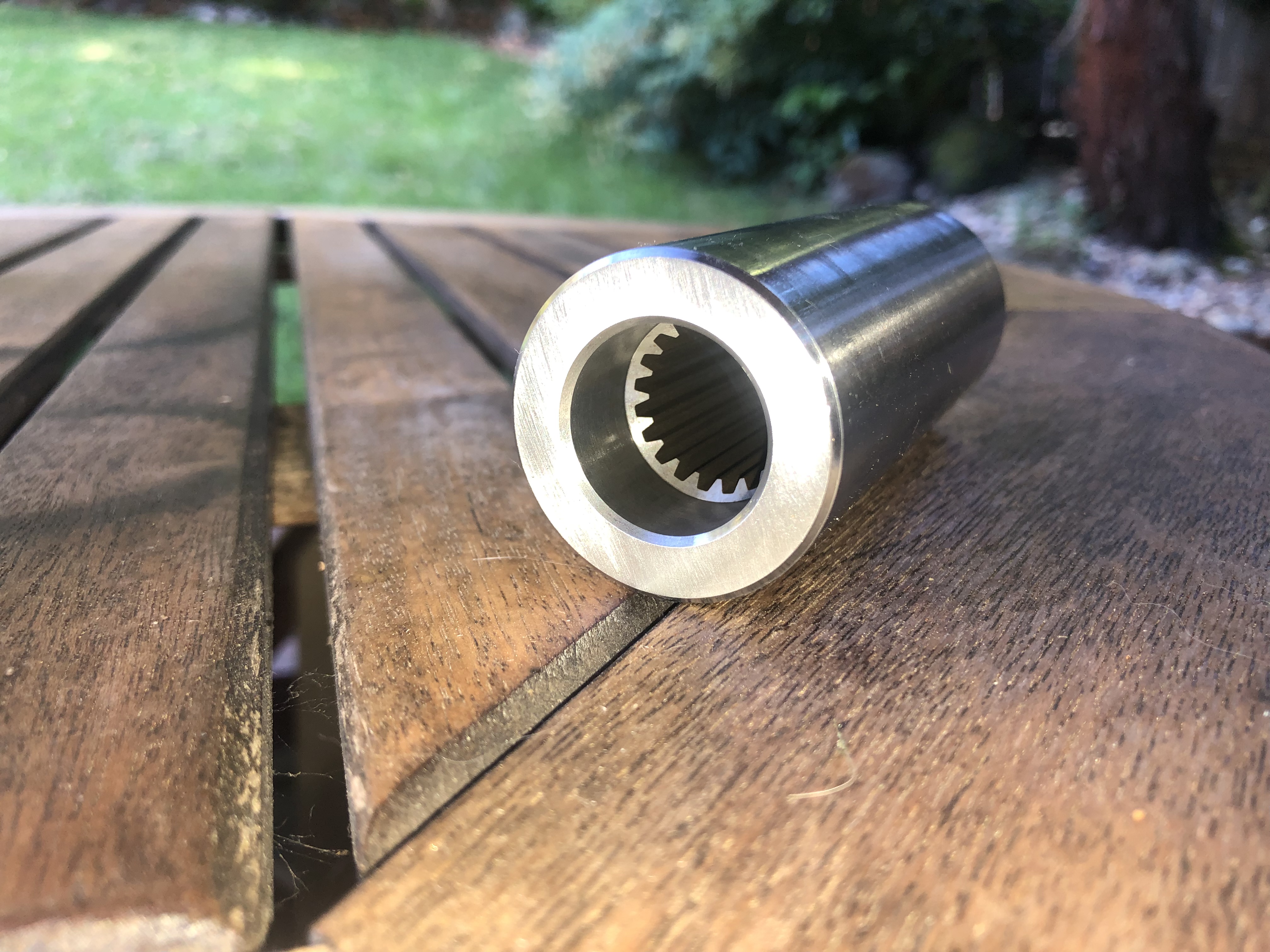

hey folks, after lots of back and forth with the machine shop, v2 couplers are finally in production!
-4140 alloy steel
-simpler design. No flange, but still compatible with the bearing.
-cheaper!
-4140 alloy steel
-cheaper!

v2 couplers arrived !
EDM machined 4140 goodness

looks like you simplified it the same way i did. though i didn't see any need for a bearing. just a universal opposite side to add a clutch spline piece to.
viewtopic.php?p=23018#p23018
- Bratitude
- Posts: 991
- Location: Canada
- Has thanked: 168 times
- Been thanked: 350 times
Re: Leaf spline coupler
vwbrady wrote: ↑Mon Jun 28, 2021 4:27 pm looks like you simplified it the same way i did. though i didn't see any need for a bearing. just a universal opposite side to add a clutch spline piece to.
still compatible with the bearing, now just some additional machining if some one wants a flywheel or Drive shaft interfaced compared to gearbox direct drive
