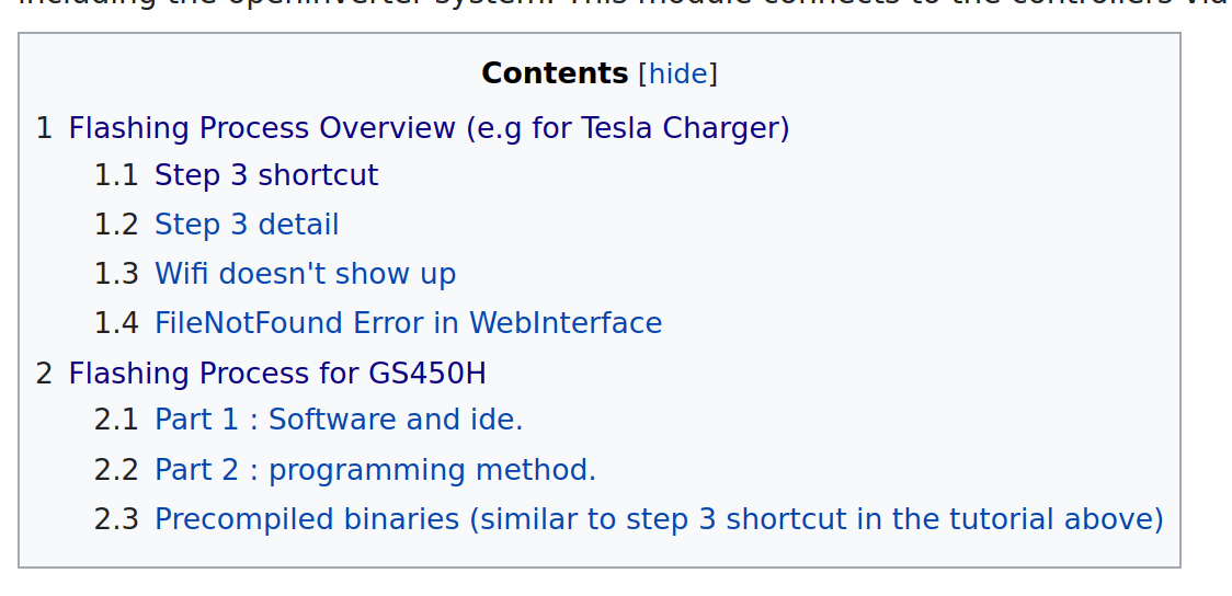

Re: HOWTO: Flashing ESP8266
Hello,
people seem to have had problems with programming these lately.
I took posts from arber, johu and others in this thread and put them in a wiki page. I hope it helps someone.
I also added a pre-compiled binary for the web-interface, so people should even be able to flash their Olimex without installing the arduino IDE.
Feel free to update the page and add to it.
https://openinverter.org/wiki/Olimex_MOD-WIFI-ESP8266

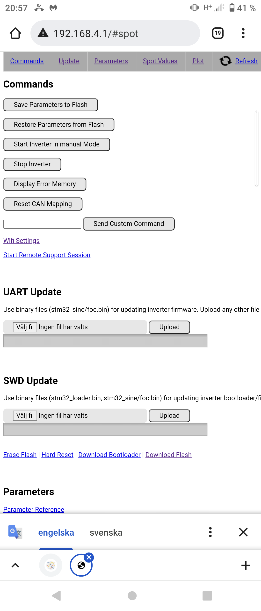

I have a similar problem as many here: I use a ESP-01 (as shown in the picture of JockE28) and from my understanding, they do have enough memory.
All the files (including the src directory) only have app. 250kB
First I upload the data directory using "sketch data upload" and message is "transfer ok".
After that I upload "FSBRowser.ino" using the arrow button from the toolbar. Also here everything seems to work.
Then, I can find the ESP in Wifi but couldn't get access to 194.168.4.1
Seems as if the module isn't responding.
Thx, Fabian.
You wrote, that sometimes (or often) no files exist on the device.
I wonder, how I could check this; is there a possibility to dump the complete memory to check the content?
Thx, Fabian.
Hello all!
Update: I managed to get my ESP work.
It wasn't a problem with the ESP but with my cellphone...
After hours of different flashing trials and without any connection to my cellphone, I finally tried to connect with my laptop.
Result: Tadah! Site was loaded and after connecting to my inverter board also the gauges and the logging worked.
I havent't tried the update function yet, but I'm very confident, that also these will work.
Conclusion: In the end, it wasn't so difficult to get the ESP programmed.
And I can confirm, that ESP-01 or ESP-01S have enough memory for the code (was doubted before).
What is still open: I do not know, why the site isn't loaded with my cellphone.
Has someone an idea? What IP-address should the connection have and what the gateway? (192.168.4.10 and 192.168.4.1 didn't work)
And second: How can I dump the complete memory of the ESP module with Arduino IDE?
CU, Fabian.
Maybe the cell phone keeps 3G/4G/5G open because no internet is found on the network of the ESP device. So an option like (auto choose) etc. should be disabled maybe in the phone.
