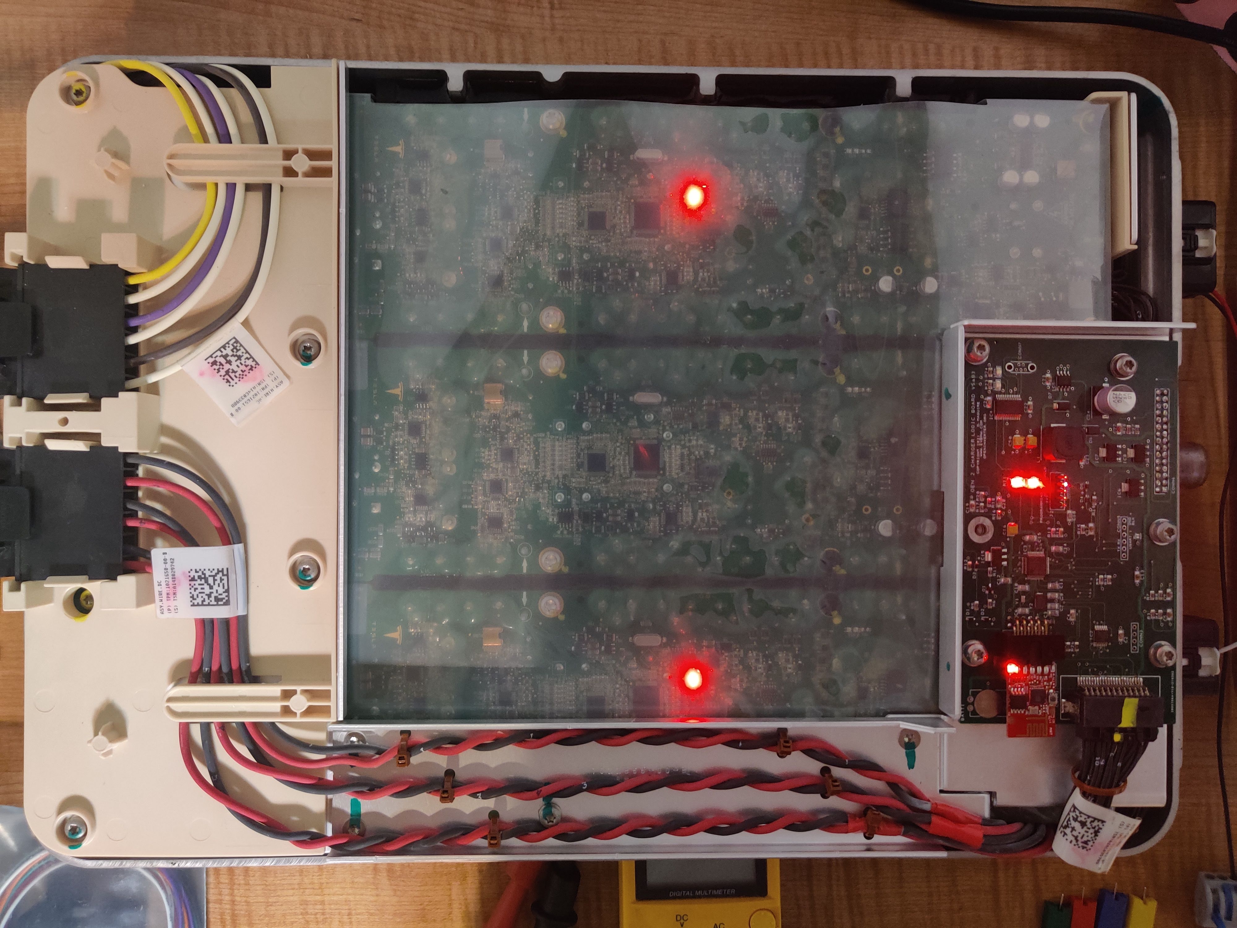

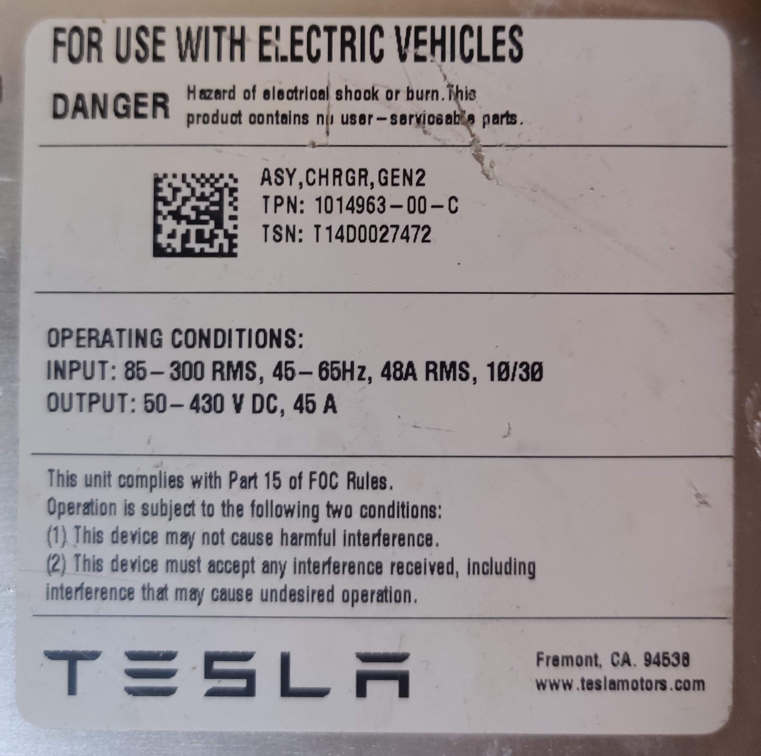

Folks, I am trying to test Tesla GEN2 charger. Using V5aB3 board running commercial software downloaded using link on Wiki page (not registered yet, just testing for now). All modules are operated on one common phase (110V).
When I initiate charge in "Manual" mode by putting HIGH on '"D1" two modules are being activated (see photo, showing only two module LED lit). I get ~110V on the output regardless of setting on web interface. I verified only one module outputs voltage. I checked voltages and control signals to power modules: GND, +15V, +12V, ENABLE, CHARGE_ACTIVATE. All look good.
Does it look like broken charger? Is there anything else to check?

Good question, but I am sure it would be helpful if I described what happens with battery connected.
I have half of the pack connected (48s) for testing.
I configured charger to operate single power module at the time through "set chargerena x" command, now I can toggle which unit I want through drop-down.
Each power module behaves differently
Module 1
The only one which responds somewhat properly but not quite. When I set udcspnt and udclim slightly above current battery voltage (172V) and trigger charge then it looks like it wants to charge but quits immediately. I think this is because power module reports battery voltage as 232V !!! When I set charging limit to 240V then it seems like it initiates charging but current going into battery is only ~0.2A
Module 2
No response, no LED, no relay click only 12V supply jumps to 3A and then fluctuates widely between 0.2A and 3A
Module 3
Looks like it tries to initiate charging but relay keeps clicking every second and LED blinks
I really do not know history of this charger, it does not look like it was tempered with and no visual damage or burn signs.
I have no prior experience with Tesla charger therefore I was looking for some tips but it looks like it is just bad unit.
This is not Supercharger unit but it is Rev C, Did anyone get 1014963-00-C (non supercharger) unit to work properly?

Didn’t Damien pop his when he tried to charge under 200V? That may be related..
- arturk
- Posts: 148
- Location: United States, MD
- Has thanked: 7 times
- Been thanked: 4 times
Right, I remember he said "much under 200V".
Lowest I tested was at 185V for few seconds and 3A current limit. No pop, no smoke, no charge.

I think the reason they break below 200V is because they do not limit DC output current. So each module seems capable of 15A. If you allow 16A@230Vac in that is 3750 W. That is only 10A@375Vdc (neglecting losses) but roughly 18A@200Vdc. So already above rating. Go figure @100V.
If you limit DC current or AC current to stay below 15A you should be fine

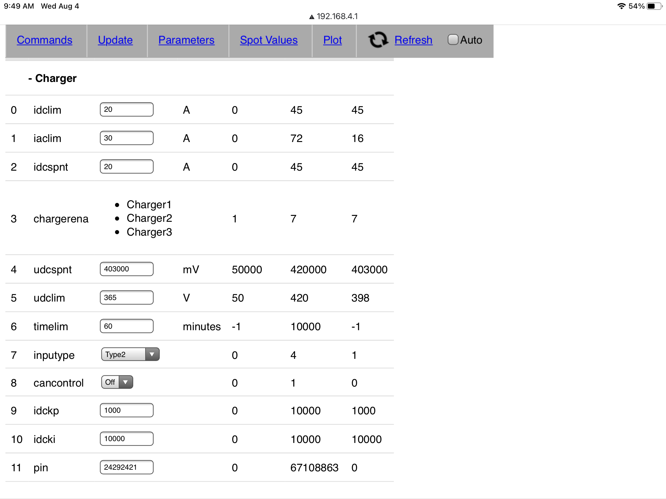

Well I don't know what I'm doing wrong since i've changed the parameters before with Putty. I can use "q" to quit but for some reason I can't change anything. It won't accept any typing or commands except "q" I know it's something I'm doing wrong just can't figure what it is.
Any thoughts would be helpful. New battery pack and I want to go easy on it and lower some settings.
Thanks in advance.
Thanks in advance.

Try Arduino serial monitor!Roadstercycle wrote: ↑Tue Aug 03, 2021 11:06 pm Well I don't know what I'm doing wrong since i've changed the parameters before with Putty. I can use "q" to quit but for some reason I can't change anything. It won't accept any typing or commands except "q" I know it's something I'm doing wrong just can't figure what it is.

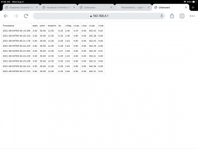

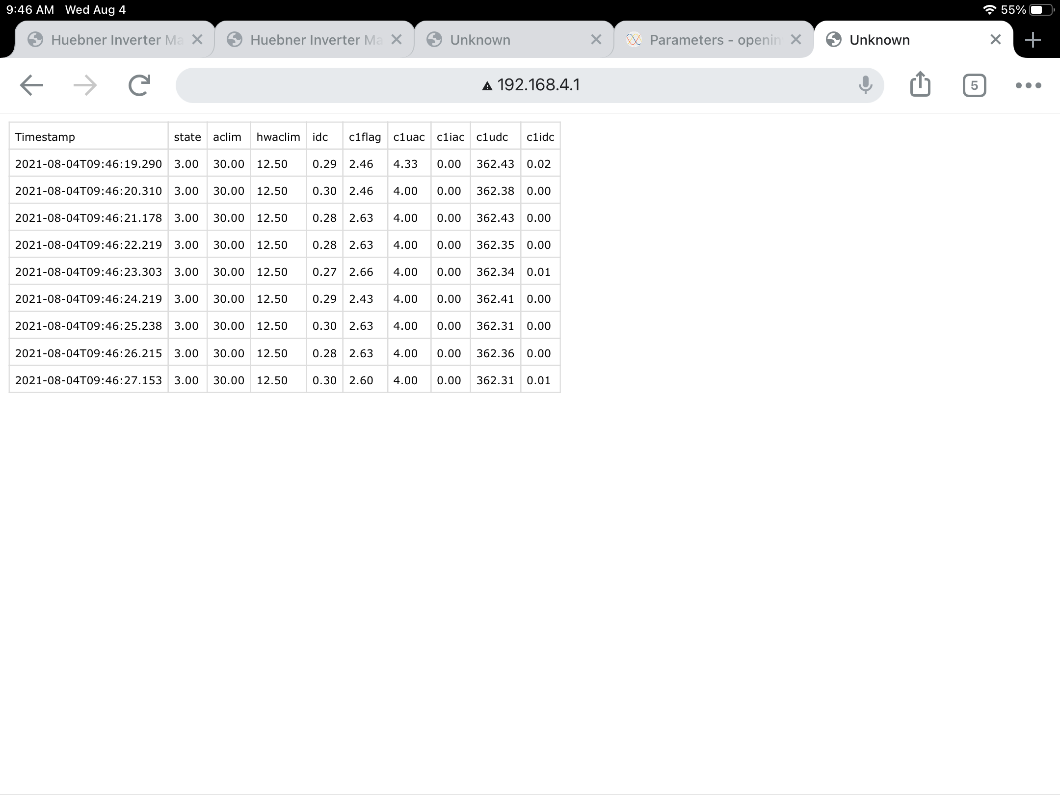

I did replace charger because it broken due to lack of cooling. So EVSE fuse blown problem solved.
Now EVSE get kick in and all charger modules activate but still not charging.
Attached screenshots
Please advice.
Thanks in advance.
Please advice.
Thanks in advance.

Yes that did the trick. Worked great, thank you.Johaljaswant wrote: ↑Wed Aug 04, 2021 2:08 pmTry Arduino serial monitor!Roadstercycle wrote: ↑Tue Aug 03, 2021 11:06 pm Well I don't know what I'm doing wrong since i've changed the parameters before with Putty. I can use "q" to quit but for some reason I can't change anything. It won't accept any typing or commands except "q" I know it's something I'm doing wrong just can't figure what it is.
Thanks in advance.
