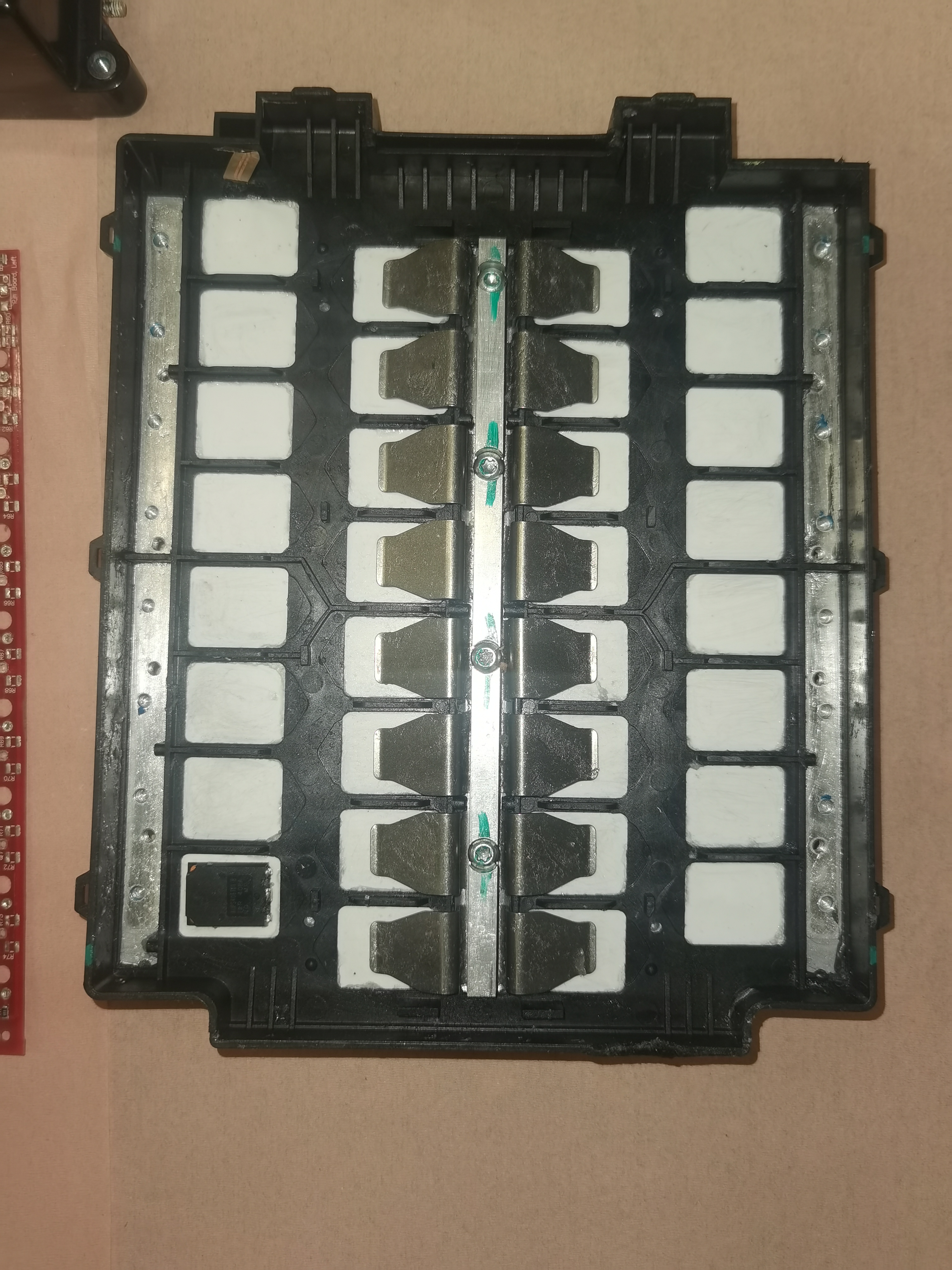

Time to reveal Tesla LDU Inner secrets
Unfortunally ive got an IGBT Blowout, New inverter piece is incoming thanx to the kind user "Boxter EV"

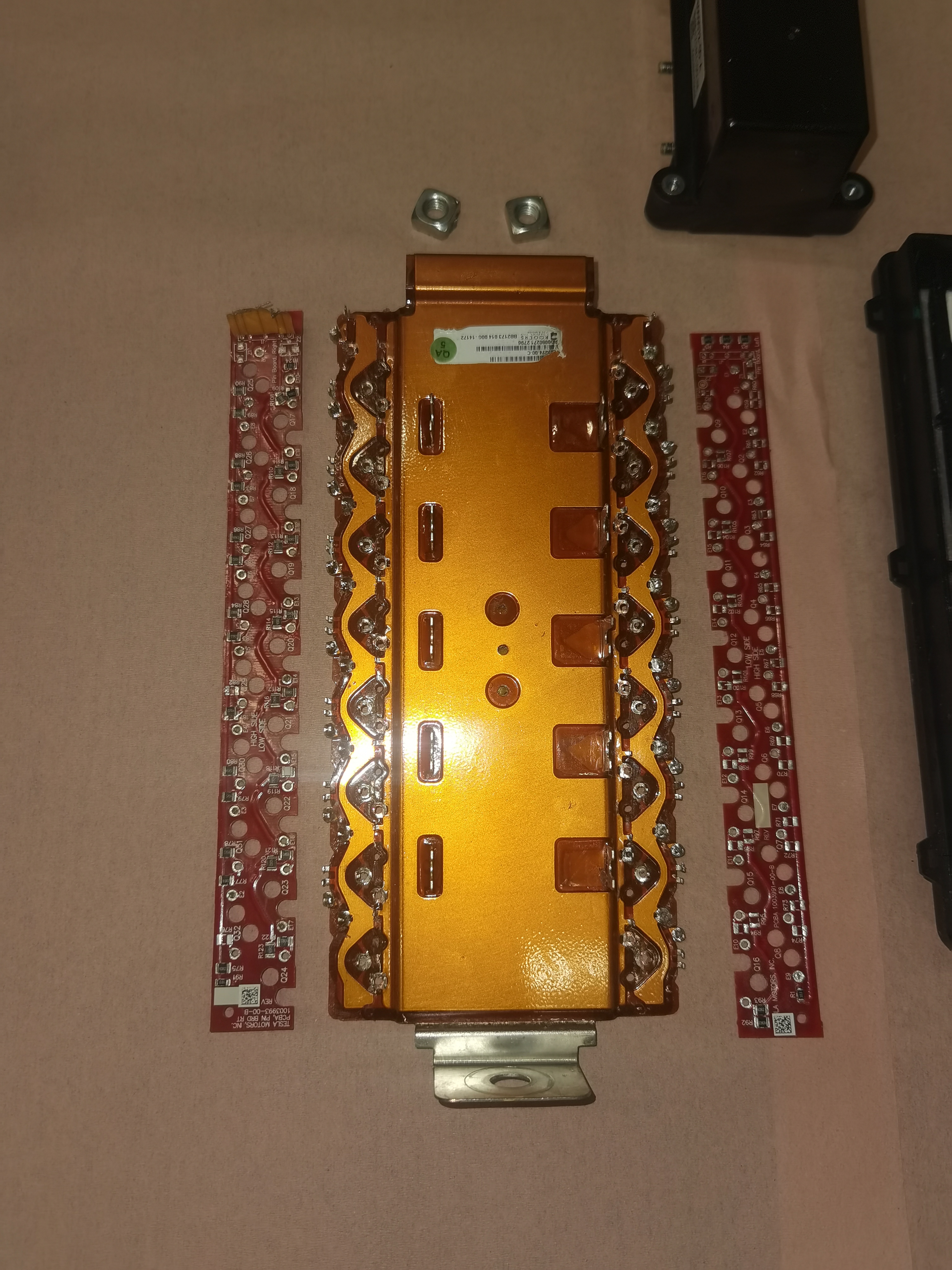

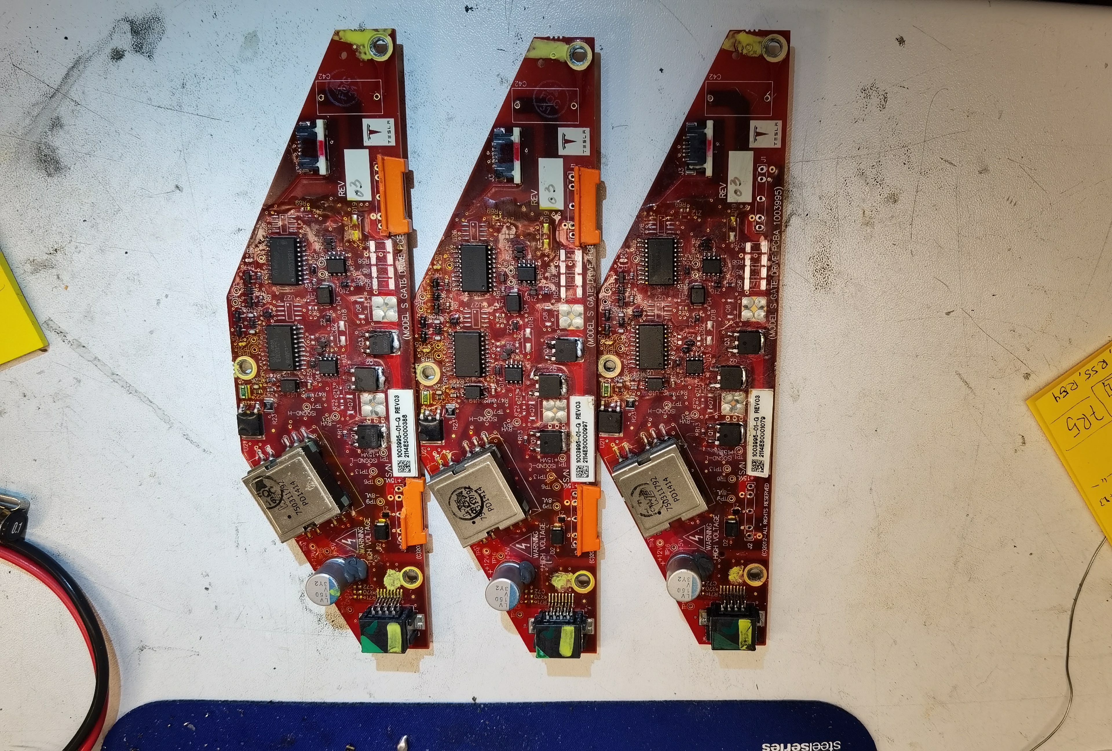

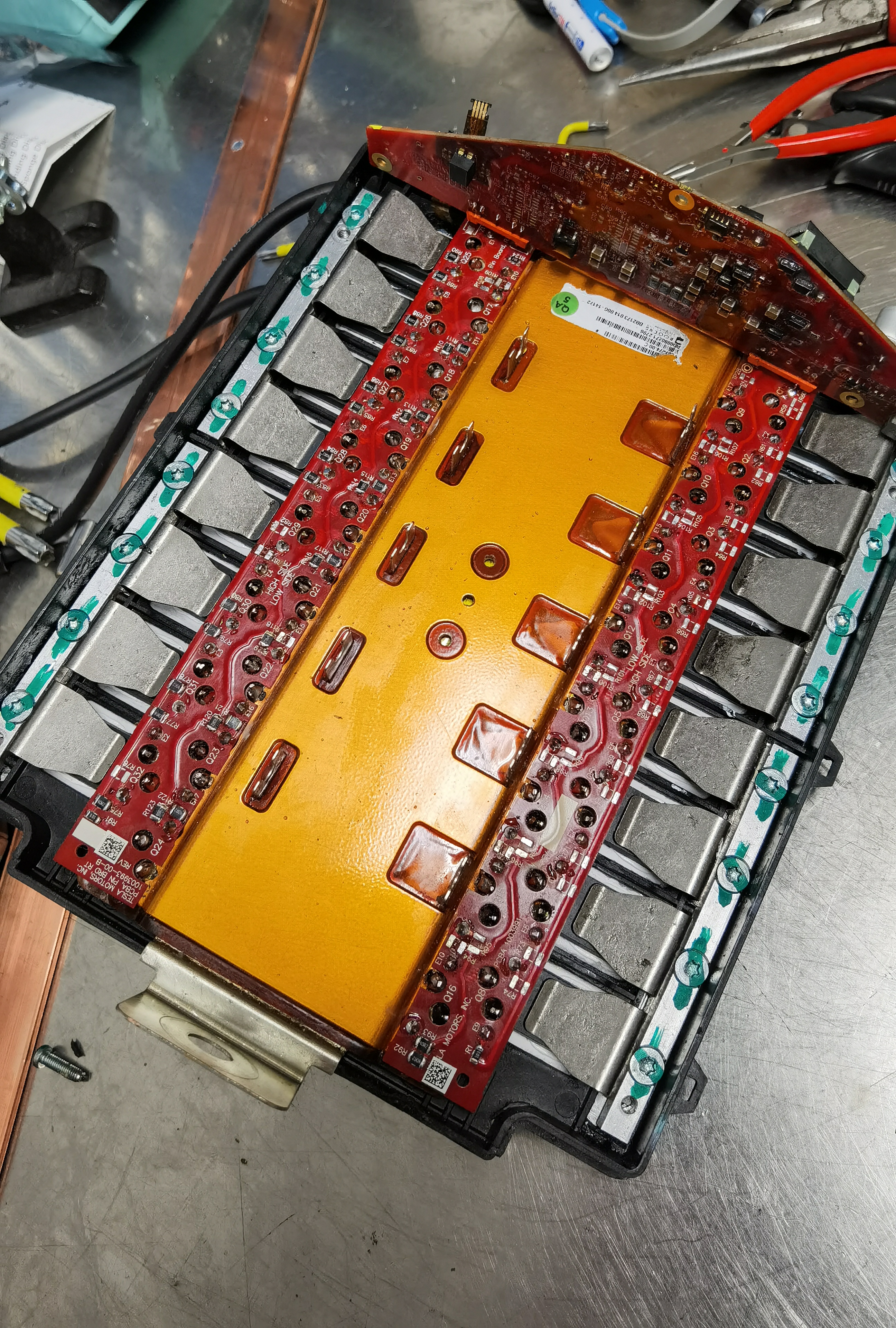

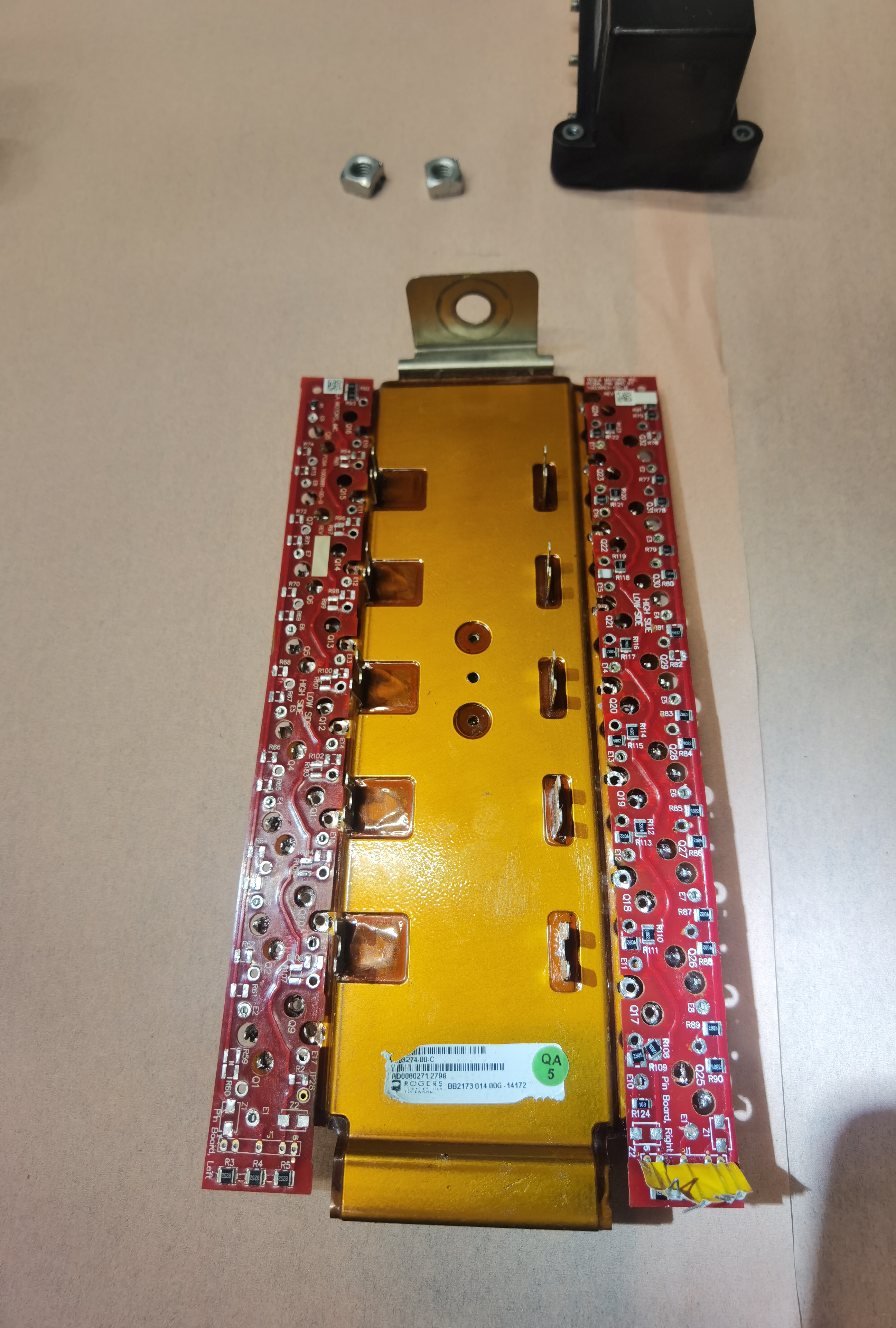

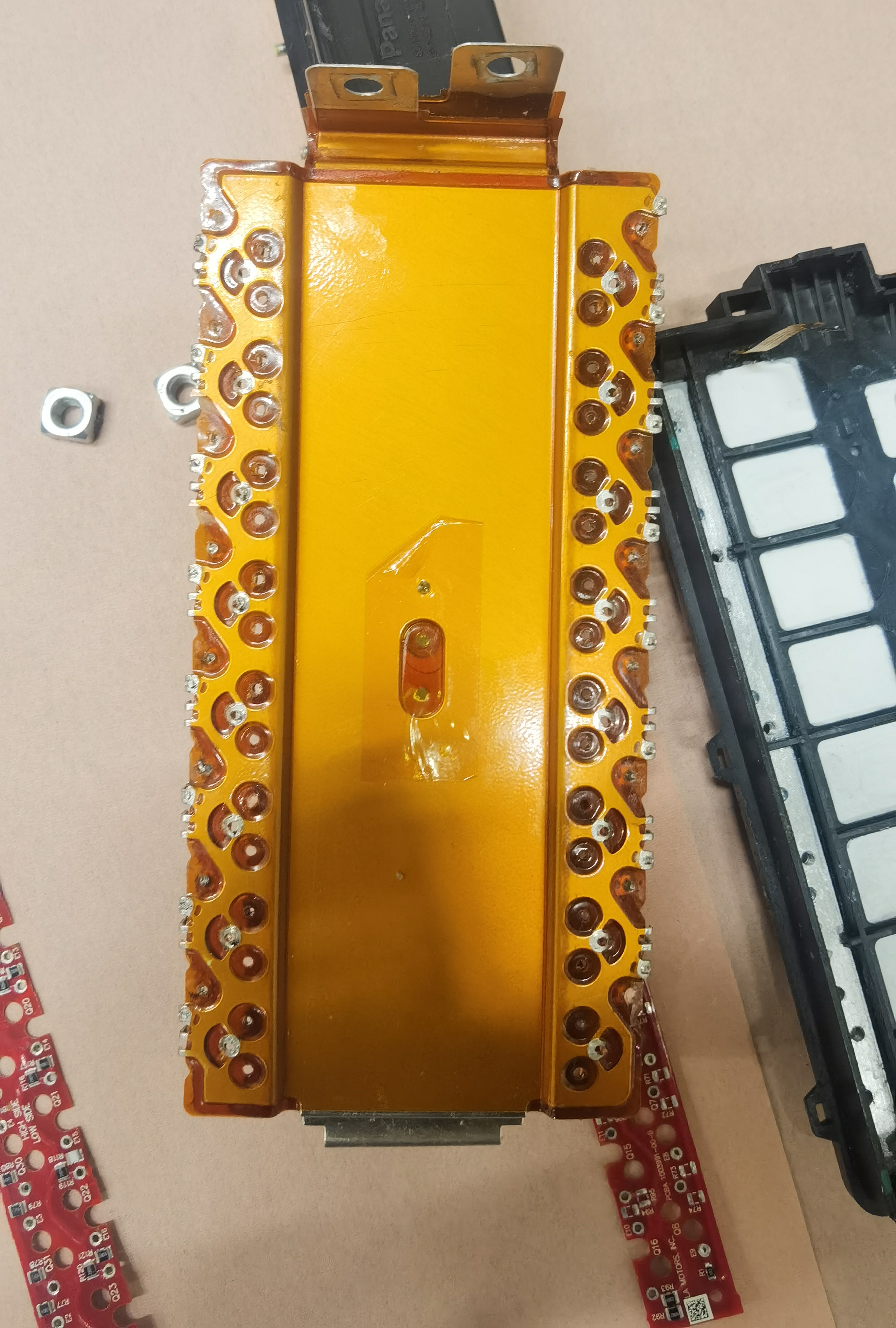

As return favor to the forum i decided to teardown my broken inverter piece

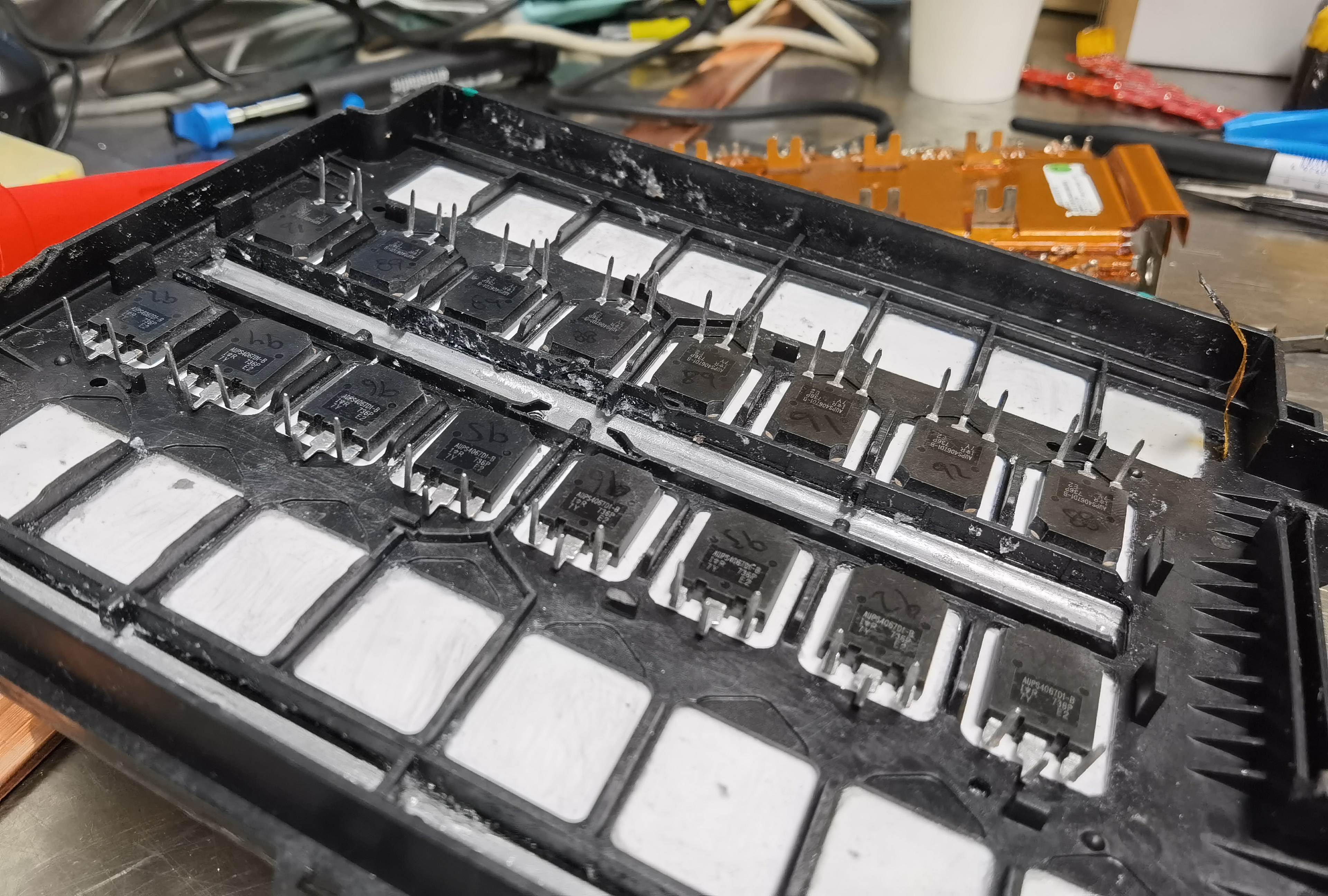

The solution i found to deal with the "Elon goo" was Metal cleaner: https://veidec.com/gb/metal-clean
It did not eliminate the goo entirely but its stickyness disapered and behave like gelatine the just blew it away with compressed air.
First preheat to 150-200 degree, then the desolderring begin, ecuipped with 150w soldergun in combination with Vaccum solder station.
Total time from blown inverter piece to this, aprox 4 hours. In this condition it is quite possible to restore with new igbt.

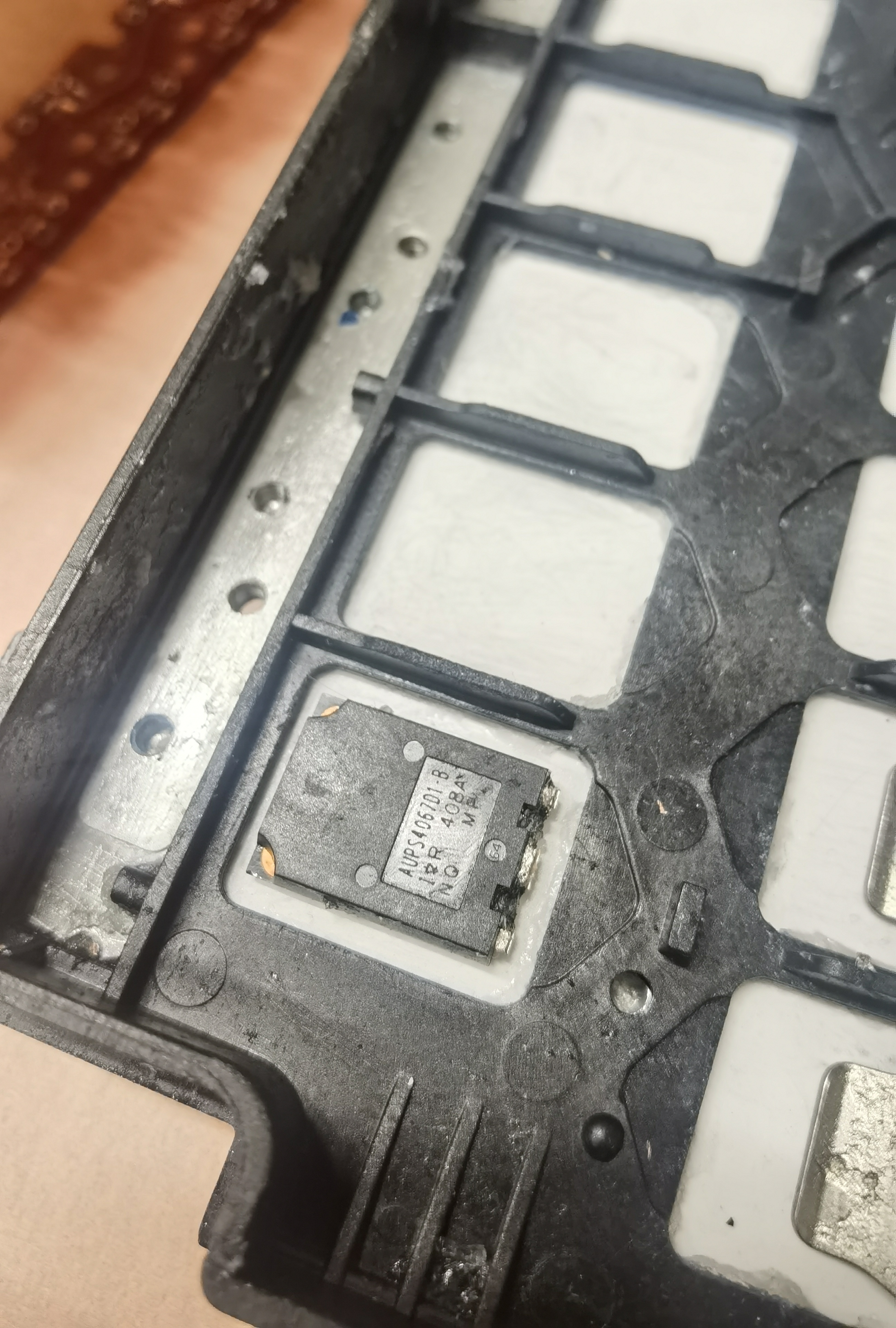

By the way, not the same Igbt as the base unit,
AUPS4067D1-B https://www.amazon.com/10PCS-AUPS4067D1 ... 08KTDJ9HR
And it can not be repeated enough, this is an example of fantastic engineering and problem solving
