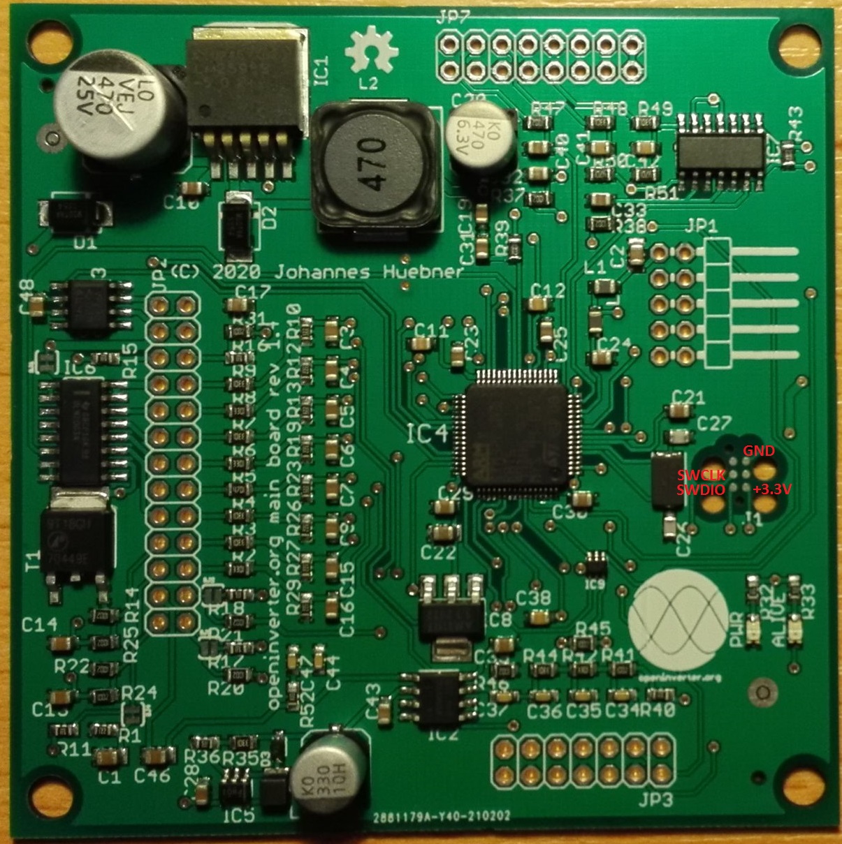

Hi! Latest mainboard has TC2030 programming interface and I bought TC2030-MCP-NL-10 for it but I am not sure about pinout for it. Could someone help me connect ST-link to it?
Re: HOWTO: Flashing with ST-Link v2
Hi,the new boards use a new SWD connector. What type of connector should I use?
This push-pin SWD-connector is sort of proprietary. Its cheap to produce on PCB, but the connector is way too expensive. Please do not support this connector and just solder the wires on the pads. When done with flashing, unsolder the wires again when there is a risk of accidentally pulling on the soldered wires.
