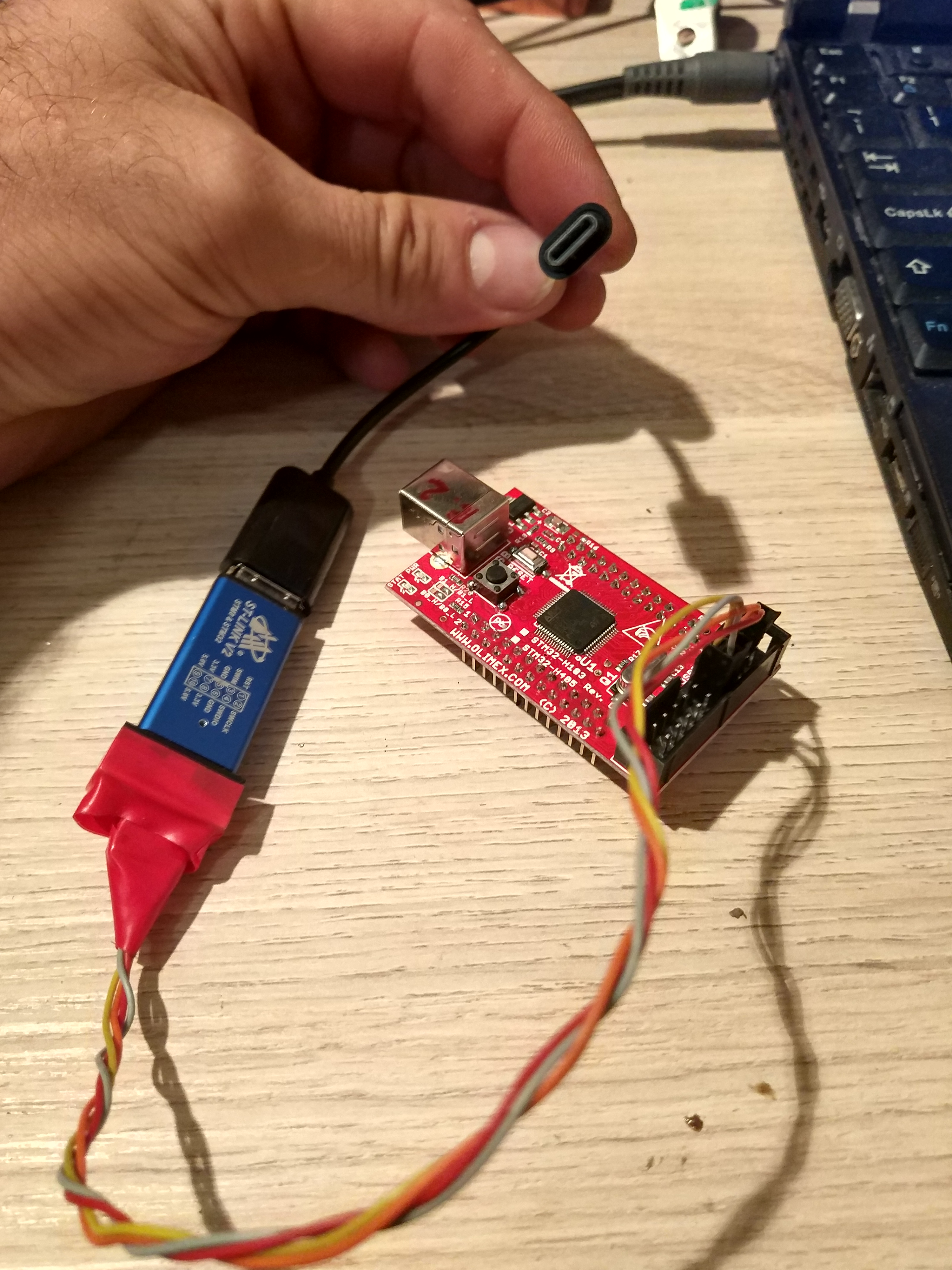

I have sucessfuly updated Olimex board using ZFlasher STM32, my Android phone and ST link V2 dongle with USB OTG cable.
1. I erased flash - OK
2. I downloaded firmware to the phone - OK
3. I used bootloader code and flashed Olimex - OK
4. I flashed again with Firmware code - OK
I got flashing green light as serial began to work.
For flashing with Android i use .hex file.

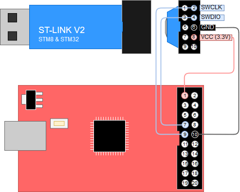

I have found some info on how to programm the STM32 chip on the blue pill.
I will use ST-Link like before. Some instructions here:
https://idyl.io/arduino/how-to/program- ... 2f103c8t6/
Or here:
https://stm32programming.blogspot.com/2 ... -uart.html
Connecting the Blue Pill to the STM-32
__ST-LINK V2................ Blue Pill
PIN 2.... SWCLK............. CLK
PIN 4.... SWDIO............. IO
PIN 6.... GND................ GND
PIN 8.... 3.3V................ 3.3V
When programming with ST link, it’s not necessary to move the jumpers on the Blue Pill board.
Of course the file upload procedure is the same as for the Olimex H103.

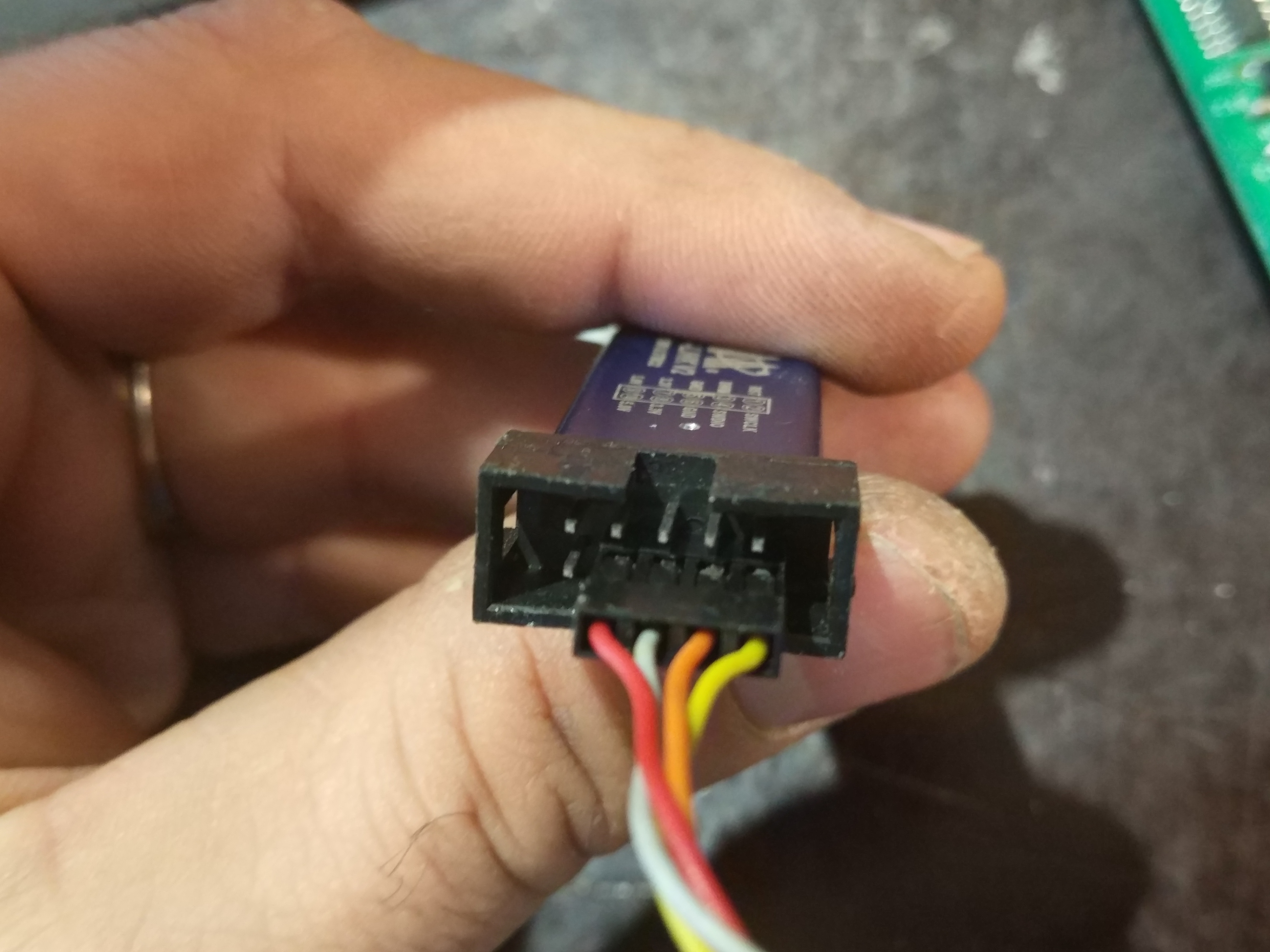

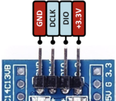

Quick word of warning about the cheap chinese st-link clones; The markings for SWDIO and SWDCLK may be reversed on the casing (I've experienced this myself) If you get weird errors then swap the cables over and try again. It can't do any harm so long as you just swap those two.

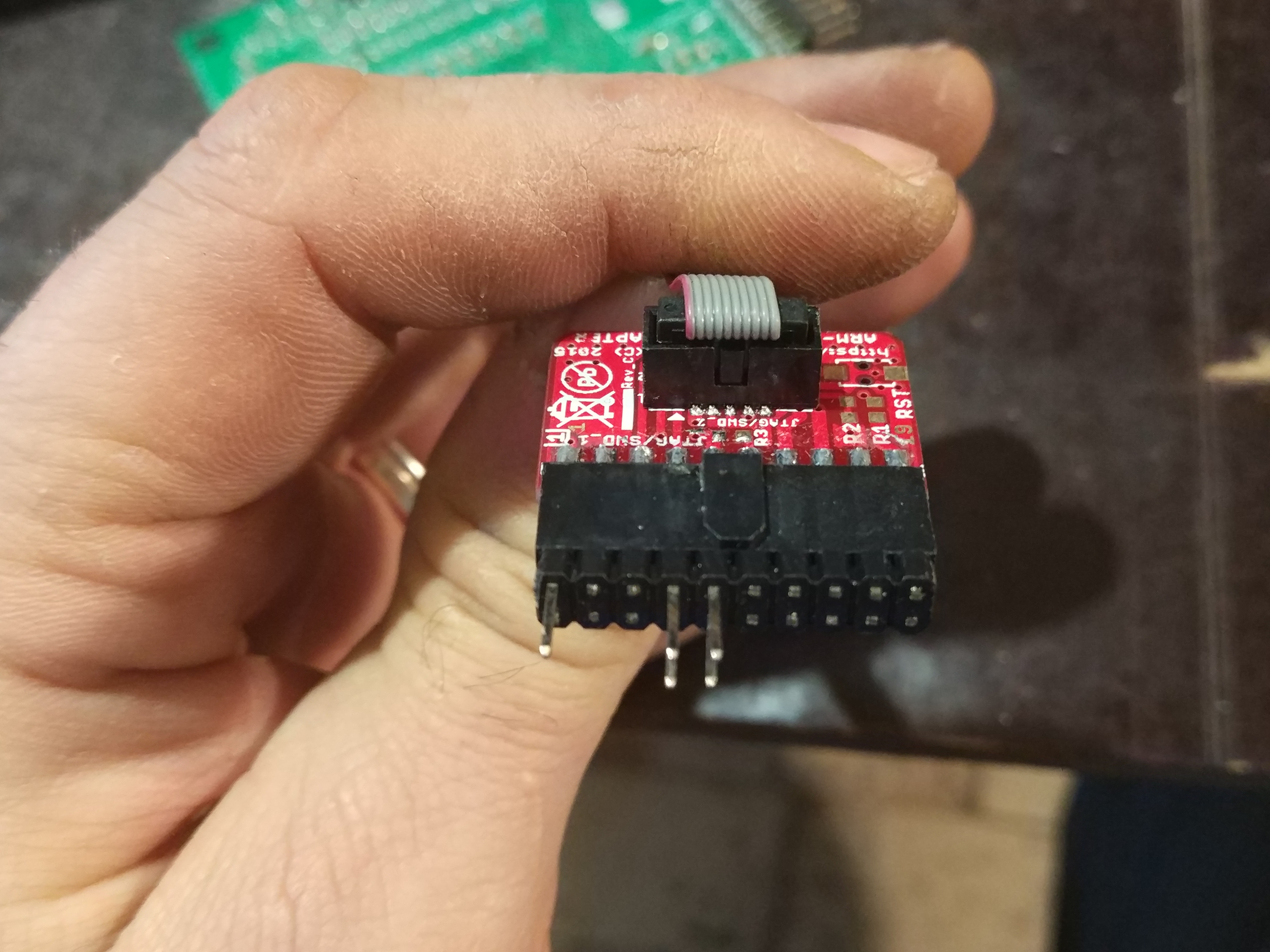

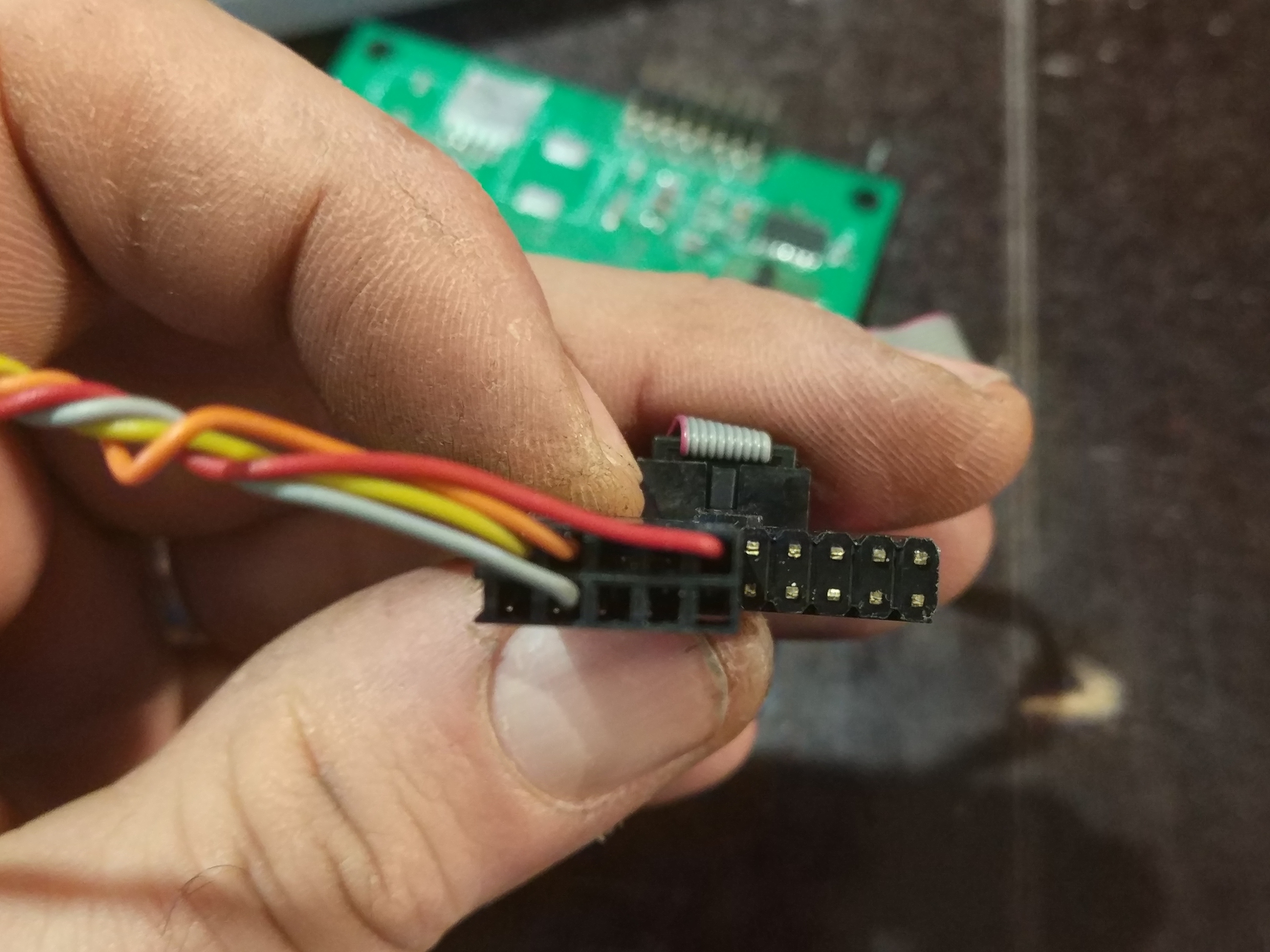

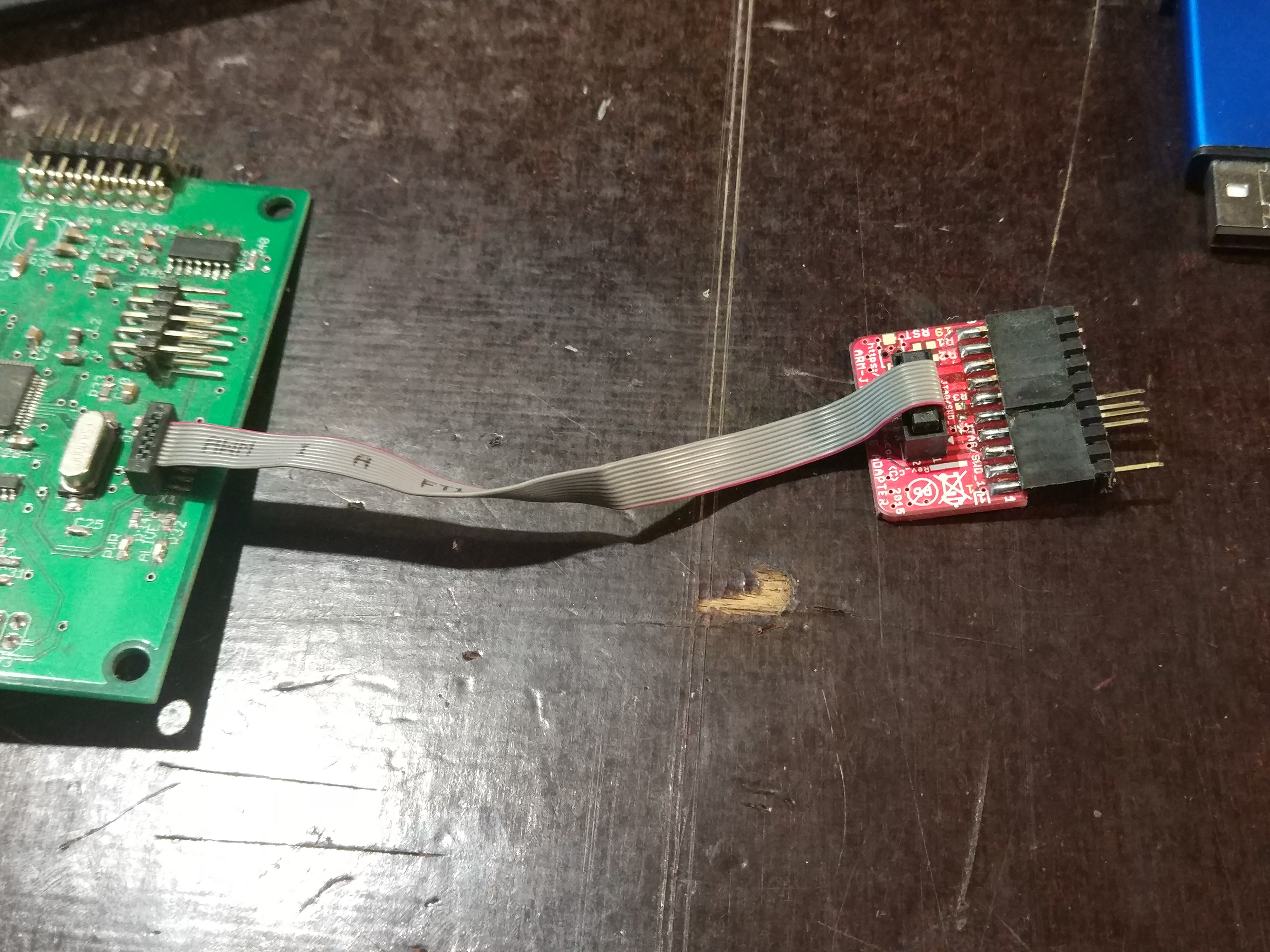

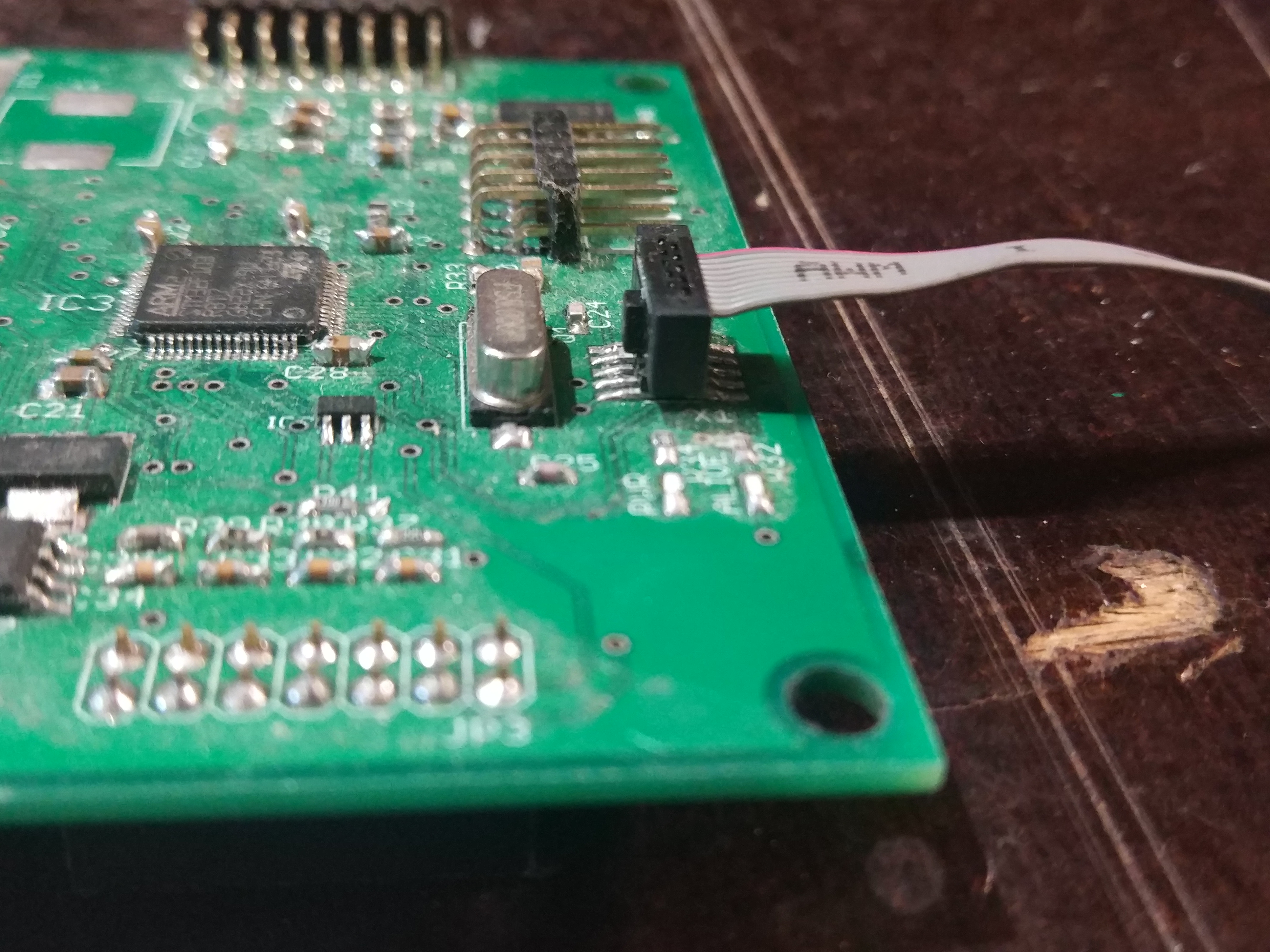

OK i will show you how to connect to Rev. 3 board
First you have to get ST-Link USB gizmo.
Next you need SWD to JTAG or some such adapter. You may work out your own from SWD cable, but i use Olimex adapter here
https://www.olimex.com/Products/ARM/JTA ... TAG-20-10/
Then you connect SWD cable to Rev 3 board and to JTAG adapter. Observe the red stripe.
From JTAG then is the mirror connection as to Olimex STM32H103.
Programming procedure is exactly the same as with H103.

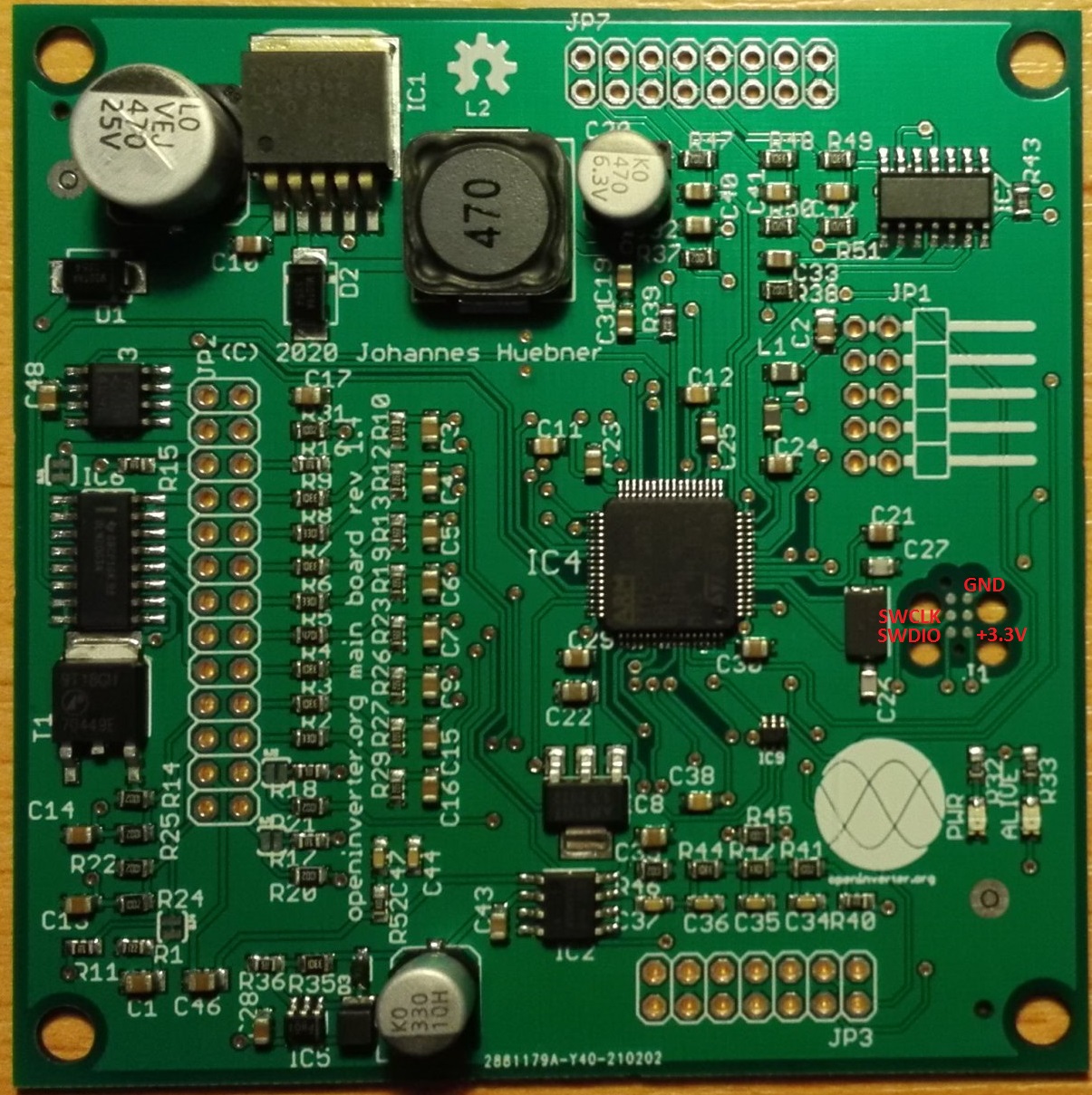

Today I finally finished soldering v3 board - now 5V and 3V3 are present :) so my next step is programming.
Of course it can't be so easy, because when I want to connect via ST-Link utility I have error with communication like can't connect to target.
I saw somewhere, that can be problem with usb so I tried to put to another USB port - without success. So - next days I will spend with searching of connection problem - nice.
In those milesteps it looks, that I will try inverter in next year - unfortunately now is January.
Have someone any idea what to do?
Posts: 3796
Been thanked: 413 times
Re: HOWTO: Flashing with ST-Link v2

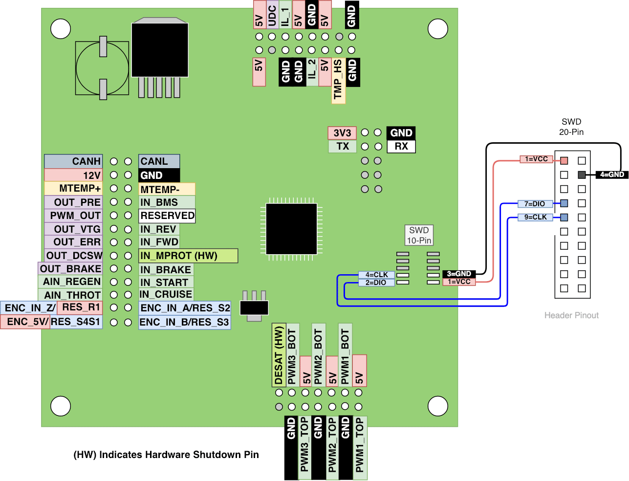

You want to inspect the onboard chip traces if you somehow made a cold solder joint.
I would recommend you solder 4 short cables to programming port and put a JST connector on the other end, so you have firm connection like DImas drawing.
You can translate SWD connector directly to 4 pin connector on STLink. It is even drawn on the underside of the STLink.
SWD ___________STLink
Vcc ____________pin8
GND ___________pin6
SWDIO _________pin4
SWCLK ________ pin2
STLink has to be updated and you have to install drivers of course.

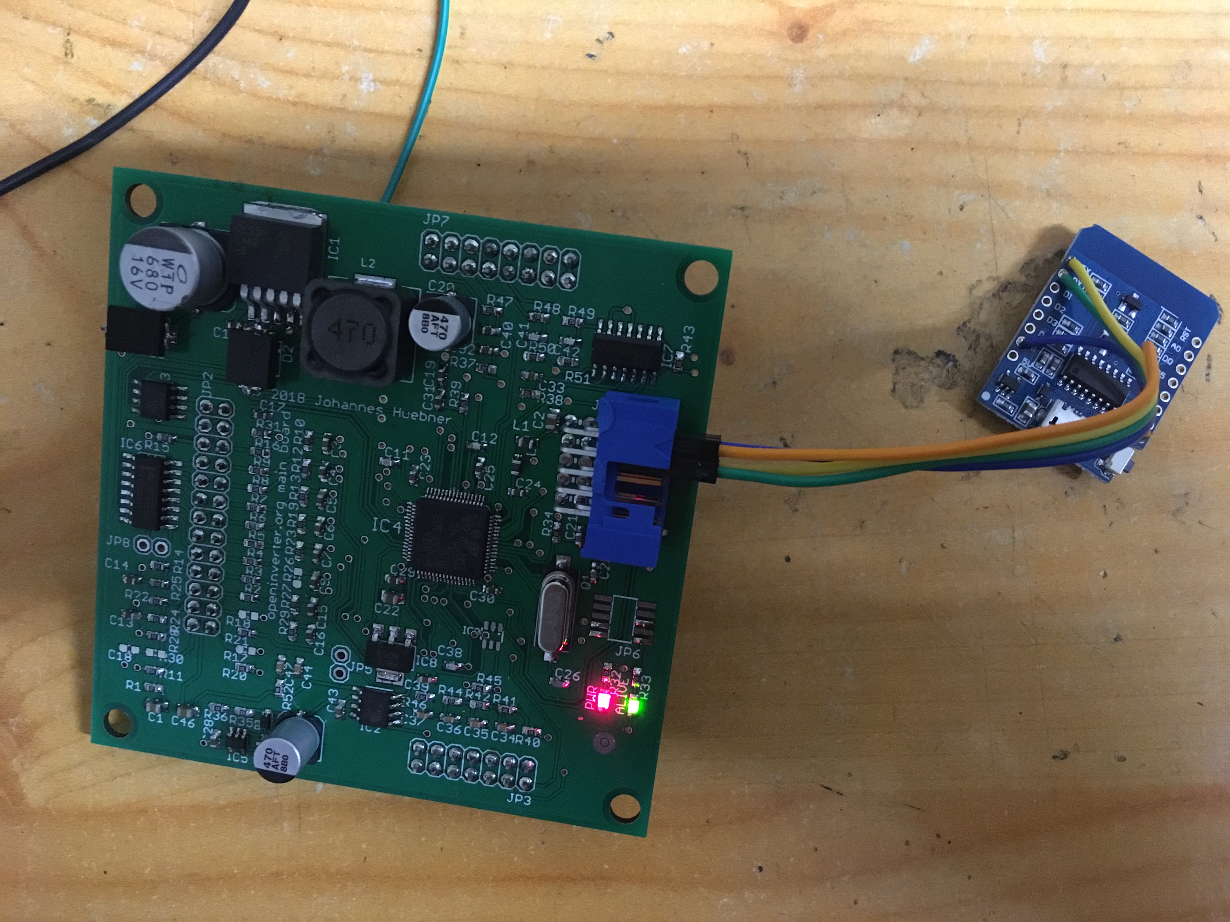

Good, that doobedoobedo put idea to buy more cheap stuff and together I bought WEMOS D1 mini with 4MB flash - here I had totally no problem with programming - it was even faster 4x than ESP. Everything was good, wifi was visible and was possible to login - second yeah :)
Today I tried to connect v3 board and WEMOS and everything is working good, parameters are visible and is possible to download-upload param.json to board.
One question: why was necessary to upload gaugues.html to see page with gaugues - I need also to upload something more what I don't know?
Second: I didn't try to solder test board+ upload test firmware to v3 board - is it possible to upload only stm32-test via wifi?
