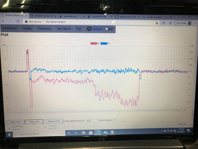

My question is regarding id and iq. When I plot them I was expecting to see iq fluctuate with throttle input and id stay relatively lower. Seems to be backwards? Maybe I’m just backwards?? Any insight is appreciated!
- Posts: 6713
- Has thanked: 368 times
- Been thanked: 1542 times
Re: Toyota MGR Rear Traction Transaxle
Is it just spinning freely? Then not much torque needs to be generated and you spin right up into the field weakening range. id=field weakening.

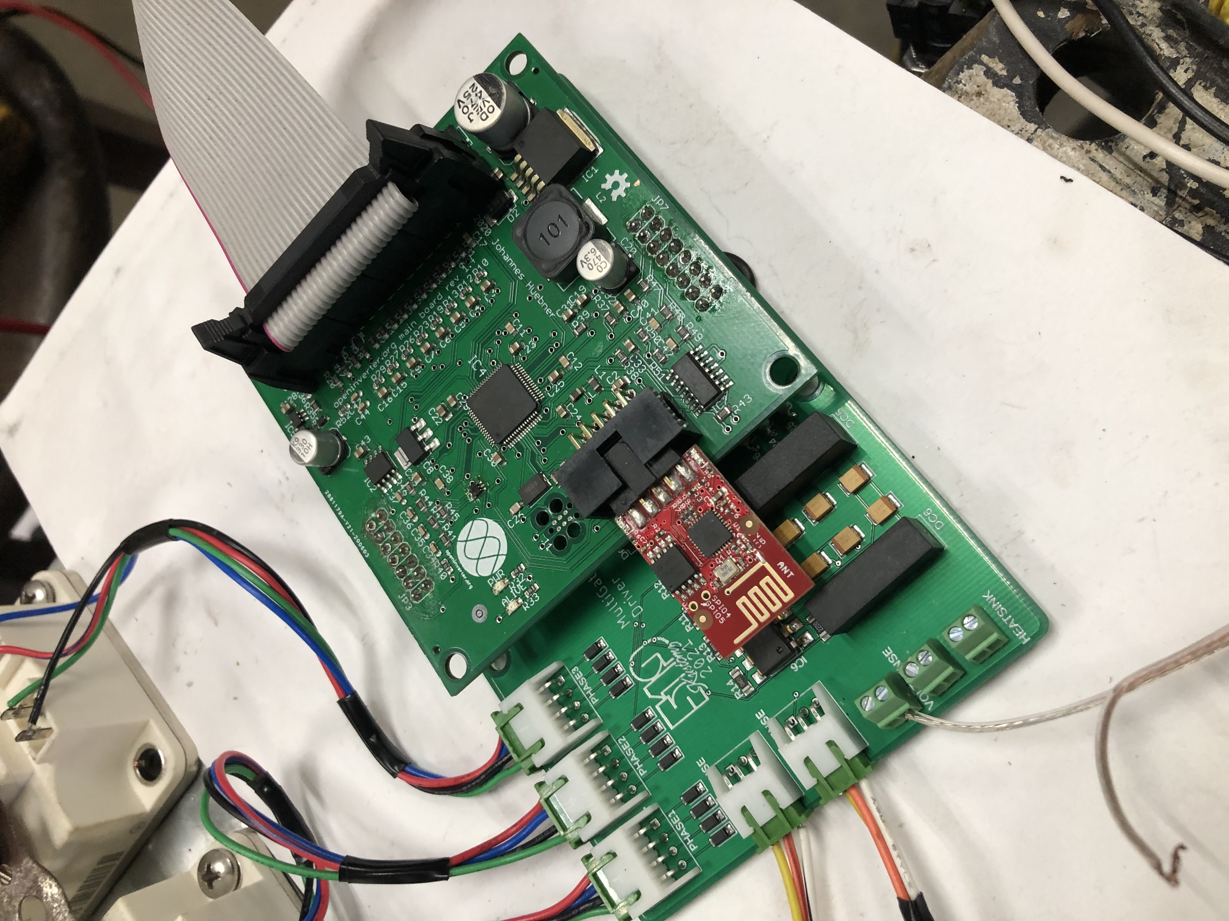

EDIT: thats a nice gate drive board in the video, do you have some details?
- Posts: 9
- Joined: Thu Mar 14, 2019 1:05 pm
Yeah absolutely! Here is a couple pics of the gate driver board. It has the sense connections on it as well and is designed to stack your main board. Also included a 5v / ground tap I use for the throttle pedal.

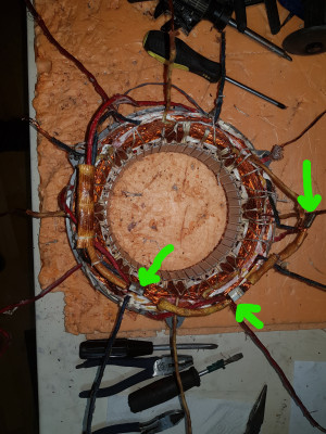

Got some bad news on the rewiring front, the MGR consists of 48 poles meaning 16poles per phase and 4s4p configuration. I've designated the half dozen transaxles I currently have as engineering samples so if anyone has any recommendations for rewiring I would be happy to hack at the windings without concern for function afterward. My hope is that I'll find one of the new style MG1 stators from a prius that will fit inside the MGR housing as the diameter is the same as at least one generation.
Bear in mind I haven't opened mine up yet, this is just based on another photo earlier in the thread, but I would suggest trying to find the three crimps I have arrowed in the picture below. These appear to form a star point so you should be able to cut the crimps and reconnect the resulting 24 ends into a delta for running at higher speeds with lower voltages. Personally I am holding off on opening up mine for a couple of reasons, I haven't found motors in general to be too fussy about voltage (within reason, maybe this will be an exception?), I haven't got a car to put it in or built a suitable test rig yet, and Damien appears to have got his subframe mounted back in the blue yacht so I am happy to wait and see what happens there. viewtopic.php?p=23617#p23617AdvancedEnergySys wrote: ↑Sun Feb 07, 2021 8:42 pm if anyone has any recommendations for rewiring I would be happy to hack at the windings without concern for function afterward.
Similar thoughts here.180jacob wrote: ↑Sun Feb 07, 2021 10:44 pm Personally I am holding off on opening up mine for a couple of reasons, I haven't found motors in general to be too fussy about voltage (within reason, maybe this will be an exception?), I haven't got a car to put it in or built a suitable test rig yet, and Damien appears to have got his subframe mounted back in the blue yacht so I am happy to wait and see what happens there.
1) If the 450H can run 70mph on <500v, why not the MGR? Clearly I am not an EE and do not play one on the net, but....
2) I do not need high speed, 50 is fine.
3) It seems like the Gen3 Toyota stuff can be CAN controlled, if so, maybe the Gen2 as well. If the inverter simply responds to Tq request, BINGO!
4) I am fairly certain the MGR resolver will not be plug-n-play with a Prius inverter, but am willing to try.

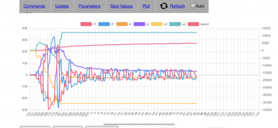

Did some more thorough testing this afternoon.
High load, full throttle runs from standstill to 30mph up an incline.
With booster at 530V (see plot below):
- throtcur at 3, AC motor current shows 300A
- max DC current of 160A according to my JLD404 (approx 50kw)
- strange behaviour of idc on the plot. Not sure why it does this?
- noticeable drop in torque as 30mph is approached
- DC current drops quickly back below 100A after peaking
- enough torque to spin the wheels when pulling away hard

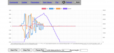

Full throttle run from standstill to approx 50mph up an incline:
I tried increasing and decreasing the throtcur to 4 and 2. Noticeable difference below 30mph but not above.

Great testing tom3141!
Yes, I experience a very similar behavior of the significant decrease in acceleration when going into field weakening region. Iq drops to 30% of max with little change in speed.
This is not what I expect but I only have a very little understanding of motor drives and FOC.
I expect roughly constant torque and increasing power up to FW (field weakening) and then close to constant power as speed increases and torque decreases. Maybe this is to much of a simplification?
Anyway the MGR is proably designed to provide high torque at standstill to very low speeds and then only beeing able withstand high speed operation as always connected to wheels but not providing much torque at all at this high speed.
The package of the MGR is very convinient but it seem to not be suitable to drive a vehicle up to road speeds.
