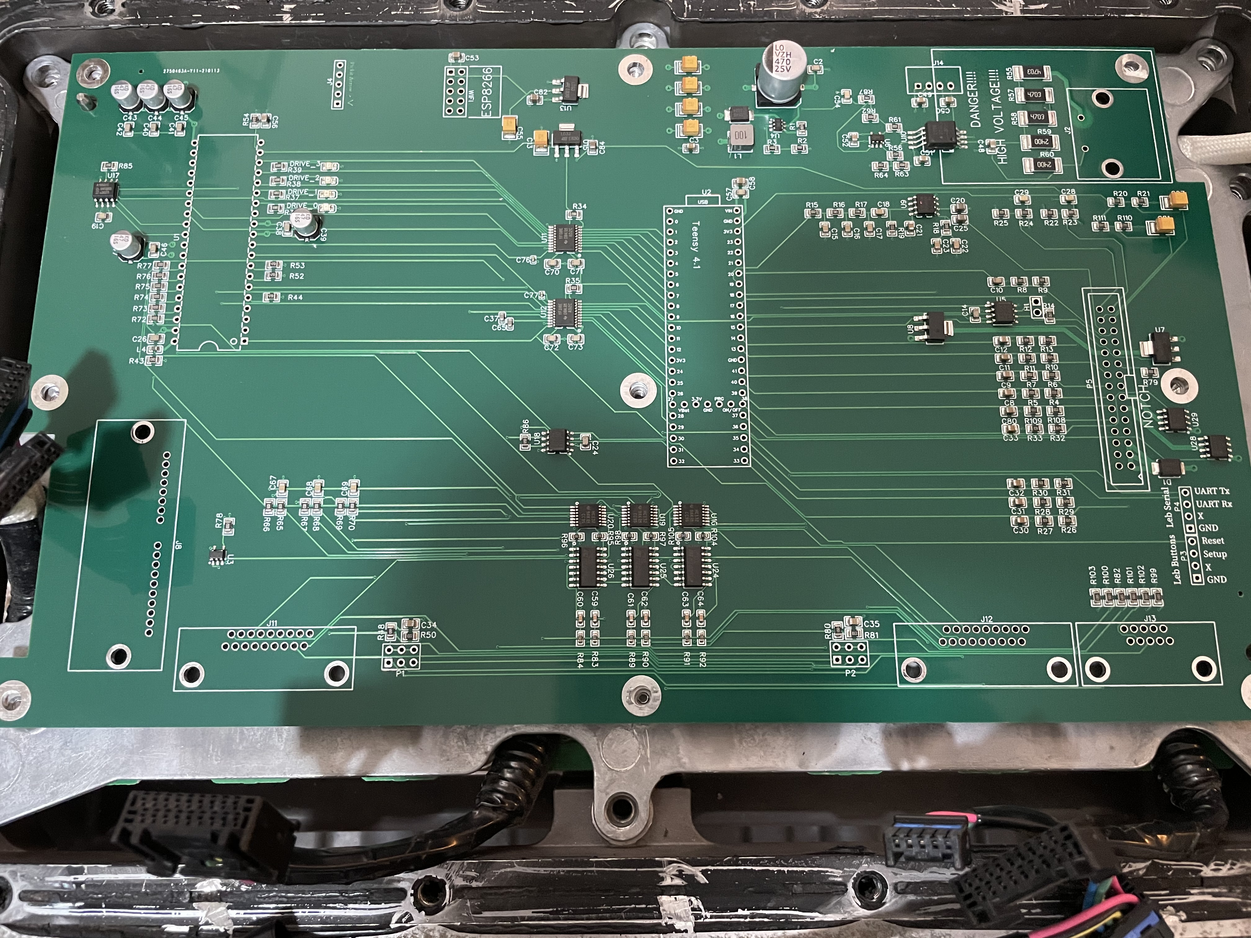

Hello, I'm sharing my inverter project. It uses the Lebowski brain (I really want the sensorless control) and it uses the power stage from a Volt/Amp era. I have based somewhat it on Bas' original design, but I have added components from Arber's design, Damien's designs, and some of Johnannes designs as well. I'm about to order a few of them. Here are some features I added:
I am using hardware overcurrent that doesn't shutdown PWM, instead it only turns off that IGBT (using comparators and logic gates). I plan on using it for drag racing, so I don't want 1 IGBT to cause me to lose a race. Also the logic gates invert the signal from active low to active high.
I'm using a Teensy 4.1 to convert the resolver into a UVW signal for low RPM. With IPM motors, the advance angle isn't static (research MTPA if you don't understand). Lebowski's brain compensates in sensorless mode, but not sensored.
Im using Teensy for all external interfaces (since I have it anyway). This way I can use its killer 600Mhz processor (and the awesome math hardware) for all the extra IOs Im adding.
The Teensy is also communicating with the Leb chip for throttles, reverse, temps, and monitoring its Reset pin (in case of desat, as well as holding it in reset until the contractors are on. Eventually I want it to send the throttles and reverse over CAN, but Bas said its not standard CAN, so for now I have CAN and analog signals between them.
Teensy will also be monitoring the UART from Leb, and send data out over the external CANbus. Also will send out the same data to the esp8266 for wifi (it will be basic, pretty much the same as the Lexus GS450h wifi).
Any comments on the schematic/PCB layout are welcome! I'm still laying out the hardware (so you can ignore them for now). I'm hoping for some feedback to make sure I haven't made any bonehead mistakes in the schematic.
I haven't used the TXS0102DCUR before (for 3.3V to 5V translations). I'm hoping it can sink enough current to drive the RC filter for the analog throttle signals and overcurrent RC filter (I think it should?).

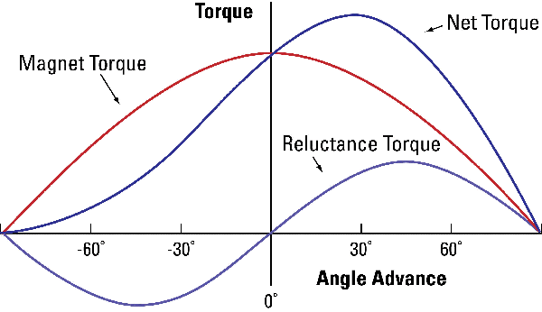

Another question. How do you intend to tell the brain you advanced the current angle. As i remember this is changed by applying more id into the mix and this changes your reluctance torque. But you are correct. Lebowski does not correct start for IPM motors.
IPM should see best torque angle on start at 120deg instead of 90deg as other motors. See pic.
Theory says reluctance torque component with IPM is more dominant with large amp loads, such as on start. I should be able to apply more amps to armature here, but system wont let me.
With this i get really lame torque on start. To offset that i reduced FOC stator resistance by factor of 3. So i use like 48mR value where system should have 180mR. Then motor really shows power, but consumption goes up too!

So the teensy constantly will track the motor position from the resolver. To calculate the advance angle, you need to know 2 constants, Rotor Flux (IE RPM per Volt), and the difference between the inductance from Ld to Lq. In traditional surface mounted BLDCs there is no difference, hence no additional advance needed. IPM motors there is some. The rotor flux is in volt–seconds per radian (V⋅s/rad). For example, a Nissan Leaf motor should be around ~0.00712 for the rotor flux, and the difference between Ld and Lq should be around 30 micro Henries. You then find the needed Id current with the top formula (I have it in spreadsheet form):arber333 wrote: ↑Fri Jan 08, 2021 11:34 pm Another question. How do you intend to tell the brain you advanced the current angle. As i remember this is changed by applying more id into the mix and this changes your reluctance torque. But you are correct. Lebowski does not correct start for IPM motors.
Then use the bottom formula to find the Iq current. Then your total advance is the arctan (atan) of id/iq.
For my example above, 50 amps of commanded current is ~101.25 degrees advance, 500 amps is ~126.75 degrees advance, and 1000 amps is ~130.5 degrees advance.

Ok, got my PCB layout done. Its called Lebowski_Resolver_PCB_Final (the one on the bottom of the link).

I got my boards from JLCPCB! Took longer than last time I ordered some, but they are more complex too.

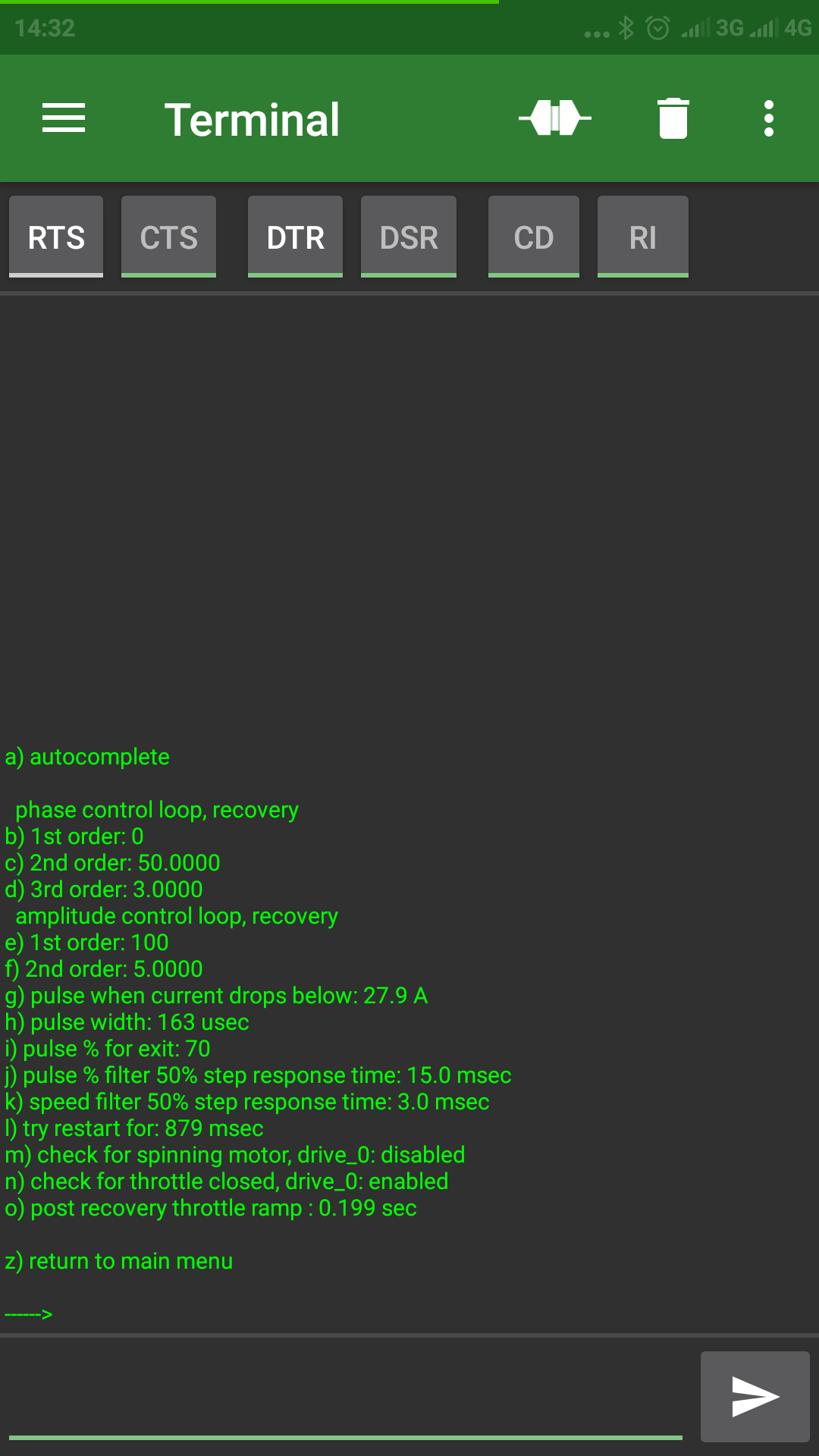

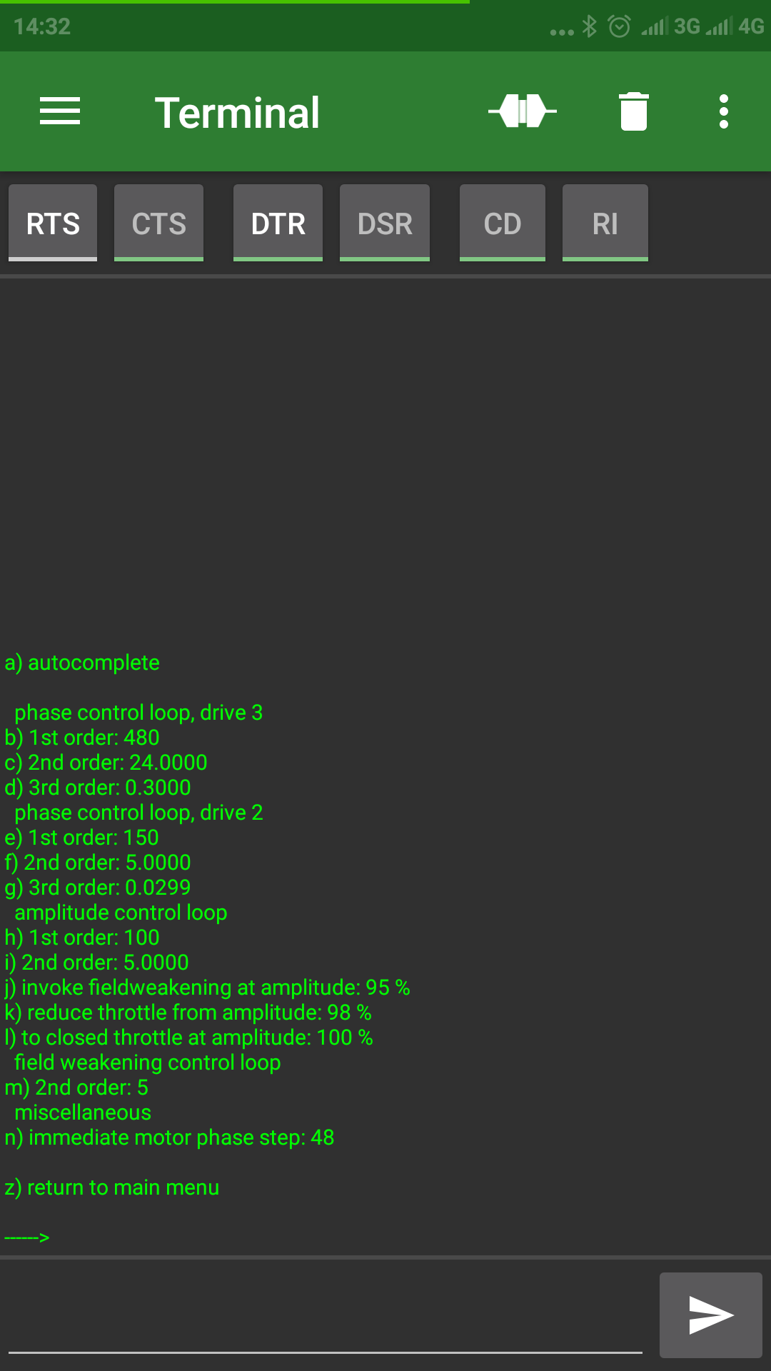

I dont know if this falls into the correct category as it is firmware related, but since i use Volt inverter with Lebowski brain i will post it here.
Since my Lebowski drive is shaking on start i went to play with control parameters for its hyperbolic governor. Idea is to have as short as possible mode 2 range where control runs on hall sensors alone. Those create a lot of spikes in control.
Also i noticed at higher speeds Lebowski should recover but for some reason it cant untill speed falls to 70km/h. I tried to get to at least 110km/h because of traffic on both lanes of highway can deal with that speed. If you need to play with settings do read Lebowski user manual.
I also managed to get an OTG USB C cable and connected RS232 serial gizmo to my phone. Together with Android terminal app it is easier than ever to tune up my car on the road. I only could do it easier if i had Wifi connection like Openinverter
First i played with option h) pulse width. I found out best for my system was 165
Then i tried to change the b) and c) filters. Together with lowering i) and raising time for the pulse l) i managed to bring the recovery up to 110km/h. Now it is much safer if motor goes out of sync on highway. I can safely lower the speed to 110km/h and motor recovers every time. My settings are in the screenshot.
Next emboldened i went on to menu g) and tried to change parameters for drive 2. I noticed with recovery if i lower the gains function gets sharper but also smoother. So i changed option e) to 150 and instantly i got better start... not a whole better, but i could tell it made a difference. So i went and lowered the f) option to 10 and then to 5.
I also noticed in menu h) there is a b) filter option for drive 2. I tried to increase it to dampen the vibrations and it did help. I have it set to 220.
I still have some twiching at very low speeds, but i can now overcome them by give it more throttle and motor takes off directly.

Do you have a schematic or bom for the resolver to uvw board by any chance?

Not directly. I will get one encoder board from kiwifiat someday now and test it on my application.Jack Bauer wrote: ↑Mon May 03, 2021 9:50 am Do you have a schematic or bom for the resolver to uvw board by any chance?
Other than that i would recommend to go by mechanical route with RLS board and magnet because it really works and is a repeatable solution for various brain options.
You would still have to machine a mount for RLS encoder PCB to go in place of resolver, but once there it is really easy to replace just the PCB and you can have sin/cos, UVW or just ABZ signal.

The design files will be up on Github in the coming weeks. I''ll post here when it is done. Currently tested on the Nissan Leaf and Hyundai HSG motors that both have a 1:1 relationship of pole pairs to resolver lobes.Jack Bauer wrote: ↑Mon May 03, 2021 9:50 am Do you have a schematic or bom for the resolver to uvw board by any chance?

If you're asking me, I can share my design no problem, but I'm just using a Teensy and generating the UVW signals with it. I'm calculating the angle, applying the MTPA formula and then outputting that to the UVW signals (the complex math it can do in hardware, so no calculation delays). My plan also taking in the temps from the Volt inverter and motor, and sending them to the Big L also.
Basically Im using the Teensy 4.1 as a gateway to the entire outside world (I have analog inputs, but eventually migrate to CANbus).
