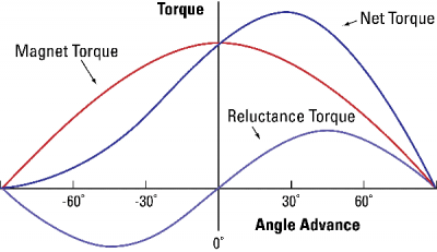

Another question. How do you intend to tell the brain you advanced the current angle. As i remember this is changed by applying more id into the mix and this changes your reluctance torque. But you are correct. Lebowski does not correct start for IPM motors.
IPM should see best torque angle on start at 120deg instead of 90deg as other motors. See pic.
Theory says reluctance torque component with IPM is more dominant with large amp loads, such as on start. I should be able to apply more amps to armature here, but system wont let me.
With this i get really lame torque on start. To offset that i reduced FOC stator resistance by factor of 3. So i use like 48mR value where system should have 180mR. Then motor really shows power, but consumption goes up too!
So the teensy constantly will track the motor position from the resolver. To calculate the advance angle, you need to know 2 constants, Rotor Flux (IE RPM per Volt), and the difference between the inductance from Ld to Lq. In traditional surface mounted BLDCs there is no difference, hence no additional advance needed. IPM motors there is some. The rotor flux is in volt–seconds per radian (V⋅s/rad). For example, a Nissan Leaf motor should be around ~0.00712 for the rotor flux, and the difference between Ld and Lq should be around 30 micro Henries. You then find the needed Id current with the top formula (I have it in spreadsheet form):
Then use the bottom formula to find the Iq current. Then your total advance is the arctan (atan) of id/iq.
For my example above, 50 amps of commanded current is ~101.25 degrees advance, 500 amps is ~126.75 degrees advance, and 1000 amps is ~130.5 degrees advance.
See this post on ES for more details (and where I got the corrected formula from):
https://endless-sphere.com/forums/viewt ... a#p1564821
The beauty of it is, you can figure out the rotor flux very easily. Set Lebowski to 0 field weakening current, and max out the RPMs on whatever size battery you are using. Then the amount of tuning needed is adjusted by only changing the Ld-Lq difference until the best results are achieved. I'll be starting with the Lexus GS450H trans, so there are 2 motors. I can set 1 to Regen and the other to motoring and it acts as a dyno!

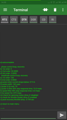

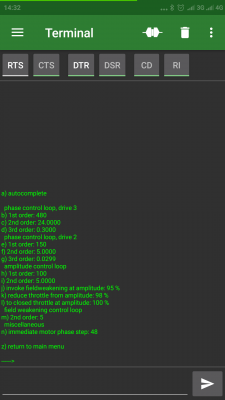

I dont know if this falls into the correct category as it is firmware related, but since i use Volt inverter with Lebowski brain i will post it here.
Since my Lebowski drive is shaking on start i went to play with control parameters for its hyperbolic governor. Idea is to have as short as possible mode 2 range where control runs on hall sensors alone. Those create a lot of spikes in control.
Also i noticed at higher speeds Lebowski should recover but for some reason it cant untill speed falls to 70km/h. I tried to get to at least 110km/h because of traffic on both lanes of highway can deal with that speed. If you need to play with settings do read Lebowski user manual.
I also managed to get an OTG USB C cable and connected RS232 serial gizmo to my phone. Together with Android terminal app it is easier than ever to tune up my car on the road. I only could do it easier if i had Wifi connection like Openinverter :).
First i played with option h) pulse width. I found out best for my system was 165
Then i tried to change the b) and c) filters. Together with lowering i) and raising time for the pulse l) i managed to bring the recovery up to 110km/h. Now it is much safer if motor goes out of sync on highway. I can safely lower the speed to 110km/h and motor recovers every time. My settings are in the screenshot.
Next emboldened i went on to menu g) and tried to change parameters for drive 2. I noticed with recovery if i lower the gains function gets sharper but also smoother. So i changed option e) to 150 and instantly i got better start... not a whole better, but i could tell it made a difference. So i went and lowered the f) option to 10 and then to 5.
I also noticed in menu h) there is a b) filter option for drive 2. I tried to increase it to dampen the vibrations and it did help. I have it set to 220.
I still have some twiching at very low speeds, but i can now overcome them by give it more throttle and motor takes off directly.
