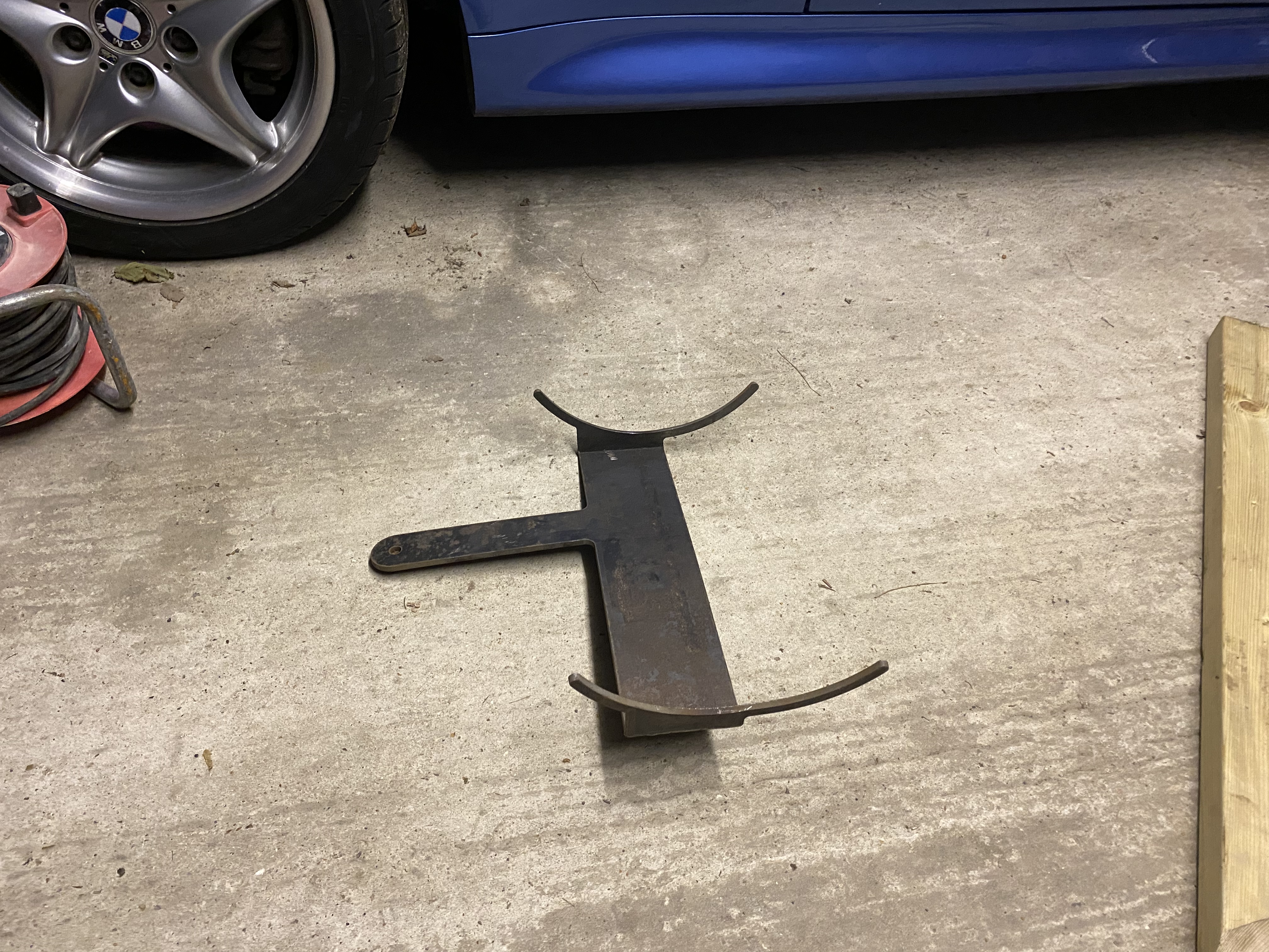

Great project - don't suppose you have any more pictures of your trolley jack / LDU support thing? I need to knock something up myself and rather than reinvent the wheel.......

It’s very stable and means the LDU can be manoeuvred and raised into the car with relative ease, just by use of standard trolley Jack.Hi THere,
Re: Porsche Boxster 986 Tesla conversion
Thanks, much appreciated.
What's the point of the hole at the end? Bottom left corner of the picture above?

Not required. It was there in case a separate bracket was needed for stability (it wasn’t).

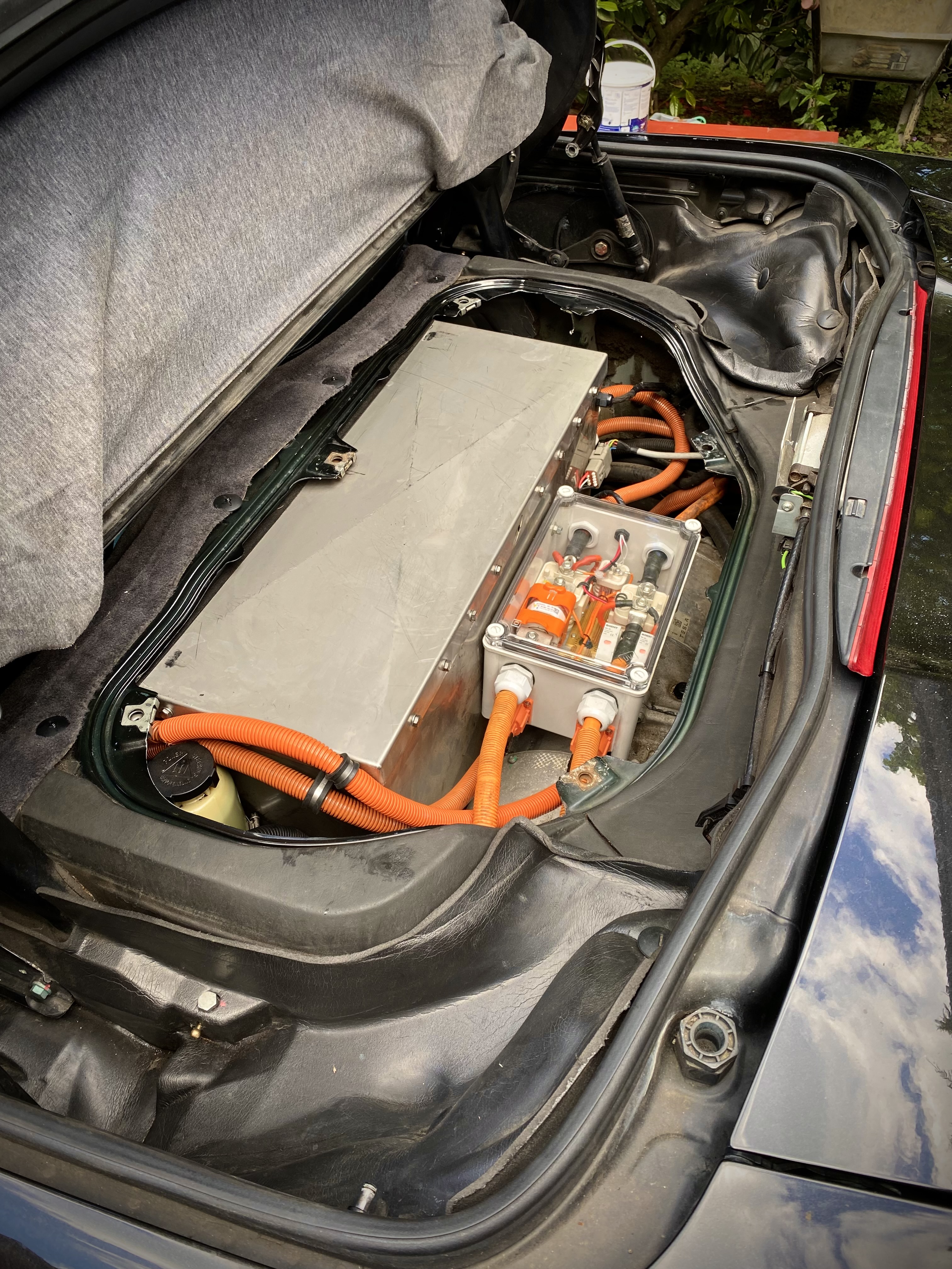

I've been following this build from the start and am trying to replicate it - so far so good. I have a couple of questions regarding the HV electrics.
1) Where did people put their manual disconnect? Should it be mounted close to the main contactor box or should it be accessible without having to pull the engine compartment cover? My main contactor box is mounted on top of the LDU. I have two battery packs (one between the firewall and motor and the other under the trunk).
2) Should I have second contactor box and individual contactors for the other HV components such as the charger, DC/DC converter, heater, etc.? All of these will be individual fused and have a manual switch in the cab.

I can’t speak about best practice, just what I’ve learned from others and read applicable to the Porschecanadasconvert wrote: ↑Sat Nov 13, 2021 6:52 pm I've been following this build from the start and am trying to replicate it - so far so good. I have a couple of questions regarding the HV electrics.
1) The HV disconnect switch is mounted in the middle of the pack. It’s physically located in the battery box under the boot floor inside another smaller HV box. This box has the battery fuse and another HV contactor (closes on ignition on / charge).
2) My charger and DCDC both have separate 15 amp HVDC fuses. Their + feed is connected to the battery side of the main contactor and the - side connected to the motor side of the negative contactor. I have a LV relay set-up and logic that’ll close the negative contactor during a ‘charge state’ but not power-up the VCU or other aux LV systems that aren’t required for charge (except water pump). Obviously the relay logic will also allow the negative contactor to close during ‘ignition on’ state.
There is another small HVJB in the front of the car that is housing the HV contactor for the PTC heater and charger stuff. It also has the 240VAC relay coil.
There is no HV continuity anywhere unless the car is on, or charging.

I’ve been running a UP28 vacuum pump for brakes over the past year and a half. It works well but the downside is the irritating noise kicking-in every few presses of the pedal. Therefore I decided to follow in others’ footsteps and fit a Tesla (Bosch) ibooster. Details on this unit and how to run it can be found on the Lar’s EVCREATE website: https://www.evcreate.nl/wiring-the-tesla-ibooster/
Old set-up - the booster is underneath the enclosure on the left:
Old parts ready for the recycling pile:
Installation is straight forward and the bolt patterns make it almost plug n play for the Porsche. The tricky part is that the ibooster physically mounts high-up and consequently was fouling on the car’s bonnet when closed. To overcome this I had some nylon brake fluid resistant 3d printed low-profile manifolds made that allowed me to remove the tesla reservoir and re-install my lower form factor OEM Porsche reservoir which sits in a custom stainless bracket and bolts directly to the Ibooster's sensor mounting.
