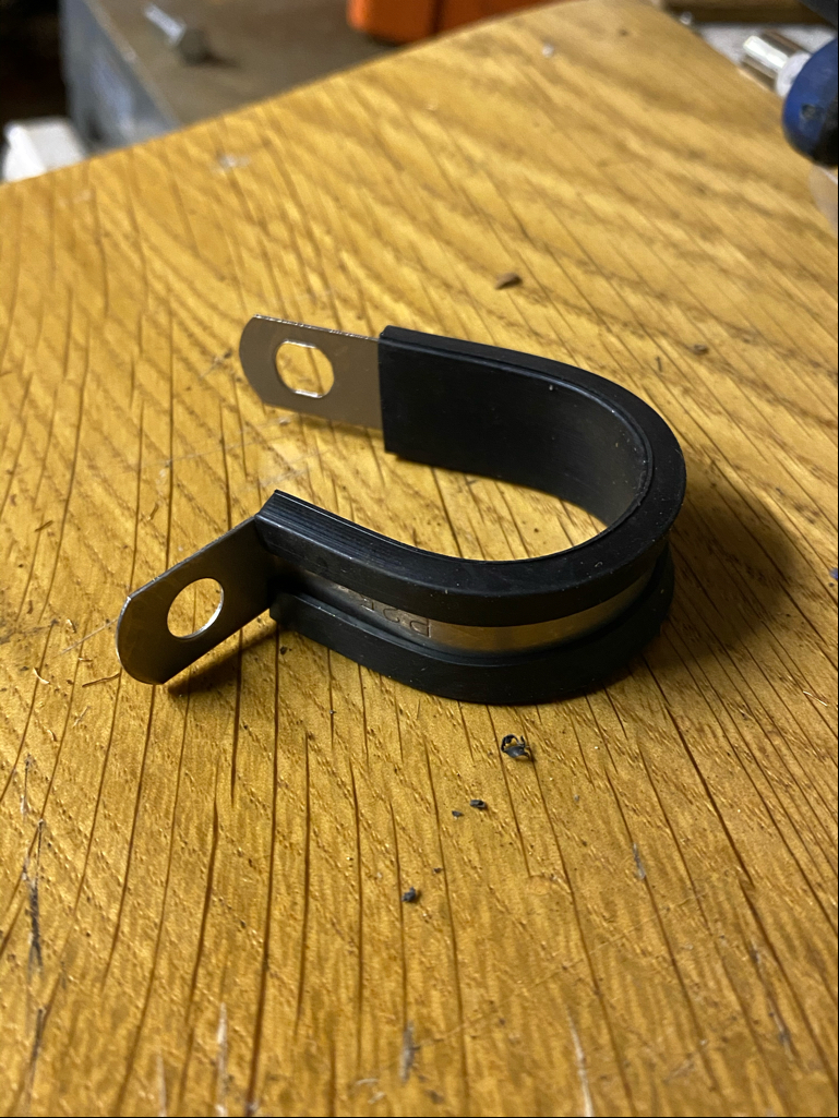

As ever the main 12v + feed is housed in 20mm conduit and clipped down using stainless rubber lined clips. These things are a very cost-effective solution for the HV lines too.
The steering is working as expected and I'm pleased the pump noise isn't as intrusive as feared. Just been for 20 minute drive around town and no leaks so far. Inspired by the Red Arrow project, it's hard to beat the TRW solution in bang for buck terms.
