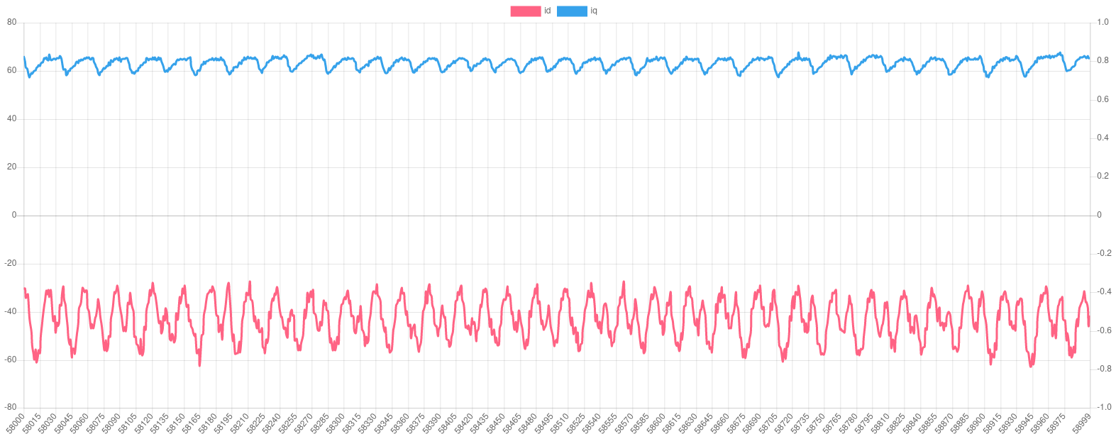

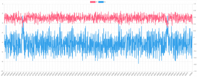

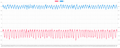

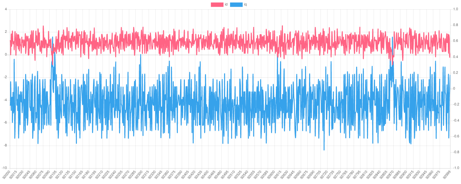

Here is something you can try. I have increased the S&H time to 7.5 cycles and samples to 10. That means it contains values from 133us, so 2 values from the last PWM cycle actually.
It doesn't feel much different because the vibration is subtle anyway, but maybe it makes a difference on your cars.
Also took an id/iq plot while slightly pushing against the handbrake. You see the oscillation is less with more filtering.
EDIT: il1 and il2 also jitter a similar amount, so I don't think the resolver is the issue.
EDIT2: When no PWM is present the jitter is less, I think that would be the actual ADC jitter. Just a few amps, won't be noticable mechanically.

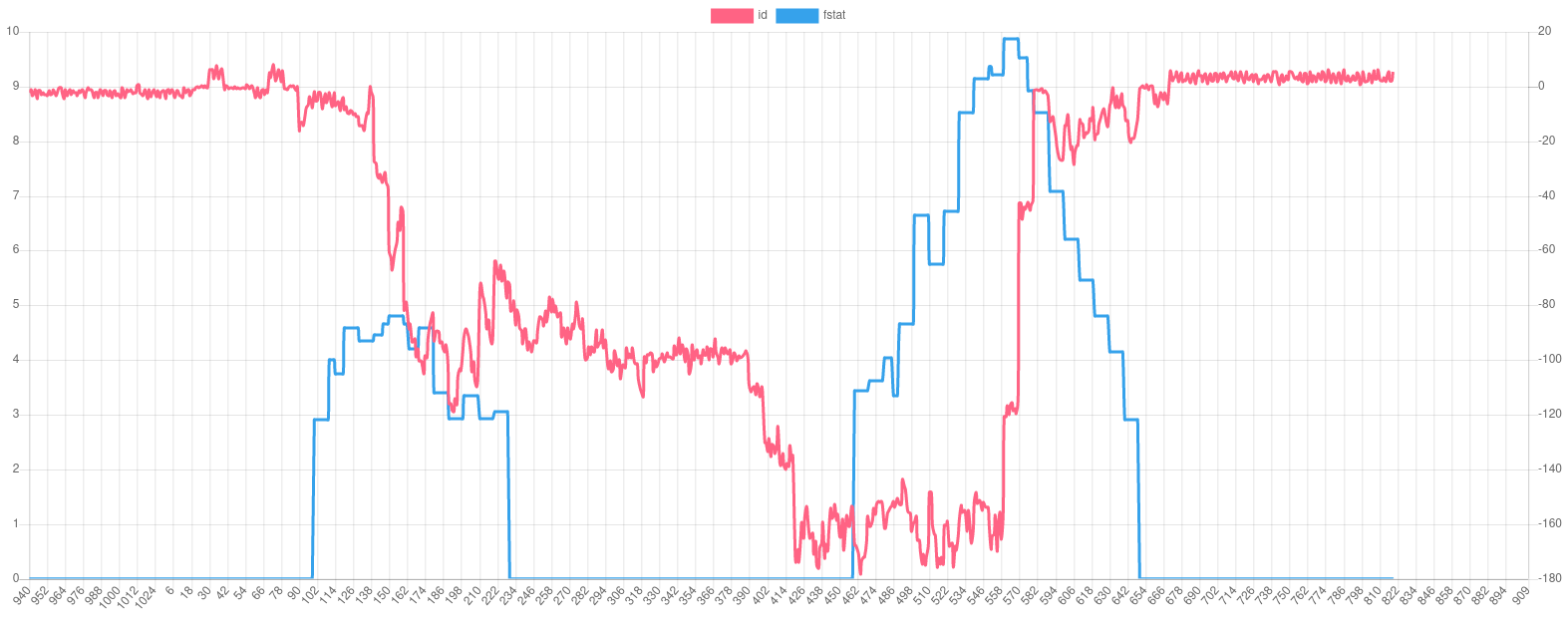

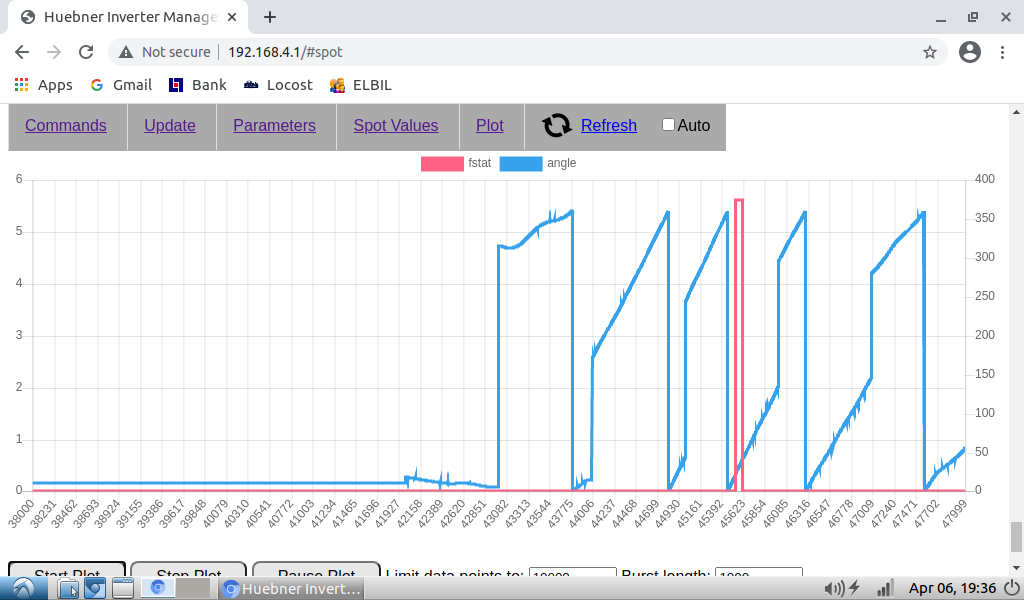

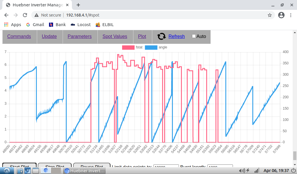

I have tested the new SW and the result is no change in stuttering. There are less noise on the id and iq, just as johu got.
I did find something else which I don't understand. Why does fstat go from 0 to 5 in one step, can't get anything in between. I can get the car moving but 0 fstat. Could this have effect on stuttering at very low speeds? Also, there are some disturbance noticable on angle at least when I drive slowly, seen in above picture as well. Hard to see if I go any faster.
A note on having averaging over more than one switch pulse, this could lead to instabillity as you can have changes in output without correspoding change in feedback signal. In this case there is only a small overlap so should be ok for testing.
EDIT: added one more plot to better illustrate the jump in fstat. Above fstat 5 there looks to be any value possible.

frequency calculation happens every 10ms. But only if the rotor has moved more than 10 resolver degrees within 10 ms. By my calculation it should pick up at 2.7 Hz but maybe I forgot something. fstat is used in a few calculations, like regenramp and dynamic integral gain. But since you already tried disabling the latter, it's not that.

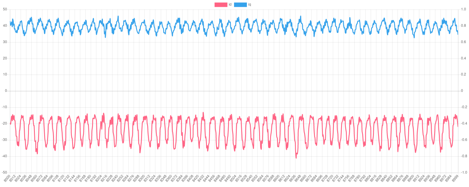

No, not that either. Have programmed it to start advancing at 10 Hz now but the stuttering actually happens before.
It is visible on the plot as about 40A oscillation of id.
You can see frequency picks up at about 2.8Hz. I think it is 5Hz for you because you have a ratio of 1:2 between stator and resolver.
Still attached the binary, maybe it does something. Also changed sample size to 8, so now all values come from within the last cycle.

This is with ~120 digits of noise on sine and cos inputs, 6 polepairs, and 1 respolepair (encoder chip). I suspect 'better' setups won't see quite as much difference.
.bin and .hex files attached, code here: https://github.com/mjc-506/stm32-sine/c ... 913386057a and I will do a pull request Johannes? (These are based on the pure unaltered 5.03.R code)
I think though, that none of the new parameters are needed (they shouldn't need adjusting by the end user - may need adjusting for major code/hardware changes but the 'frequency' variable would probably handle most of that. Also, I see no need to retain the old atan2 code, and no need to have a value on the web interface displaying it either (once well tested of course). In addition, a few of the intermediate variables may not need to be 32bit (cos_sin_anglast, sin_cos_anglast and sum1 could probably be int16_t, sample_delay_comp could probably even get away with int8_t...) but the extra few bits guards against unexpected inputs, especially at startup.
One point of concern: On my hardware, and with my firmware (including other edits), I get no braking/regen - for example, with pot at ~50%, applying pot2 >50% will actually appear to increase throttle and the motor accelerates further (reducing both pots to zero means potnom drops to zero and the motor stops, and increasing pot2 from a stop doesn't start the motor). I can't see any reason that these code changes could/would cause that, and it's entirely possible something strange with my hardware and/or firmware edits is causing this, but please be aware that there's a potential issue here.
Thanks for your help and patience. I seem to have some success! Check this out: The left hand side of the graph is the 'new' TI observer code, the right hand side I'd switched back to the 'original' atan2 code. There is a small difference Also shown is the raw angle from both codes at the same time - you can just about see the new observer trace peaking out from beneath the atan2 trace.

That looks very good! I don't quite understand what I'm seeing though. Should angle and angleatan look the same in the right half of the plot?
Yes lets test some more I had some similar code for calculating speed from angle change and it turned out too slow on fast speed changes, e.g. a wheel loosing traction and spinning up would trip out the inverter.
No worries about variable sizes, we have plenty of memory.
- mjc506
- Posts: 343
- Has thanked: 30 times
- Been thanked: 28 times
Re: FOC low speed stuttering
angleatan and angleobs are resolver degrees (and equal to mechanical degrees on my hardware), angle is scaled somewhere to electrical degrees. My hardware is 6 pole pairs and 1 resolver pole pair, so noise and angle are both *6.
The TI observer can output speed directly, I can add that in?
