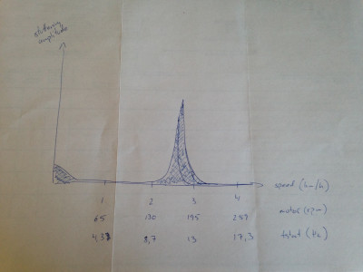

Been doing more testdriving.
I'm experience low speed stuttering at 2-3km/h. I'm running SW 5.00 but experienced the same thing with SW 4.94.
It happens around 2-3km/h => 150rpm(130-195) motorspeed or 10Hz fstat.
At higher speeds it is very smooth. At lower speeds much smoother so there seem to be a short steep peak at close to 10Hz fstat which is very odd to me?
My parameters:
My parameters:

Interesting!
I tested with setting the brkrampstr to 50 and that helps in getting smoother stops but, to what I could note, no effect on acceleration.
A note as well, I get the same behavior in reverse as in forward. So not dependent on motor direction.
To be very clear, during a very slow acceleration,
0-2km/h there are some very small hesitations, barely noticable.
2-3km/h quite noticable shaking.
3->km/h smooth
3->km/h smooth

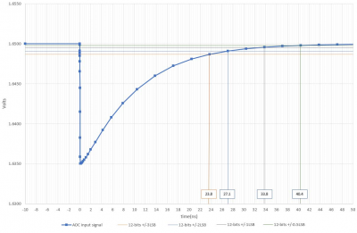

Here is an interesting information from ST regarding resolvers. Maybe test a 3,0V voltage reference for STM32, VDDA supply, should reduce ADC noise. Will require adjustment to both HW and SW, but reasonable.
Or even use of another STM32 with separate Vref and ADC supply? Requires totally new HW and most likely largely changed SW as well so not the first one to test.
I can't help much with SW but I should be able to help with HW upgrades and testing, if wanted.
Regarding current feedback I don't think there is much you can do with HW. The current transducers should have resonable drive capabillity. Possibly use of a filter with lower impedance to reduce effect of ADC.
Regarding the resolver more can be done but it will for shure complicate the HW.
- Been thanked: 1914 times
Re: Renault Clio Electrique -97
On the mini mainboard I decoupled VDDA with 100uH and 10uF from VDD instead of 10uH/1uF on the V3 mainboard. That decreased ADC noise. Can you try that?
But I do suspect the noise comes from outside.
Filter-wise it doesn't really matter whether filtering is done in SW or HW. HW filter is also crap in -> signal out, the same can be done in software.
I studied the paper a bit, unfortunately no real surprises. They use opamps for adding gain and offset where we just use resistors. They low pass filter at 150 kHz, we at 60 kHz.

According to the BOM for the Yaris board there should be 10uH/10uF on my board.
In attached ST paper I found that they recommend using 1uF in parallel with 10nF for decoupling of VDDA (page 24). Also, they talk about reducing inductance as this can cause oscillation and use ferrite cores as well. Overall, I agree with that the noise probably comes from the outside but VDDA is a very sensitive point as it effects all ADC:s.
Regarding the resolver paper, they also use a voltage doubler for the resolver supply signal. That is one way to increase SNR, by increasing the signal amplitude. And the difference by using op-amps is you get much lower output impedance which might be helpful to reduce noise with the type of ADC used.
Also, using separate analog ground all the way from external connector to the ADC(VSSA) might help reduce noise.
Analog signals is a pain but also very interesting...
EDIT: Maybe a good idea to source a extra motor with resolver. Then I would have a complete extra setup, not needing to do all testing in the car.
Yes actually I have a Prius transaxle here, just need to get the resolver plug and I could test with Gen2 Prius board.
I found an interesting plot in that AN, voltage dip on a 1k/2nF filtered signal. Suggests the signal has fully recovered after 34 ns. We are running 9 MHz ADC clock, so that would be about 4 clock cycles. But I just programmed 1.5 clock cycles sampling time. Can check the influence of that. But even after 1.5 cycles the signal has recovered mostly. Back when I experimented with the resolver I couldn't see any influence of the sampling time.

Maybe I'm misunderstanding but 9MHz give a period time of 111ns and so 1,5 cycles for sampling would take 167ns.
Wouldn't this then result in the measurement is taken when the signal is fully recovered?
Re: FOC low speed stuttering
Oh, of course. Thats why it made no difference

I have now tested setting both curkifrqgain and fwkp to 0. I can't notice any difference between default value and 0. Tested a bit back and forth.
I'm attaching a graph of when I experience the stuttering. The first just above 0km/h is barely noticable (no problem living with) and then a quite steep peak between 2-3km/h (anoying, specially during regen brakeing to full stop), above this nothing. More noticable with slight uphill load. The same thing applies doing regen, steep peak at 2-3km/h.
EDIT: Just beeing very specific with what I'm experiencing so that if others have similar or not at all similar behavior.

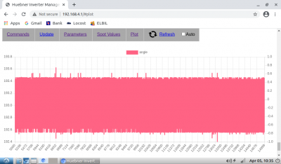

Ok, too bad. I can post a screenshot of my angle and current plot to compare noise. It was like 3° jitter on angle and 7A on current.
Will try other filtering options next.

Wild idea, feel free to shoot down... Jitter is down to noise presumably? Would a resolver to spi/i2c/etc gadget mounted right at the resolver be any help? (Minimal cabling to pick up noise, low noise related supply, low noise adc (better than the stm adc)
That of course is assuming that the noise is down to a combination of longish cable between resolver and board, noise in the analogue vcc, noisy stm32 adc?
Edit: or of course, 'just' a dedicated high quality 2 channel ADC would do it I suspect, although something designed for a resolver would probably handle things better.

Is this what you are refering to with angle and current plots? Both at standstill. No difference when in D, R or N. 10000 data points and burst length 1000.
Both currents are a bit offset but maybe within what you could expect?

I don't think this is such a wild idea. However if the OEM can manage without this then it can't be impossible. In case of the MGR, it is mounted at the rear axle and the inverter is at the front with a ~4m reaolver signal cable inbetween.mjc506 wrote: ↑Sun Apr 04, 2021 8:08 pm Wild idea, feel free to shoot down... Jitter is down to noise presumably? Would a resolver to spi/i2c/etc gadget mounted right at the resolver be any help? (Minimal cabling to pick up noise, low noise related supply, low noise adc (better than the stm adc)
If a digital signal transfer is to be used it is better to use CAN or RS485 rather than SPI/I2C. SPI/I2C are created to be used on a PCB and are not that robust.
I think the best idea is to first try to measure and analyze what is causing the errors and try to get it working as is.

Good points re software solution and oem setups.
I looked at the stm adc again last night, seems it should be able to get with 0.1deg quite easily, so there's something else going on...

johu: If you or anyone else is not experiencing what I'm experiencing then it is probably something I have done or something with my motor/inverter combination. Maybe has nothing to do with SW? Just don't want you to, again, put your time into something only I'm experiencing.
arber333 and Zapatero: Please describe a bit more in detail if you are experiencing what I'm experiencing or your behaviors are different.
I find it odd that if it is a signal/noise issue that it is so noticable at a specific speed only. Might be that when starting to move the disturbance increases and then at higher speeds it is masked by motor inertia, but still strange?
