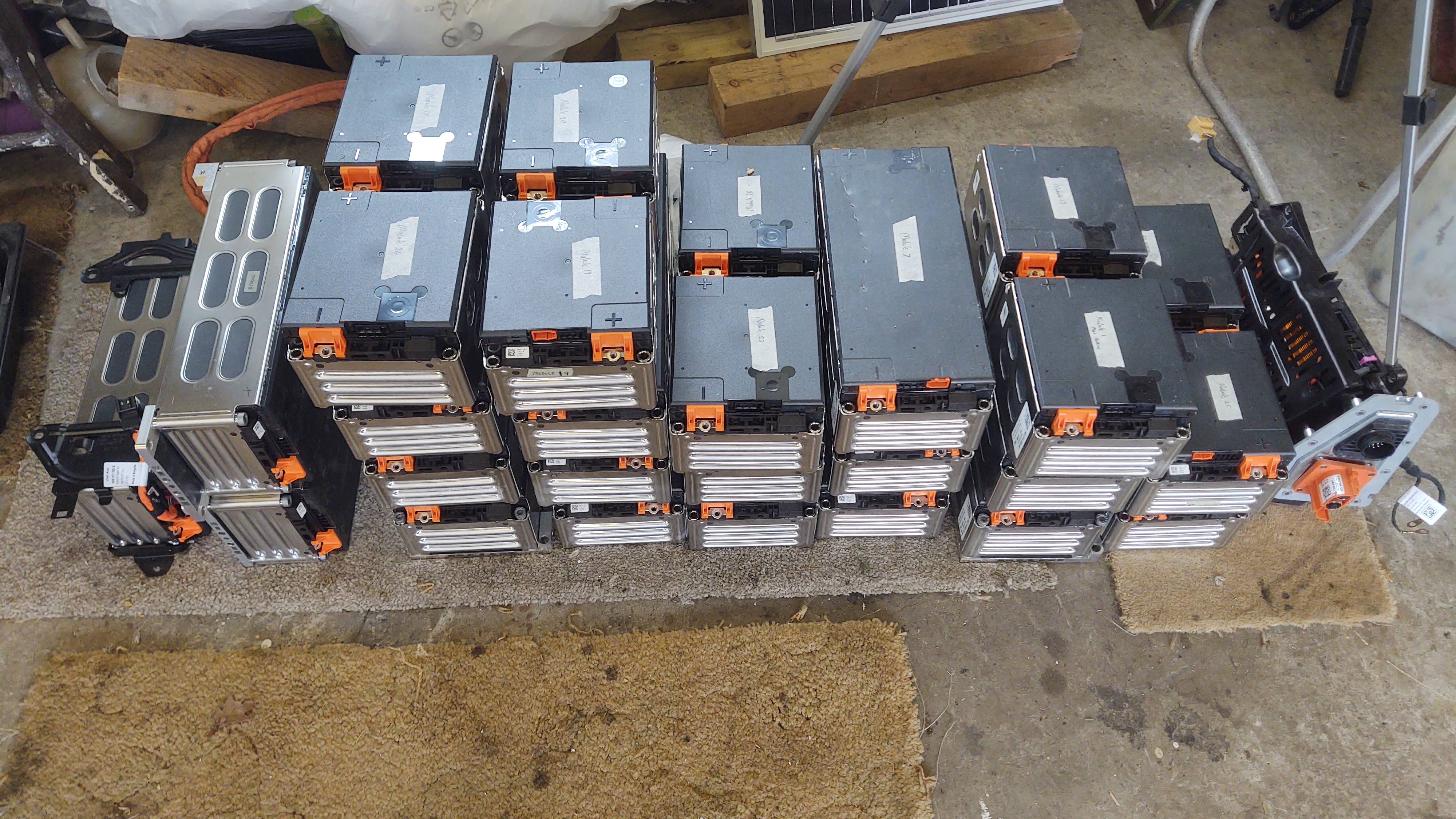

Here is a pic of the battery pack opened. I'll be posting a video about it sometime but wanted to ask you guys if there is anything you want me to do before I dismantle it.
I'm in the process of following the pixie path through the pack and marking each module and connector so once out of the box I should be able to reconnect everything as is but with better access.

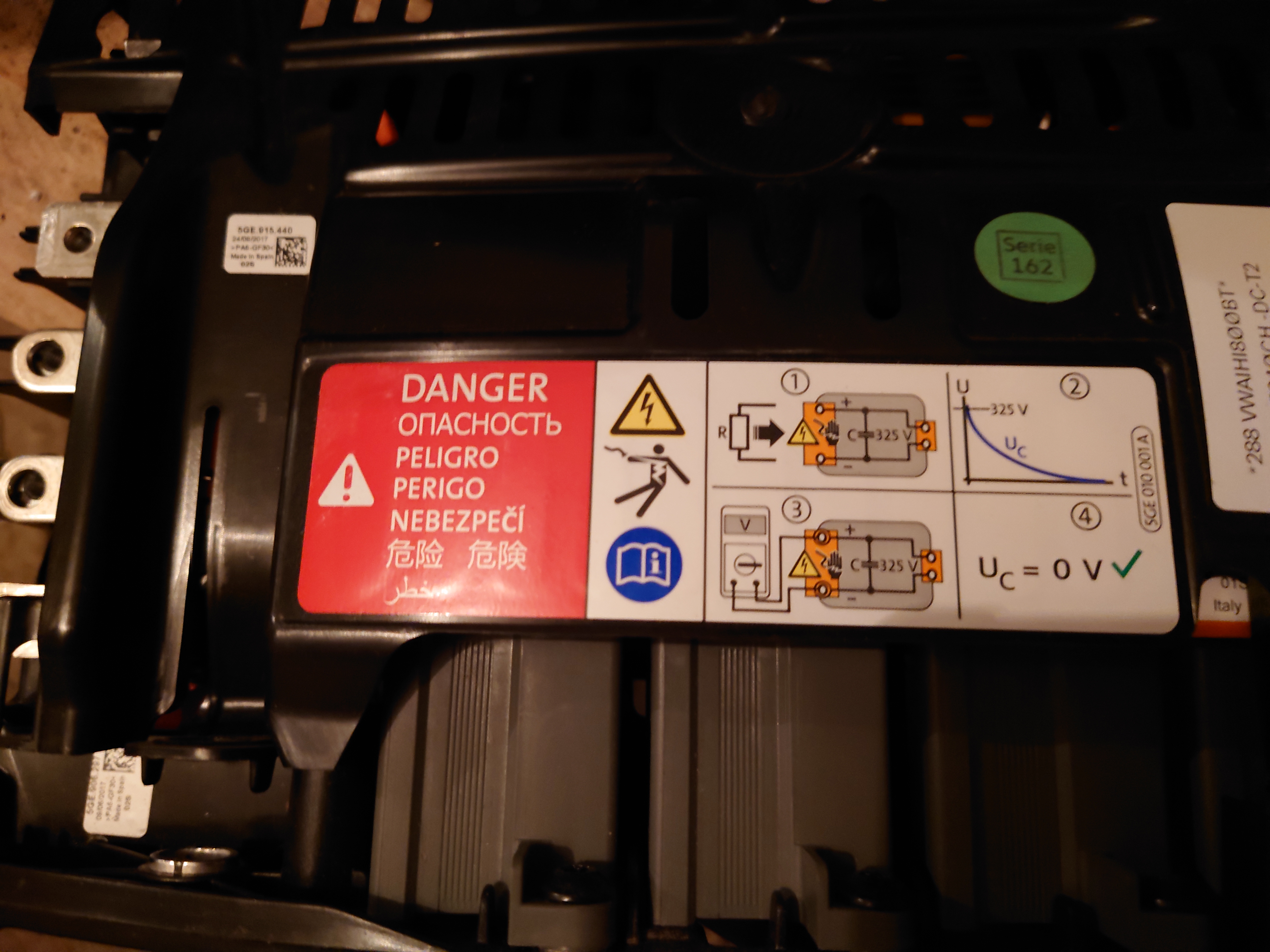

**********SAFETY WARNING**********
Sorry guys I should have posted this earlier. I'll copy it into my first post.
I don't know if all eCar packs are the same but this pack has no physical safety disconnect to cut the pack in half, it will be at full voltage until you break it down.
It also means it is at full voltage while you are cutting the top off which is not easy and if you do it wrong you WILL cut into the battery modules!! I was lucky as before I figured out the best method I slightly cut into a module with my chisel but caused no harm.
The top of the pack is some kind of fibre glass covered in metal foil. It is so well glued down you will not be able to prize it off so will have to cut the top off.
To do this you MUST cut straight down at the corner of the bottom flange. Cutting flat in towards the pack will probably result in damage and possible fire as unlike Leaf packs the modules have no protection.
I used a 1" wood chisel to cut the top off but I think one of those vibrating multitools would do it much cleaner and easier.
DO NOT use a dremel or grinder to cut the top off as in a couple of places there are BMS wires you will cut into. In my case the Chisel didn't harm them but a cutting disk would have I've never used a vibrating multitool but I'm assuming it wouldn't cut the wires either.
I'll take some photos later and add them to this post.

Allright, so we are basicly at the same expertism level here.
If I would have a full pack, I would discharge one cell a little with a light buld etc. And then try to find a way to start the VW BMS to be able to sniff if it wants to balance it and how. But mine is in parts and I don't know how to "start" the pack.
Please look at this before you continue taking it apart, there is capacitor in there to discharge.

Thanks for that.
I took out a couple of links yesterday to make it a bit safer and the cap is still at 290V.
Before I strip everything I'll stick a resistor across it.
Also I'll use a precharge resistor before reconnecting.

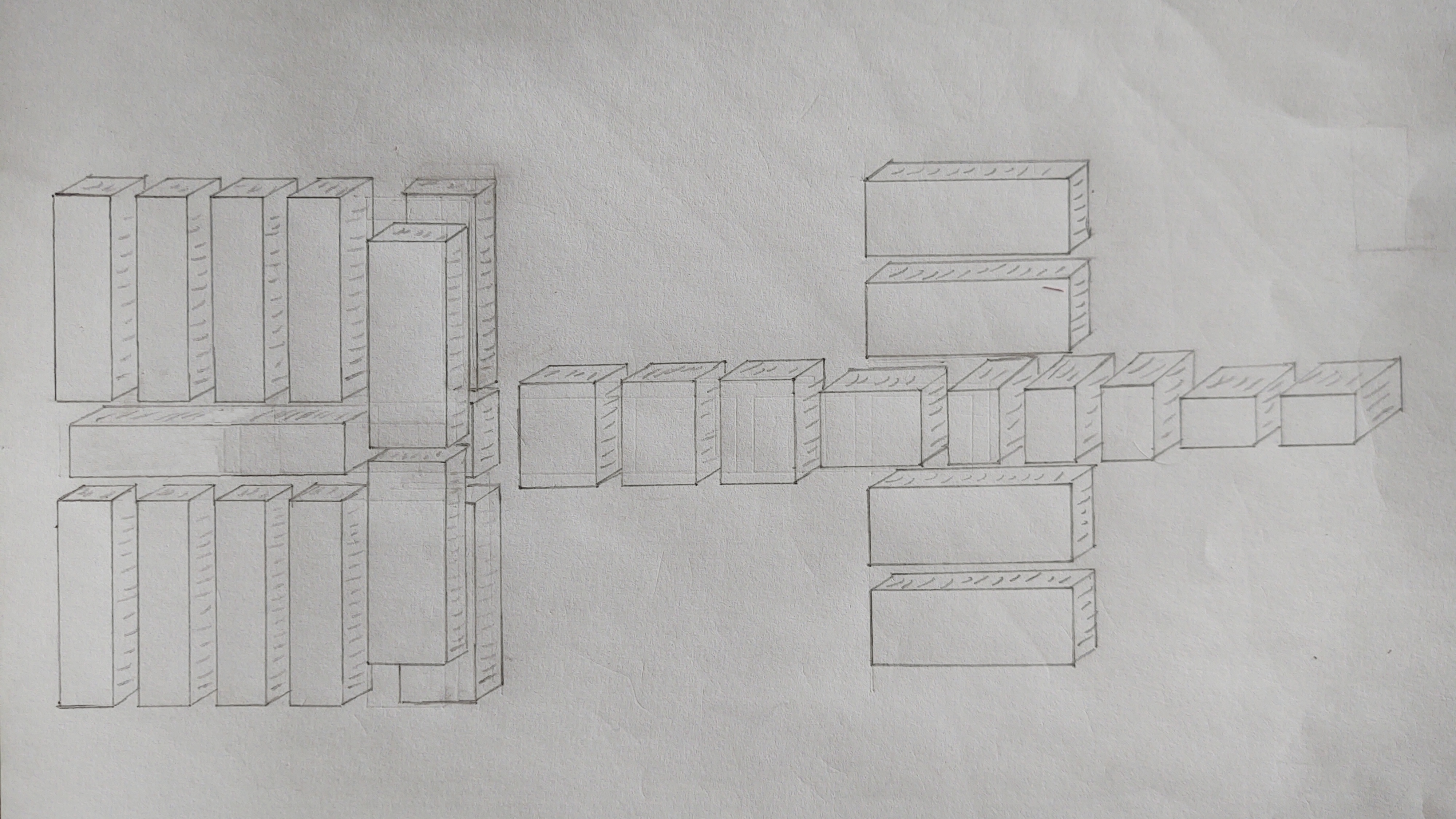

I've traced the pixie path and drawn a diagram to show the battery modules from number 1 (Most Positive) to number 28 (most negative) I still need to dismantle the pack and label the BMS and CAN cables so wish me luck on that.
Hopefully this will be useful to someone. Excuse the terrible drawing but an artist I ain't.
BTW This is edited with corrected battery module layout so forgive the tipex glare.

Great job Alibro! Many Thanks!
Now I can see how it has been originally.
Bigpie, should the master/contactor controller wake up also if there is no modules? -Have to buy a CAN board first though.

Nice, I just realised you are charging the vw modules with outlander charger. Many thanks for pioneering, I plan to do that too. I have SimpBMS also here.
Alibro, please check you module 6 and 7, for I think it is only one big 4S module.
I will look at your module arrangement and compare it to my wiring measurements I sent you, if get a moment I will share it here.

Oh bo() #*s!JaniK wrote: ↑Wed Apr 07, 2021 2:01 pm Nice, I just realised you are charging the vw modules with outlander charger. Many thanks for pioneering, I plan to do that too. I have SimpBMS also here.
Your right janik, when I first opened the pack I thought there were two small modules and never double checked but it's only one. I'll fix the drawing and repost later.
Meantime I'm relabelling the pack.

New photo's copied into the post above with (hopefully) the correct battery module layout.

Comparing my multimeter mayhem and your HV order.
My :
From BMS Master,
black cable to module # and orange interconnect.
27, orange interconnect to 26-23
22, orange interconnect to 21-19
18, orange interconnect to 17-16
15, orange interconnect to 14-13
12, orange interconnect to 11-10
9, orange interconnect to 8-7
6, orange interconnect to 5-4
3, orange interconnect to 2-1
Alibro?

Allright.
I have now traced and figured out the black BMS wiring according to Alibro's picture of opened pack and my separate wiring on the floor.
I allready got SimpBMS wired up 7 months ago to it. But then I tested only 1 module group for verify that SimpBMS works with the Samsung modules. And didn't know the og HV wiring.. There will be more...
The orange one is easy because it actually consist of smaller harnesses that are used to connect the BMS slave modules to the next modules with the dummy BMS PCB. The orange wiring just makes the Cells in the modules connected together act as a group with the one that has the black BMS harness. (Didn't now that until I had measured all of the wiring with multimeter)
There are 5 different types of module groups in pack.
Total of 8 groups.
The flow of the CAN wiring trail in black harness is not the same as flow of HV current.
Flow of the input enable signal is, and it is a loop.
Maybe that will have something to do with balancing?
Ok next, draw a readable schematic?
Or maybe I send my notes to Alibro and after he double checks them later with the full pack we will share the info.
Total of 8 groups.

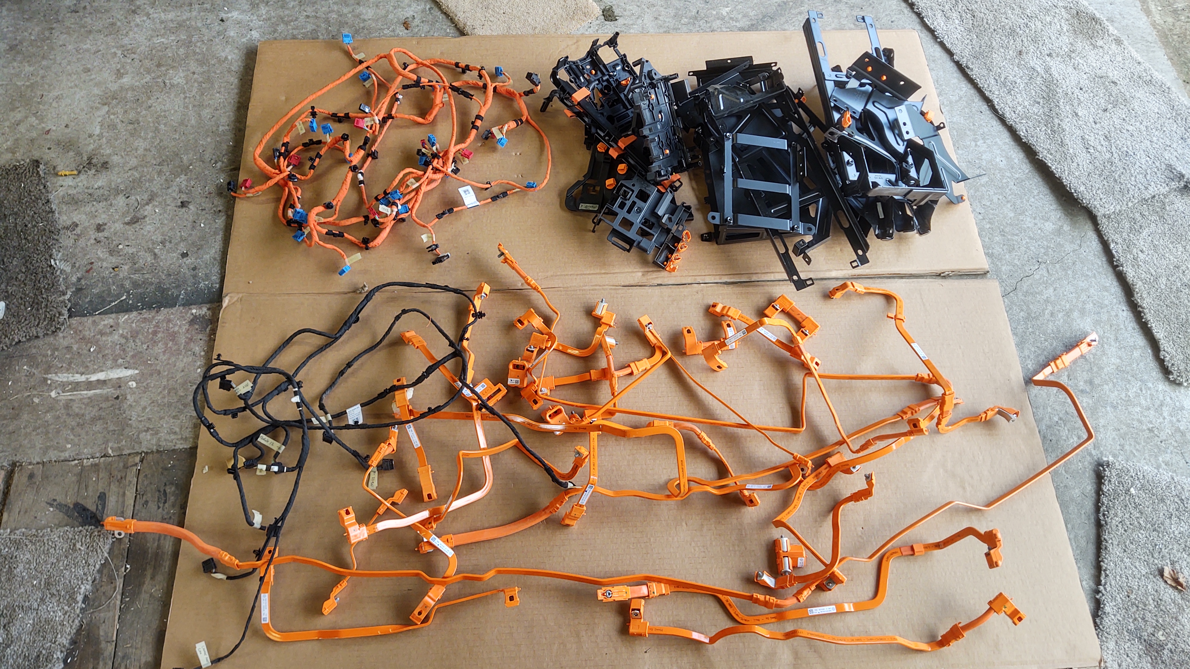

Now I have the lid off and have tidied up a bit I realise you are right about using a sharp (short blade) knife to cut the pack open.
I have all the modules removed now so my next move is to reconnect it all on the bench.
