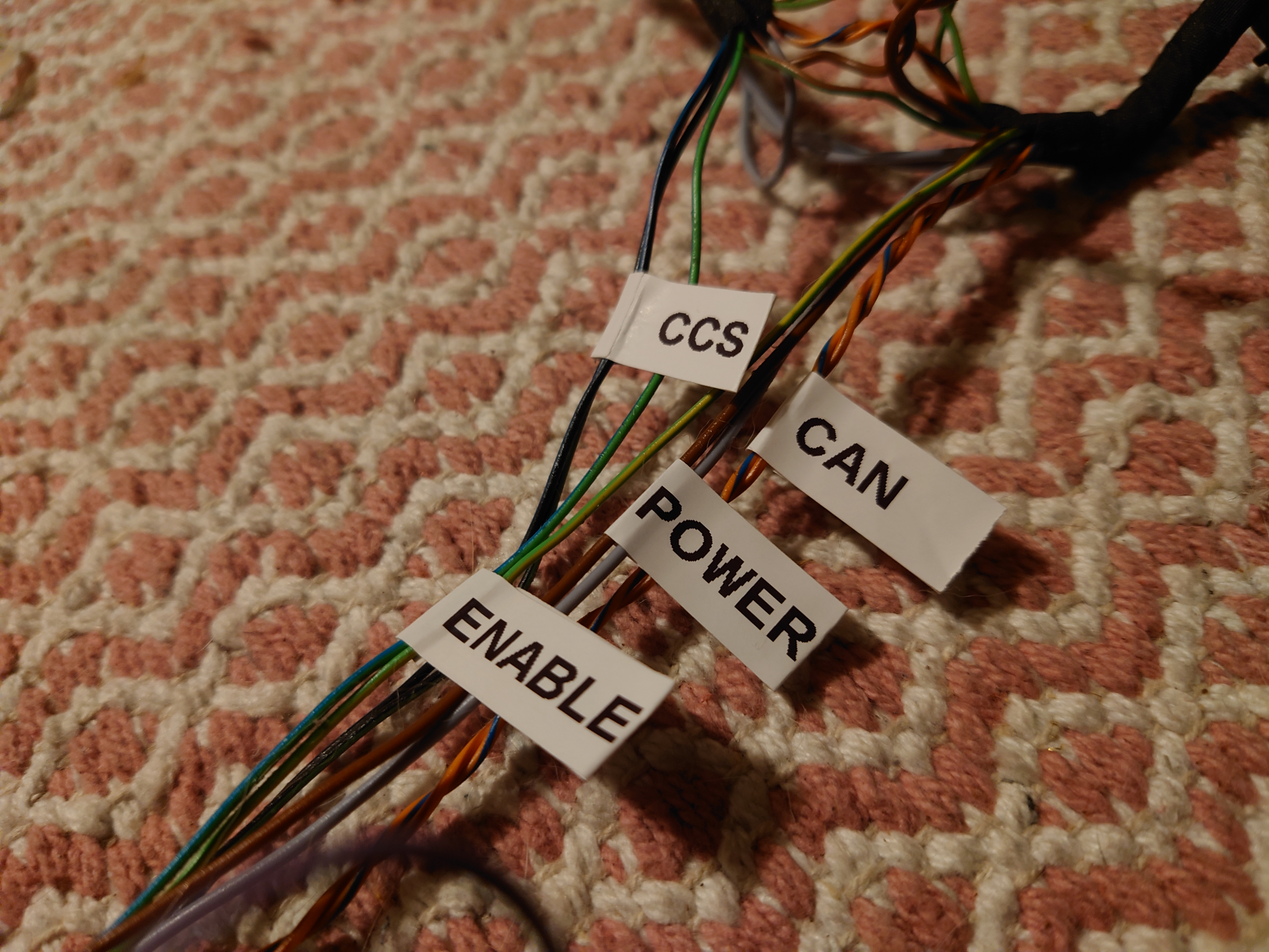

Allright, here we go. I will flood your PM with questions and pictures when I get to my parts and notes in the evening..
Lets start with finding out if you have the same wiring harness part numbers that I have? And I will find my drawings where I have traced the wiring. If you could add the HV side module arrangement then we are good to go if we sometime want to utilise original contactor and BMS box.
Modules look the same as mine, you can separate large module types from the sticker location on top and the other type has connectors in bots sides of module.
I must add that I allready cut my BMS orange harness in half because there was a point where only 1 wire goes on and I will have 2 packs.

Allright, so we are basicly at the same expertism level here.
If I would have a full pack, I would discharge one cell a little with a light buld etc. And then try to find a way to start the VW BMS to be able to sniff if it wants to balance it and how. But mine is in parts and I don't know how to "start" the pack.
Please look at this before you continue taking it apart, there is capacitor in there to discharge.

Allright.
I have now traced and figured out the black BMS wiring according to Alibro's picture of opened pack and my separate wiring on the floor.
I allready got SimpBMS wired up 7 months ago to it. But then I tested only 1 module group for verify that SimpBMS works with the Samsung modules. And didn't know the og HV wiring.. There will be more...
The orange one is easy because it actually consist of smaller harnesses that are used to connect the BMS slave modules to the next modules with the dummy BMS PCB. The orange wiring just makes the Cells in the modules connected together act as a group with the one that has the black BMS harness. (Didn't now that until I had measured all of the wiring with multimeter)
There are 5 different types of module groups in pack.
Total of 8 groups.
The flow of the CAN wiring trail in black harness is not the same as flow of HV current.
Flow of the input enable signal is, and it is a loop.
Maybe that will have something to do with balancing?
Ok next, draw a readable schematic?
Or maybe I send my notes to Alibro and after he double checks them later with the full pack we will share the info.
Total of 8 groups.

Now I have the lid off and have tidied up a bit I realise you are right about using a sharp (short blade) knife to cut the pack open.
I have all the modules removed now so my next move is to reconnect it all on the bench.
