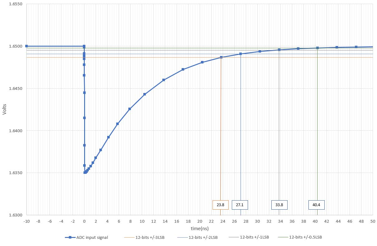

Yes actually I have a Prius transaxle here, just need to get the resolver plug and I could test with Gen2 Prius board.
I found an interesting plot in that AN, voltage dip on a 1k/2nF filtered signal. Suggests the signal has fully recovered after 34 ns. We are running 9 MHz ADC clock, so that would be about 4 clock cycles. But I just programmed 1.5 clock cycles sampling time. Can check the influence of that. But even after 1.5 cycles the signal has recovered mostly. Back when I experimented with the resolver I couldn't see any influence of the sampling time.

Maybe I'm misunderstanding but 9MHz give a period time of 111ns and so 1,5 cycles for sampling would take 167ns.
Wouldn't this then result in the measurement is taken when the signal is fully recovered?

I don't think this is such a wild idea. However if the OEM can manage without this then it can't be impossible. In case of the MGR, it is mounted at the rear axle and the inverter is at the front with a ~4m reaolver signal cable inbetween.mjc506 wrote: ↑Sun Apr 04, 2021 8:08 pm Wild idea, feel free to shoot down... Jitter is down to noise presumably? Would a resolver to spi/i2c/etc gadget mounted right at the resolver be any help? (Minimal cabling to pick up noise, low noise related supply, low noise adc (better than the stm adc)
That of course is assuming that the noise is down to a combination of longish cable between resolver and board, noise in the analogue vcc, noisy stm32 adc?
Edit: or of course, 'just' a dedicated high quality 2 channel ADC would do it I suspect, although something designed for a resolver would probably handle things better.
If a digital signal transfer is to be used it is better to use CAN or RS485 rather than SPI/I2C. SPI/I2C are created to be used on a PCB and are not that robust.
I think the best idea is to first try to measure and analyze what is causing the errors and try to get it working as is.

I looked at the stm adc again last night, seems it should be able to get with 0.1deg quite easily, so there's something else going on...
