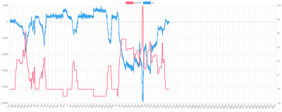

So did some testing.
So while q-current/voltage is well suited to be supported by a V/Hz profile, d current is a bit more complex. Not sure what the physical connections are.
- ud is negative when accelerating and sortof linearly increases with frequency
- ud becomes positive when regenning and seems to not vary much with frequency
- uq is positive in both regen and acceleration and also linearly increases with frequency
- both quantities vary a fair bit depending on throttle input, thats the part that the PI controller must handle

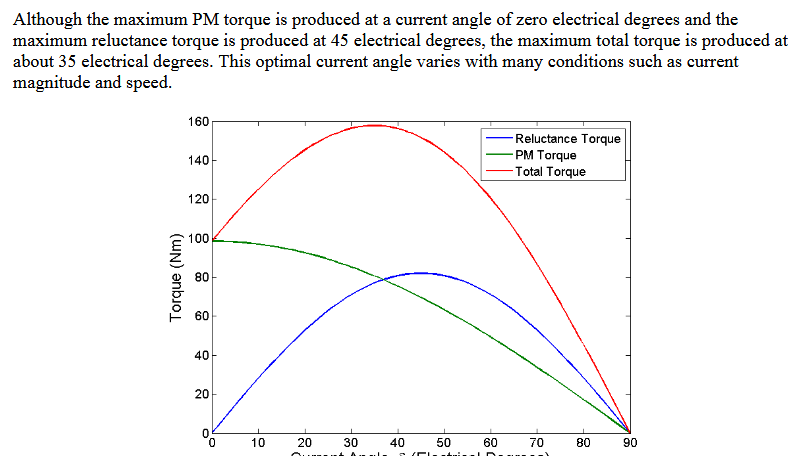

I guess I'll do some more research on MTPA (most torque per amp) to find out how to vary iq/id over the speed range.

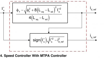

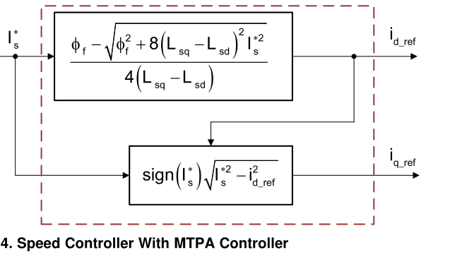

So I found this in a TI paper (www.ti.com/lit/pdf/spracf3)
It does not take speed into account, only the differences in the inductance and the flux linkage. I found another paper that has some actual data on these: https://www.mdpi.com/1996-1073/11/6/1385/pdf

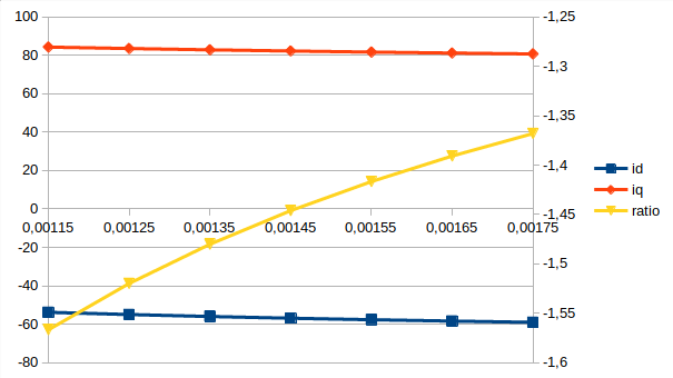

Typical values at medium currents and 90° phase angle are Lq=2.5mH, Ld=1.2mH, Flux linkage=0.09 Wb.
These values plugged into MTPA at 100A total current would result in Id=-57A and Iq=82A. The ratio varies quite a lot with current set points.
So a first approach would be using constant values.
The TI paper also has something on field weakening, just have to find out when to deploy it.
