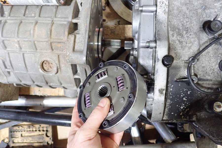

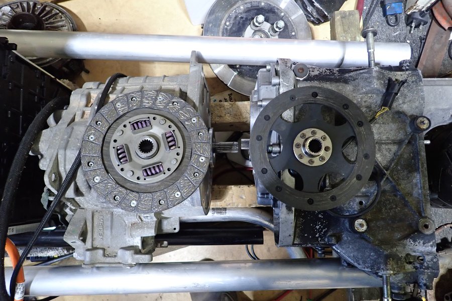

I've made up an adaptor plate using two clutch plates.
The main explanation + more photos of it are over on the project page but thought I'd mention it here as wellas it's related to the Outlander rear motor.
viewtopic.php?f=11&t=1632 Link to project page.
Clutch plates that fit both shafts
Bolted together using a ally spacer.
In place ready for the next stage of the project.
Of course it's going to be months or more before I know it it will be successful under load.

This is a silly question to get your opinion of my plan ...
I was going to cut off the end of the gearbox coupler with something overkill like an angle grinder, then press it into my coupler is there any reason that you can see this might not work? (Other than the fact I will probably need to heat the coupler and borrow/buy a press).
Posts: 3795
Been thanked: 411 times
rstevens81 wrote: Tue May 11, 2021 6:31 am This is a silly question to get your opinion of my plan ...
I think your idea is the fastest. Use the grinder with the thinnest disk with care. But when done i would put the coupler in a lathe and mill and polish the end that was cut. This way it all looks more professional :).
Before pressing put the gearbox coupler end in a fridge to shrink it and heat-up your socket part to expand it before pressing gearbox side into it. This way you will get the most clearance for comfortable fit.
