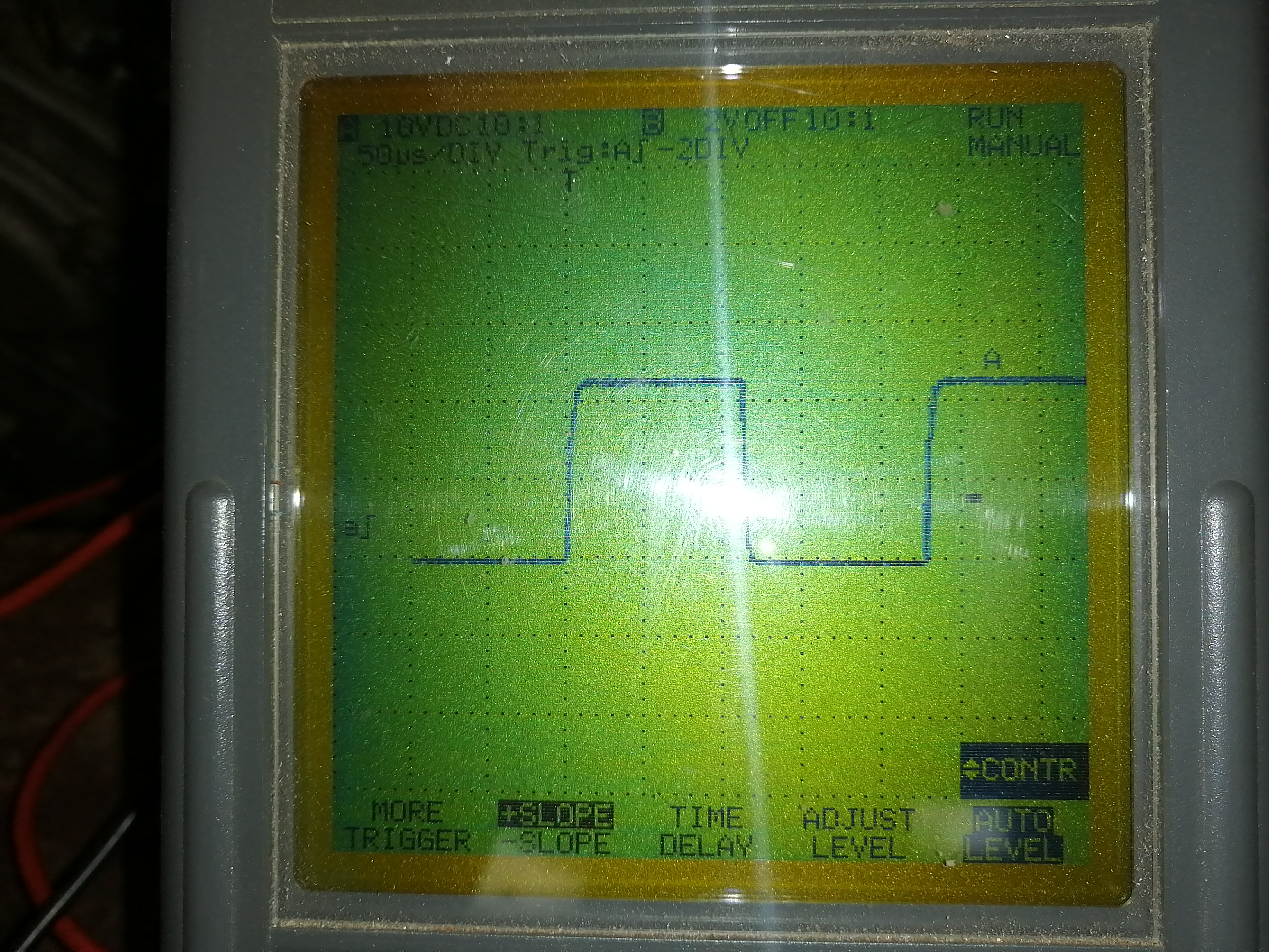

Joined: Sun Apr 26, 2020 2:26 pm
Re: BMW I3 Project
Post by lumax »
Already run into a problem 🤣
Tested all PWM signal, and adjust the dead time to 1.5us, connected the IGBT (no DC link), power it back on, start inverter and BAM!!! Blow my 1A fuse on the brain... Triple check all my wiring, everything was good.
Unplugged the driver from the IGBT and test all gate one by one... I hade no problem to turn them ON and OFF with my finger resistance...
Put back everything together and test again but this time with only one IGBT connected to the driver (all 3 driver connected to the brain), the current draw from the brain alone and the 3 gate driver is around 260ma... with one IGBT connected and working (PWM ON) the total current draw is around 700ma (450ma for one IGBT), and when 2 IGBT are connected I run around 1.2A and with 3 IGBT connect I got an over current protection error that stop the PWM (current should be around 1.6A)
The gate capacitance look to be to large for the driver and the brain PSU... From the scope I can clearly see rising edge is curved due to gate capacitance, unfortunately I did not take a picture
Is this kind of current draw is normal?

The BMW driver board takes in 11W from the 32V supply voltage when running all 6 IGBTs at 8.8 kHz. This would translate to 1A at 12V. The 5V architecture might be less efficient than 32V. Can you try supplying the gate drivers separately with 5V? They consist of 6x2W DC/DC converters. Assuming 80% efficiency they would already pull 3A from the 5V rail when fully utilized. That would probably overload the 5V regulator.

lumax
Posts: 57
Re: BMW I3 Project
Post by lumax »
Here are the results
When I got this over current problem on the brain the PWM frequency was set to 17.6Khz...
Gate driver (all 3) idle current @ 5V = 400ma
3.1A @ 5V @ 17.6 Khz (bad wave form)
2.0A 2 5V @ 8.8 Khz (good wave form)
1.2A @ 5V @ 4.4 Khz (excellent wave form)
So I will stick to 8.8 or 4.4 and keep the gate driver power connected to the brain
By the way I got a lots of success yesterday...
Open loop motor rotation wirh SINE DONE!
Closed loop motor rotation with FOC DONE!
Now ready to tune the FOC and put back everything together
4.4 Khz at IGBT gate

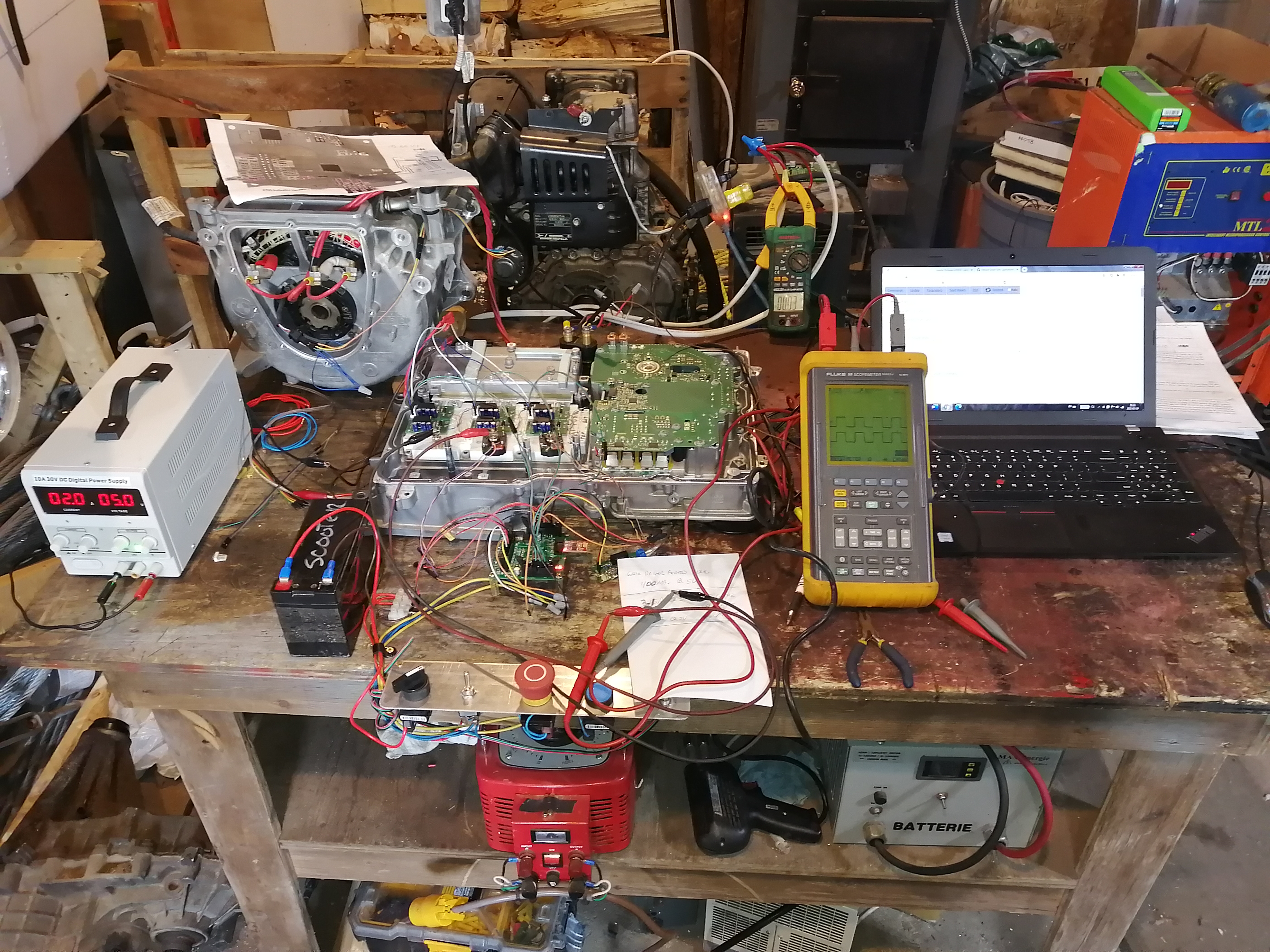

lumax
Posts: 57
Re: BMW I3 Project
Post by lumax »
