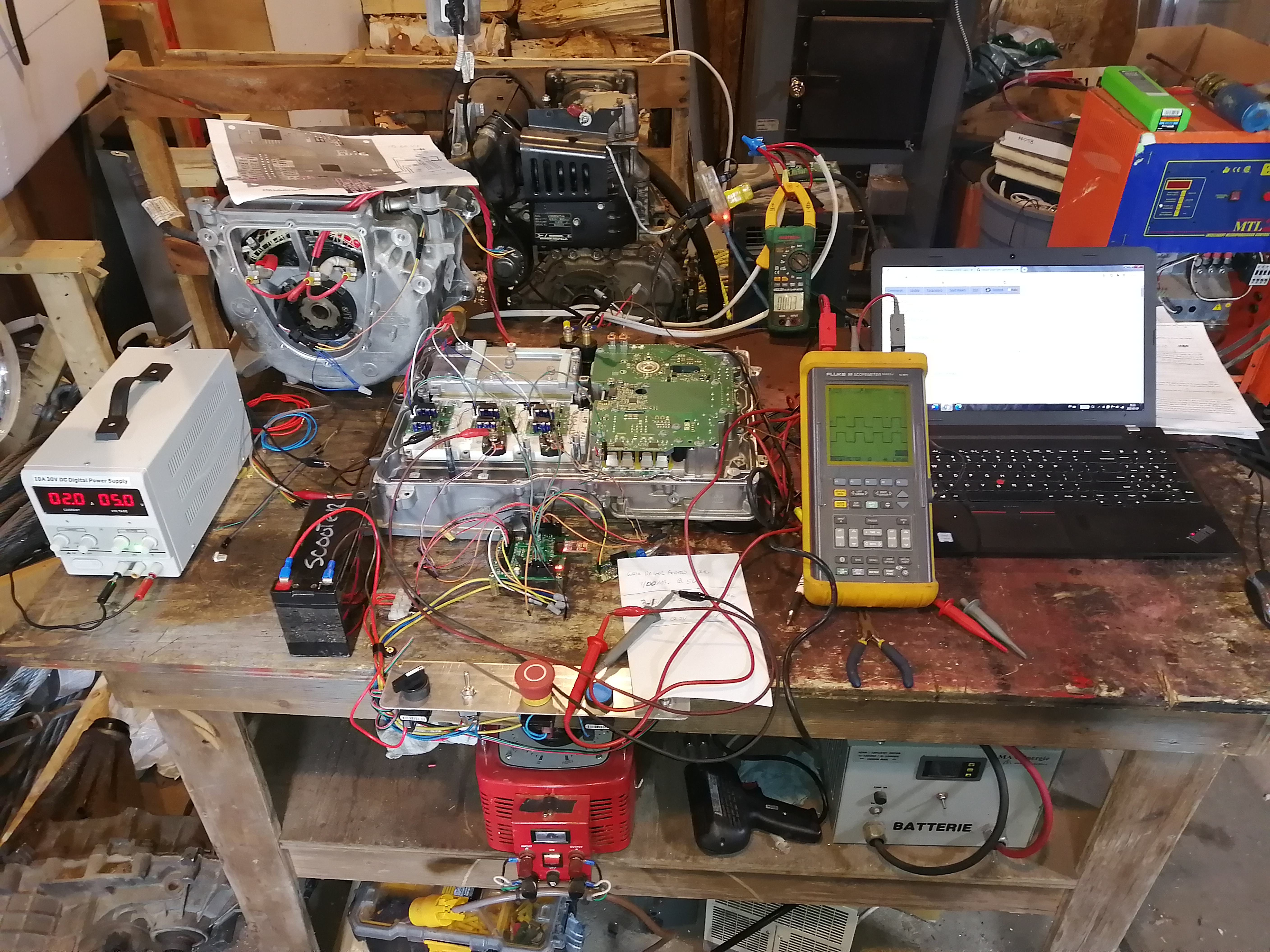

Today I have started to connect everything together... And I decided to give a try to the original IGBT driver board... It was a pain in the a** to connect the wiring to the original tinny connector, but I managed to do the connection with 1/16W resistor lead welded to a stranded wire... not perfect but good enough... 24 gauge solid wire was too big to fit the connector
I will keep you in touch !

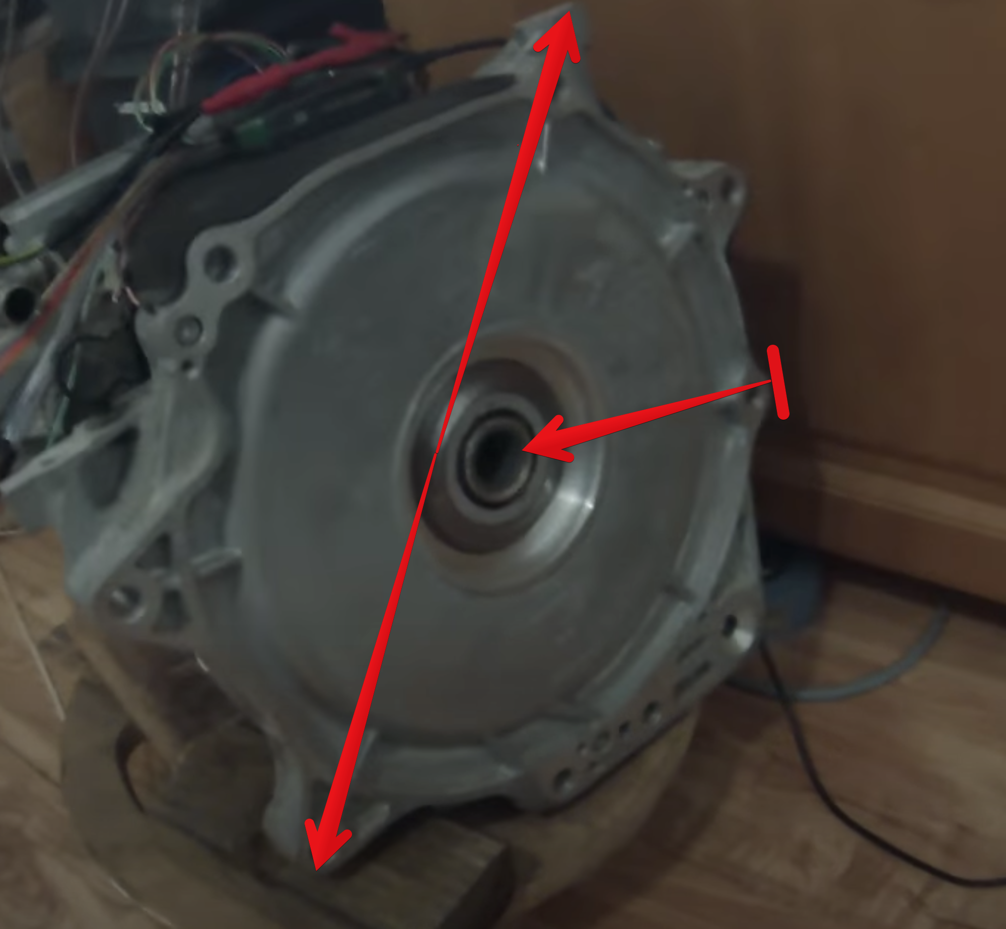

thinking of using a i3 motor for a future project, any chance you can grab some measurements on the back side of the motor.
mostly looking for these measurements, but if you have more accurate / complete ones that would be great !
Re: BMW I3 Project
Your long arrow dimention is roughly 13.75'' (overall outside)oelbrenner wrote: ↑Mon Jun 08, 2020 12:39 am thinking of using a i3 motor for a future project, any chance you can grab some measurements on the back side of the motor. mostly looking for these measurements, but if you have more accurate / complete ones that would be great !
Your short arrow dimention is roughly 6'' (c/c)
But the bolt patern is not even... some holes are at 6.75'', 6.25'', 7.25''...
In the final assembly of this project I will post the complete template with all measurent... when i get there
A single pack is 12.25'' wide x 15'' long x 5.5'' tallwillywonka wrote: ↑Tue May 19, 2020 5:05 am Hi @lumax

Little update...
After almost one year, the project was held to a dead stop, since I got problem with the original brain, (no PWM output) and no more time to play... Johu, kindly send me a replacement board to replace the defective one... After a couple hours of setup and config, I now have PWM signal !!!
So I'm gonna keep following the config and start-up procedure... So far so good!!!

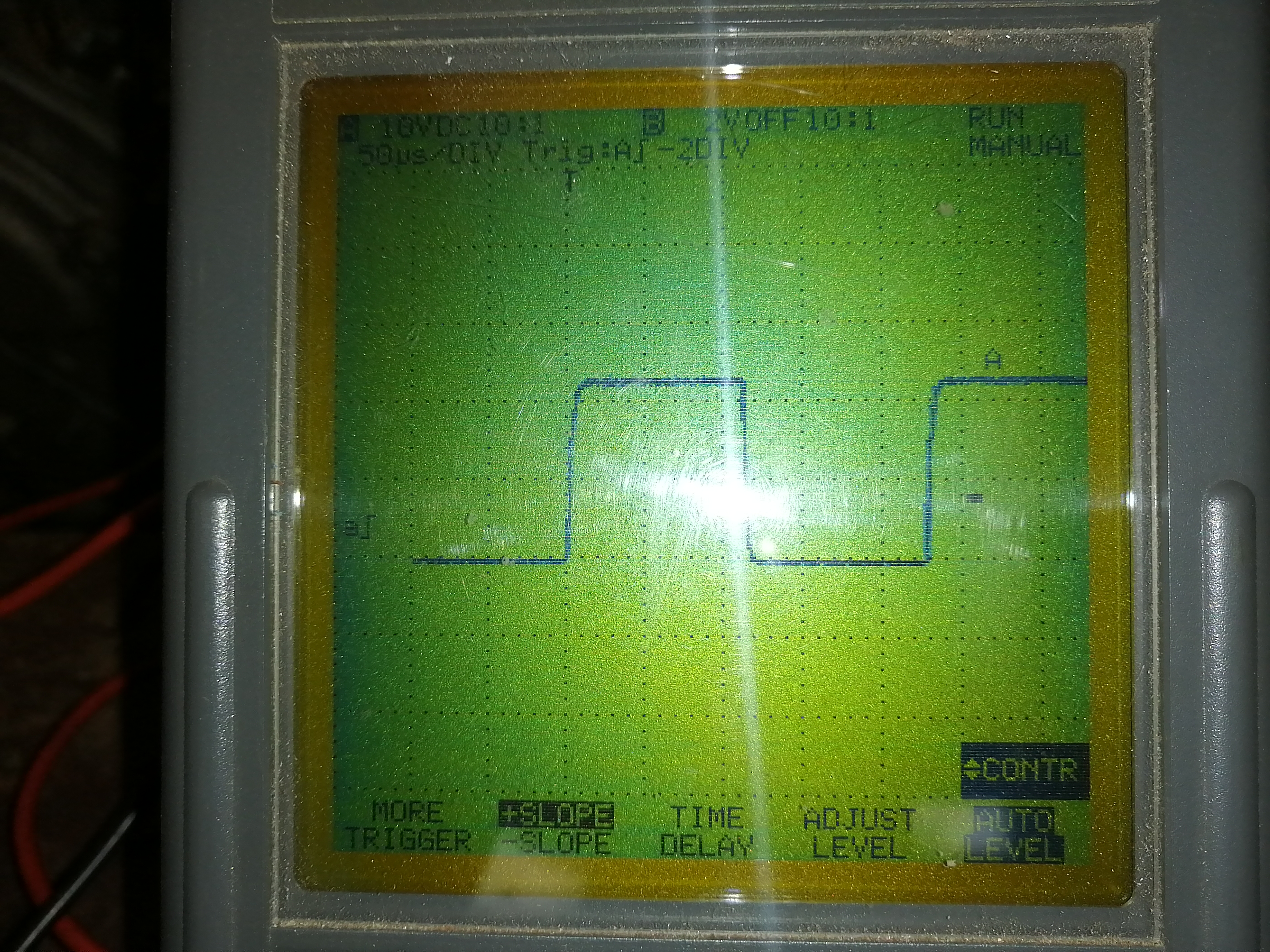

Already run into a problem
Tested all PWM signal, and adjust the dead time to 1.5us, connected the IGBT (no DC link), power it back on, start inverter and BAM!!! Blow my 1A fuse on the brain... Triple check all my wiring, everything was good.
Unplugged the driver from the IGBT and test all gate one by one... I hade no problem to turn them ON and OFF with my finger resistance...
Put back everything together and test again but this time with only one IGBT connected to the driver (all 3 driver connected to the brain), the current draw from the brain alone and the 3 gate driver is around 260ma... with one IGBT connected and working (PWM ON) the total current draw is around 700ma (450ma for one IGBT), and when 2 IGBT are connected I run around 1.2A and with 3 IGBT connect I got an over current protection error that stop the PWM (current should be around 1.6A)
The gate capacitance look to be to large for the driver and the brain PSU... From the scope I can clearly see rising edge is curved due to gate capacitance, unfortunately I did not take a picture
Is this kind of current draw is normal?
Don't think so...
Don't think so...

The BMW driver board takes in 11W from the 32V supply voltage when running all 6 IGBTs at 8.8 kHz. This would translate to 1A at 12V. The 5V architecture might be less efficient than 32V. Can you try supplying the gate drivers separately with 5V? They consist of 6x2W DC/DC converters. Assuming 80% efficiency they would already pull 3A from the 5V rail when fully utilized. That would probably overload the 5V regulator.

Re: BMW I3 Project
Here are the results
When I got this over current problem on the brain the PWM frequency was set to 17.6Khz...
Gate driver (all 3) idle current @ 5V = 400ma
3.1A @ 5V @ 17.6 Khz (bad wave form)
2.0A 2 5V @ 8.8 Khz (good wave form)
1.2A @ 5V @ 4.4 Khz (excellent wave form)
So I will stick to 8.8 or 4.4 and keep the gate driver power connected to the brain
By the way I got a lots of success yesterday...
Open loop motor rotation wirh SINE DONE!
Closed loop motor rotation with FOC DONE!
Now ready to tune the FOC and put back everything together
