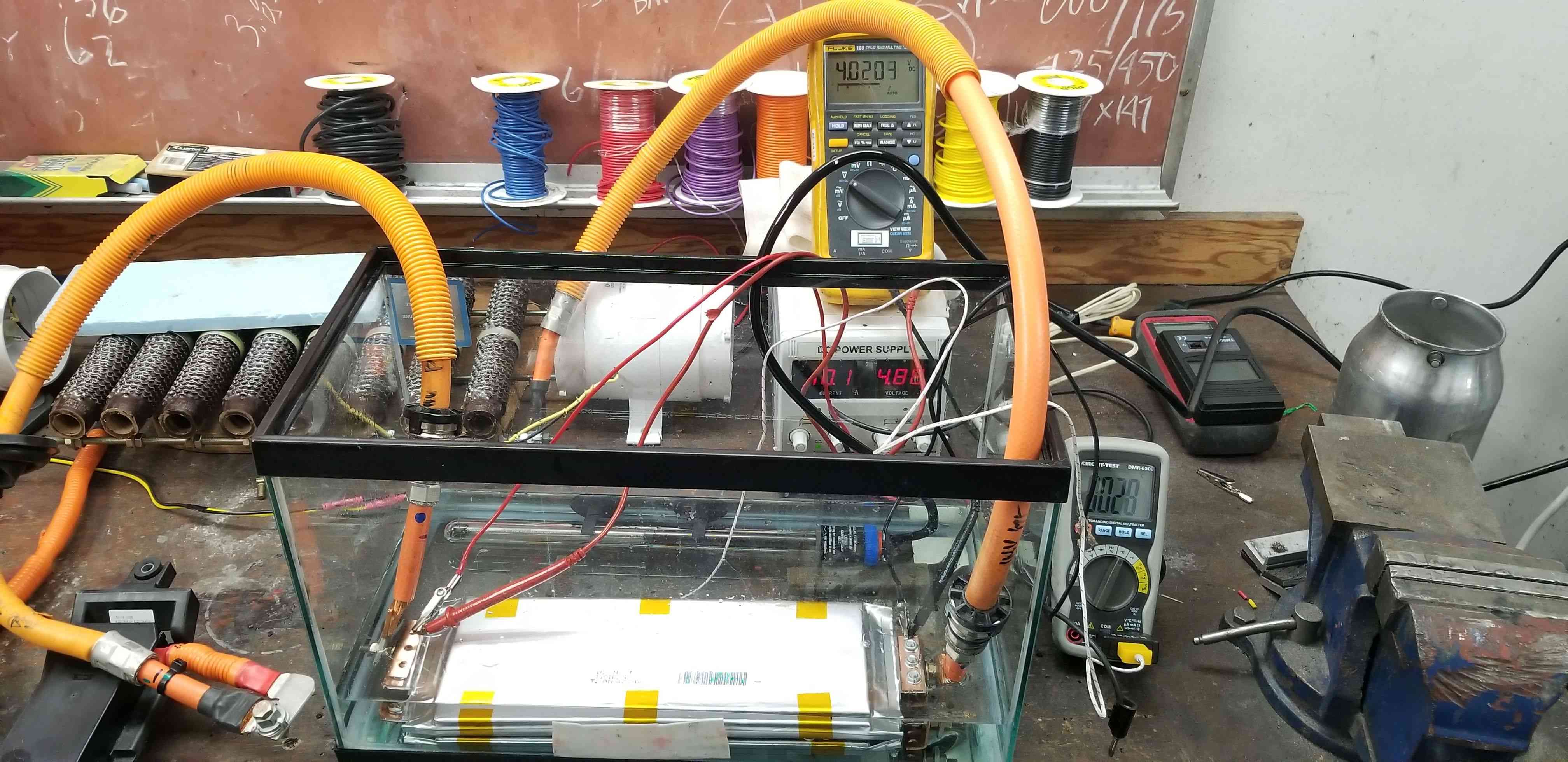

We have done total immersion testing using Mineral Oil. The picture shows a pair of Chevrolet Bolt Cells being tested. We did 100s of hours of cooling tests using different configurations of cooling plates. Immersion cooling was by far the best. In the end, we decided not to proceed due to the logistics of building a fluid tight battery box, overall weight etc., but we will probably use this for a future pack. Total immersion cooling is used extensively in the Bitcoin mining world. They immerse entire servers without problems.

Liquids, such as cooling fluids, are often considered "non-conductive" at "safe" voltages, as in below 60v. Once you get into the hundreds of volts, conductivity does not scale well. Tests at 12v will not indicate results at 300v, much less 600v, it's called "breakdown voltage" and it even applies to wire insulation. I will try and find the dielectric constant for mineral oil, but even subtle differences in chemistry can have huge impacts on conductivity.dougyip wrote: ↑Wed Feb 10, 2021 5:19 am We have done total immersion testing using Mineral Oil. The picture shows a pair of Chevrolet Bolt Cells being tested. We did 100s of hours of cooling tests using different configurations of cooling plates. Immersion cooling was by far the best. In the end, we decided not to proceed due to the logistics of building a fluid tight battery box, overall weight etc., but we will probably use this for a future pack. Total immersion cooling is used extensively in the Bitcoin mining world. They immerse entire servers without problems.
<edit>: Well air has a dielectric strength of about 3MV/m, so anything greater than that should be just fine, as long as it is not contaminated

Battery temps can get very high road racing. Our Kia air cooled pack would go from ambient to 65 degC in 20 min. Our Bolt pack with OEM style indirect cooling plates would hit 65 degC within a couple of laps. It wasn't until we went to full liquid cooling plates sandwiching each cell pair that we could run an entire 20 min. Now with our Model 3 pack, temperatures barely hit 50 degC.

Mineral oil is used in HV transformers in the KV range, so no problems at our voltages. We were actually going to use AmpCool: https://www.engineeredfluids.com/ampcool mainly due to it's low fluid density. Phase change fluids like 3M's Novec are the the best, but are extremely expensive.

If you want to play safe, you could separate the pack into lower voltage segments with separate cooling oils. Then you can tolerate cheaper oil and more contamination. It would be useful to know how the oil reacts when contaminated by vented gas from the battery, as that's definitely something that can't happen in a transformer.
