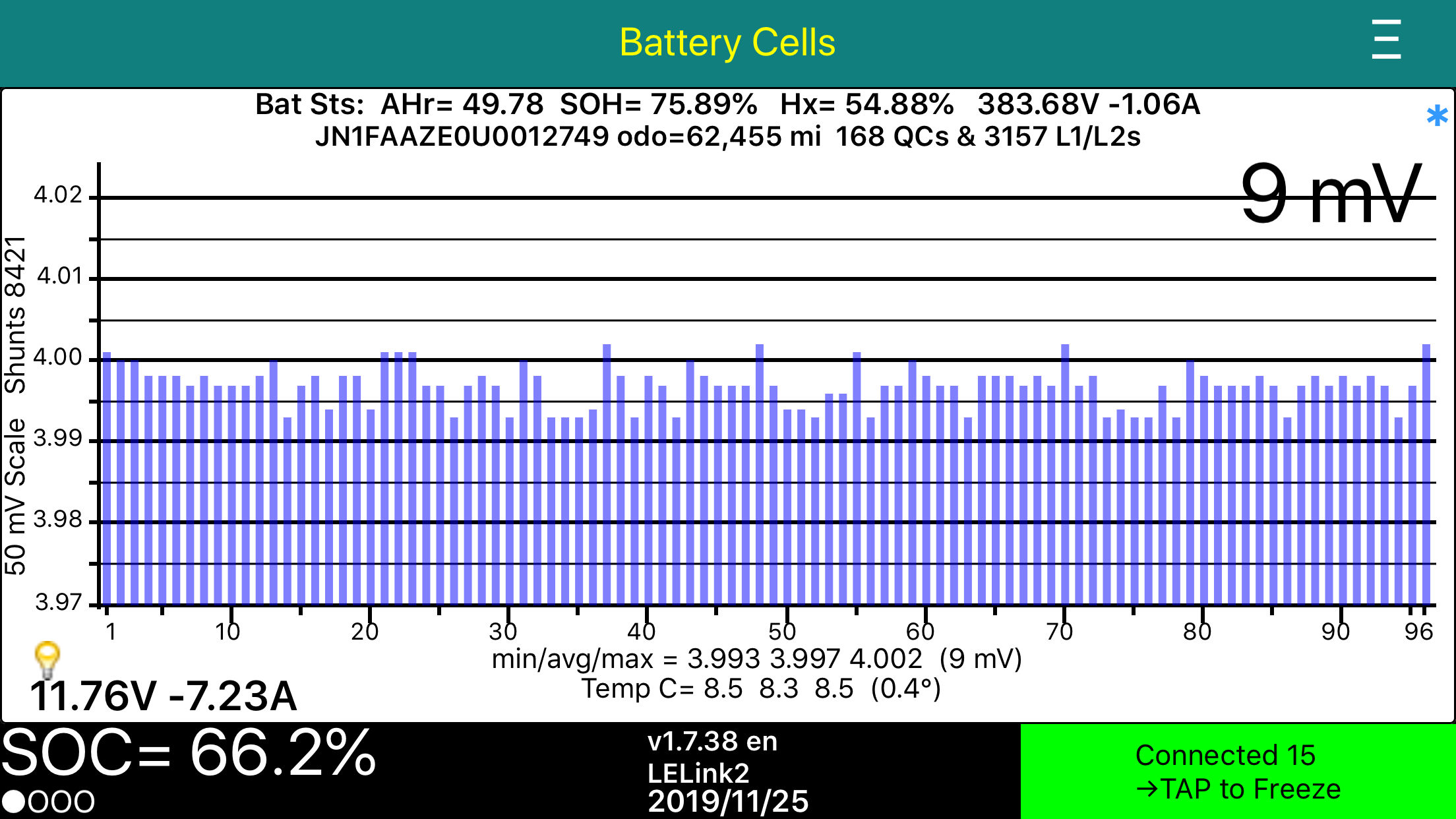

You need to get a pack sniffer 2 from Wolftronix. that and a 5V USB portable power supply it will tell you if the battery is there and what shape it is in.

You can't really connect a pack sniffer to a car in an auction yard.
Normally Copart has images of the dashboard display, you can see battery state of charge and Nissan's own health approximation on the right side. This should be enough to verify the existence of a battery, and give a rough indication of life.
Nissan do not cool their packs, it seems that the lifespan of the Leaf batteries is questionable. I'd aim for a low mileage car that "runs and drives".

xp677 wrote: Mon May 04, 2020 5:47 pm You can't really connect a pack sniffer to a car in an auction yard.
We've done that several times at Copart auction locations in the UK while inspecting the battery.

That's good to know. From watching his videos, it seemed that you needed to get under the vehicle to connect directly to the battery.

xp677 wrote: Mon May 04, 2020 8:40 pm That's good to know. From watching his videos, it seemed that you needed to get under the vehicle to connect directly to the battery.
Yeah. This is the plug that comes out of the battery box. (both BMS and HV). The Pack Sniffer 2 connects directly to the BMS.
By battery is out of the box.

I'm aware of that from watching the videos. I wasn't aware that you could get to that connector with the car on the ground. Can you get the same data from elsewhere in the car? Diagnostic port, etc?
