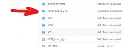

Re: Prius Gen 3 Dual Motor Logic Board Support Thread
Design files for the V1d ampseal adapter boards are now live on github :
https://github.com/damienmaguire/Prius- ... master/V1d
Was referring to the ampseal board which wasnt there, but thanks for taking the time to reply. Damien knew what I meant. I made good use of the logic board patreon files to do the yaris/auris/>2012prius small board variant.
Thanks for these.
thank yyoujohnspark wrote: ↑Tue Jan 05, 2021 10:57 pmhttps://github.com/damienmaguire/Prius- ... dParts.csv
row 7 is the item you wish to buy. I have included this link in case you did not know the details
I think JB had a lot of trouble buying this part. Think he ended up getting from Japan.
Ah thank you for the clarification 180jacob, i now know what to do180jacob wrote: ↑Wed Jan 06, 2021 10:05 am (based on Damien's PDF, still waiting on the plots )

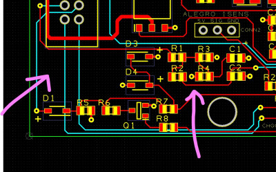

So Damien has given me permission to upload the smaller layout version of the Dual motor board to the github repository.
I will also be (attempting to) maintain these boards. The idea being that I gain more experience with electronics and PCB design and at the same time Damien has one fewer juggling ball in the air so can spend more time innovating. Whilst my current level of skill and experience doesn't come close to Damien's and others on this forum I am learning fast so bear with me.
I have been trying to decide for over a week which repository was best to put this design in as we have one for prius and one for yaris/auris however it transpires that some newer prius' (like mine) also use the smaller board. I think its important not to break any links that may be in the forum or wiki so renaming or moving anything isnt an option. In the end I have decided to put this design in the Prius repository as most people using a yaris inverter will have looked in the Prius repository but not necessarily the other way round. I Have added a link in the reverse direction anyway.
These are 95% what I ordered and have tested though I have made a few subtle changes since. I moved the resistor capacitor network for the charger proximity signal out the way of the IDC connector. And changed the pad size on C7 to match the 8mm footprint component. The P channel mosfet I had used for the delay-on dc-dc control was removed from JLCs library so I have chosen a suitable alternative (hopefully). I also noticed the low side driver ICs for the outputs are out of stock. As these are used on the new VCU as well I will wait until an alternative is chosen for that and use the same, or maybe they will come back in stock? The whole series is 0 at the moment.
I will make these changes to the large layout board as well at some point. If anyone else has any change suggestions (that are tested and proven), let me know and I will implement them. Its important not to feature creep though, I say this with the intention of implementing fixes really.
Obviously I haven't made any boards with these latest changes and I don't intend on doing so until I have looked at other things like using a single wifi module and external CAN, so these files are available untested. That said the changes since my build are so subtle I am pretty confident I haven't introduced more errors.
I was wondering if you have taken maintaining the boards (prius/auris) that we could try to unify the designs?
by that i mean,
1) have a single board for dual and single motor configurations, just have 2 BOMS one for single motor config and 1 for dual motor config?
2a) create a 3d printable adaptor simlar to bexander (viewtopic.php?f=11&t=912&hilit=renault&start=50) therefore single board design for both?
2b) create a through hole resistor or jumper to switch between the resistance value differences between the inverters?
2c) change to through hole screw terminals instead of the current sensors sockets or make 2 sets of pads for each confuration
I'm happy to help if i can as i have both a yaris and a (old) prius inverter & a 3d printer so could assist in high res photos, cardboard aided design etc.
Of course feel free to tell me to get lost if this is totally bonkers.
by that i mean,
Yep that's what I'm thinking, just didn't want to upset the apple cart by changing too much in one go.
Unifying single and dual is a bit more tricky than just the BOM as at the moment there are differences in the CAN, the idc pinout, the current sensors parreleling and the igbt parreleling. This can all be overcome though. An alternative outcome is we make the dual motor board do everything the single one can and ignore the very slight increase in component cost.
As for the easier task of unifying big and small, my small board layout already has two solder jumpers to select which current sensor resistor ratio you want to use. (viewtopic.php?p=19786#p19786) though as I only have the one inverter I haven't 100% tested both options.
As for the connector I was thinking dual footprint so you just solder on whichever you have (like you suggested)
And for physically mounting one idea I was thinking possibly design some tabs on the PCB outline to make it fit the large size and you just snap them off if you want to fit in a small inverter. Dont know if JLC do a V milling option to put groves in? Other ideas are only make the small size and people screw in two extra PCB pillars or I like your 3d printing suggestion as lots of people have one now. To be honest now I have a small layout it's a very quick job to make the outline bigger especially if the other stuff is unified, so it's no problem keeping both. It does make things in general a lot simpler though if people don't have to choose between half a dozen varients when ordering or looking up the pinout/schismatic/PCB.

I think, that COOLANT_TMP line is hanging loose. I've check on a few schemas and every where is this same. So my understanding is that it's not used and not needed.
But where it supposed go initially?

In older versions the web interface did not display this correctly. Download this: https://github.com/jsphuebner/esp8266-web-interface and upload index.js via the upload form on top of the page. Then refresh and you should see which pinswaps are active.
If you take a look on Damien's github at the v1 Prius schematic (not 1c or 1d, just v1) it is shown to be connected to the atmega328P though at that point there was no software for using the buck boost. It looks like the functionality was dropped in favour of adding mg1 current sensors. For most people just reading the die temperatures is adequate and coolant pumps are run all the time. If we are going to the effort of soldering on the connector though we might as well wire it up to something, there is a spare adc pin on MG2 stm32, or on the dual motor board there are several spare on MG1, or it could go to a solder jumper next to the 328p and you select if you want both die temps or one and the coolant temp. I will have a look at this next time there are other things to change.
Was there anything specifically you wanted to do with the coolant temp measurement?
