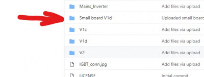

So Damien has given me permission to upload the smaller layout version of the Dual motor board to the github repository.
I will also be (attempting to) maintain these boards. The idea being that I gain more experience with electronics and PCB design and at the same time Damien has one fewer juggling ball in the air so can spend more time innovating. Whilst my current level of skill and experience doesn't come close to Damien's and others on this forum I am learning fast so bear with me.
I have been trying to decide for over a week which repository was best to put this design in as we have one for prius and one for yaris/auris however it transpires that some newer prius' (like mine) also use the smaller board. I think its important not to break any links that may be in the forum or wiki so renaming or moving anything isnt an option. In the end I have decided to put this design in the Prius repository as most people using a yaris inverter will have looked in the Prius repository but not necessarily the other way round. I Have added a link in the reverse direction anyway.
These are 95% what I ordered and have tested though I have made a few subtle changes since. I moved the resistor capacitor network for the charger proximity signal out the way of the IDC connector. And changed the pad size on C7 to match the 8mm footprint component. The P channel mosfet I had used for the delay-on dc-dc control was removed from JLCs library so I have chosen a suitable alternative (hopefully). I also noticed the low side driver ICs for the outputs are out of stock. As these are used on the new VCU as well I will wait until an alternative is chosen for that and use the same, or maybe they will come back in stock? The whole series is 0 at the moment.
I will make these changes to the large layout board as well at some point. If anyone else has any change suggestions (that are tested and proven), let me know and I will implement them. Its important not to feature creep though, I say this with the intention of implementing fixes really.
Obviously I haven't made any boards with these latest changes and I don't intend on doing so until I have looked at other things like using a single wifi module and external CAN, so these files are available untested. That said the changes since my build are so subtle I am pretty confident I haven't introduced more errors.

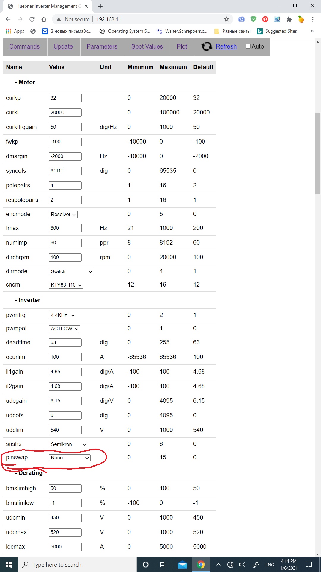

Hello again ...)))
I have a fully assembled board prius gen 3 dual motor(Pri_G3_built_v1d)
I have a minimum of wires connected HV+-,invertor 12v -+,5+-one pedal Potentiometer,12+ start signal,12+forward direction signal,resolver 6 wires ...
my problem as you can see in the video below the motor does not stop ...
it stops rotating after disconnect the wire for the direction ...
I tried many different options with settings nothing helped
180jacob

Hard to see from your video and its late so I might not be thinking straight but looks like you haven't set the pinswap setting, this means the current sensors wont match up with the phases and the inverter will not be able to control the current correctly. I ant remember what you need to set it to but for reference I posted my parameters here: viewtopic.php?p=21384#p21384 though these were with the latest firmware version 4.97 and I think you said 4.87 in your video. Looks like I set it to "8" but not sure which option that translates to on the web interface drop-down box.
thanks for the help !!!
firmware version 4.96R FOC
I compared your settings and mine and found the difference and found my problem ...
i used command set pinswap 5
but I did not select nothing in the section inverter

Abricosvw wrote: Sun Jan 31, 2021 2:33 am I compared your settings and mine and found the difference and found my problem ...
In older versions the web interface did not display this correctly. Download this: https://github.com/jsphuebner/esp8266-web-interface and upload index.js via the upload form on top of the page. Then refresh and you should see which pinswaps are active.
