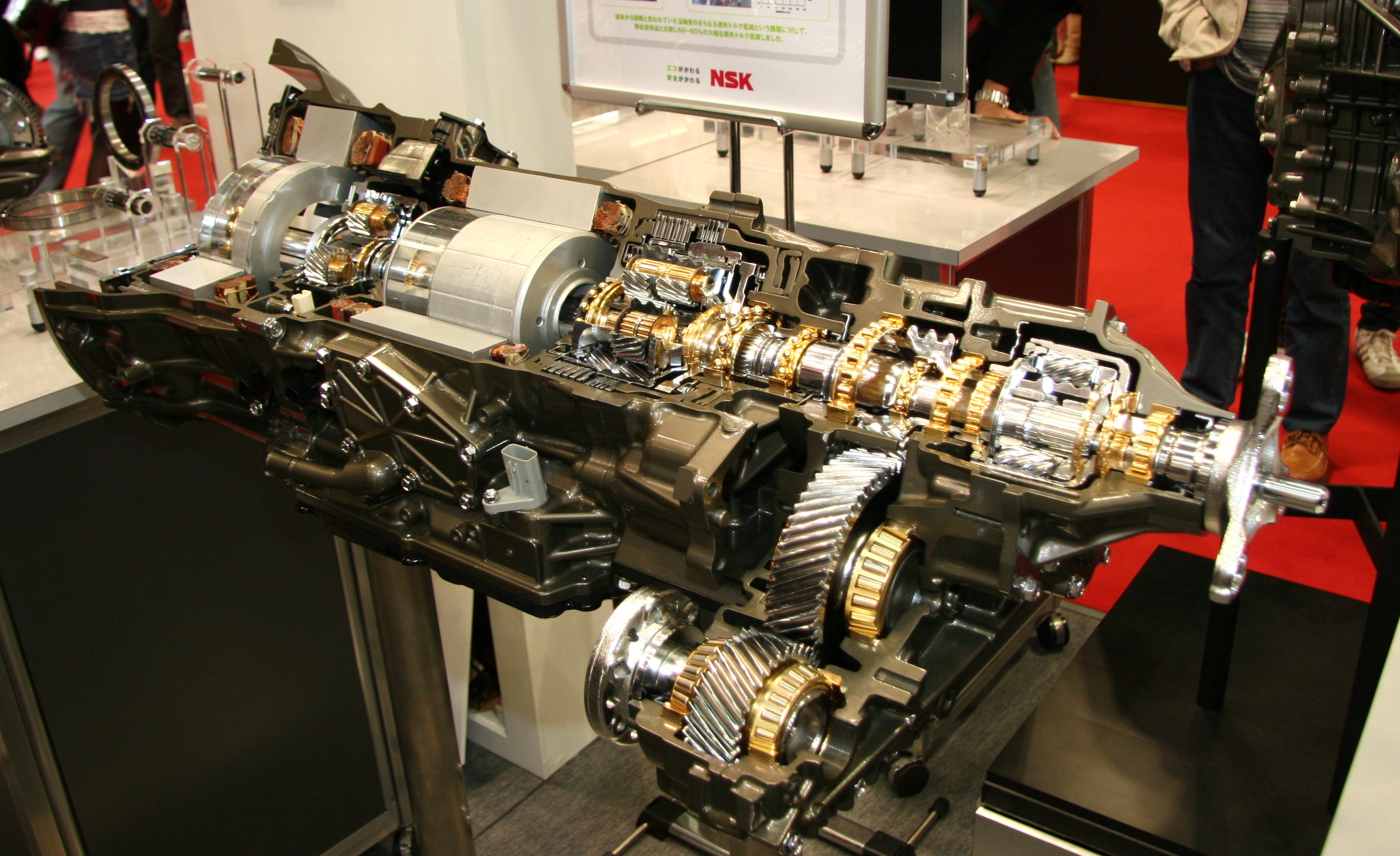

Introducing my 2004 Subaru Forester XT. It is currently parked on my driveway due to the rising gas prices here in Canada. But I much rather drive it because of the styling and the practical seating and trunk space. Image
For the decade that I have owned the Forester, I have done a lot of wrenching so I am not unfamiliar with the mechanical aspect of vehicle modifications. I have also dabbled with Arduino boards and 3D printers so I am not a stranger to fiddle around with things to make them work. I have been following Damiens work on the Lexus/Toyota gearbox and inverters. The idea of a simplified conversion process (custom driveshaft instead of adapter plate) was really appealing. So recently, I pulled the trigger on one of the Lexus GS450h gearbox. I am forgoing the AWD and building a RWD to keep things simple.
Cost tally (in Canadian Dollars rounded up to the nearest $5):
$740 - GS450h gearbox
$100 - GS450h gearbox oil pump controller
$040 - Gear position sensor connector
$525 - GS450h inverter
Total so far: $1,405

I am reading through the Prius Gen 3 inverter hacking thread. Is there any downside in using this inverter with the GS450h gearbox?
I am still learning about all the components I need for the build. As a software engineer, I am still trying to wrap my head around the electrical stuff, but I intend to read through the software sources to get more acquainted with what features are possible etc.

RE3Rotor wrote: Fri Feb 07, 2020 12:10 amSo recently, I pulled the trigger on one of the Lexus GS450h gearbox. I am forgoing the AWD and building a RWD to keep things simple.
I don't know anything about the Forester drivetrain but it might be worth allowing for a future AWD upgrade using the bolt on transfer box used in the LS600H :)

the inverter is better from GS450 to use.
what is the gearbox price tag?

Kevin Sharpe wrote: Fri Feb 07, 2020 10:56 am I don't know anything about the Forester drivetrain but it might be worth allowing for a future AWD upgrade using the bolt on transfer box used in the LS600H :)
All Subarus have the front diff built in to the transmission. So the front axles come out of the side of the transmission. I thought about the 600h transfer case. And if that will fit under the car, it will definitely be a consideration.

As far as cheaper alternatives, I believe the 2007 Camry hybrid inverter also works, just rearranged pinout for the main connector. Internally, I'm sure the Camry hybrid is lower powered, I just don't kow by how much.
