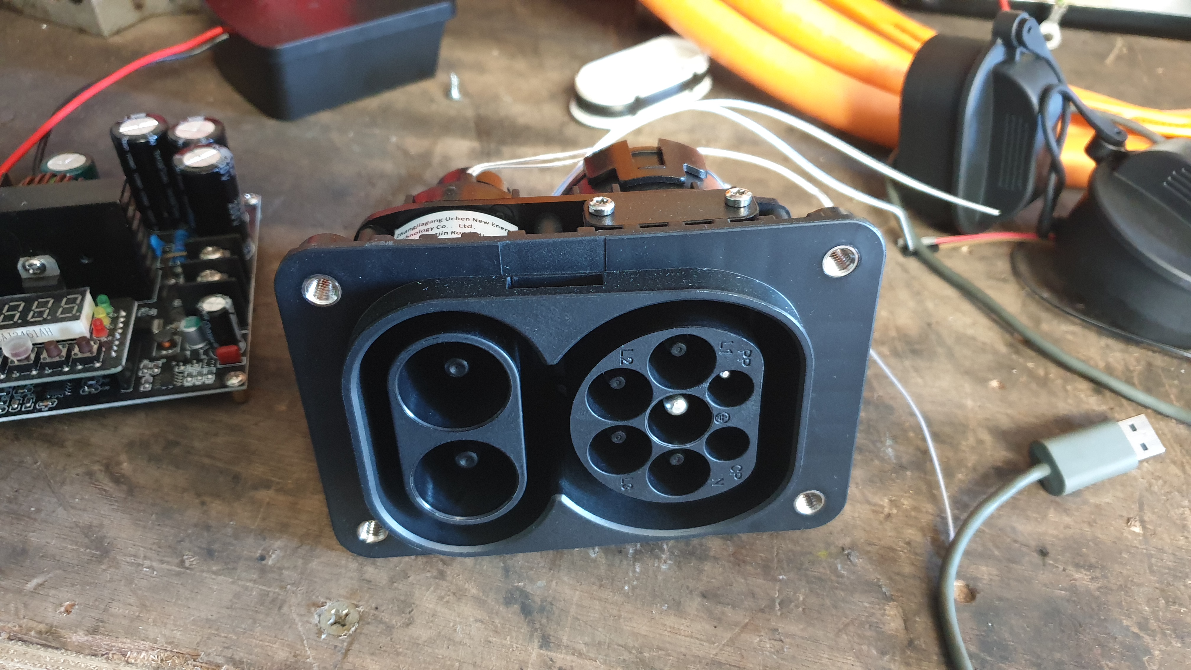

- Posts: 3563
- Been thanked: 88 times
Re: CCS EVSE and Car side
Got you covered on the socket. One thing I've learned over the years working with Johannes is the more complex and hardware intense the system seems to be , the more likely he is to solve it with an stm32f1 , a few resistors and caps and some lines of code ![Smile :)](./images/smilies/icon_e_smile.png)

- New Electric Ireland
- Posts: 172
- Joined: Sun May 31, 2020 12:22 pm
I recognise that socket... happy another New Electric donation is proving useful
