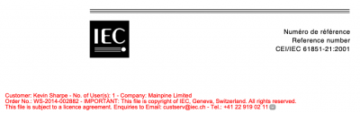

johu wrote: Sat Jan 09, 2021 8:38 pm EDIT: is there any problem in using the docs you bought to create an open source product?
If they are legitimate IEC documents then they will be licensed to named users only as detailed at the bottom of every page (see attachment). I would recommend contacting the IEC and reviewing the license before using the documents for development because they take copyright very seriously.

mikeselectricstuff wrote: Mon Jan 11, 2021 12:52 pm Even just re-writing the same information ( lists of commands etc.) would be OK.
The IEC disagree - "YOU may not lend, lease, reproduce, distribute or otherwise exploit, whether commercially or not, the IEC
Publication(s) to which this Licence Agreement relates."
https://www.iec.ch/webstore/custserv/pdf/Licence.pdf

You can absolutely implement IEC standards in open source software. Section 6.1 (p.60) of the linked document explains the steps you have to go through. The first step is that "someone" has to purchase a copy of the standard. Once that's done, "someone" can implement the standard in open source software - as long as there are no patents involved.
The problem for us (as far as I understand it) is that open source software is usually developed by a loose and evolving group of individual volunteers, not "someone". Unfortunately, the IEC rules don't permit you to share the purchased copy of the standard among that group of individuals.

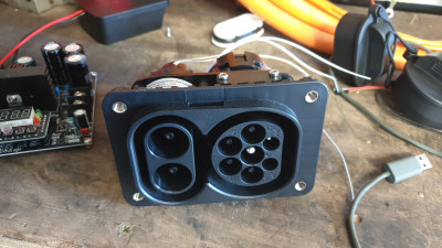

Posts: 4000
Been thanked: 1114 times
Re: CCS EVSE and Car side
Got you covered on the socket. One thing I've learned over the years working with Johannes is the more complex and hardware intense the system seems to be , the more likely he is to solve it with an stm32f1 , a few resistors and caps and some lines of code :)
New Electric Ireland
Posts: 172
Joined: Sun May 31, 2020 12:22 pm
Post by New Electric Ireland »
mikeselectricstuff wrote: Tue Jan 12, 2021 11:05 pm Someone could, for example, write a document encapsulating the same information, e.g. substituting code for a flowchart, renaming symbolic names etc.
In order to do this you would need access to a registered document and this would result in a violation of the "otherwise exploit" IEC license restriction.
If you read my first post you'll see my concern is that we keep our projects legal on Open Inverter. Lots CCS information sources exist including CharIn and open source drivers so we do not need to violate IEC copyright nor publicise questionable workarounds on a public forum.
Posts: 172
Jack Bauer wrote: Wed Jan 13, 2021 1:11 pm Got you covered on the socket.
I recognise that socket... happy another New Electric donation is proving useful 8-)
