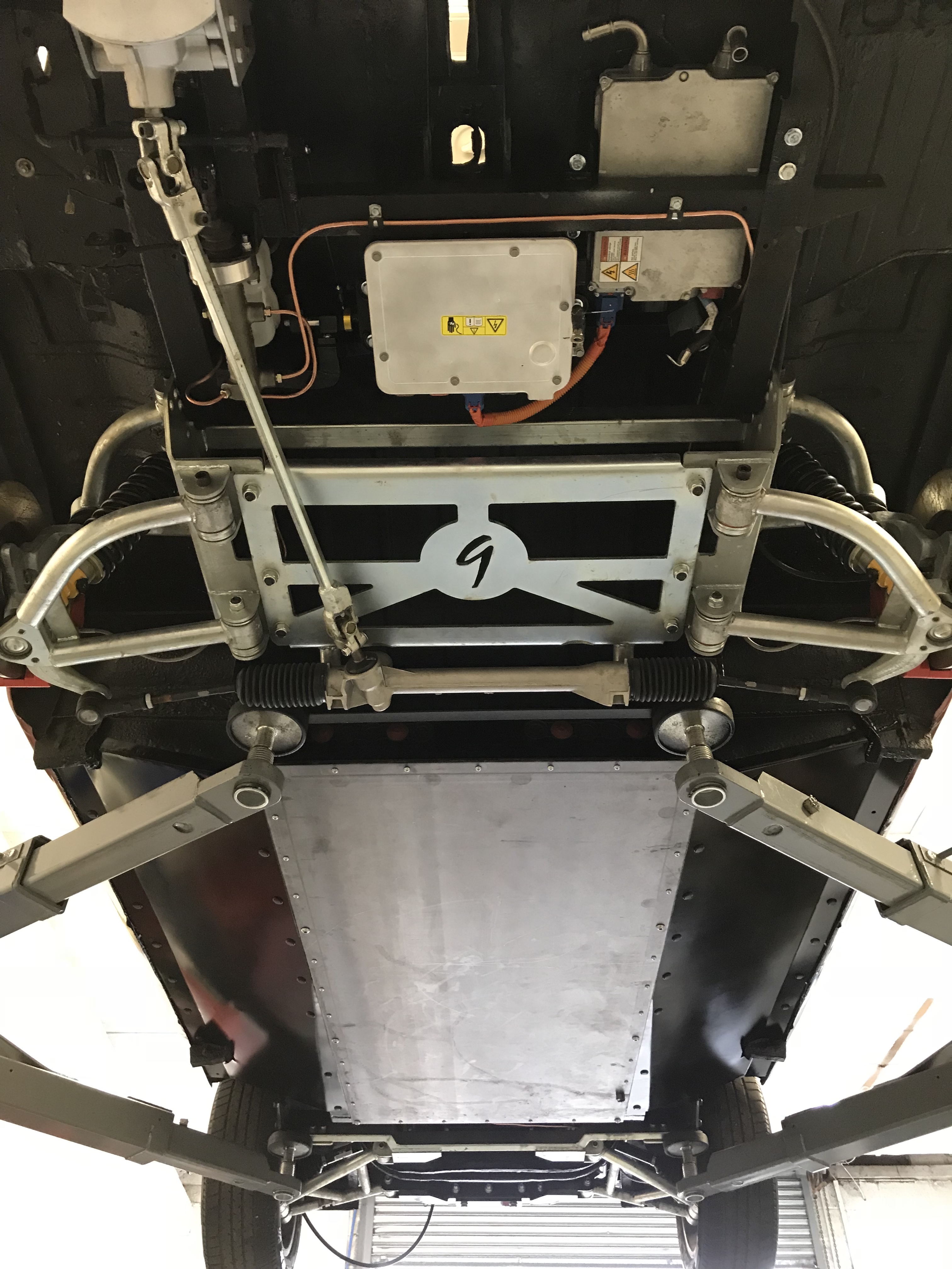

Just a few photos of the "ICE Breaker" project with lots more details to follow... for historical posts please see my DIY Electric Car Forum thread (here)

Re: ICE Breaker - 1967 VW Splitscreen Bus with Tesla Drivetrain/Battery
Clean Conversion² (as in clean code x no emission) haha.
I might have missed it in the historical thread but are you using that Type 2 DC fast charge port? Where did you get the socket from?
I consider using Type 2 instead of Chademo in the Touran because it seems to be more common in Germany.

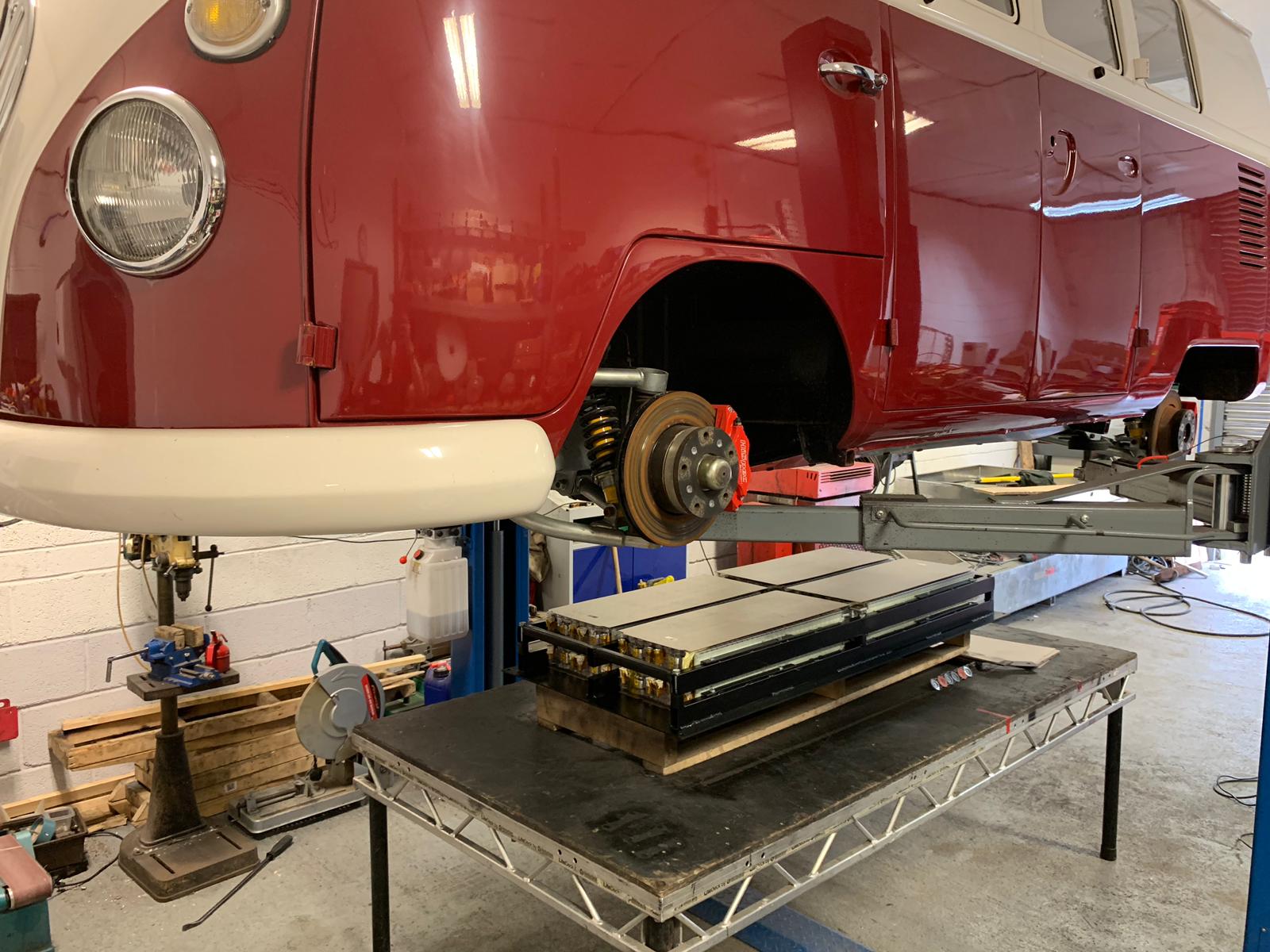

loading 8 Tesla P100 modules (50kWh) into the 'belly' of the bus today
Now thats a tight space for those batteries, specially having seen it first hand.
Good thing you will be reusing the Tesla BMS thus not requiring alot of wires.
Yeah, it's cosy in the 'belly' battery box
