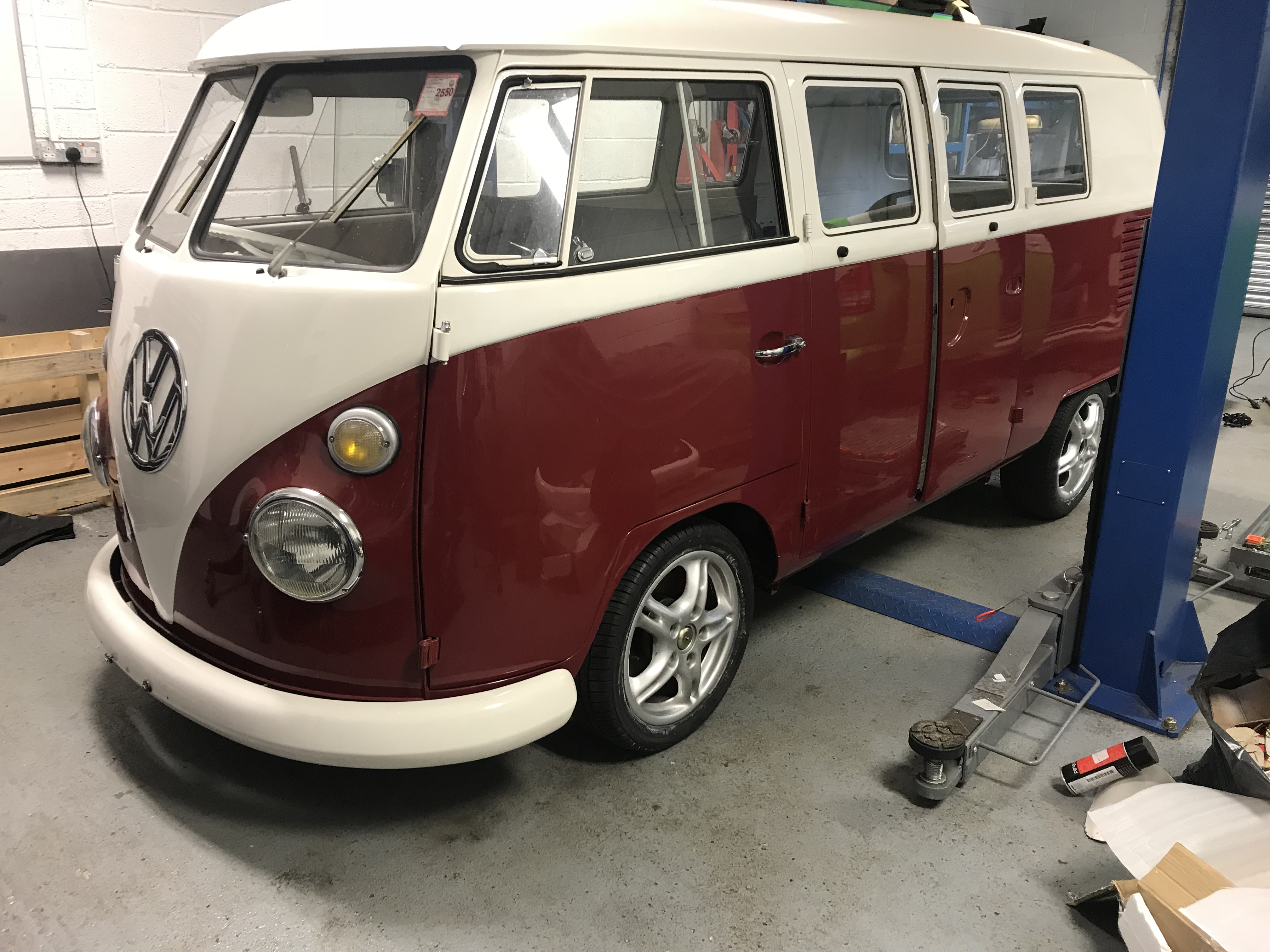

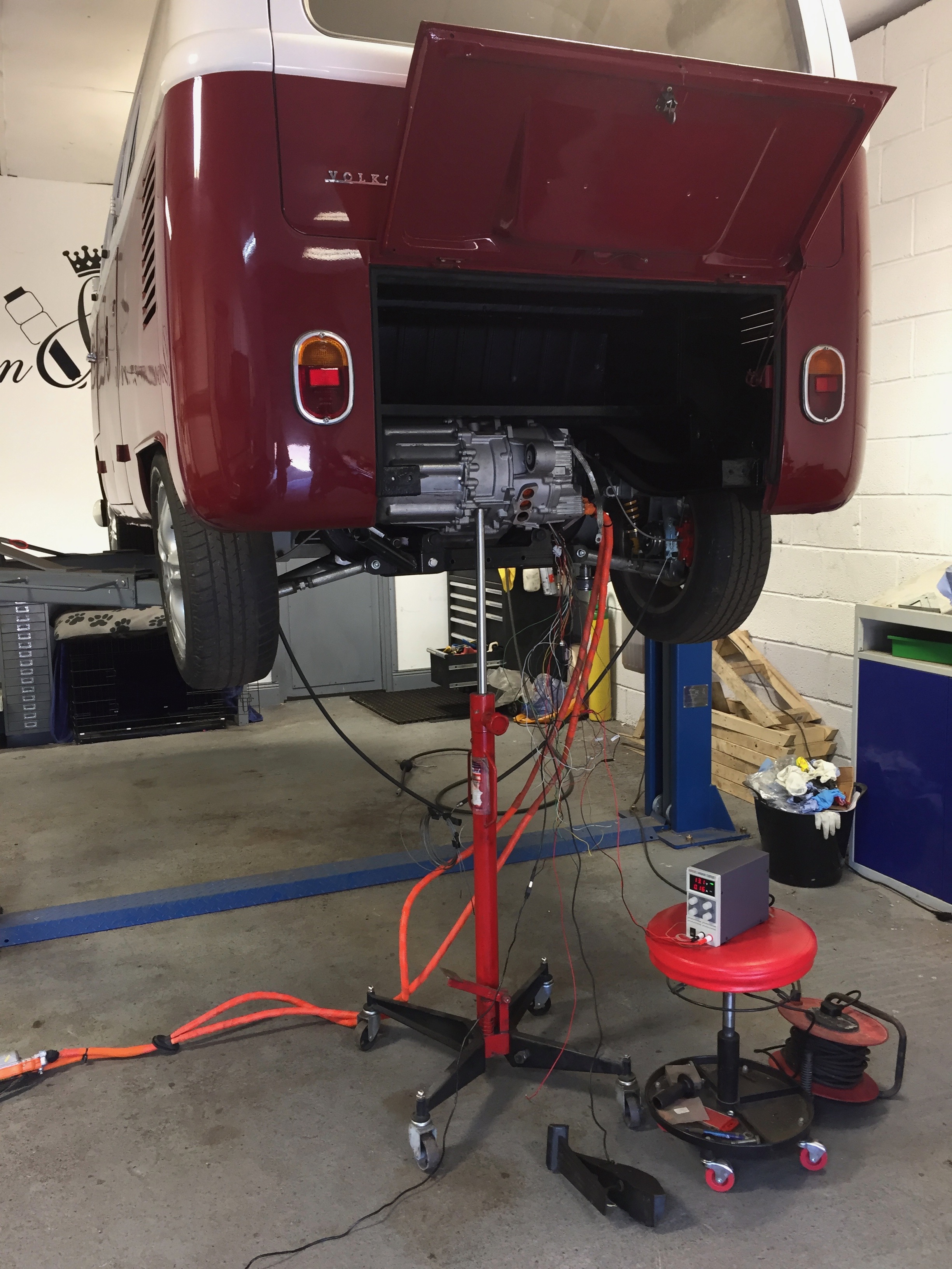

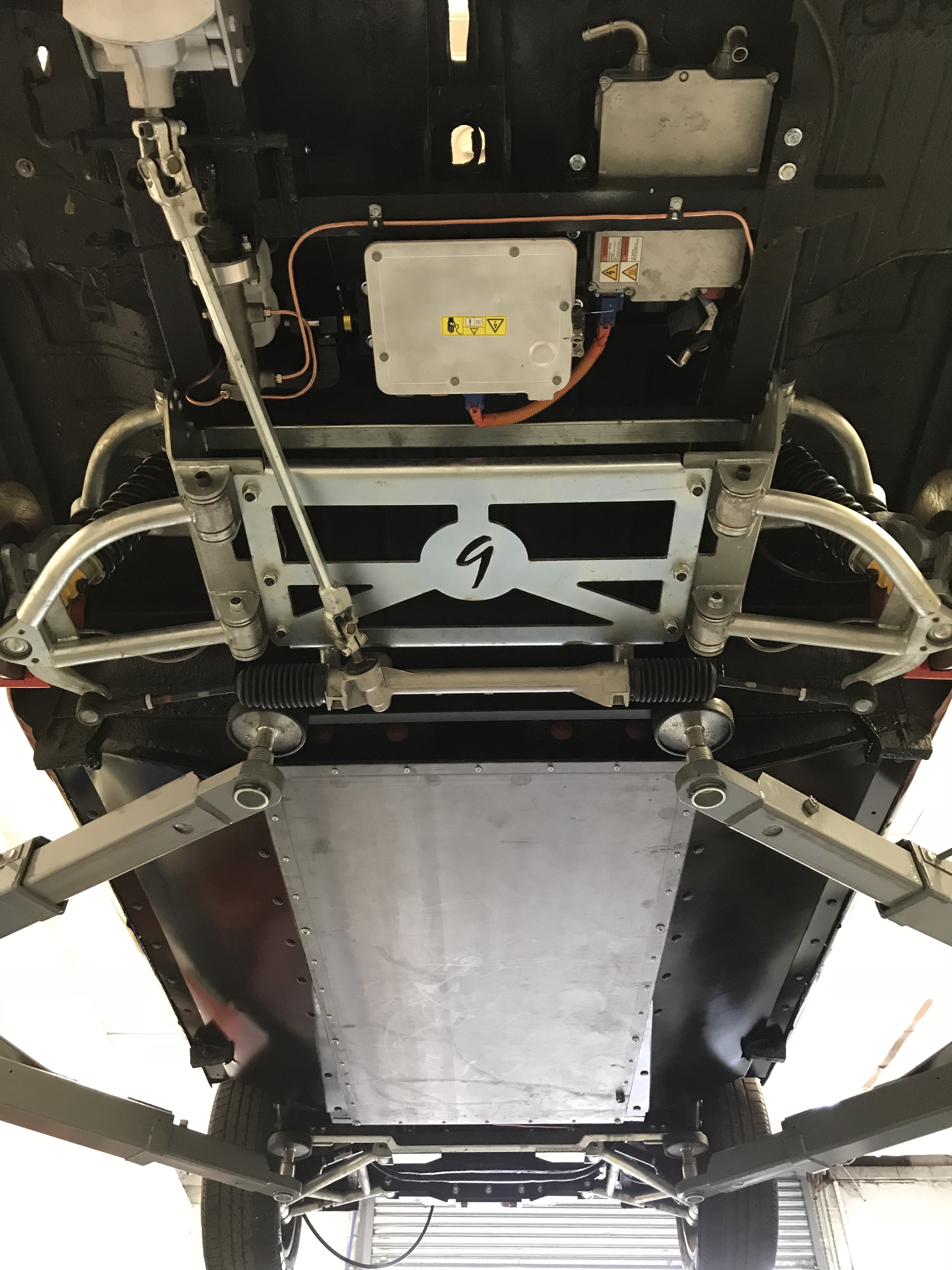

Just a few photos of the "ICE Breaker" project with lots more details to follow... for historical posts please see my DIY Electric Car Forum thread (here) 8-)

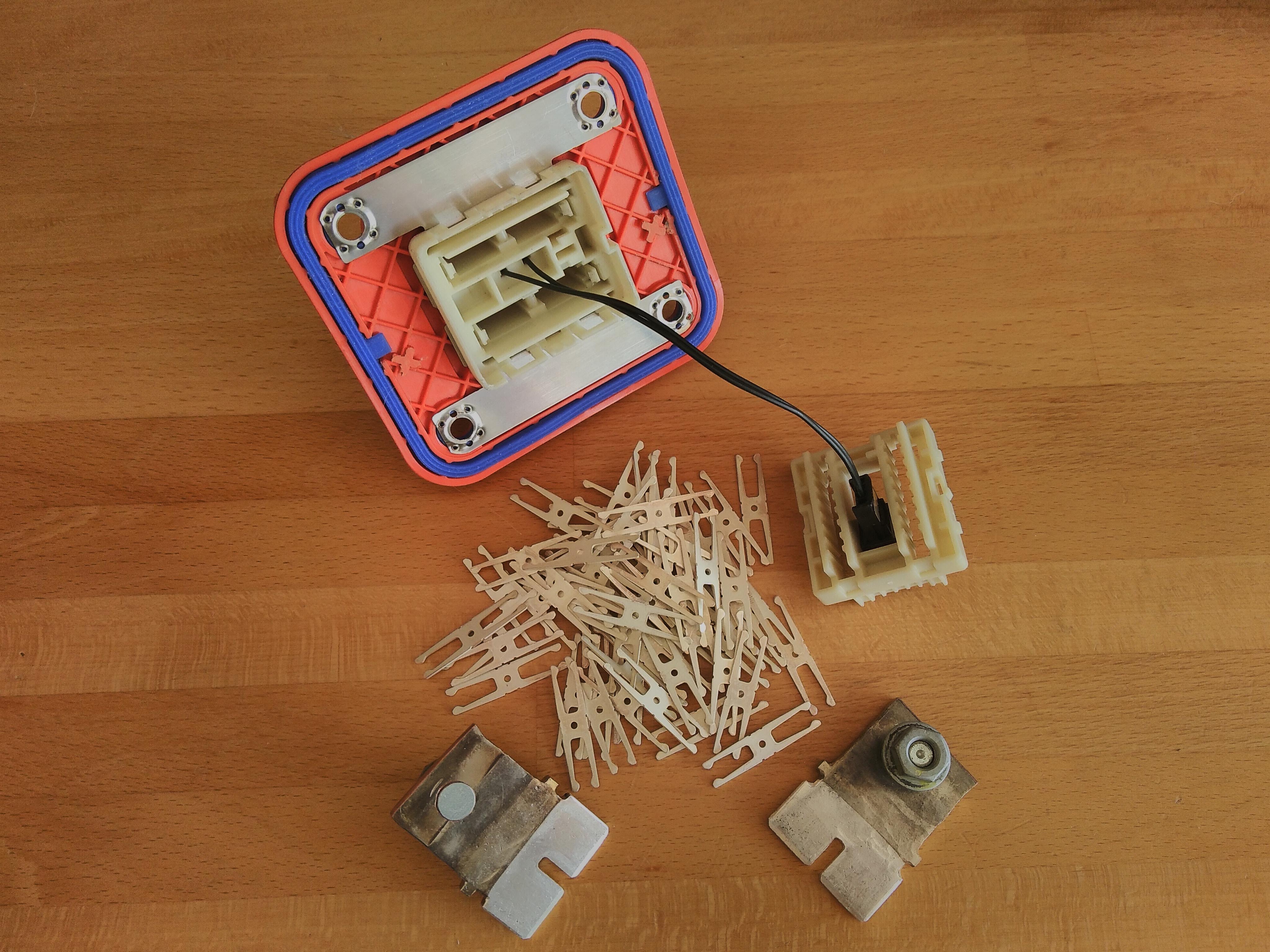

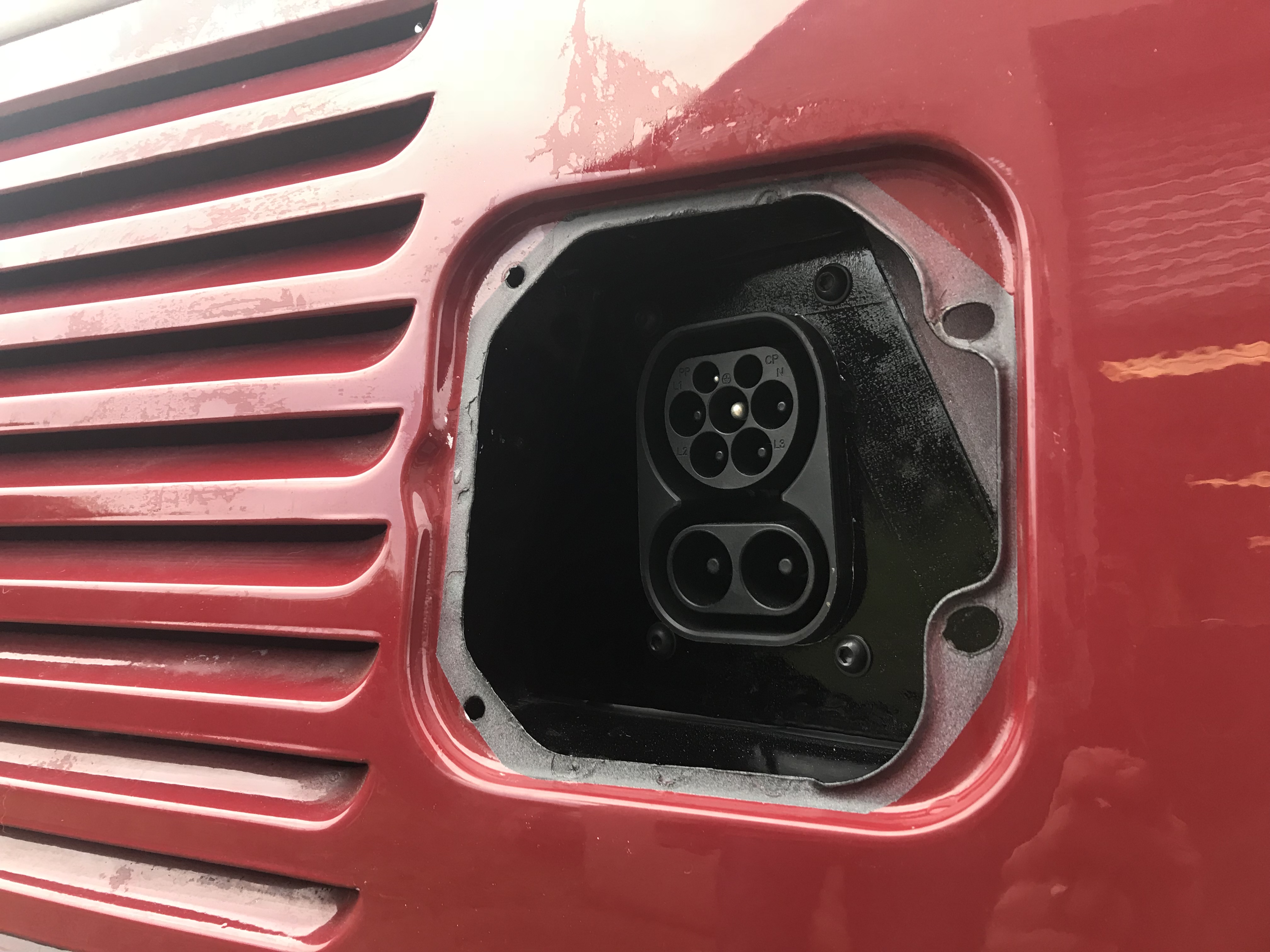

I might have missed it in the historical thread but are you using that Type 2 DC fast charge port? Where did you get the socket from?
I consider using Type 2 instead of Chademo in the Touran because it seems to be more common in Germany.
D@F

johu wrote: Wed Feb 06, 2019 4:13 pm
yes same question for me and same consideration for my golf....

johu wrote: Wed Feb 06, 2019 4:13 pmI might have missed it in the historical thread but are you using that Type 2 DC fast charge port?
Today we are using the Type 2 AC pins for 22kW three phase. Our long term goal is to use the Type 2 DC pins and I'm making some progress on finding a vendor for the HomePlug Green PHY that's required. Ideally I'd like to see the PHY added to Damien's Tesla charger board in a future release 8-)
johu wrote: Wed Feb 06, 2019 4:13 pmWhere did you get the socket from?
We purchased some from a vendor in China. I believe that Zero EV in the UK (here) will sell them in future, I'll ask Chris to comment here.
johu wrote: Wed Feb 06, 2019 4:13 pmI consider using Type 2 instead of Chademo in the Touran because it seems to be more common in Germany.

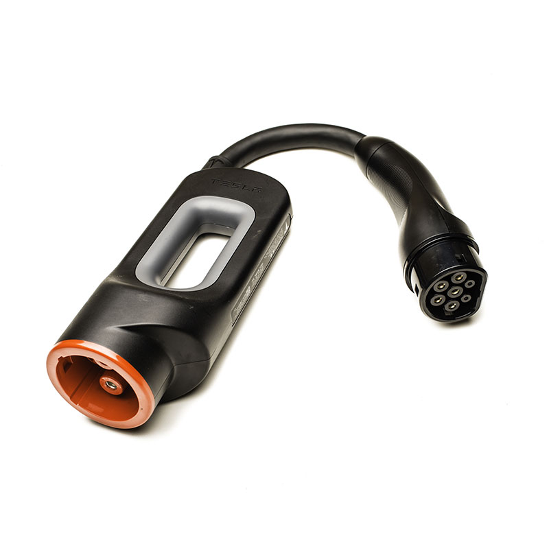

Both Damien and I plan to use the Tesla CHAdeMO adaptor (see photo) which will allow our cars to charge from AC (single/three phase to 22kW), CCS DC, and CHAdeMO DC :)

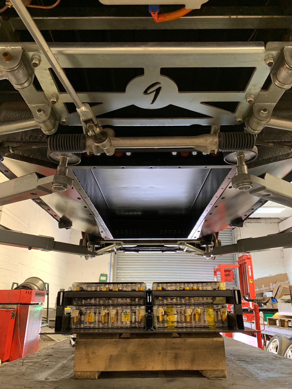

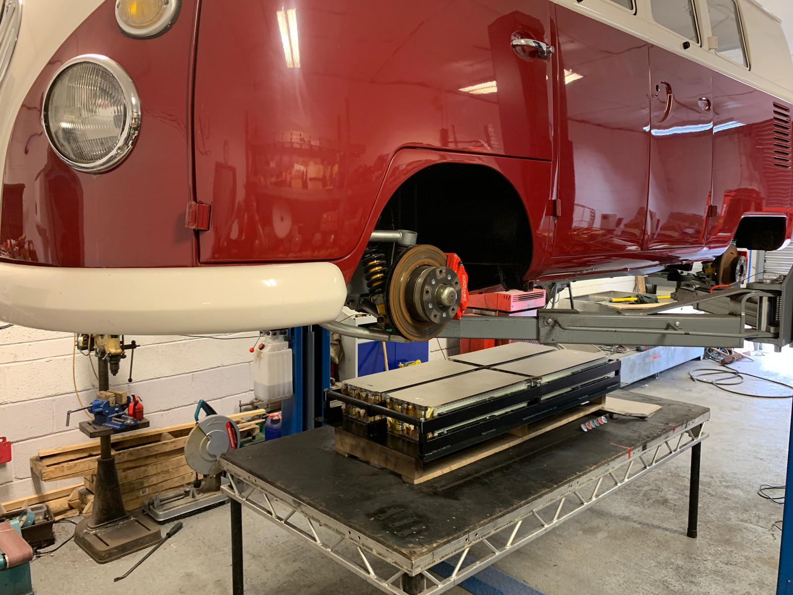

loading 8 Tesla P100 modules (50kWh) into the 'belly' of the bus today :D
Posts: 2392
Location: Bristol
Has thanked: 206 times
Been thanked: 563 times
Re: ICE Breaker - 1967 VW Splitscreen Bus with Tesla Drivetrain/Battery
Now thats a tight space for those batteries, specially having seen it first hand.
Good thing you will be reusing the Tesla BMS thus not requiring alot of wires.

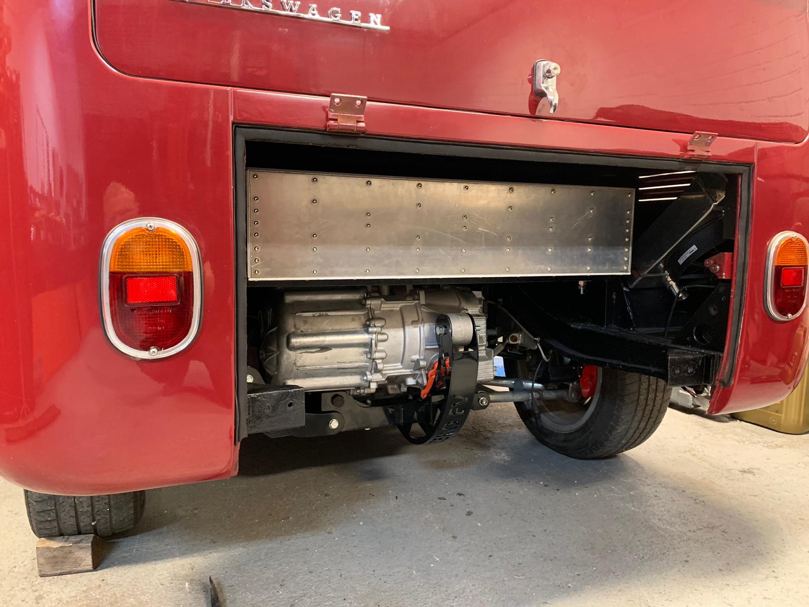

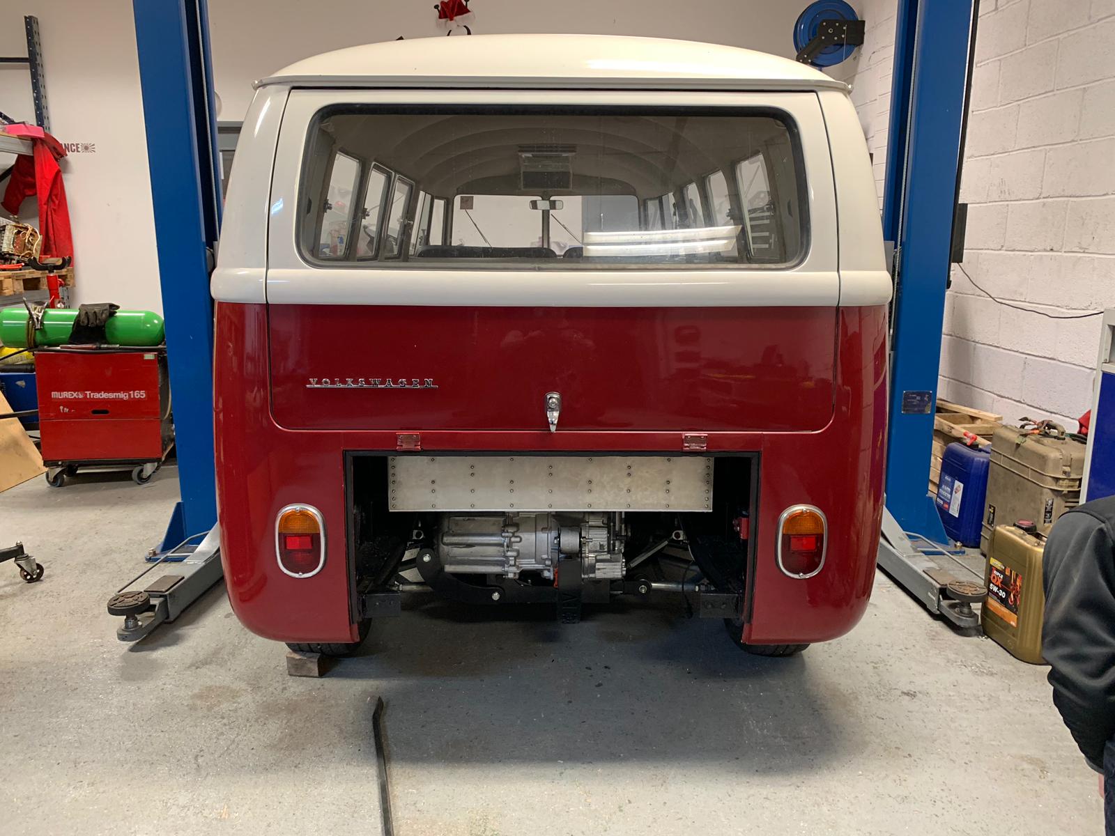

Another 4 Tesla P100 modules (25kWh) in the rear of the bus :D

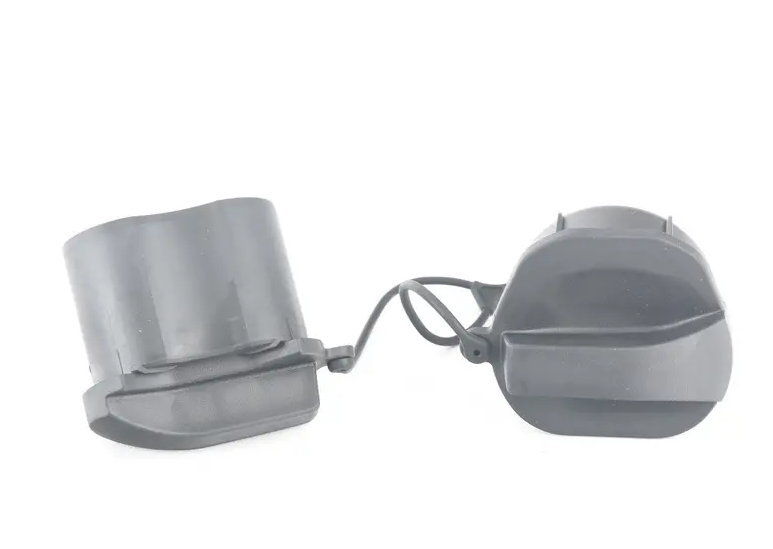

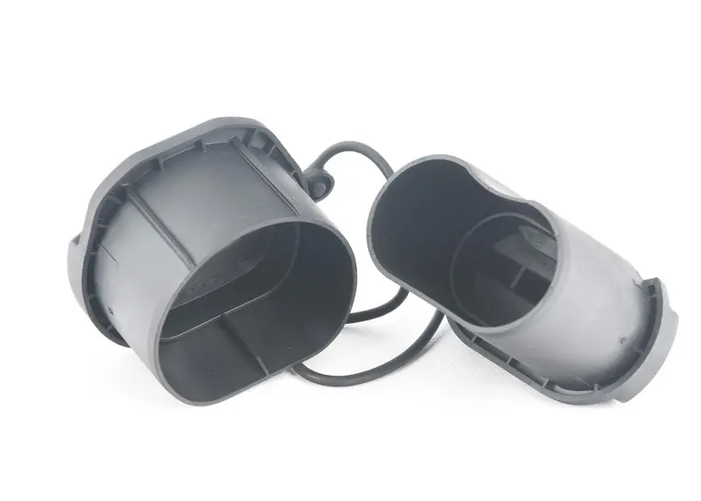

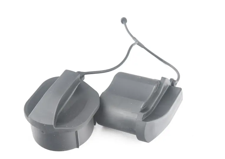

I recently purchased a new BMW i3 covering cap for the CCS charge port connector that I have fitted on the bus. The part number is 61 13 9 343 122 and it cost €36 from a BMW dealer :)
BMW also sell the caps without the CCS DC part if you're just fitting a Type 1 ("J1772") or Type 2 ("mennekes") connector and need some extra weather proofing. I don't currently have the part number for those versions.
I'll get some photos taken when I get a moment but for now here are some library pictures.

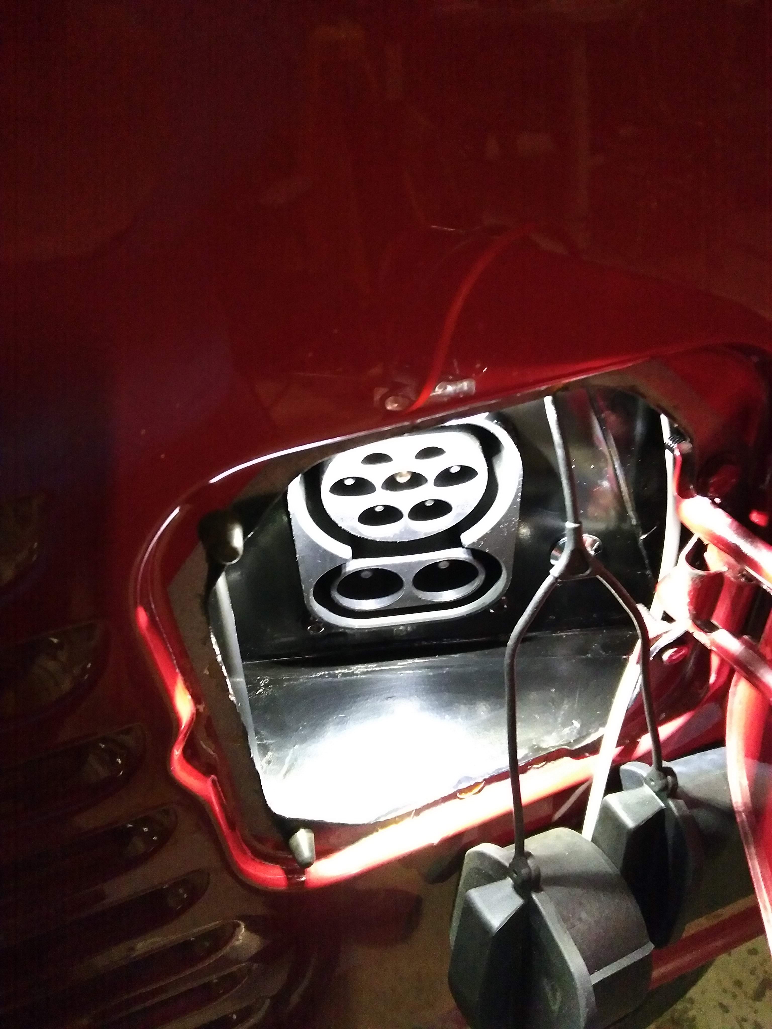

Simple pleasures... an automatic light for the charge port :)
Posts: 6709
Has thanked: 368 times
Been thanked: 1536 times
Nice :) Was there an existing switch you could use or how do you trigger it?

johu wrote: Sat Nov 09, 2019 2:55 pm Nice :) Was there an existing switch you could use or how do you trigger it?
No switch in the bus so installed a proximity sensor to detect the fuel flap open/closed :)

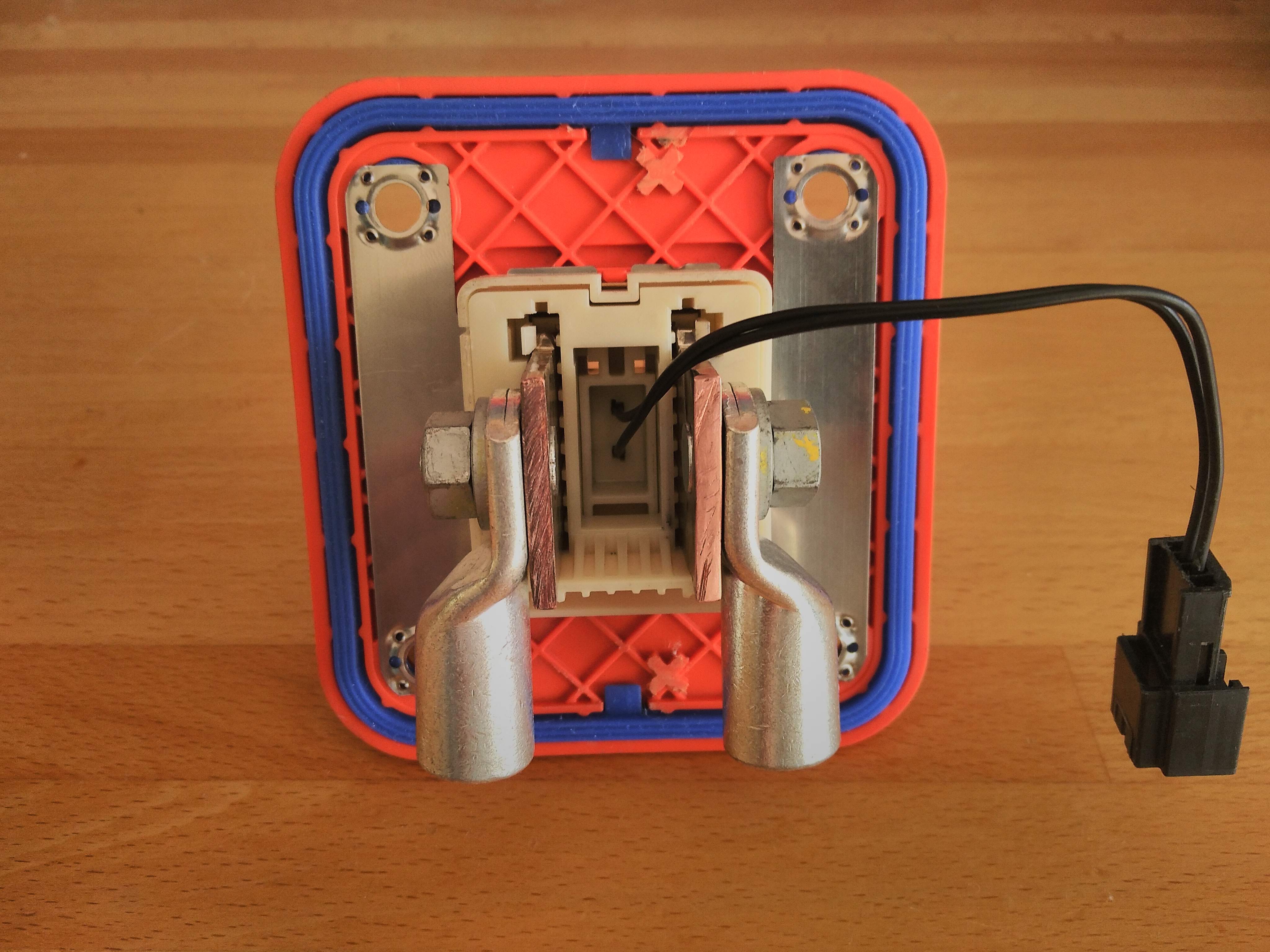

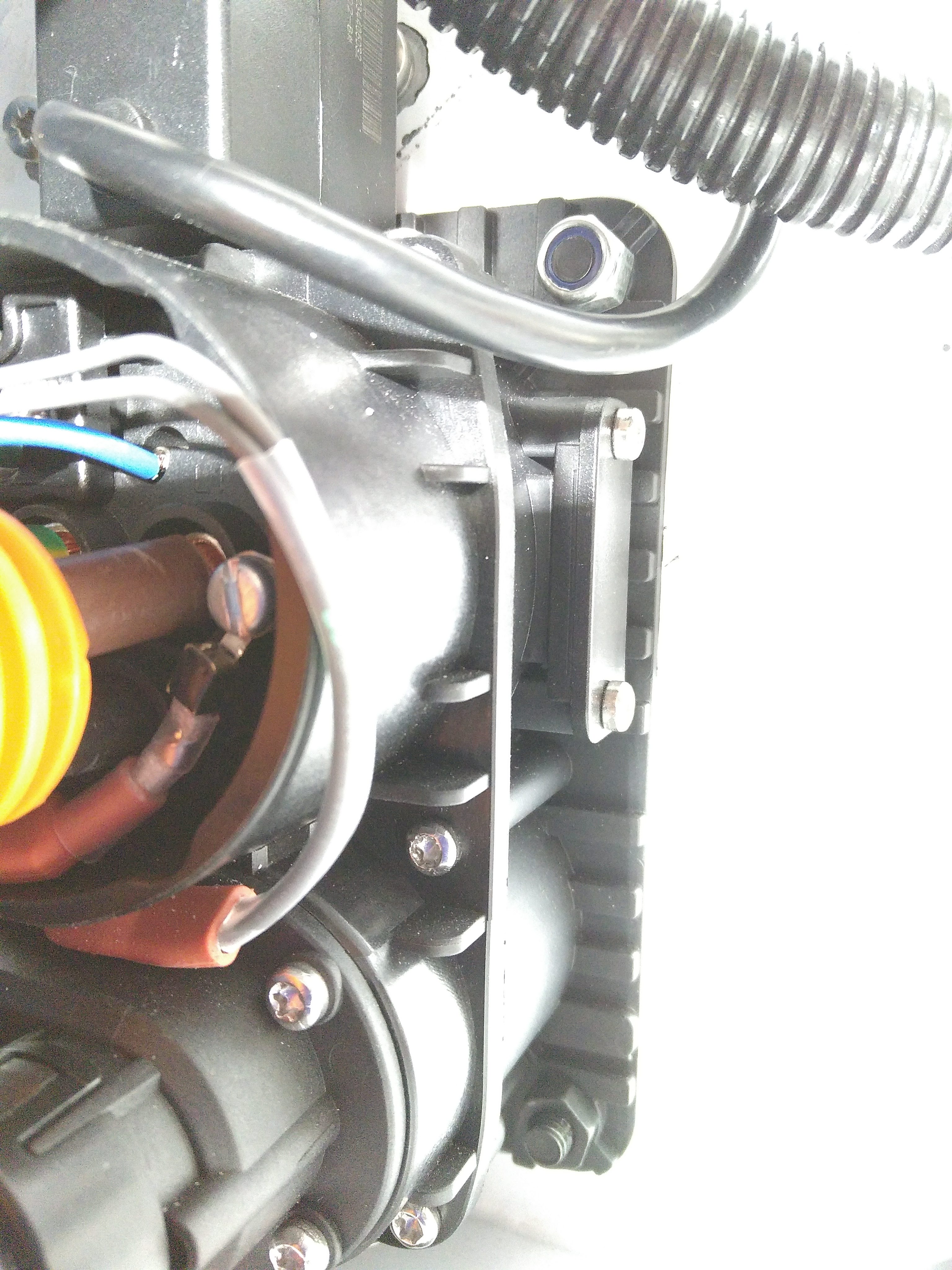

I decided to reuse the Tesla Model 3 charge port thermistors in my CCS connector. I haven't attached them directly to the DC power pins as per the Tesla connector but went for an easy option of using existing screws located in both the AC and DC pin area.
Hopefully they will give me a rough indication of the connector temperature during charging and also provide compatibility with the Tesla CCS controller (here) :)

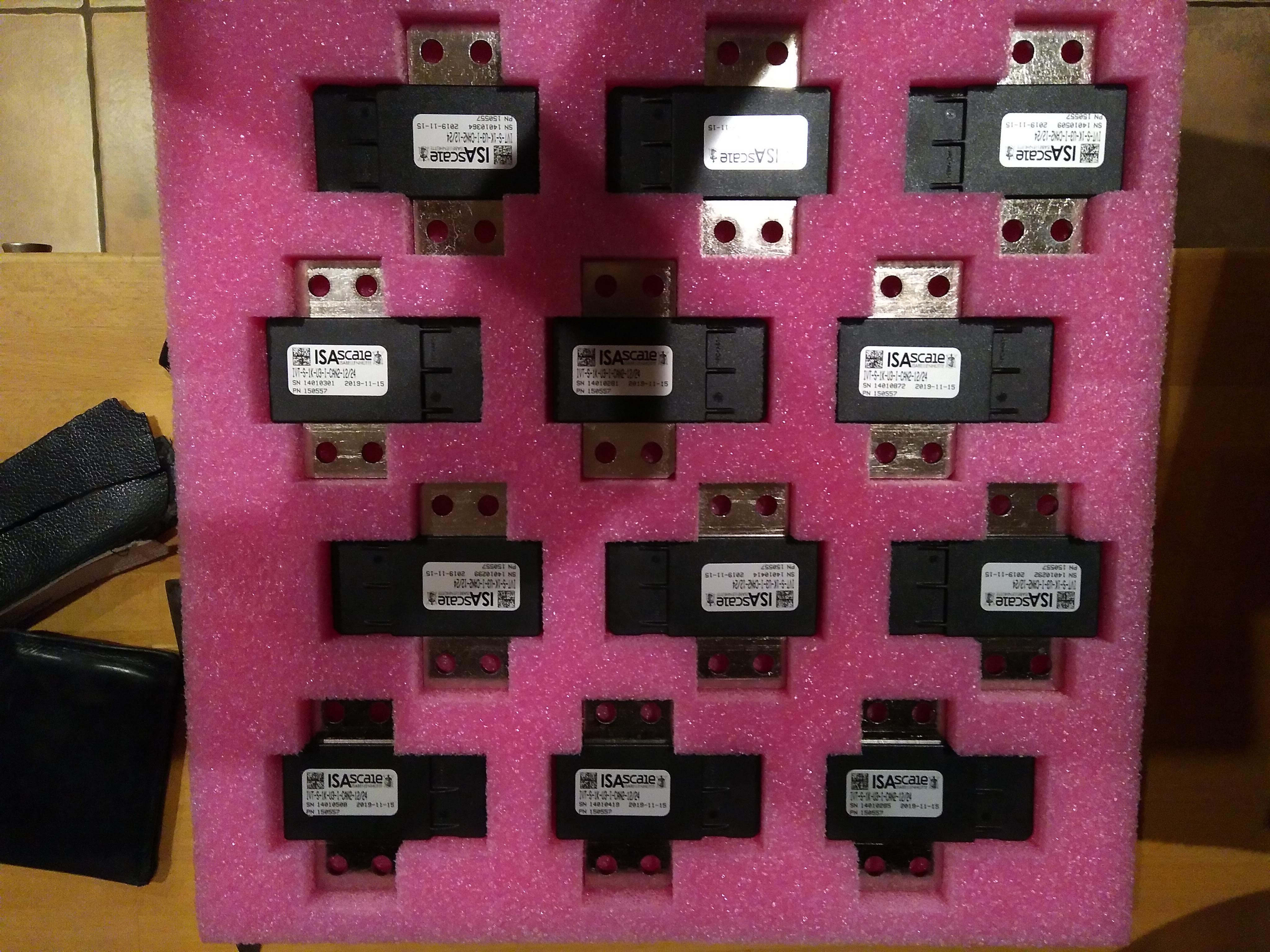

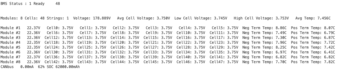

We have some new toys... 1000A IVT-S 'shunts' (data here) :)
Posts: 2392
Location: Bristol
They are really nice, incooperated them into the SimpBMS already.

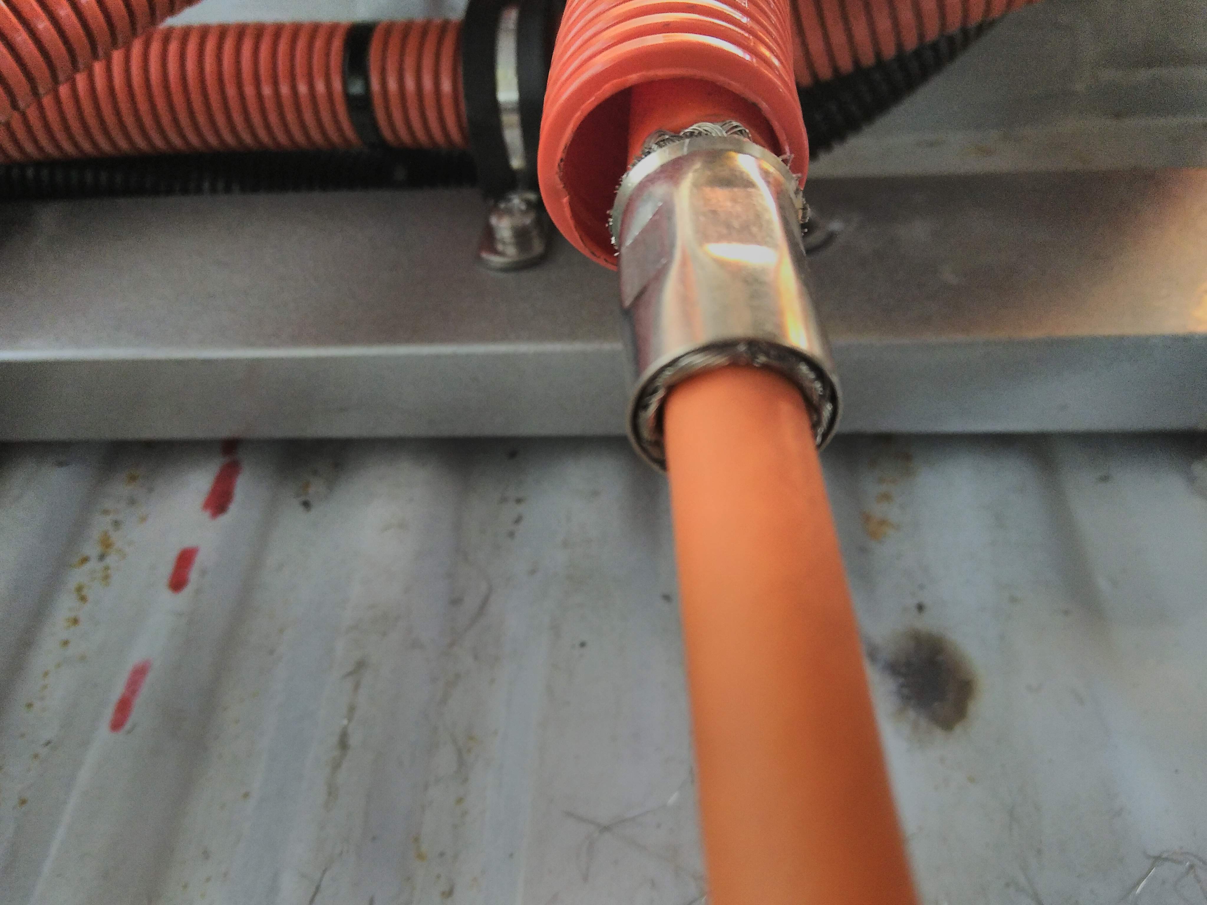

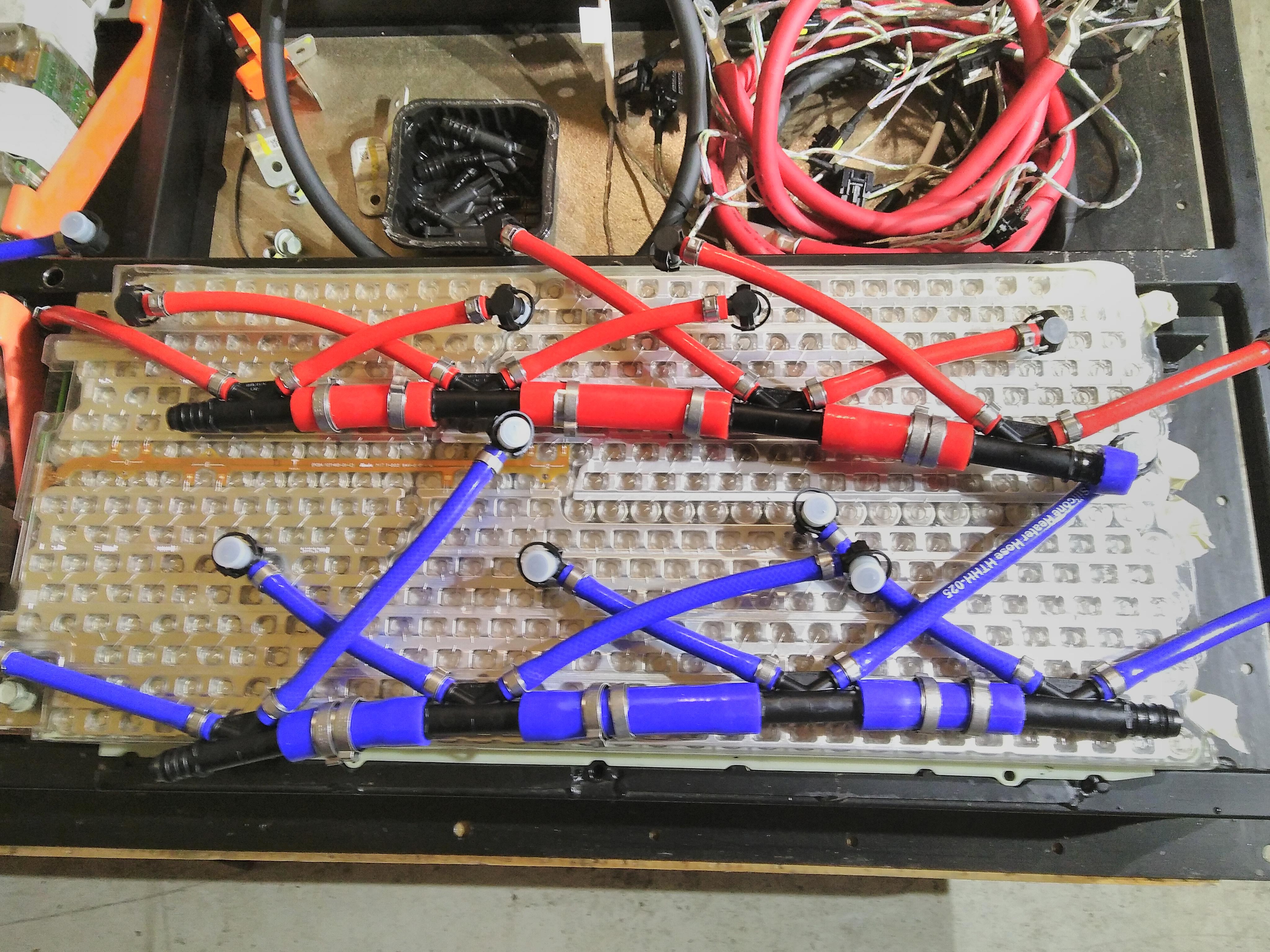

so much Tesla battery plumbing :)
larsrengersen
Posts: 143
Has thanked: 10 times
Been thanked: 28 times
Post by larsrengersen »
Cool! Using the P100 modules is a hot topic.
Do the colors imply you have a in/out (assuming cooling)?
Or does it imply you have a heating and a cooling sub circuit within the module?
How did Tesla use the modules?
I was expecting counter flow for better heat exchange.
