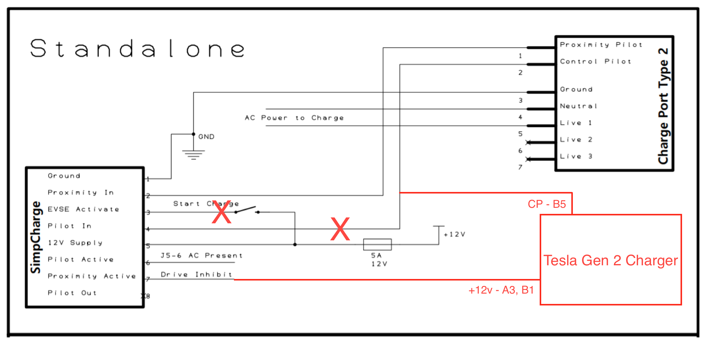

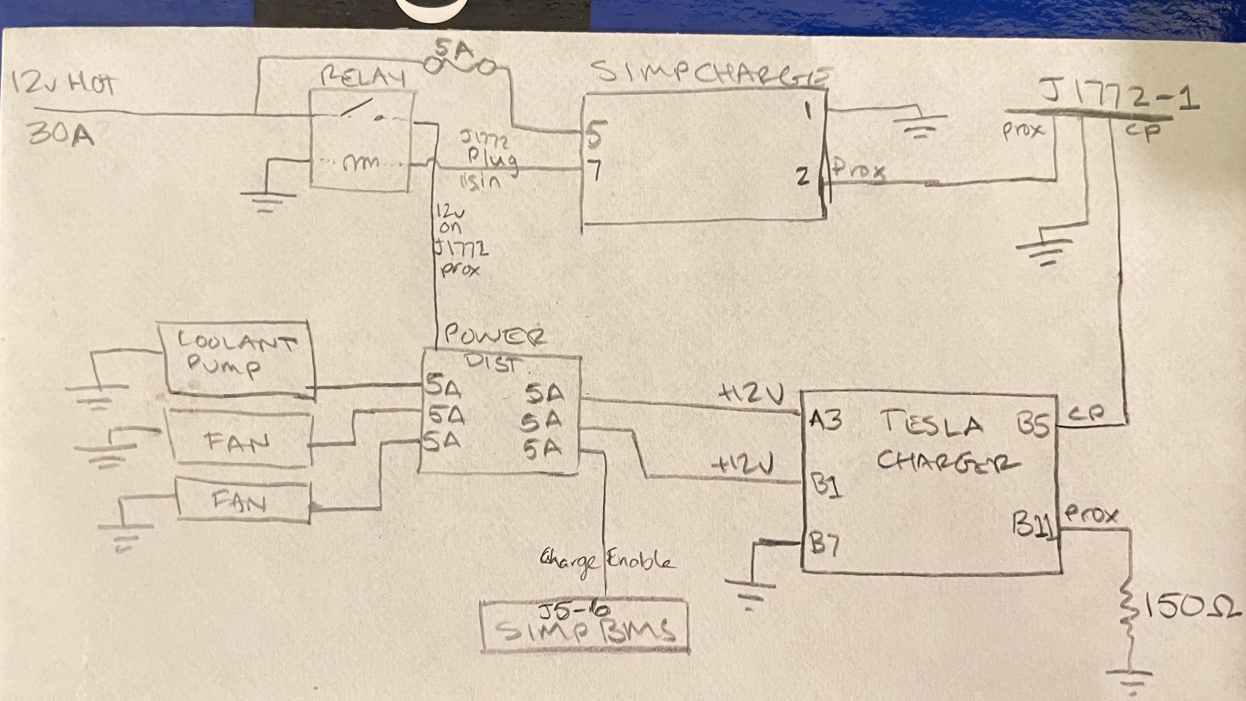

I can confirm that the Gen 2 V5 software has the correct scaling on my 1014963-00-G charger.
I've just ordered a SimpCharge from Tom to fire up the power to the charger (and BMS) upon J1772 physical plug in. If I'm reading this correctly, The Proximity goes to ONLY the SimpCharge and the Control Pilot goes to ONLY the Tesla charger, like so:
Can anyone confirm that this will work, and the Tesla charger will start without being connected to the Proximity signal from the J1772 connector?

Your mileage may vary, I'm using a Type 2 rather than Type 1 inlet, but I did not find Simcharge to play well with the Tesla charger (V4 control board) to be honest.
The charger wants to see the proximity signal, so I looped that to both devices. However, the charger appears to interfere with the level detection done by the Simpcharge, so its proximity 12V output stays on all the time. So we can't use that.
For the pilot signal, it looked like there's an input and filtered output. Since the pilot signal measurement seems flaky on the V4 board, I thought I'd try that: no, it doesn't work. With the pilot signal looped into the Simpcharge pilot input as well as the charger, and using the Pilot active 12V output to power the charger, that does seem to work.
However I'm not convinced that the sequencing is exactly right, and I can hear the relay in my EVSE chatter a couple of times when you plug in.
Frustration was compounded by the molex minifit connector used, which is incredibly fiddly if you don't have the specific crimp tool, and even more so if you need to un-do a connection because you guessed wrong.
Now I've spent a day wiring it in, I'll try it out, but any further problems arise I'll change it back to a microswitch on the fuel flap - a reminder to respect the KISS principle...

Guys please keep in mind the Tesla Charger board is designed to be the ONLY item connected to the charge port really, Unless the firmware gets modified. As the EVSE signals are always based on voltage dividers anything else adding resistance to the circuit will cause issues.
A "Workaround" would be:
1-Pilot signal is only needed by the Charger this can be direct.
2-The proximity signal is no more then a resistor divider to ground, so you can do this externally for the charger to mimic being always plugged in.
3- The actual charge port signal to the SimpCharge to activate the charger only when actually plugged in.
This means the EVSE/plug is detected by the SimpCharge via Proximity.
The EVSE is controlled by the Tesla Charger opensource board via the Pilot signal.

Thank you Tom, this makes complete sense. Simply spoofing seems rather simple! Your knowledge and openness to share is invaluable.
Attached is my simplified schematic, for anyone who may want to recreate in the future.

Well, against my better judgement I wired up the Simp Charge as shown above before resolving the other issues. It works perfectly!
It takes about 10s from plug insertion to charge start with a cold boot of the charger. The Simp Charge triggers the BMS to charge mode (precharge and main contactors), turns on the Tesla charger, and fires up the cooling system and fans. Overall, very pleased.
Haven’t dug into the charger itself yet, but am very happy to have a low drain system that fires right up on command. Thanks Tom!!
edit: I did check all grounds, they are all going to the same point on the case and look clean and tight. That didn’t do it, on to the next..
