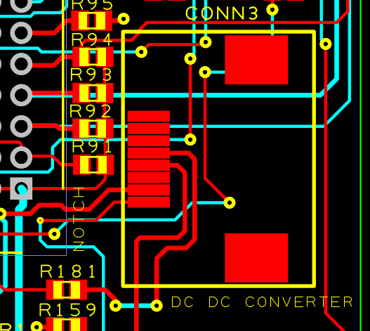

If you have a look at the schematic for my prius gen 3 board it gives the pinout for dcdc control. From memory there are 3 wires. on/off , 12v sense and pwm.

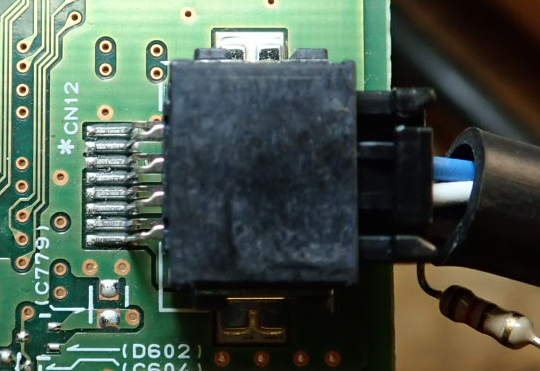

Jack Bauer wrote: Mon Feb 24, 2020 4:18 pm If you have a look at the schematic for my prius gen 3 board it gives the pinout for dcdc control. From memory there are 3 wires. on/off , 12v sense and pwm.
I'm sure the purpose of the wires are probably the same or very similar however I've had a quick look and the colours are slightly different and the connector pinout is also different. More importantly there are 4 wires not 3.
Counting from the top becuse of the * index the coloured wires are connected as follows.
The Prius connector on your schematic and PCB are connected to different pins.
I don't have enough spare time to look into it any further for a few days.
