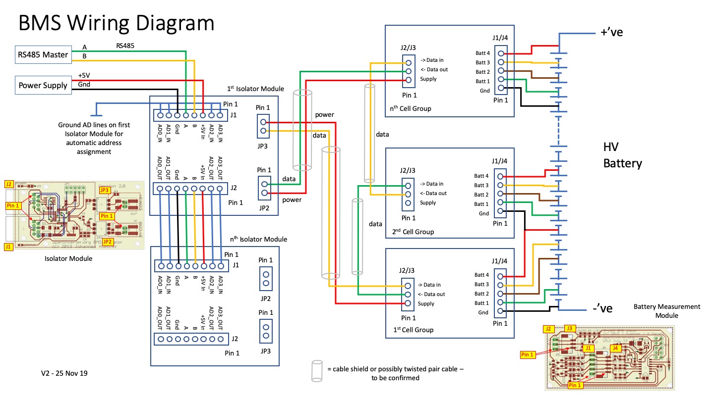

I've created this wiring diagram for Johannes' BMS and added it to the Wiki as well.
This diagram has been edited. The connections on the 1st isolator module connector JP2 were reversed. Also swapped the position of JP2 and JP3 on the diagram to match the actual PCB
Posts: 6709
Has thanked: 368 times
Been thanked: 1536 times
Re: 4-channel BMS with daisychain bus
Beauty :)
