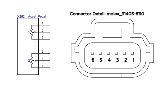

Only thing is that it won't let you measure the resistance so it's not only a simple pot in there...
This is the pin out for reference.
Voltage 0.7v to 3.8v approx.
1= Ref.
2=Sign
3=Return
4=Return
5=Signal
6=Ref.
Note: See the swap of polarity on the second set!

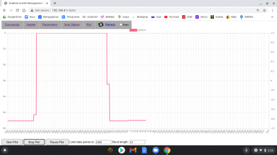

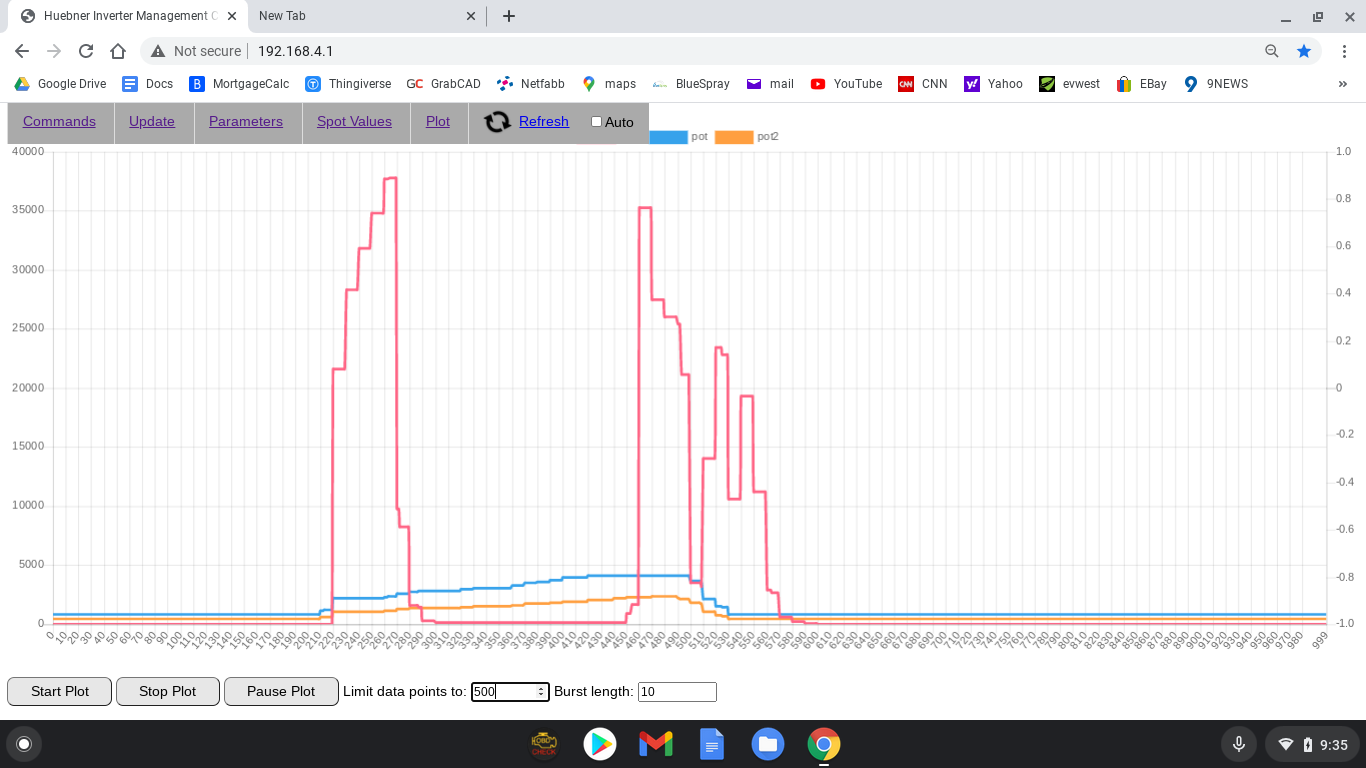

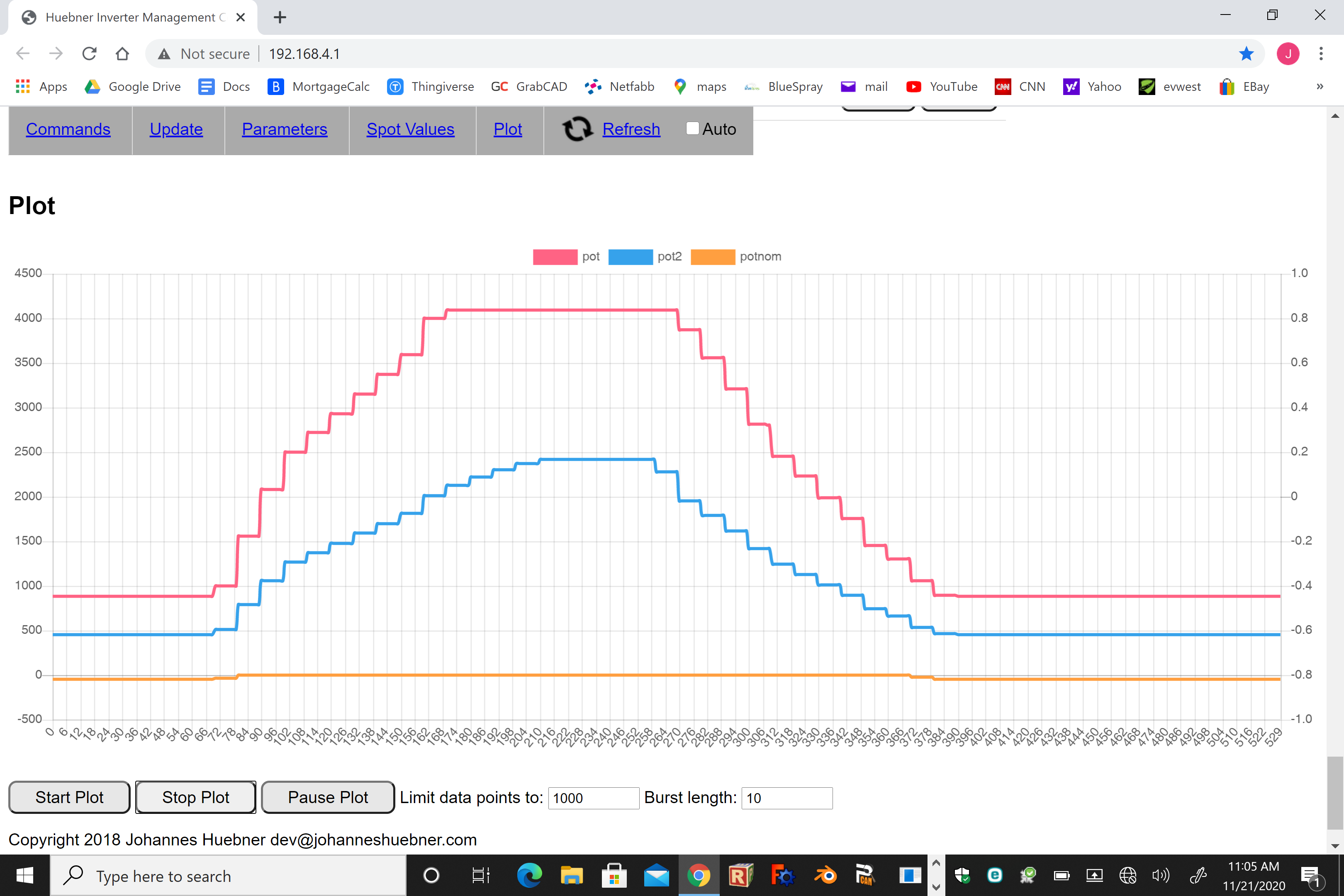

I'm having a weird problem with my throttle pedal while bench testing LDU at 80volts.
Dual hall effect pedal from old maxima, with two pot channels test and plot perfectly.
I configured the dual channel potmode for throttle signal redundancy, calibrated the two pot signals, everything seems fine, running motor, etc...
The problem is, there's a giant dead spot in the middle portion of throttle travel.
I've run a plot showing both throttle pots rising slowly as I depress the pedal VS amps to the motor. there's a deadspot thru the major central part of the travel, and it feels software induced. What am I missing? I did need to reverse the direction of motor rotation, is a side effect of that?
Is it a parameter problem? I've attached the plot and the param file if anyone has any chance to look, I'd be very appreciative.
Thanks-john
Blue=POT Brown=POT2 Red=AMPS
Thanks-john

Re: Throttle Pedal
The parameters ampmin and slipstart are your friends.
First try lowering slipstart in 5% decrements, maybe down to 30% and see if that fixes your problem. Then you can also try raising ampmin like up to 10%

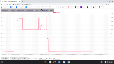

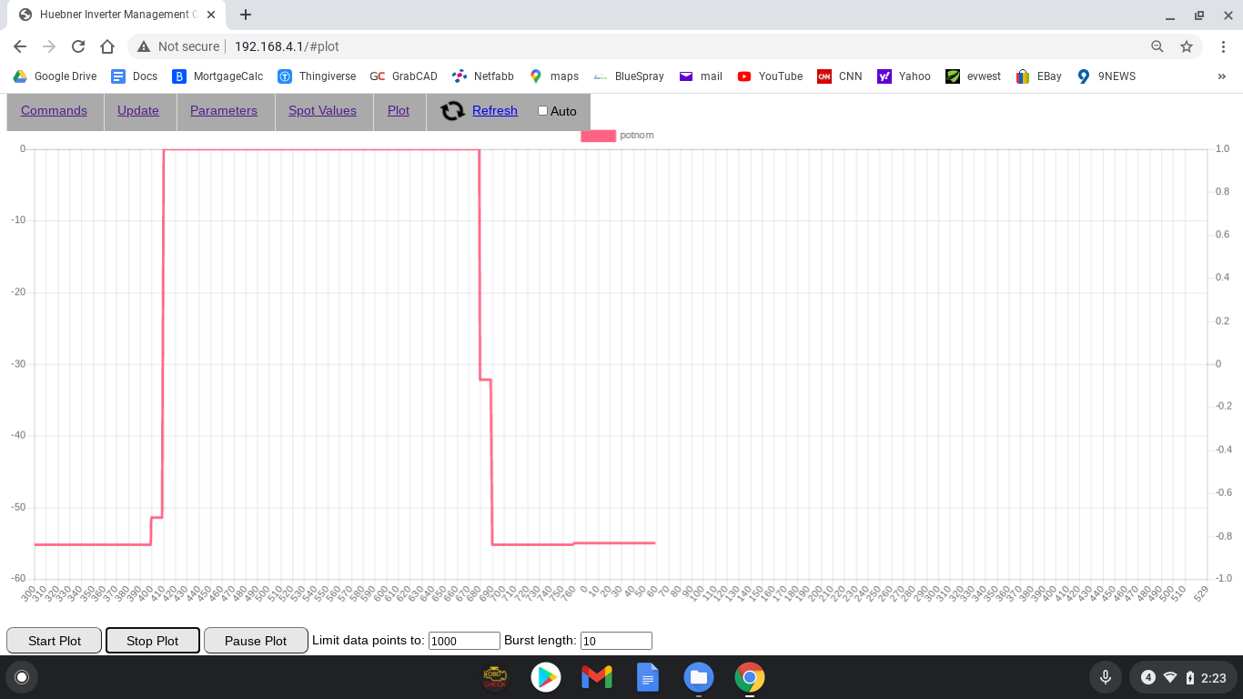

Re: Throttle Pedal
Thanks johu, I've visited Patreon to express appreciation for digging into this issue, and look forward to doing so again in the future.
I tried your suggestion, but not much change.
As a control experiment I reverted to SingleRegen mode, unplugged the throttle POT2 pin, recalibrated the min/max values, and it works perfectly linear like it should.
Plotting DualChannel potnom shows a problem with POTNOM, maybe the pedal I'm using doesn't stay within the required offset tolerance between the two signals , thus becoming invalid unless they align -more closely- at the beginning of pedal travel, and at the end... just not in the middle.
Ive attached plots both singleregen and dualchannel POTNOM, for what they're worth...And I've ordered an E46BWM pedal in hopes of finding the proper pair of signals. Is there a tolerance setting between these signals to accept some slop in the paired signal offset?
- Posts: 656
Re: Throttle Pedal
The offset tolerance is 10 and cannot be set by user as of 4.85. If you'd like to edit the software and compile it yourself, the value is in throttle.cpp in the source code.

Re: Throttle Pedal
"10" means 10% difference in slope.
Maybe the problem is that pot1 saturates at 3.3V. Put a 2k7 or 4k7 in series with it and recalibrate. This forms a voltage divider with the on board 10k pull-down resistor.

Re: Throttle Pedal
Thanks for the explanations, I thought about a resistor to more closely match the signals.
So, I wired it up, 2k7 resistor to POT, and first test plotted very good, but now after a reboot i seem to have upset my always (for months) reliable WIFI connection. Not lost, but VERY SLOW data rate, no parameters right away, maybe an update every 5-20 seconds...
Now after reversing my steps I still have very slow parameters with the drive unit, have I upset the DU, or does it sound like a component failure? I've searched, but found no real answer. I've disassembled inverter cover to check the board and connections, reseated, flashed to current firmware, and updated the web files as described in the video with parameter subscriptions.
Up until now, I have been bench testing, occasionally with 80v, occasionally with no HV connection, operating everything fine...
but now the contactors will not complete a precharge sequence... Have I cooked it somehow or locked up the DU with an out of range throttle signal?
Apologies if this has been covered elsewhere, otherwise maybe new unexpected behavior, even if I need to buy a new board, thanks

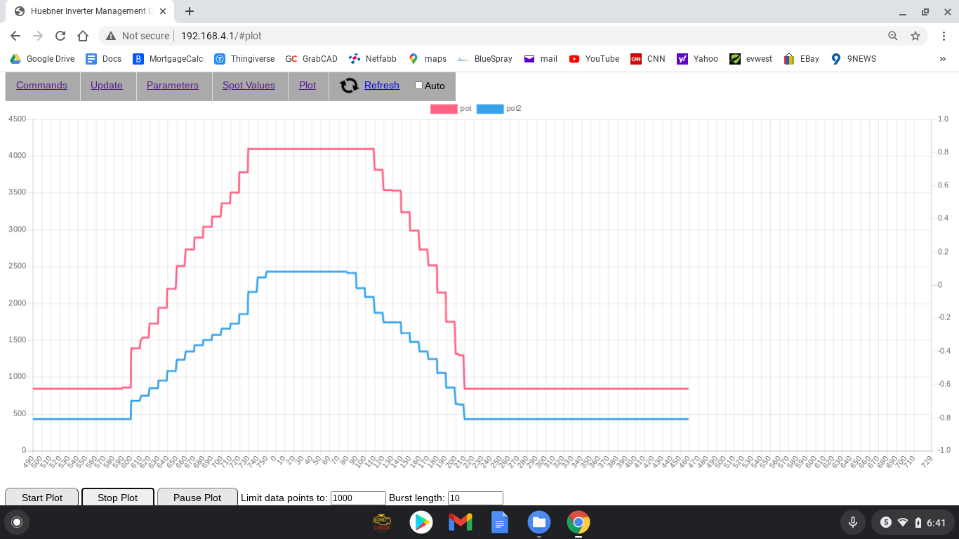

Re: Throttle Pedal [SOLVED]
Success!
Everything is functioning perfectly.
I found an intermittent ground fault in my test bench HV switching hardware which explained my precharge fail symptom.
Also, the chromebook I was using has lost ability to communicate with my v4b board at a useful refresh rate. Different computer works fine. (??)
So, the two problems at once lead me down the "What did I burn" rabbit-hole.
It all works great now.
Thanks for the continued support!
Here's a successful plot of my dual-channel throttle and potnom values I was seeking in the first place.
