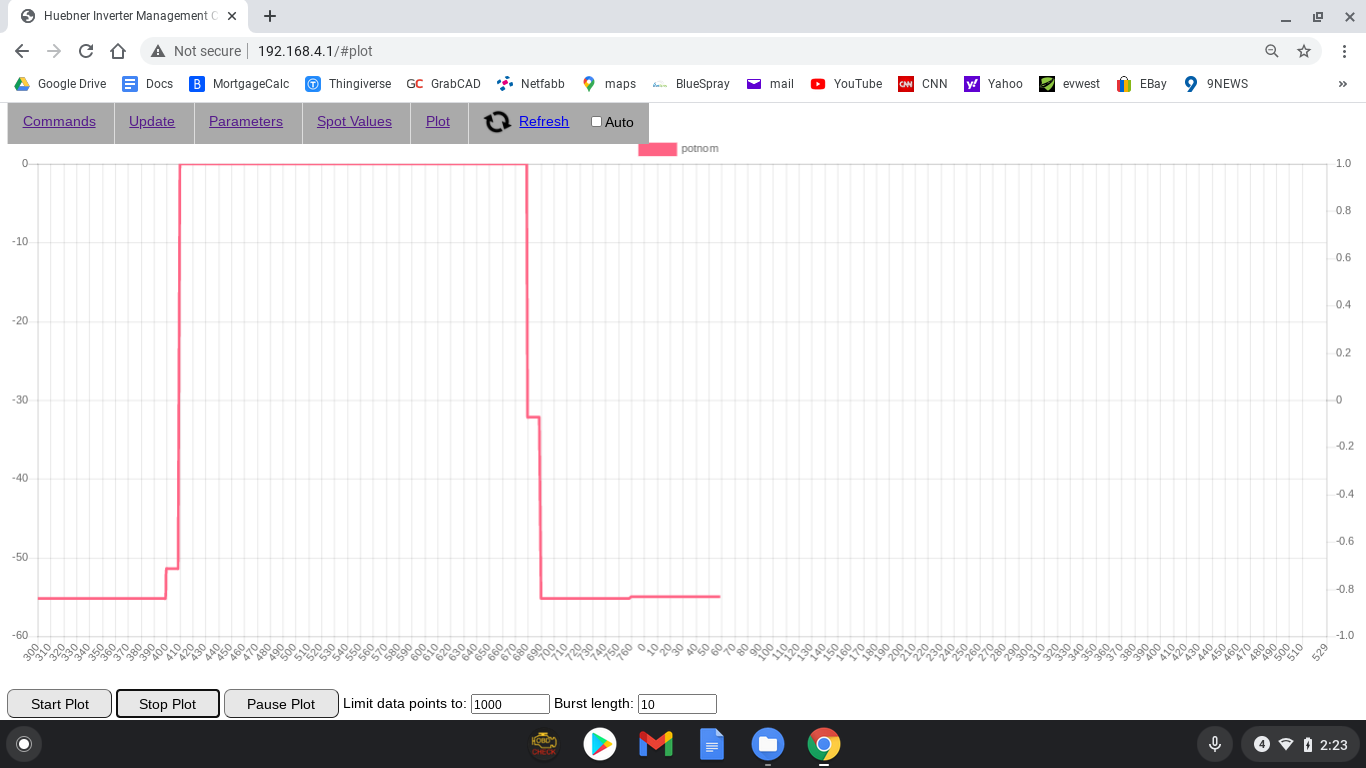

I'm having a weird problem with my throttle pedal while bench testing LDU at 80volts.
Dual hall effect pedal from old maxima, with two pot channels test and plot perfectly.
I configured the dual channel potmode for throttle signal redundancy, calibrated the two pot signals, everything seems fine, running motor, etc...
The problem is, there's a giant dead spot in the middle portion of throttle travel.
I've run a plot showing both throttle pots rising slowly as I depress the pedal VS amps to the motor. there's a deadspot thru the major central part of the travel, and it feels software induced. What am I missing? I did need to reverse the direction of motor rotation, is a side effect of that?
Is it a parameter problem? I've attached the plot and the param file if anyone has any chance to look, I'd be very appreciative.
Thanks-john
Blue=POT Brown=POT2 Red=AMPS

Re: Throttle Pedal
The parameters ampmin and slipstart are your friends.
First try lowering slipstart in 5% decrements, maybe down to 30% and see if that fixes your problem. Then you can also try raising ampmin like up to 10%

Re: Throttle Pedal
The offset tolerance is 10 and cannot be set by user as of 4.85. If you'd like to edit the software and compile it yourself, the value is in throttle.cpp in the source code.
Relevant code:
Relevant code:
bool Throttle::CheckDualThrottle(int* potval, int pot2val)
int potnom1, potnom2;
//2nd input running inverse
if (potmin[1] > potmax[1])
potnom2 = 100 - (100 * (pot2val - potmax[1])) / (potmin[1] - potmax[1]);
else
potnom2 = (100 * (pot2val - potmin[1])) / (potmax[1] - potmin[1]);
potnom1 = (100 * (*potval - potmin[0])) / (potmax[0] - potmin[0]);
int diff = potnom2 - potnom1;
diff = ABS(diff);
if (diff > 10)
*potval = potmin[0];
return false;
return true;
Re: Throttle Pedal

Re: Throttle Pedal
That comment refers only to the lines directly below it; those check whether potmin is higher than potmax, meaning it's inverted.
For the purposes of checking the slop between the two values:
is specifically the relevant area.
if (diff > 10)

Re: Throttle Pedal
"10" means 10% difference in slope.
Maybe the problem is that pot1 saturates at 3.3V. Put a 2k7 or 4k7 in series with it and recalibrate. This forms a voltage divider with the on board 10k pull-down resistor.

Re: Throttle Pedal
Thanks for the explanations, I thought about a resistor to more closely match the signals.
So, I wired it up, 2k7 resistor to POT, and first test plotted very good, but now after a reboot i seem to have upset my always (for months) reliable WIFI connection. Not lost, but VERY SLOW data rate, no parameters right away, maybe an update every 5-20 seconds...
Now after reversing my steps I still have very slow parameters with the drive unit, have I upset the DU, or does it sound like a component failure? I've searched, but found no real answer. I've disassembled inverter cover to check the board and connections, reseated, flashed to current firmware, and updated the web files as described in the video with parameter subscriptions.
Up until now, I have been bench testing, occasionally with 80v, occasionally with no HV connection, operating everything fine...
but now the contactors will not complete a precharge sequence... Have I cooked it somehow or locked up the DU with an out of range throttle signal?
Apologies if this has been covered elsewhere, otherwise maybe new unexpected behavior, even if I need to buy a new board, thanks

Re: Throttle Pedal
You can't lock yourself out with wrong parameters. Sounds like sketchy power supply really. Thou shall measure voltages: 3V3, 5V, 12V

Re: Throttle Pedal [SOLVED]
Success!
Everything is functioning perfectly.
I found an intermittent ground fault in my test bench HV switching hardware which explained my precharge fail symptom.

Here's a successful plot of my dual-channel throttle and potnom values I was seeking in the first place.
