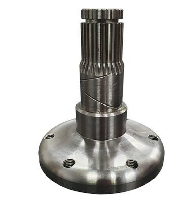

I got started on the axles this weekend. I was hoping that I could find a way to put the Tesla CV joint onto the GTO axle, but no such luck. Different spline counts (no surprise) but not enough meat on the GTO axle to cut a new spline onto it. Plus I need to shorten the GTO axles by about half an inch.
The plan for now is to cut (on an angle) and sleeve the two axles together. We'll see how long that lasts and when (not if) it breaks I'll get new axles made.

Re: 1940 Chevrolet with Tesla Motor
why don't you use the Tesla Drive Shaft Stumps from zero EV with adapter plates if necessary?
Essentially, that's what I'm doing but I just bought the whole drive shafts because it was cheaper. Adapter plates might work, but it would require some custom machining and/or butt welding to the Tesla stumps which I'd like to avoid. In theory, I could have the GTO shafts splined for the Tesla CV bearing carrier but the spline sizes are similar enough that there isn't enough material to cut new splines on.muehlpower wrote: ↑Sun Nov 15, 2020 8:19 pm why don't you use the Tesla Drive Shaft Stumps from zero EV with adapter plates if necessary?
https://zero-ev.co.uk/product/tesla-dri ... 64-993-vw/
I'm doing this project on a tight budget so I'm trying to avoid too much custom machining for now. Cutting and sleeving will get me on the road, and I can get a shaft with the GTO splines on one end and the Tesla splines on the other made when these break at some point.
I'm not sure we got along right. The parts of Zero EV fit into the Tesla differential and have 6 threads on a diameter of 108mm. Your drive shafts have 6-hole CVs. All you need is a ring with 6 holes of 108mm and 6 threads with your diameter, if you don't already have 108mm. No welding, no cutting!
I made adapters because my drive shafts were too short.
The Zero EV driveshaft stumps are exactly what I have but cost roughly $200 more than what I paid.
https://zero-ev.co.uk/product/tesla-dri ... umps-pair/
To mate the GTO axles to an adapter would require shortening them, and a) they don't have a good spot to add new splines b) I don't know a good local machinist c) I can't afford to be paying for custom machining work when I can get on the road with spliced axles. d) At this point I don't know whether the axle shaft or outer GTO CV joint will break first. I think its worth testing with the spliced axle to find that out.
You can of course do what you want, but I have spoken of the other drive stumps that don't look like the original tesla.
Oh gottcha. I highly doubt the Pontiac/Holden shafts will come anything close to the Porsche bolt pattern, and as I mentioned, putting in an adapter plate brings a host of other challenges with the packaging constraints I have.muehlpower wrote: ↑Mon Nov 16, 2020 2:47 pm You can of course do what you want, but I have spoken of the other drive stumps that don't look like the original tesla.
