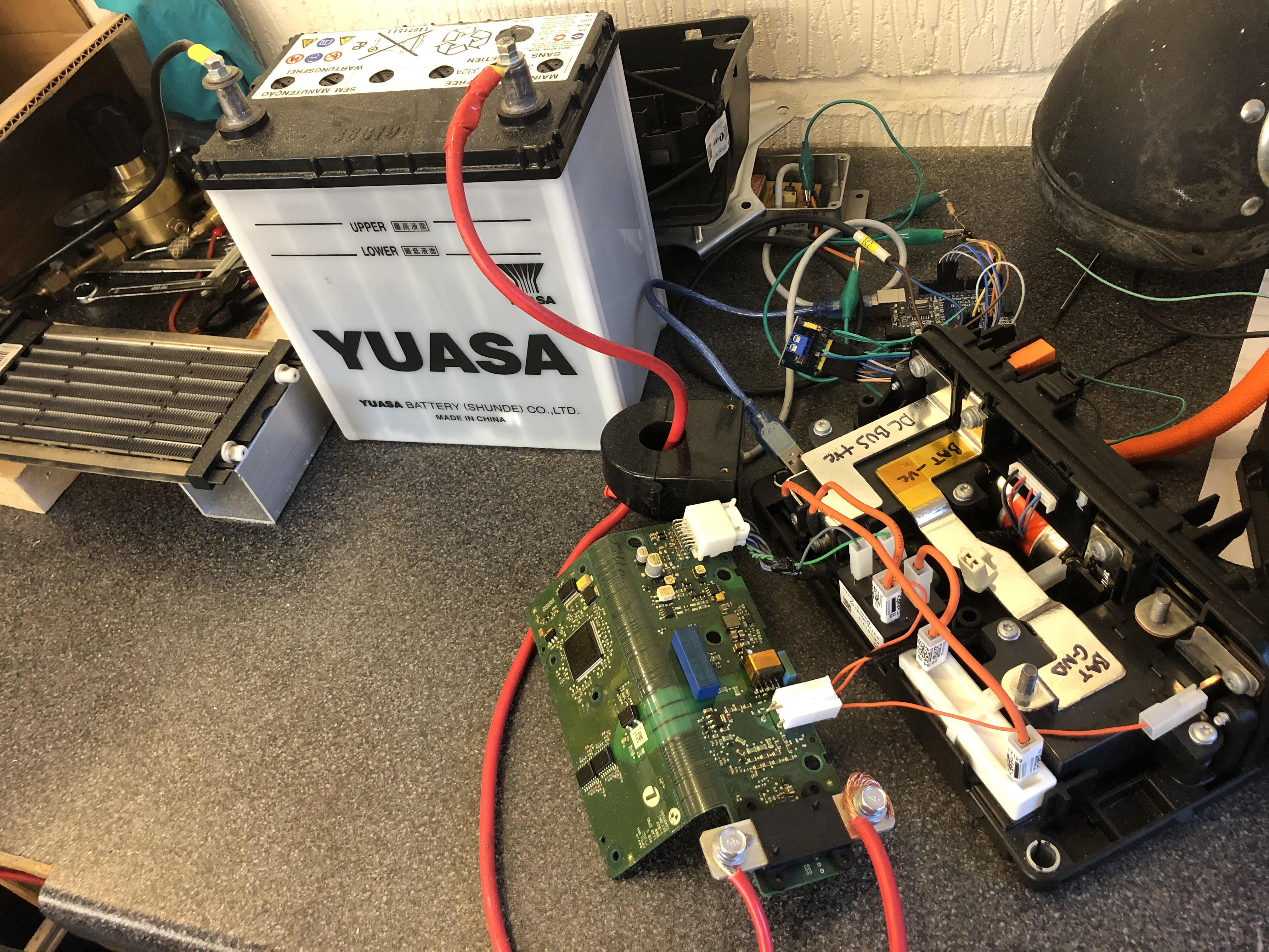

Hi, yes, it is absolutely possible to use the S-Box in its original form to output current and voltage.
I've spent quite some time reverse engineering the CAN messages up to about 300V and about 50A so far. I will dig out where I've got to and share. I'd really appreciate some sharing of real in-vehicle testing as I'm a bit limited with the test hardware I have at the moment.
Pins used as here:
My test setup is like this for current, using a DC current clamp and Arduino for CAN and current clamp logging and comparison, and an old PTC heater and 12V battery for a nice curvy current signal - good to work out scaling:
It has a single resistor shunt current sensor but with two independent high resolution A2Ds, an ASIL D processor, so very complex, and rather a lot of duplicated CAN signals. There are also a few complex voltage signals that seem differential in nature.
But critically, there is a pure signed current signal to a high resolution and a good battery terminal voltage available continuously on power up. I'll post where I've got to with that later.
Its way beyond me to reverse engineer the ability to control the contactors over CAN. For direct connection from SImpBMS, there is obviously all the mosfet drivers for the contactors, but complicated by both high and low side driving and current sensing etc. I guess for the ASIL D requirements. But last I looked, I think it is possible to cut the processor outputs to the drivers, solder in some flying leads and have a go at driving them independently from the Teensy. I hope that does not send the processor crazy.
I'm trying to use the 3 series PHEV pack with minimal modifications, hopefully just one Teensy with SimpBMS and a second CAN interface.
Hope that helps, and I'll send the CAN messages and my attempt at the scaling info later.
Richard.

So, the CAN bus is 500KBPS and I've found a good correlation with CAN ID 220 for battery volts on the battery side of the contactors.
This is preliminary but seemed to work out for turning ID220 in to volts:
   //ID220 DC Bus Volts pure
            a=((float)(256*(int)(canMsg.data[2])+canMsg.data[1]))/256.0*p1;
            b=(((float)(canMsg.data[0]))/256.0)*(p2/p3);
            c=(((float)(canMsg.data[6]))/256.0)*(p4/p5);
            volts220=a+b+c;
With parameters:
float p1=64.0;
float p2=p1;
float p3=256.0;
float p4=p1;
float p5=1024.0;
I'd be really grateful if others could try that and validate or adjust. Those parameters seemed "plausible" so hopefully that is about right? I'm new to this CAN reverse engineering.
Attached is my spreadsheet of working out the above from the raw log if that is any help to validate what I found. This has all the IDs logged, but only calculating on ID220.

Current seems to be on ID200 (but there is also current related data on ID110)
I found this gives a meaningful current signal:
current200=((float)((256*canMsg.data[2])-(canMsg.data[0]+PCoffset+canMsg.data[1]*256)))/PCscale;
With:
float PCscale=1.2;
int PCoffset = 12;
EDIT - this is probably not correct and needs testing at higher currents and use of bytes 0 to 3. Will update after more testing!
Seems strange to need that scaling factor? The offset is tiny in mA and probably different for each. Not sure if needed really and could be just inaccuracies in my current clamp and Arduino.
Attached is my spreadsheet that got me to this if any use, showing positive and negative currents.
BMW current 110 200.xlsx
(1.29 MiB) Downloaded 368 times
Again, this needs real testing as I've only got to this with a few tests. I was trying to increase current but then ran out of time.
Be great to hear of others experiences with this. Its an amazingly well engineered piece of kit which seemed a shame not to use.

What I have done is look at the communication from the sme to the Sbox by powering this up seperatly. It looks like ID 0x100 and 0x300 are sent by the SME, presumably to command the Sbox to close the contactors. Unfortunatly, I have not had time to go any further to manipulate the messages and see if I can get anything to happen, and now i need to rewire my setup.
I belive you would need power on pin 14 for the contactor supply also, perhaps you will see one of the CAN messages being sent by the Sbox change when you apply 12V to this pin (could be a status bit for this supply)?
I have attached a log of the SME messages, perhaps this will help. In message 0x100 it looks like there is a counter in byte1 and possibly a CRC in byte 4. However the CRC does not seem to match anything i have tried.
smetosbox.log
(47.28 KiB) Downloaded 305 times

Hi sprocketman, I'd not suggest connecting 8 modules to the voltage measurement connector of the S-Box (three thin orange wires), that will probably exceed its capabilities significantly! No problem with the current sensor on its own up to the capabilities of the module I expect. There are lots of resistors in series in that measurement system that presumably for a potential divider for the A2D. You can get the voltages from the modules. Just a thought!
pilt, thanks, I will certainly look at the additional 12V line. I think we will need CRCs understood to get it to respond to inputs like Tom reverse engineered for the modules. I'm not assuming that is possible unless we have logs on this can line in a working vehicle, which will be a challenge I guess?
bobby_come_lately, OK great, will be good to see others experiences with this.

OutlandishPanda wrote: Wed Nov 11, 2020 6:53 am Current seems to be on ID200 (but there is also current related data on ID110)
current200=((float)((255*canMsg.data[2])-(canMsg.data[0]+PCoffset+canMsg.data[1]*255)))/PCscale;
With:
float PCscale=1.2;
int PCoffset = 12;
Attached is my spreadsheet that got me to this if any use, showing positive and negative currents.BMW current 110 200.xlsx
Hi OutlandishPanda,
I had a quick look. I think the current is actually stored across 4 bytes (0 to 3). It looks like a 32bit signed integer. If you look at the 4th byte, it is either 0x7f or 0x80 depending on which direction the current is (ignoring noise and small offset).
I will have another look when i have more time

Hi pilt,
Thanks for testing! I saw that both bytes 2 and 3 gave signing info and so I ignored 3 - which was bad!
I think you are right, because putting manual data into my conversion shows with just two bytes, I can't exceed 78A. I just didn't test at high enough currents. I can't go over 60A at the moment. Shows the importance of full range testing.
Looking forward to your logs when you get time and I'll try and test at closer to 100A and report back.
