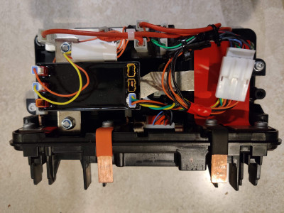

Does anyone have a pinout for the 'safety module'? Looking at re-using it but didn't take a note before I adapted the loom.

Hi,bobby_come_lately wrote: ↑Sun Nov 08, 2020 9:49 am Does anyone have a pinout for the 'safety module'? Looking at re-using it but didn't take a note before I adapted the loom.
Which pin out do you need?
this one?

Yes please! That's the external connector, right? Guessing it's power and CANBus and...??sprocketman wrote: ↑Sun Nov 08, 2020 9:54 pmHi,bobby_come_lately wrote: ↑Sun Nov 08, 2020 9:49 am Does anyone have a pinout for the 'safety module'? Looking at re-using it but didn't take a note before I adapted the loom.

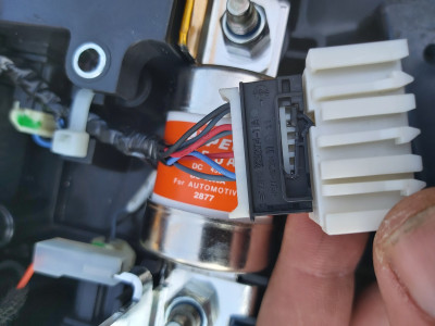

Its the conection inside the black S-Box. its just cliped into the plastic housing.bobby_come_lately wrote: ↑Mon Nov 09, 2020 8:26 amYes please! That's the external connector, right? Guessing it's power and CANBus and...??sprocketman wrote: ↑Sun Nov 08, 2020 9:54 pmHi,bobby_come_lately wrote: ↑Sun Nov 08, 2020 9:49 am Does anyone have a pinout for the 'safety module'? Looking at re-using it but didn't take a note before I adapted the loom.
this one?
A341*1B is the conector lable to the s -box
Here is a close up of the connections. it turns upside down for some reason when you click on it so here is another one.
Dont quote me because I havent tested it but I think the conections are :-
1 and 10 is can black
3 is 12v Red
12 is ground Grey
14 is 12v red
There are 2 cables on 7 and 16 that dont go to the loom
7 Light Blue
16 Grey

Great - thanks all. Will have a play. Like the idea of dropping the ISA shunt in if I can't get the original electronics going.

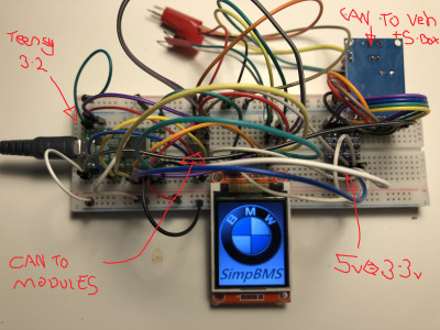

Hi, yes, it is absolutely possible to use the S-Box in its original form to output current and voltage.
I've spent quite some time reverse engineering the CAN messages up to about 300V and about 50A so far. I will dig out where I've got to and share. I'd really appreciate some sharing of real in-vehicle testing as I'm a bit limited with the test hardware I have at the moment.
Pins used as here: My test setup is like this for current, using a DC current clamp and Arduino for CAN and current clamp logging and comparison, and an old PTC heater and 12V battery for a nice curvy current signal - good to work out scaling:
It has a single resistor shunt current sensor but with two independent high resolution A2Ds, an ASIL D processor, so very complex, and rather a lot of duplicated CAN signals. There are also a few complex voltage signals that seem differential in nature.
But critically, there is a pure signed current signal to a high resolution and a good battery terminal voltage available continuously on power up. I'll post where I've got to with that later.
Its way beyond me to reverse engineer the ability to control the contactors over CAN. For direct connection from SImpBMS, there is obviously all the mosfet drivers for the contactors, but complicated by both high and low side driving and current sensing etc. I guess for the ASIL D requirements. But last I looked, I think it is possible to cut the processor outputs to the drivers, solder in some flying leads and have a go at driving them independently from the Teensy. I hope that does not send the processor crazy.
I'm trying to use the 3 series PHEV pack with minimal modifications, hopefully just one Teensy with SimpBMS and a second CAN interface.
Hope that helps, and I'll send the CAN messages and my attempt at the scaling info later.
Richard.

So, the CAN bus is 500KBPS and I've found a good correlation with CAN ID 220 for battery volts on the battery side of the contactors.
This is preliminary but seemed to work out for turning ID220 in to volts:
With parameters:
I'd be really grateful if others could try that and validate or adjust. Those parameters seemed "plausible" so hopefully that is about right? I'm new to this CAN reverse engineering.
Attached is my spreadsheet of working out the above from the raw log if that is any help to validate what I found. This has all the IDs logged, but only calculating on ID220.

bobby_come_lately, yes, my idea for SimpBMS is like this (sorry messy):
I've added a simple TFT to the SimpBMS code (that is the start up splash screen) and a second CAN bus interface over SPI. The latter turned out to be tricky to get working. I found the ACAN2515.h library for mcp2515 SPI CAN does not upset the FlexCAN library used by SimpBMS.
I'm keeping the native Teensy 3.1 CAN connection exclusively for the modules unmodified from the fantastic work by Tom. The second CAN will talk to the S-Box for current mainly, maybe voltage also (although we have that from the modules) and maybe Wh if it outputs that. It will also output data over CAN to the vehicle controller (Teensy 4.1). (That will drive an Outlander front transaxle etc.)
The screen is mainly for development and watching charging and shows the following currently:
The colour bars at the bottom represent the delta V of each cell (80 in my case) with the colours scaled from a Google project here:
https://gist.githubusercontent.com/mikhailov-work/
Which does a good job of representing values in RGB for humans to spot the relative values. Looks clearer on the screen than this photo where the greens seem to have vanished. No idea if it will be of any use yet as not tried it on the pack. My pack had 1 to 2mV cell to cell variations as received out of a vehicle, which is amazing really.
The vertical bars in the middle of the SOC ring are the module temps.
So, on one screen you can see everything coming out of the PHEV modules and S-Box. HMI designers will be horrified I'm sure!
I'm a long way from getting this implemented and working properly but will share when I get that far. I'll probably also change the screen for IPS for use in the vehicle and simplify a bit.
